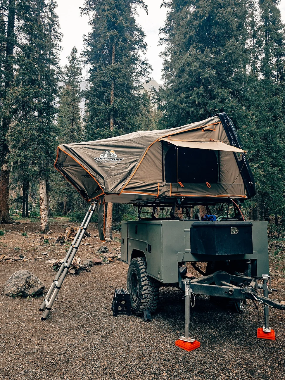

Put the RTT on a trailer, then you're not top-heavy and you can save your campsite while you explore. Doesn't work for everyone but it works great for me.
That's what we moved to, with a Hiker Trailer. Have a base camp, without having to haul the extra weight on trails or have to "break camp" if we go someplace.

Nothing really, just standard stuff.. I keep my campsite clean, put high value things out of sight, and lock the cabinets. I put a locking pin in the trailer hitch so it can't be easily hooked up and towed away but if someone wants it bad enough, they'll take what they want.
I operate on the assumption that it's mostly good people who are adventuring into the forest as far as I do, and that's worked out so far.

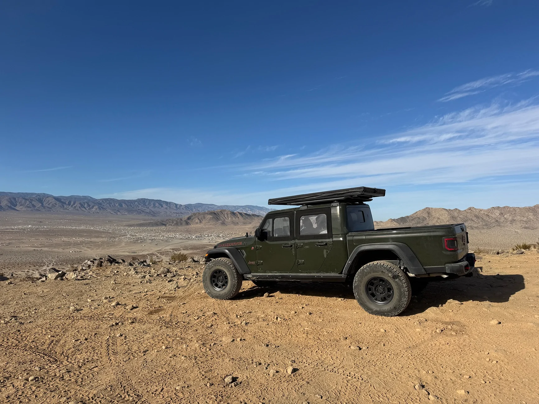

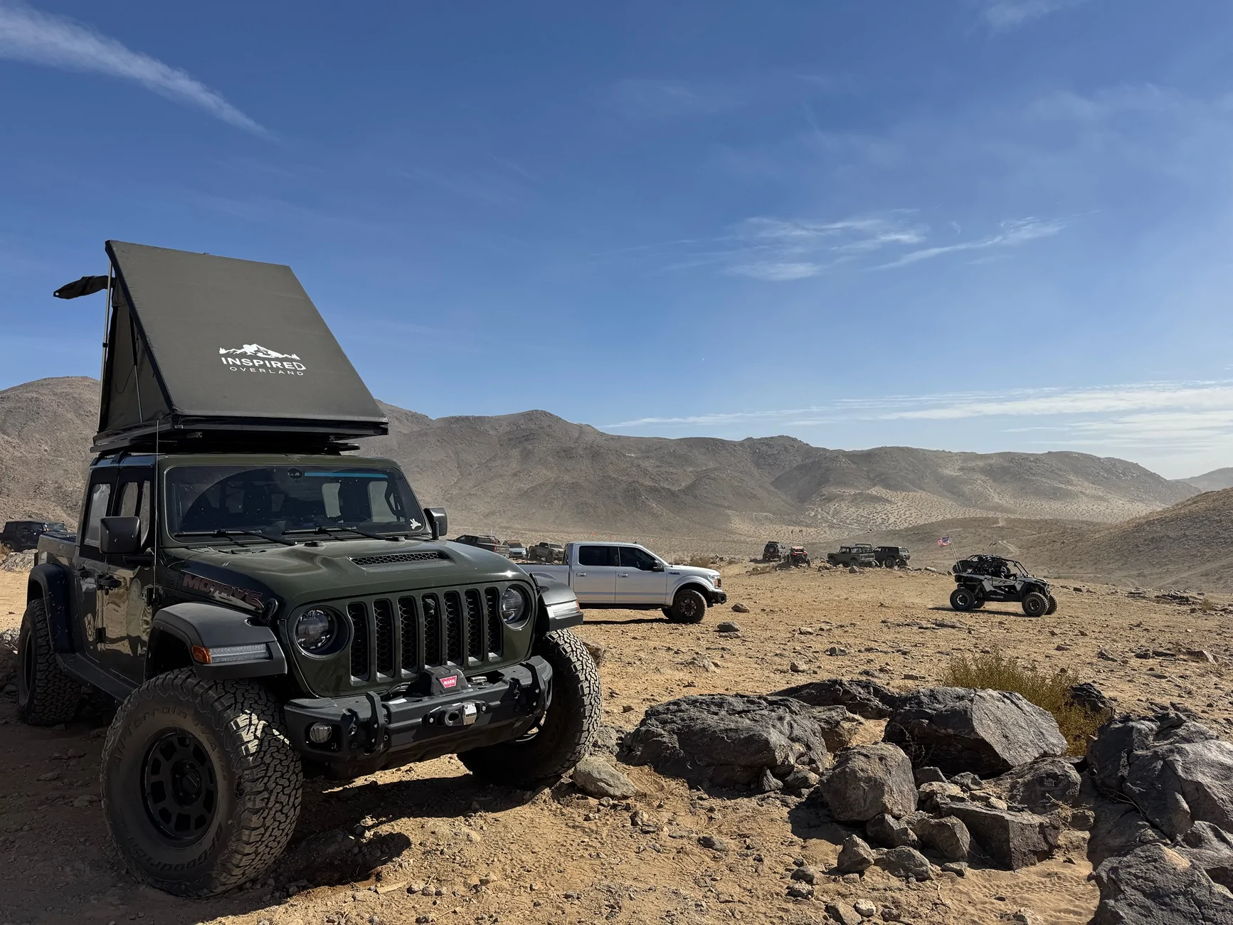

Here's my set up! Inspired Overland RTT on a Rhino Rack pioneer platform. I have the full backbone system, ordered separately from the rack. I ordered a larger rack than their system for the Gladiator. It's 5 or 6 inches longer. I have it slid back with a little overhang off the rear of the cab, and I can still get the freedom panels off easily.
