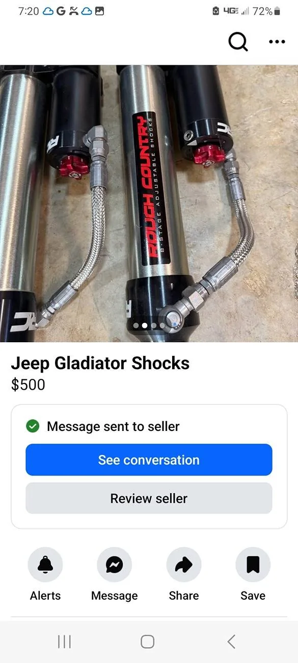

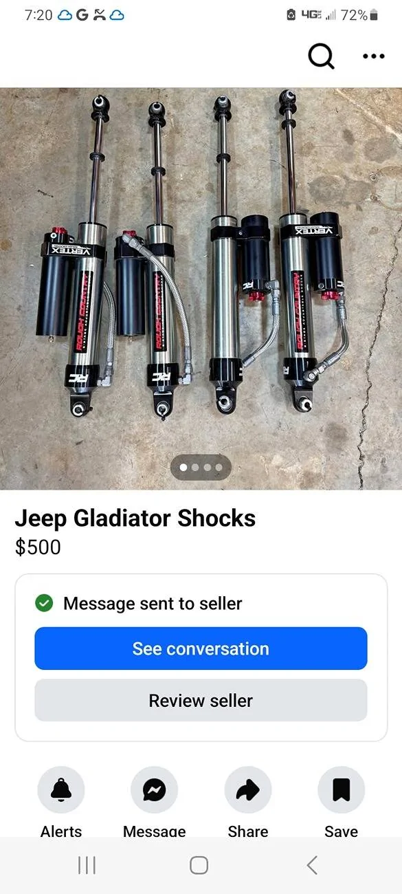

Hello to all! I find myself in need of advice. I have the other to buy a nearly new set of Rough Country Vertex Shocks for $500. They only have 1,000 miles on them. They lock as new.
I have a 2023 Gladiator Rubicon with the RC 3.5 lift and it has the upgrade to the N3 10 Nitrogen Shocks.
Would this be a viable upgrade considering the price? Would it be a 📒 difference? Lastly, these Shocks are designed for a 4" to 6" lift and mine is a 3.5. Any issues there? I appreciate your help!

Hey OP, just get the compressed lengths for the front and rear shocks, compare them to the same specs of the shocks you have now. If longer flex your Jeep until it is 3 wheeling and have a look at how much shock shaft you have left. This should give you a yes or no on the fit.
While not the same rig at all I ran 4-6 inch lift shocks on my JK that had a 3.5 inch lift. Compression was good with the bump stops from the shorter shocks, I did need to install spring retainers as the coils would unseat on extension.
I bet those shocks will fit just fine and give you more down travel :)

After taking the advice above I found that the Vertex Shocks are 1.5" longer in the rear and 1.75" in the front. As I previously said his 6" lift and my 3.5 would appear to be 2.5" difference, but when measured from the axle tube to spring perch his is only 1.5" higher lift. That measured difference matchs the extended length very closely.
I appreciate everyone's input. I know that if I jack the Gladiator up, put the frame on jack stands, remove the lower shock mount and them lower the differential that I will have an idea. My next step would be to continue lowering the axle to the point that the longer shocks would mount. If the springs are well seated then no issues.
I assume nothing. That is a lot of work just to find out if they will work. That is why I am checking here and seeking advice.
Based on my research and measurements, any ideas?
I like the Vertex based on my research I have found that most if not all who has used them feal. I like the price as well. I also like the N3 RC Nitrogen Shocks that are on mine. I am just looking to improve what I have for a reasonable price if possible.
