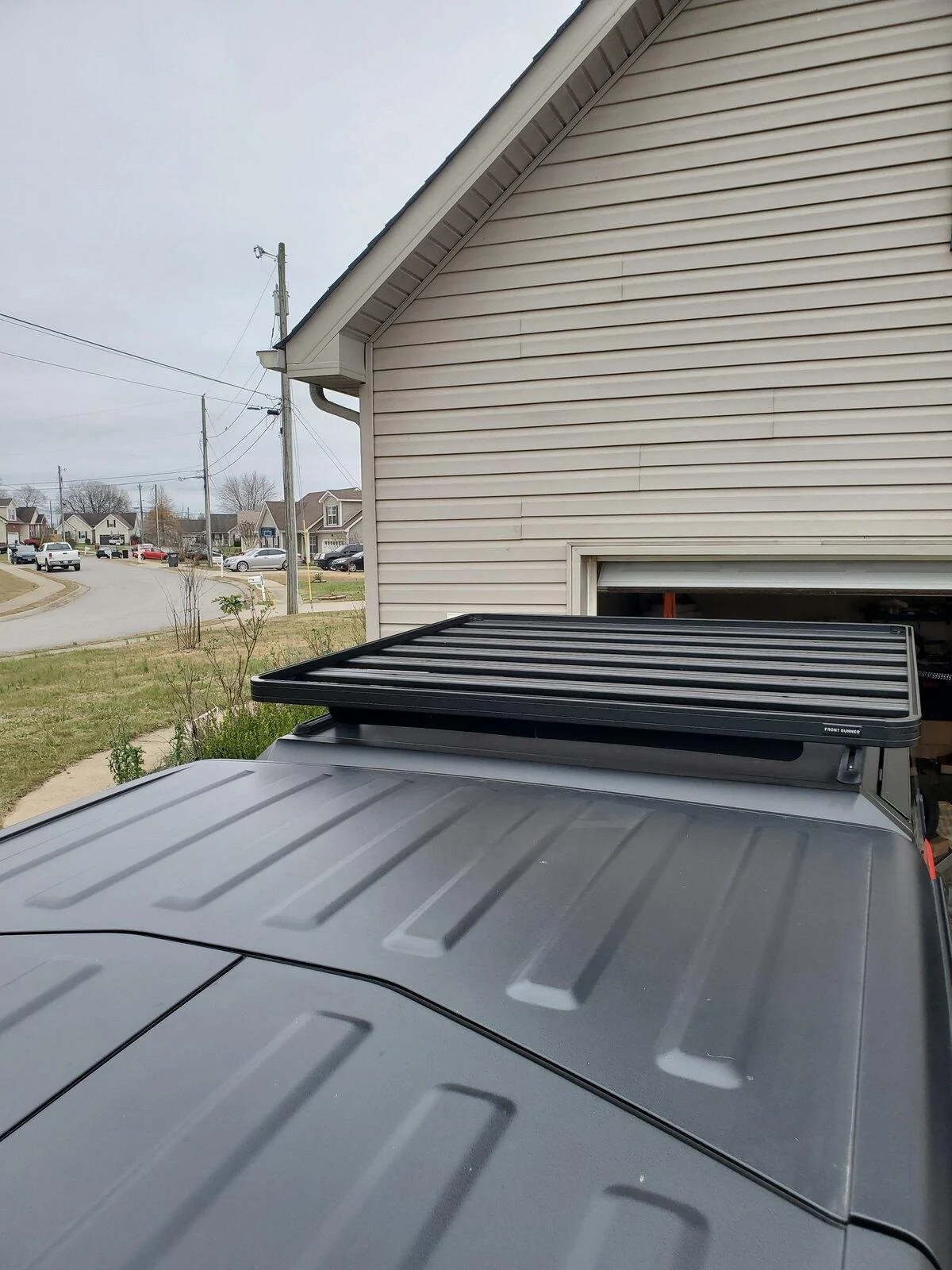

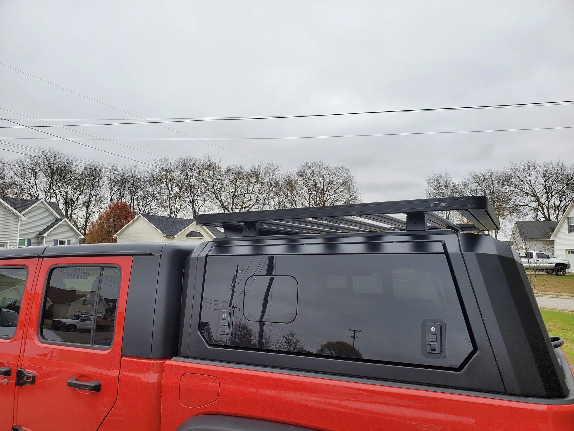

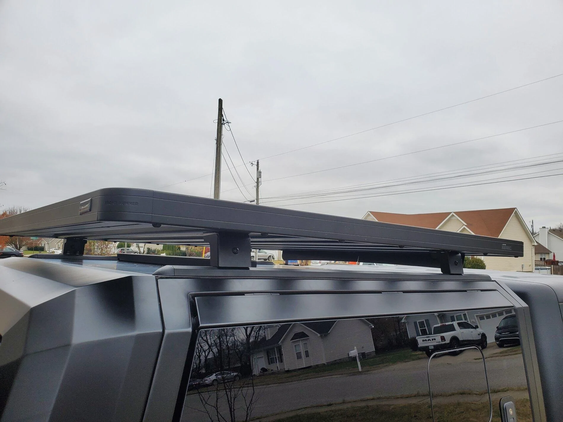

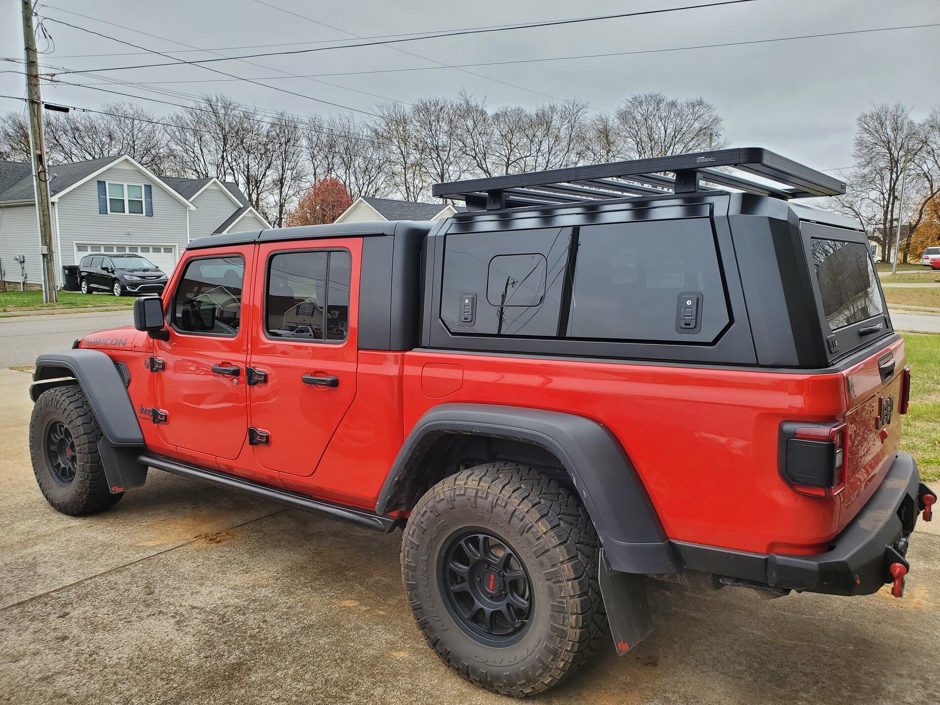

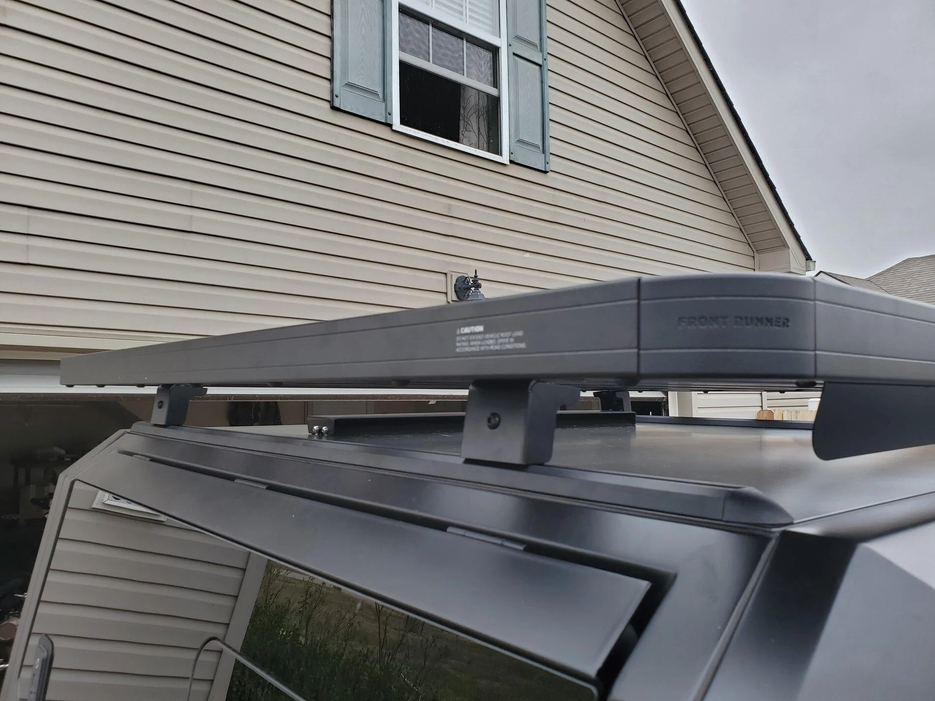

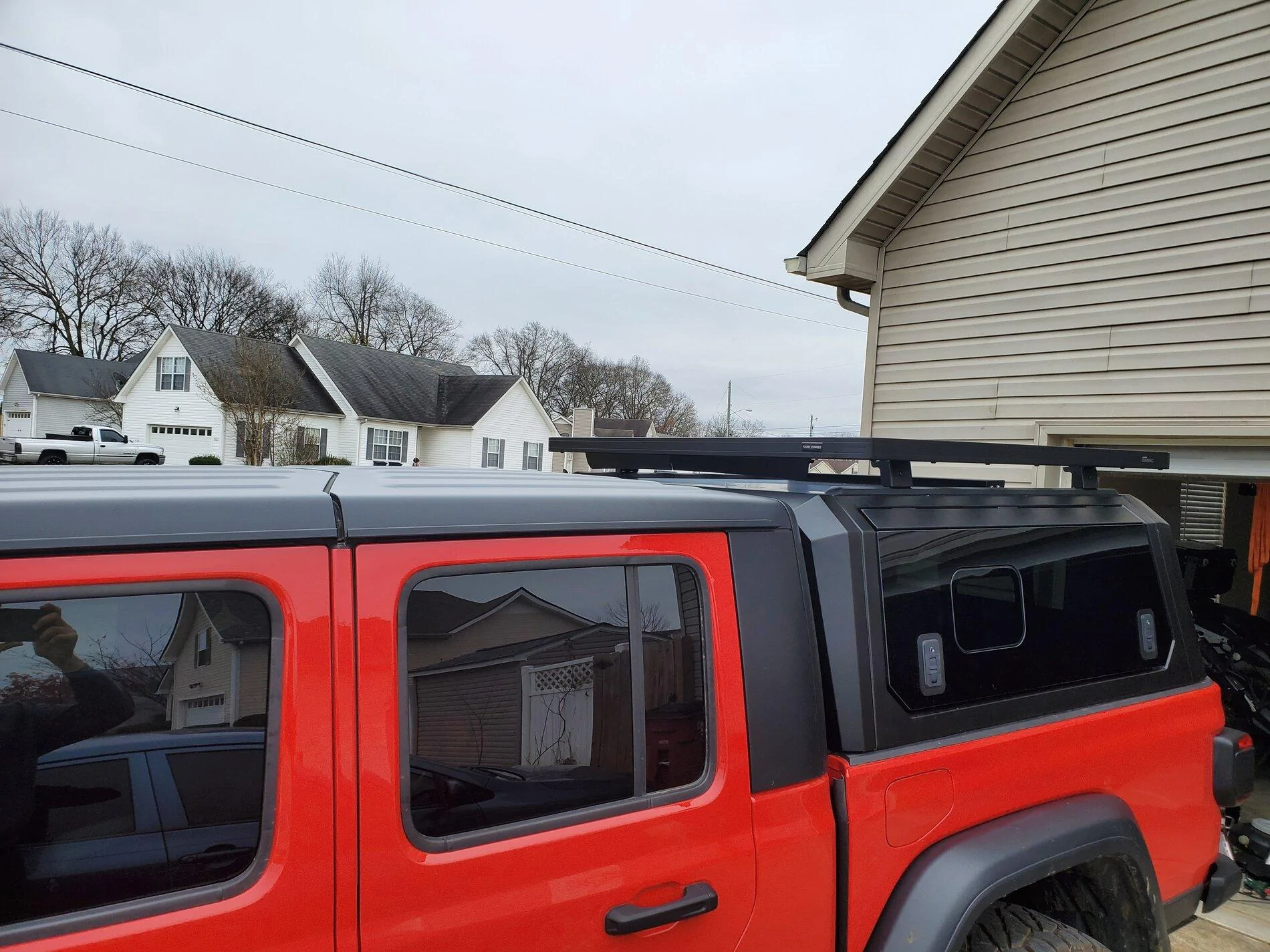

Frontrunner rack is up and running on my SmartCap. Fitment is perfect.
Be advised that the RSI channels are narrower than other manufacturers. Frontrunner makes RSI specific brackets for the mounting feet that aren't available on their site, so be sure to call or chat with them if any of you plan on going a similar route. I also went with the tall foot kit, to provide clearance for the RSI vent and Frontrunner wind fairing.
Up next is mounting my RTT brackets and test fitting the ikamper. I have a plan in place for the roof rack lighting, but I likely won't execute that until the front roof rack is on as well.

Wait, you can’t use regular foot packs on these channels? I thought normal Thule/Rhino style feet would work. Or did you mean the spacing of the mounting channels is narrower than standard for FrontRunner?
When my damaged roof panel gets fixed I’m going to need to mount my RTT and was planing on using a normal set of load bars, since the RSI still aren’t available.

I wish I'd taken a side-by-side picture prior to mounting...but basically, the small metal "anchors" that slide in to the tracks, which my Frontrunner rack feet then mount to, are narrower for RSI than the universal ones that were provided. By perhaps about 25% or so. Stock ones could easily be altered/ground down to work, but yes, the RSI channels are apparently narrower than the industry standard.

any chance you could measure the width? I am planning to use Yakima bars and am hoping the Landing Pad 1 channel adapters fit.
