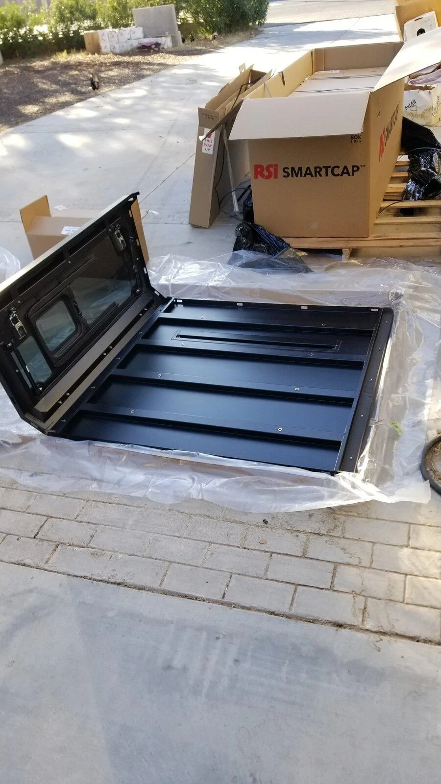

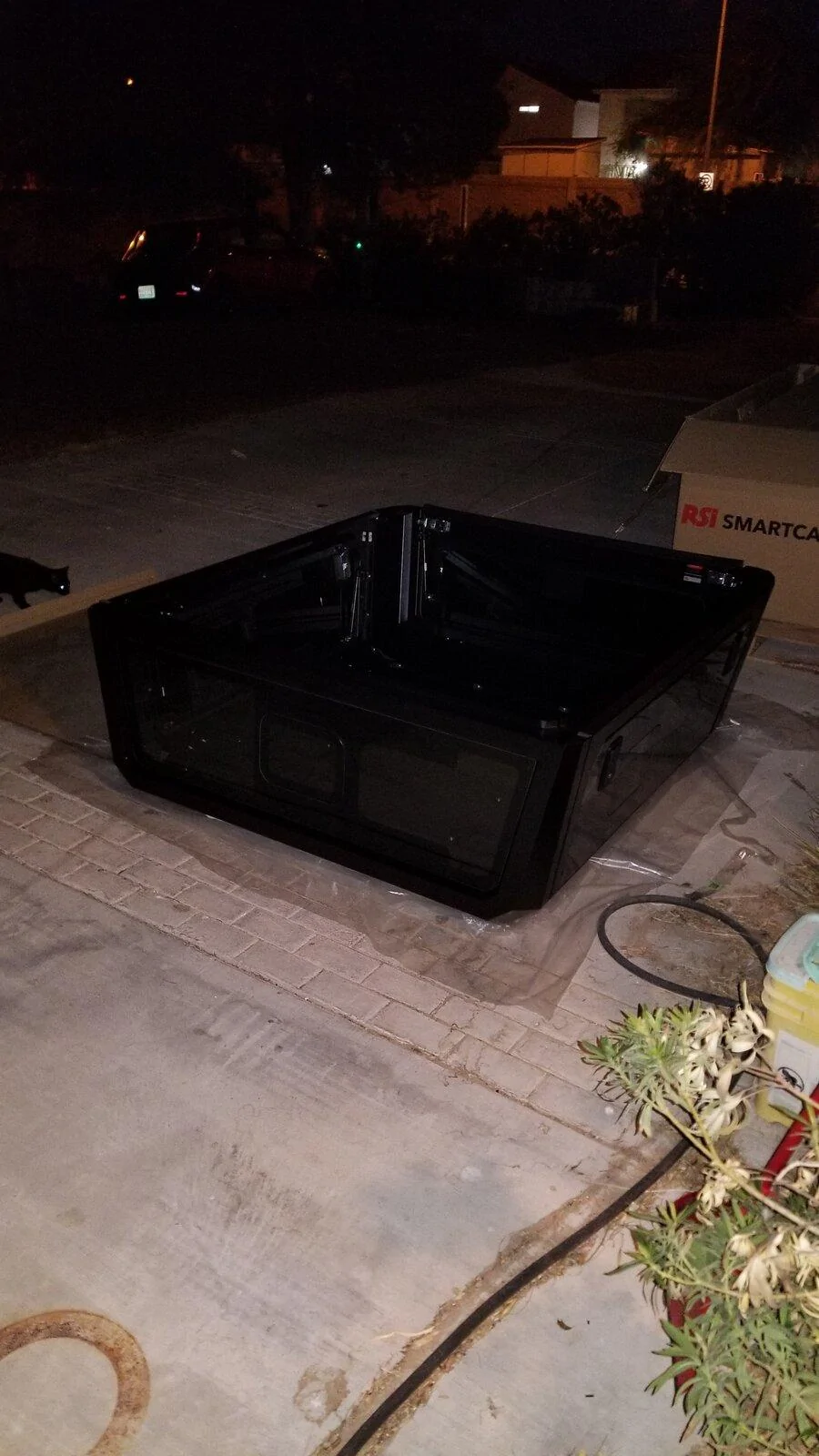

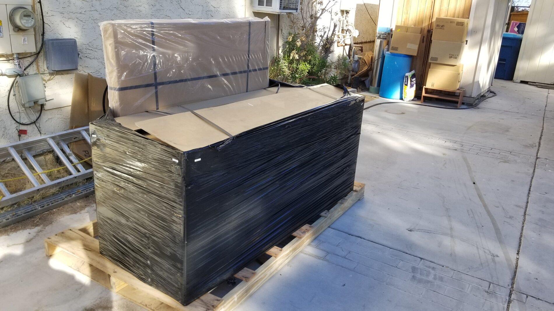

It showed up today, and in good shape. Everything is just hand tight, but I got it assembled. Tomorrow I'll tighten it up and put the weather seal around the bottom. Then I just need to find some help to mount it.
Awesome!
Interested to see if yours also has tightness issues with the tailgate and with the rear window.

Should I be concerned about the apparent length of time for assembly? I'm up in AK...i only have so much sunlight when mine actually arrives....
You should be good. Mine was delivered about 1:30, and I quit about 5:30. Sunset is 4:30, but I had the wall light to help. It takes a little work to get some of the holes to align, but not too difficult. It does take a little time to remove the bolt assemblies from the front and rear pieces. It is shipped with them installed.
The assembly instructions are actually pretty good. Read through them first, and you should be able to do the initial assembly fairly quick and easy. I don't move real fast, so I'm not the best for doing time estimates. The shipping container for the roof is the assembly platform, so watch the labels and open it carefully.

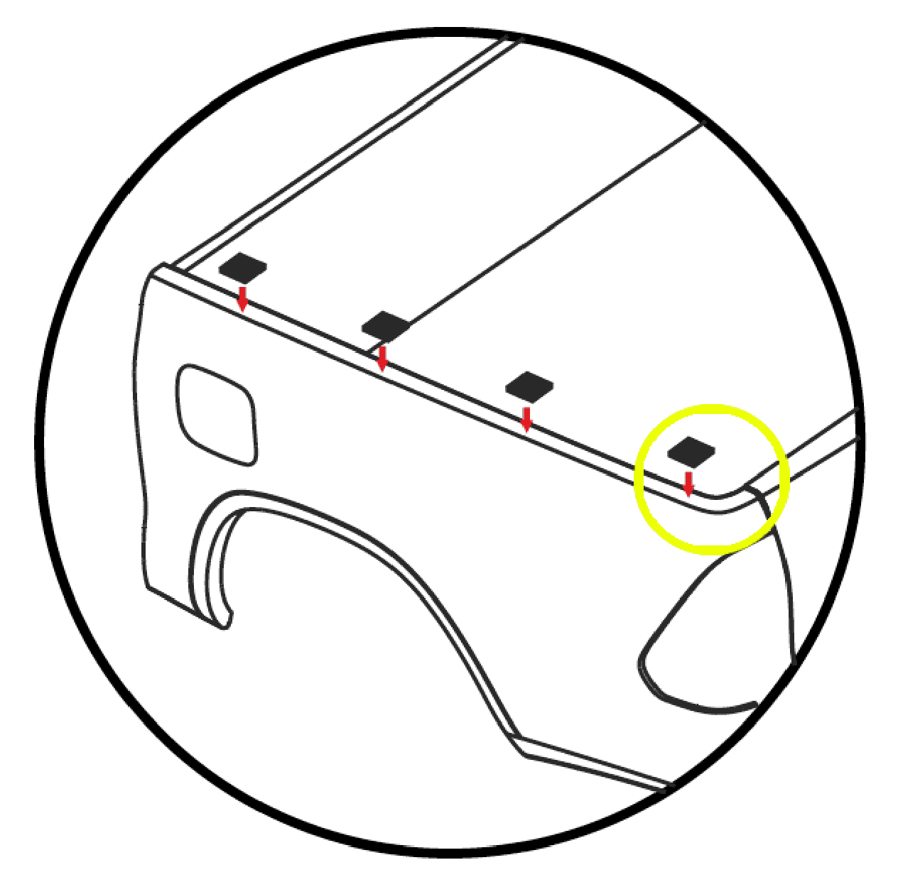

Wondering if there are any updates on addressing the issue with the extremely tight seals on the rear window and the corners of the tailgate?
You bet. We are going to be testing a 13-14mm (approx. 1/2”) dense rubber block positioned between the cap and the bedrail at the rear corners of the bed (see diagram). This should be enough to keep the tailgate from dragging across the d-rubber, as well as the door gasket from dragging on the tailgate. We intend to do this to our Gladiator over the weekend to prove it out, then we will confirm the results here early in the week.

Awesome, looking forward to hearing about how it works out!
