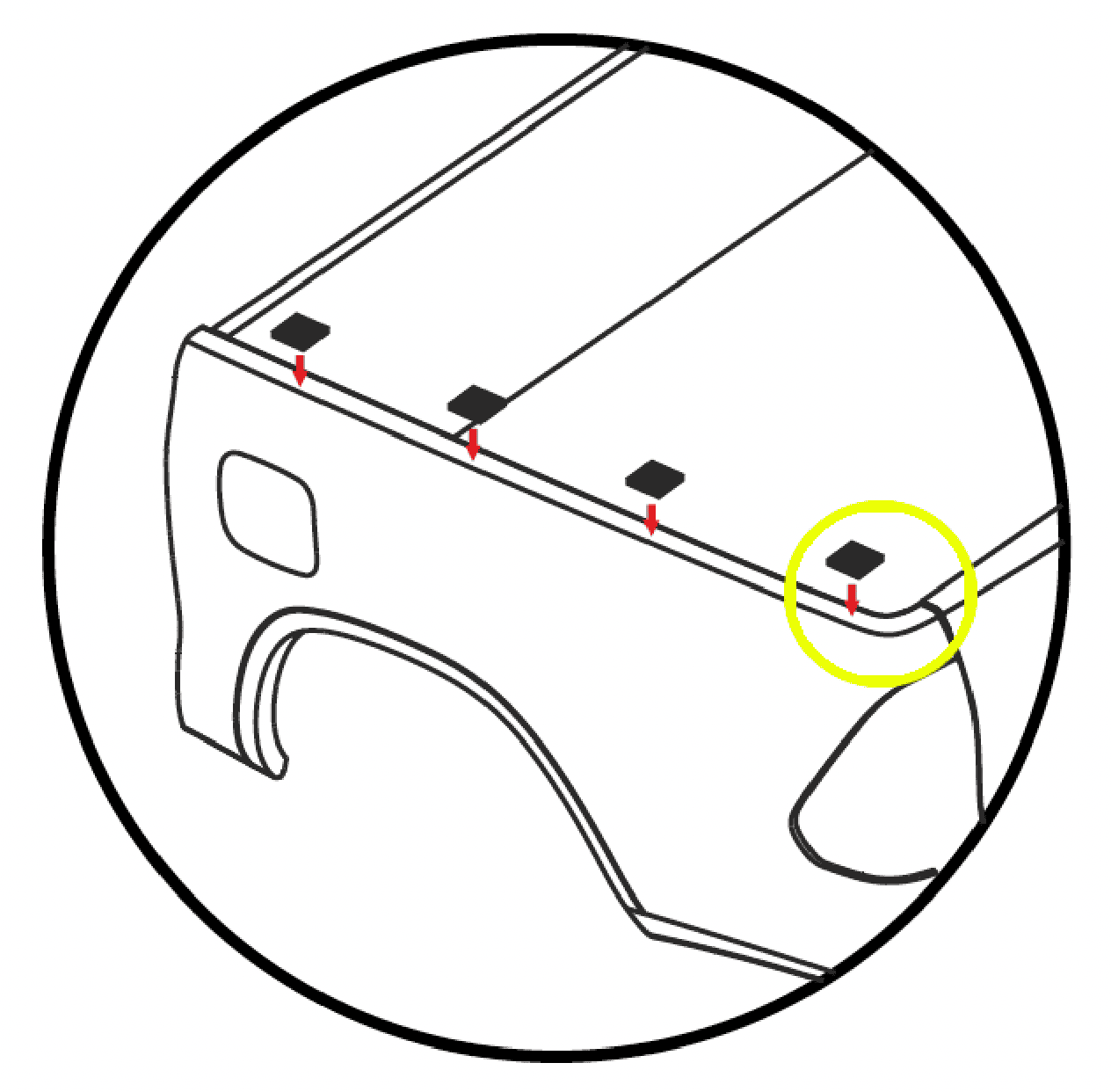

So, I tried what they recommended, and the relief on the seals was negligible. We're talking maybe a couple of mm of difference.
I think what I'm going to end up doing, is filling the inside of the d rubber with a bit of super glue, then wedging it on top of the tailgate so that it will hold in a flat position, if that makes sense. I was able to tug the d rubber flat in between the cap and the tailgate yesterday. I'll drop the tailgate tomorrow to see if the rubber has compressed to the point where it's not getting wrecked every time I close the tailgate. Hopefully. If not, I'll try a bit of glue inside of it before figuring something else out. It may be as simple as just moving that small part of the seal further back so the tailgate shuts against it.
Yeah I figured the rubber pads wouldn't do too much...there is already a space there at the back corners even without the pads.
I thought about just removing the rubber at the bottom of the back window and replacing it with a smaller gasket and moving the seals at the corners of the tailgate back as well like you mentioned, but I'll wait and see what RSI comes up with.
On mine, its not just the tailgate corners that is concerning, but the whole rear window that seems extremely tight. I have to really push hard to get everything closed back there, it definitely doesn't seem right after watching videos of the smartcap on other vehicles.
Hope this can be figured out, its such an awesome product and it sucks to have using the back tailgate and window be such an ordeal!

Our team is currently testing a couple of different solutions. We just need a day or two to make sure that what we recommend you do will be the best solution for this problem—while still maintaining the integrity of the gasket to keep the cap watertight. Please bear with us a moment so that we can properly test the solution.

As stated we are all over this. Our prototype fitment did not encounter the same issue that the production models obviously are. Our team is currently testing a couple of different solutions. We just need a day or two to make sure that what we recommend you do will be the best solution for this problem—while still maintaining the integrity of the gasket to keep the cap watertight. Please bear with us a moment so that we can properly test the solution.
Sounds good guys, thanks so much for being on top of it!

Thanks for your patience guys. We just got out of a meeting with our Tech Heads. The solution is likely a simple one that I will outline below, but we need to test it. Our Gladiator will not be available for testing until next week, so the final answer from us will not happen until then.
In the meantime… the issue is simple math. Since the D-gasket does not need to be heavily compressed to keep water out, it just needs to make contact with the bed cap, we simply need to elevate the back of the cap more. We will be testing progressively thicker rubber pads positioned on the sidewall near the tailgate to elevate it slightly more (see the attached diagram). This will reduce the drag, resulting in the door and tailgate opening and closing easier and protect the D-gasket from excessive wear and tear. If you find that you don’t want to wait for our schedule, the pads should be easily found at any local hardware store.
We greatly appreciate your patience and understanding while we get this issue resolved.

The window closing at the rear isn't overly tight for me. It's definitely snug, but not concerning to me personally. It definitely did loosen up a tiny bit by introducing the 10mm pads on the corners, but I also didn't torque the clamps as tight on the second iteration, so it could be a combination.
I dropped the tailgate today after having wedged the d rubber in between and leaving it closed for two days, and it has definitely flattened out a bit. The tailgate closes much easier now, and the d rubber gives way to the tailgate as it closes instead of trying to shovel it out of the way. Honestly, I think just putting that extra step in the instructions may be sufficient, or perhaps providing a cheap plastic shim or spacer as part of the kit to help "smush" the corners as the rubber settles. The tailgate isn't really tugging at the d rubber anymore, but unfortunately the damage to the leading edge of the rubber has already been done. The adhesive gave out, the rubber is deteriorating a bit and the superglue is ineffective now after multiple layers on both contact surfaces. With that being said, I still have probably 70% contact patch on the rubber, and I do not believe it will peel any further.
My retroactive solution is to cut those pieces, gently sand the caked on superglue from the lip of the cap, clean the area, and replace with a fresh piece of d rubber flush mounted to where the cut was made, then I'd ensure I wedge it between the cap and the tailgate for another day or two. That would fix my issue.
Having said that, I'll give it a week or so for official word. Honestly, the damage has already been done, so there's no rush at this point lol.

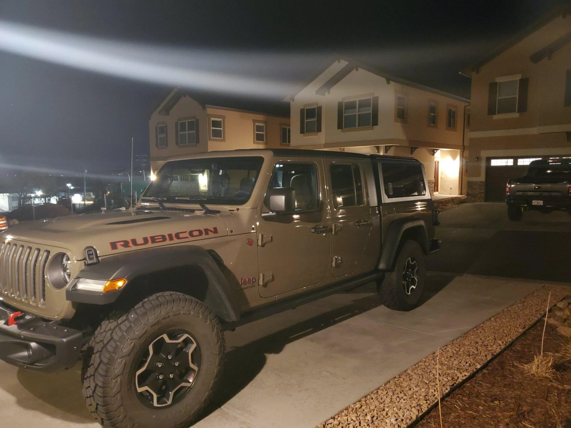

Ill probably have more photos over the weekend, but here are a few from tonight!
Any update to additional pictures?!? Been really wanting to see it on a gator gladiator!
