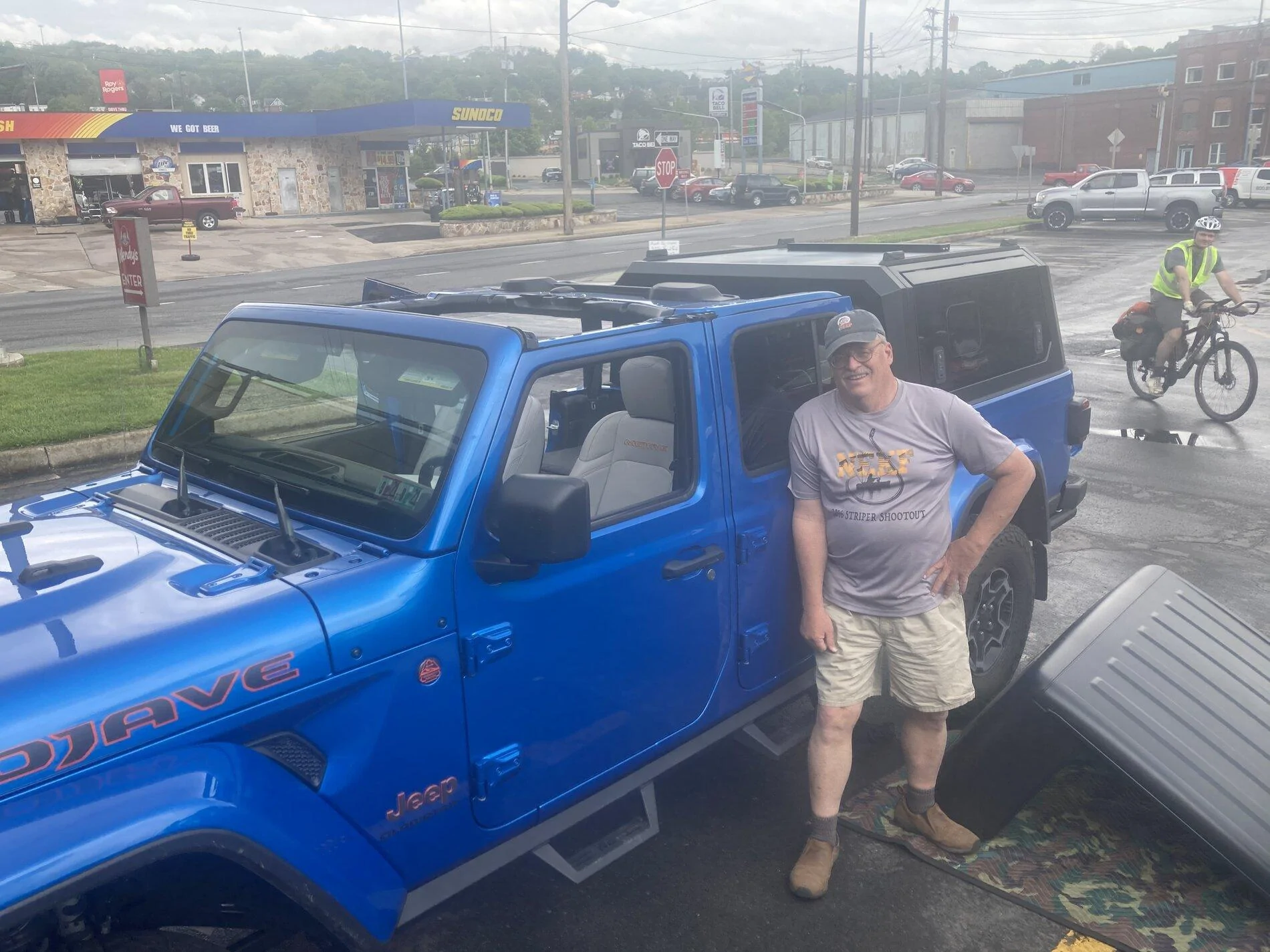

I took my hardtop off with the cap on, straight up and took it towards rear.
I did this in a Wendy’s parking lot with a forum member named Chris, we swapped entire hard tops my tinted window for his Sport base model untinted window , my view out the back much better now only looking through one tinted window. One thing is I’m six foot and Chris was 6’5”, I would not want to do if I was any shorter, but hey park along a curb and have short guy on that side.....Jack
How does it ride, Jack? Any weird noises or wind issues against the glass or anything? Think I’ll give it a go once the current storm passes.

I didn't drive with top off, just two guys in a lot swapping tops probably took twenty minutes all together and then we went our seperate ways. I would think it would be less noisey then with the freedom paanels off and top on, as the air would have more "escape" area.

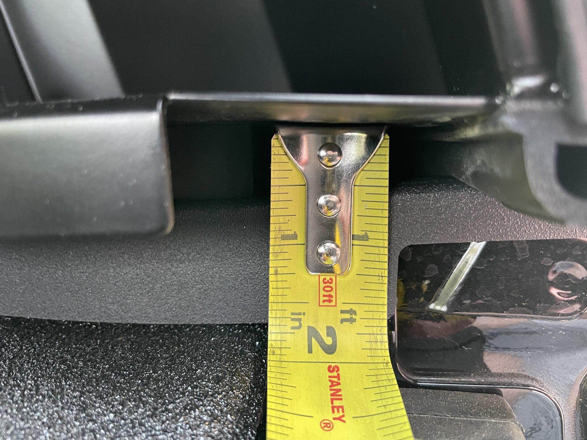

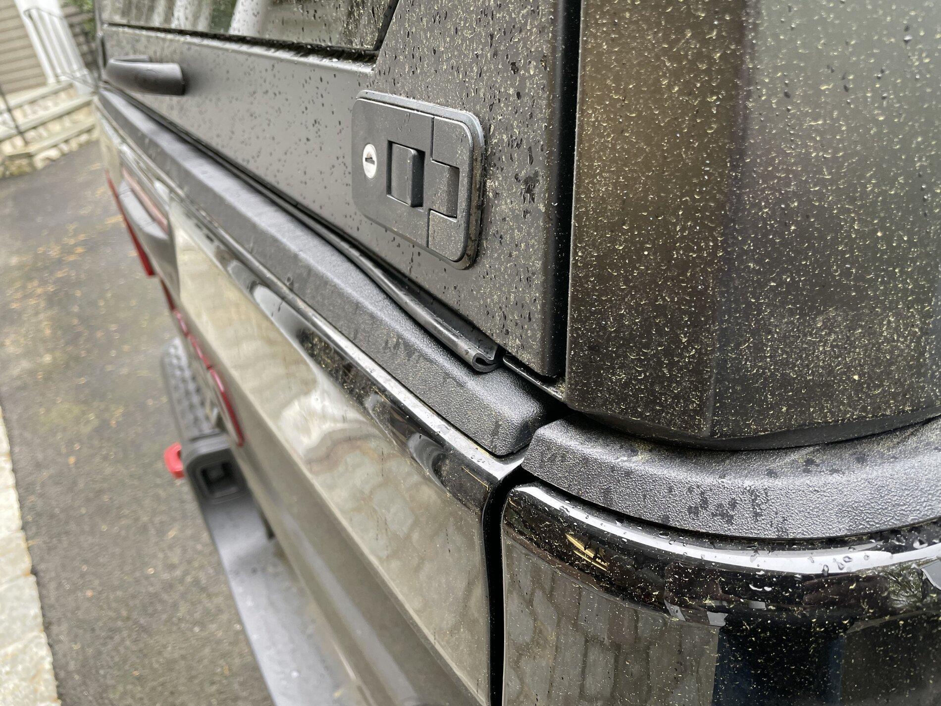

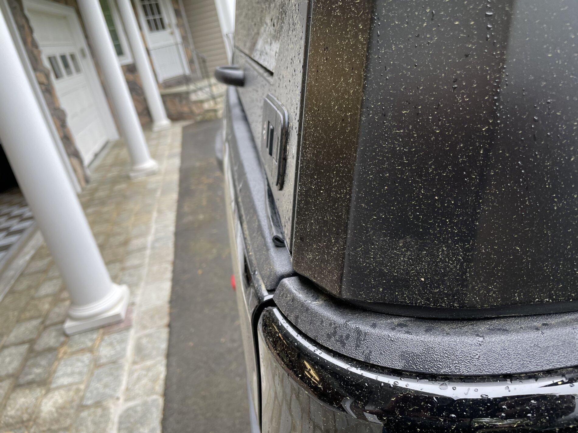

Tried replacing the spacers today with something taller - 3/4” 70 durometer rubber pads from McMaster. It didn’t work. I get 5/8” after compression, which is more than RSI recommends, and I still can’t close the tailgate or rear hatch without it messing up the gasket. I have to close both together, and the side gasket pieces still pull under.
When is this going to be corrected? So annoying on a $3700 cap…
Pics attached.
Pics attached.
I had a similar experience and had to go to a 7/8" spacer that compressed down to about 3/4" and then take a little bit of pressure off the rear clamps to get it fitting better. Mine is tight but I can easily open and close the SmartCap door and tailgate now. Hope you can get it figured out soon, once you have it dialed-in I think you'll really like the SmartCap.
I used 20mm pads and could only get 5Nm. Anymore torque on the clamps and it would have squished the plastic side rails too much.
Do you feel like it's tight enough not to move around at that torque level? I'm putting an RTT on top (170lbs), so just a bit concerned about it shifting with the extra weight.
I share the same concern once I get to a RTT. At the moment it seems stable, but make that call for yourself. I pushed and pulled on it, but not sure what sort of forces driving, aero and forbid an accident would exert on it. I’m playing with shims now to get the remaining torque on it. Once I figure that out, I’ll put them all around and call it a day.
It feels as though RSI mocked it up without torquing the clamps to determine the shim size. Once torqued, the recommended shims no longer provide enough clearance in my case.
I think we’ll have to do this all again once we add the weight of the RTT. From what I’ve seen, it’s the plastic bed side caps that deform. Another 170 lbs and they are likely to deform some more. At some point they either have to flatten out or break.
Or you need a large enough spacer that the deformation of the bed cap plus the height of the rear gate seal are offset by the spacer.
Makes me wonder how ARE does it on their caps.
