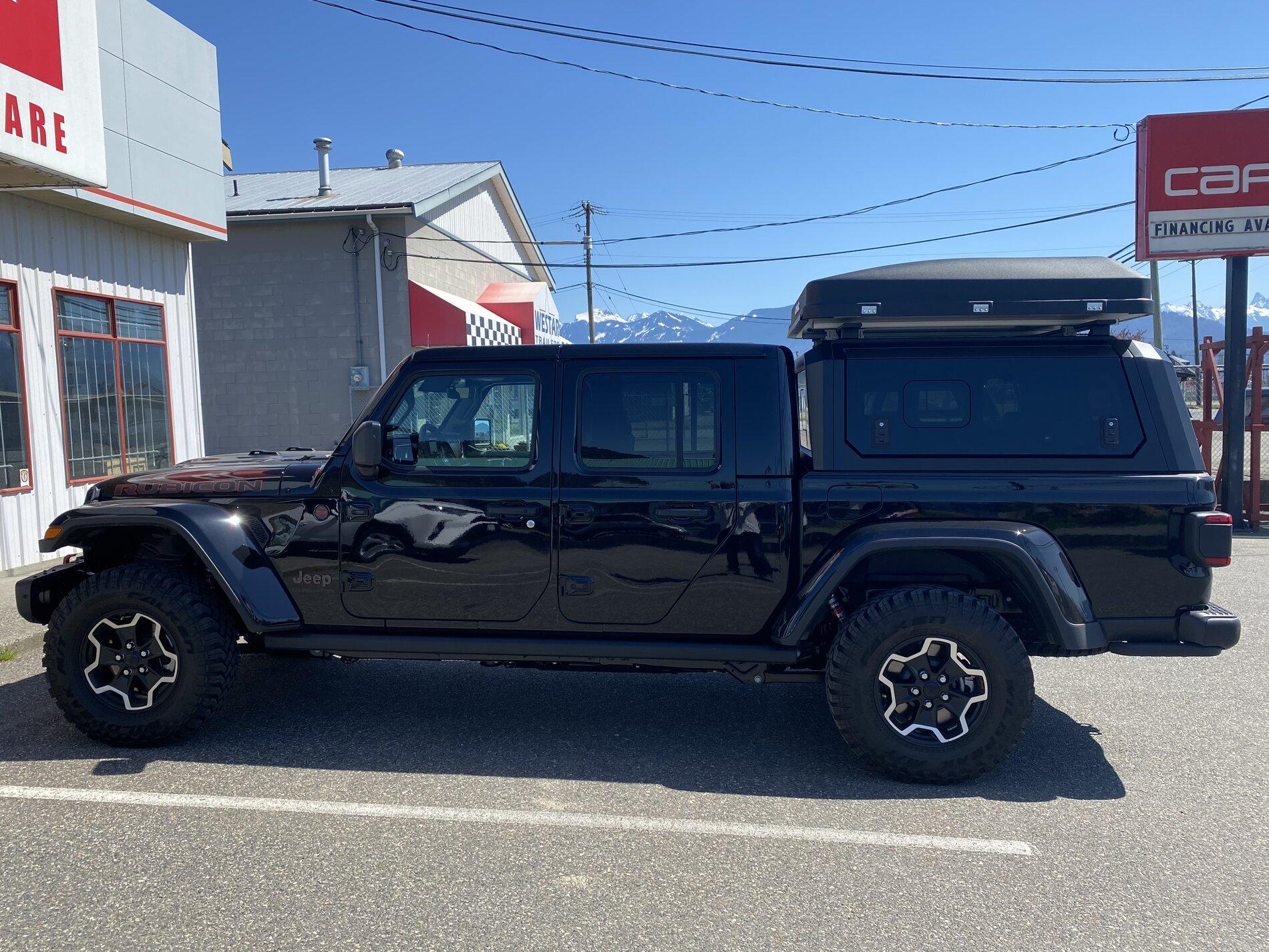

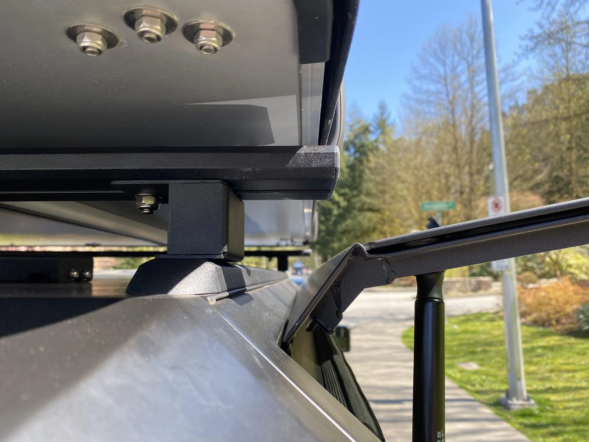

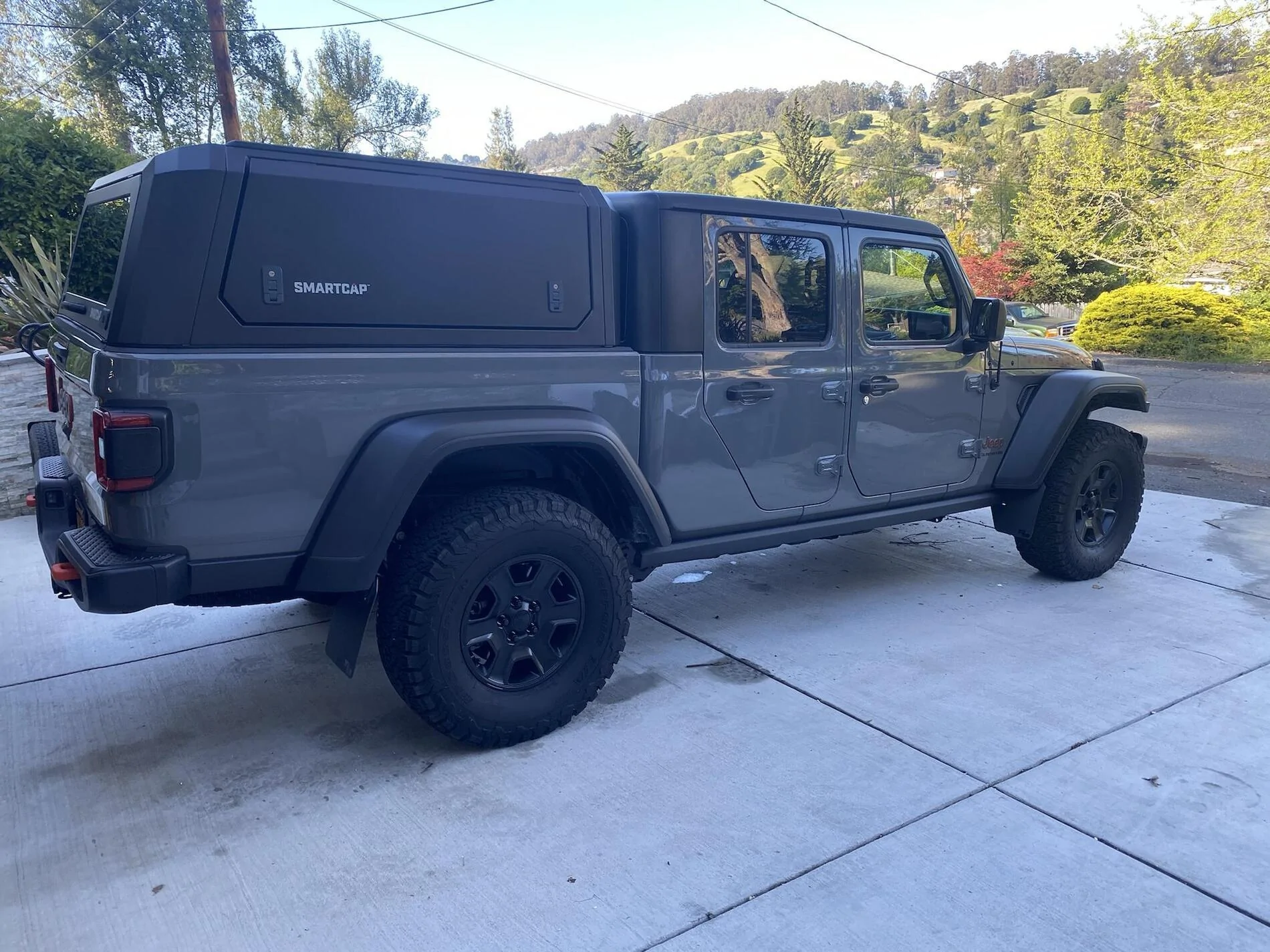

Had Capit toss on the RSI SA0401 Full Size bars and mount the iKamper Mini (spouse too small to lift tent. Don’t judge me!!)Zero drama installing or with the canopy windows. Hope that is useful for anyone tired of waiting for the Gladiator part number.
Jeep Gladiator RSI Smartcap 028F11A8-1CB0-46AB-9D73-85B83E29B054
Jeep Gladiator RSI Smartcap F892EF07-8F90-40DC-B8C8-174BB1CFB9F9

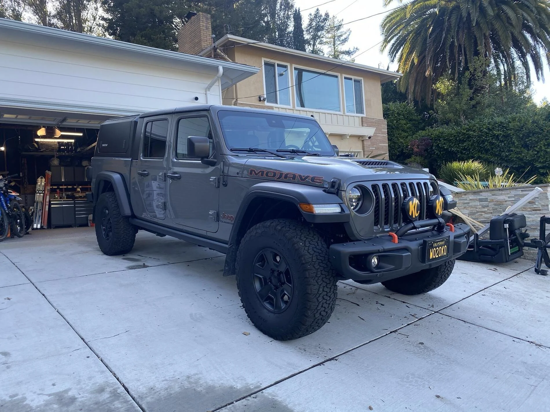

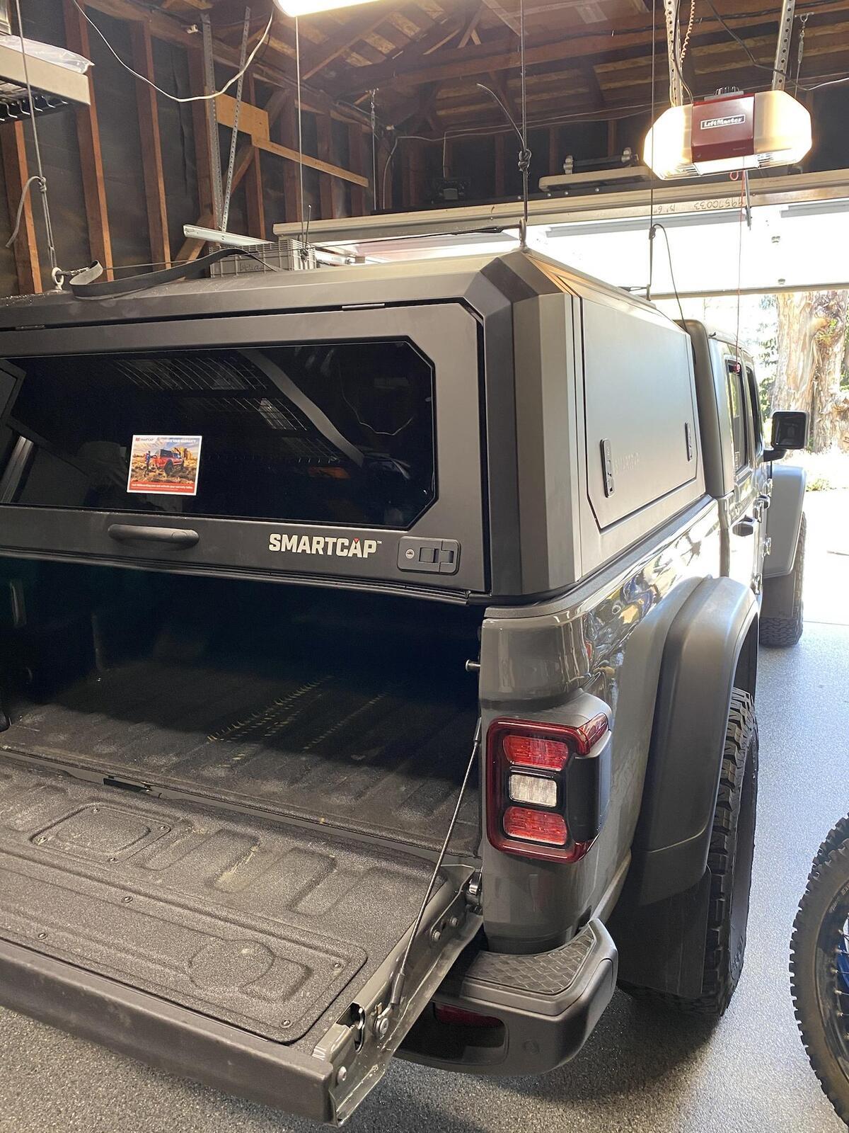

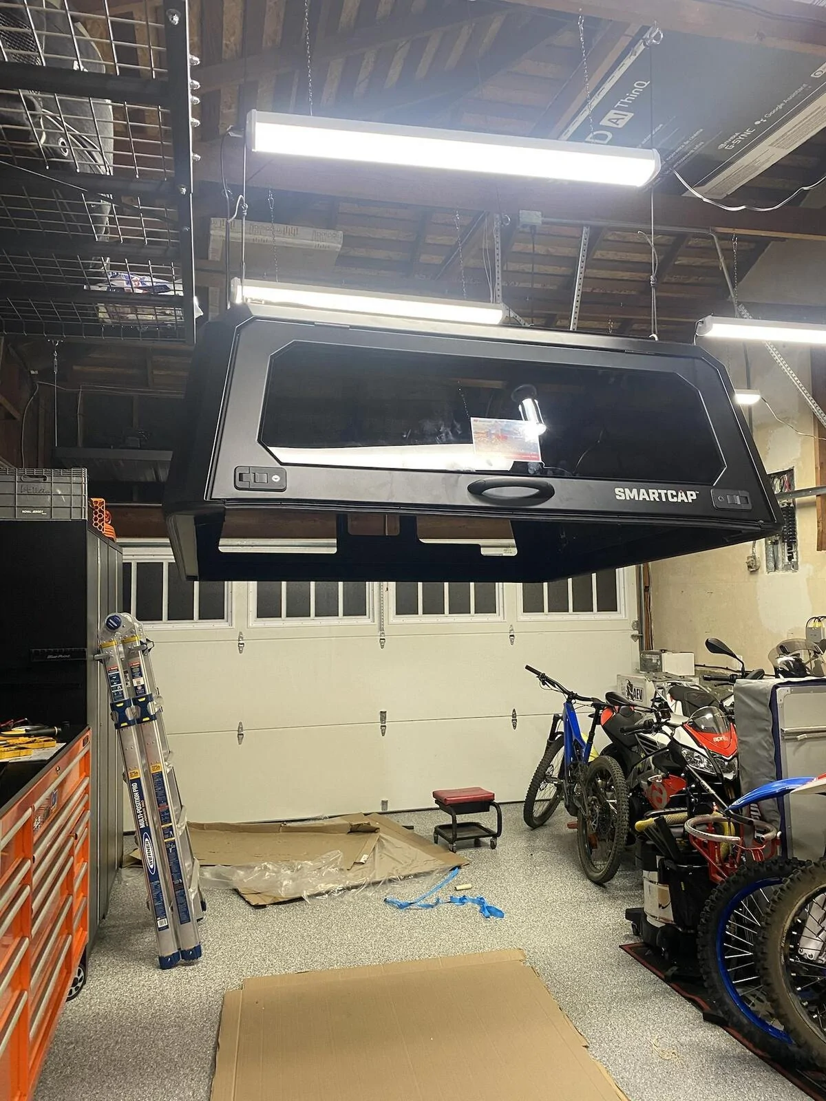

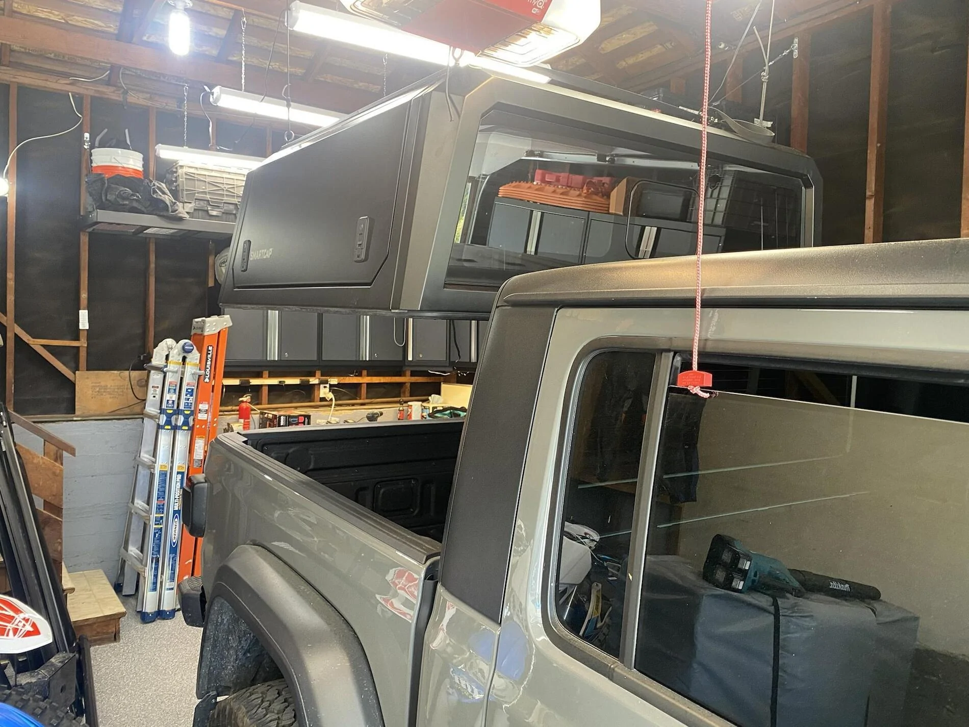

Yesterdays project:
Jeep Gladiator RSI Smartcap fRg9vh9
I installed a Harken lift and it worked better than I had hoped, lifted the cap with some steel eyebolts and the included t-slot nuts. Setting the cap down with one person was super easy.
Jeep Gladiator RSI Smartcap PnFM6Pj
Jeep Gladiator RSI Smartcap NiCMKk9
Jeep Gladiator RSI Smartcap 6u5ZLiL
Jeep Gladiator RSI Smartcap Cvf6iJZ
Jeep Gladiator RSI Smartcap 1bda2SF

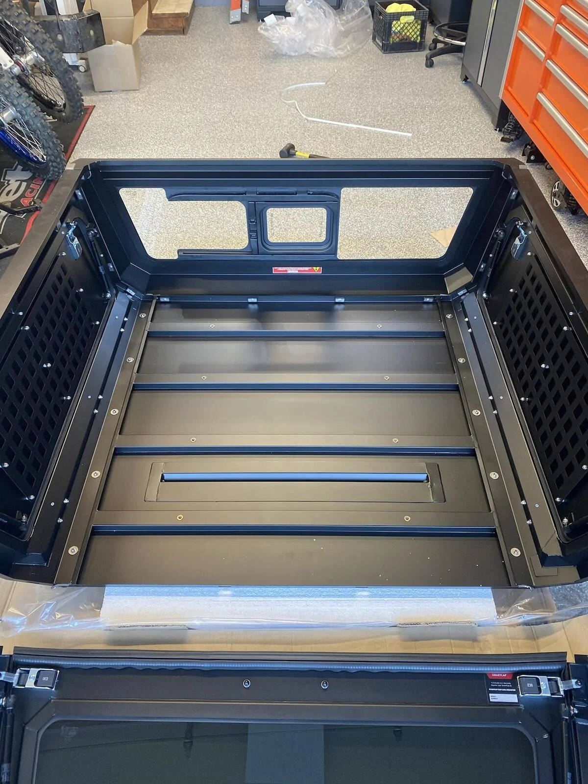

I still need to shim the rear up some, the gasket on the rear is still dragging too much. Looking around I think I'll just cut up some old HD moto tubes and see if those shim it enough. No issues at all with packaging/assembly, it went together as well as could be expected and I'm really happy with the results!

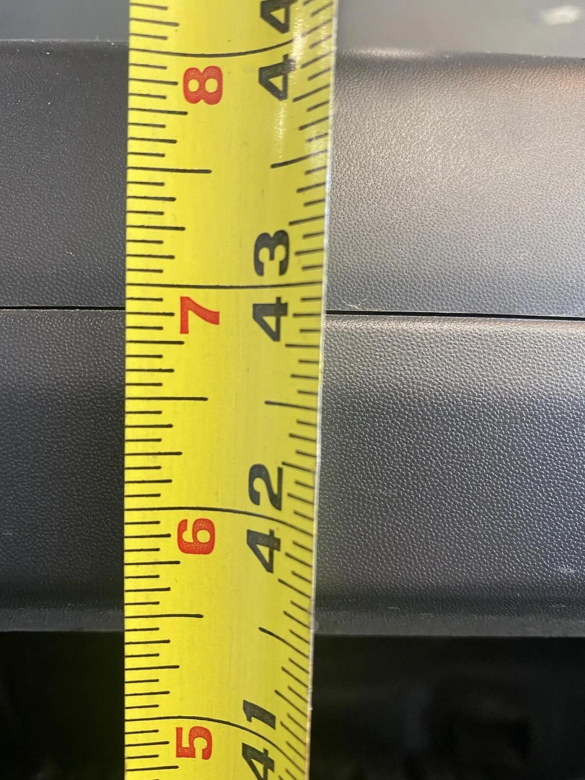

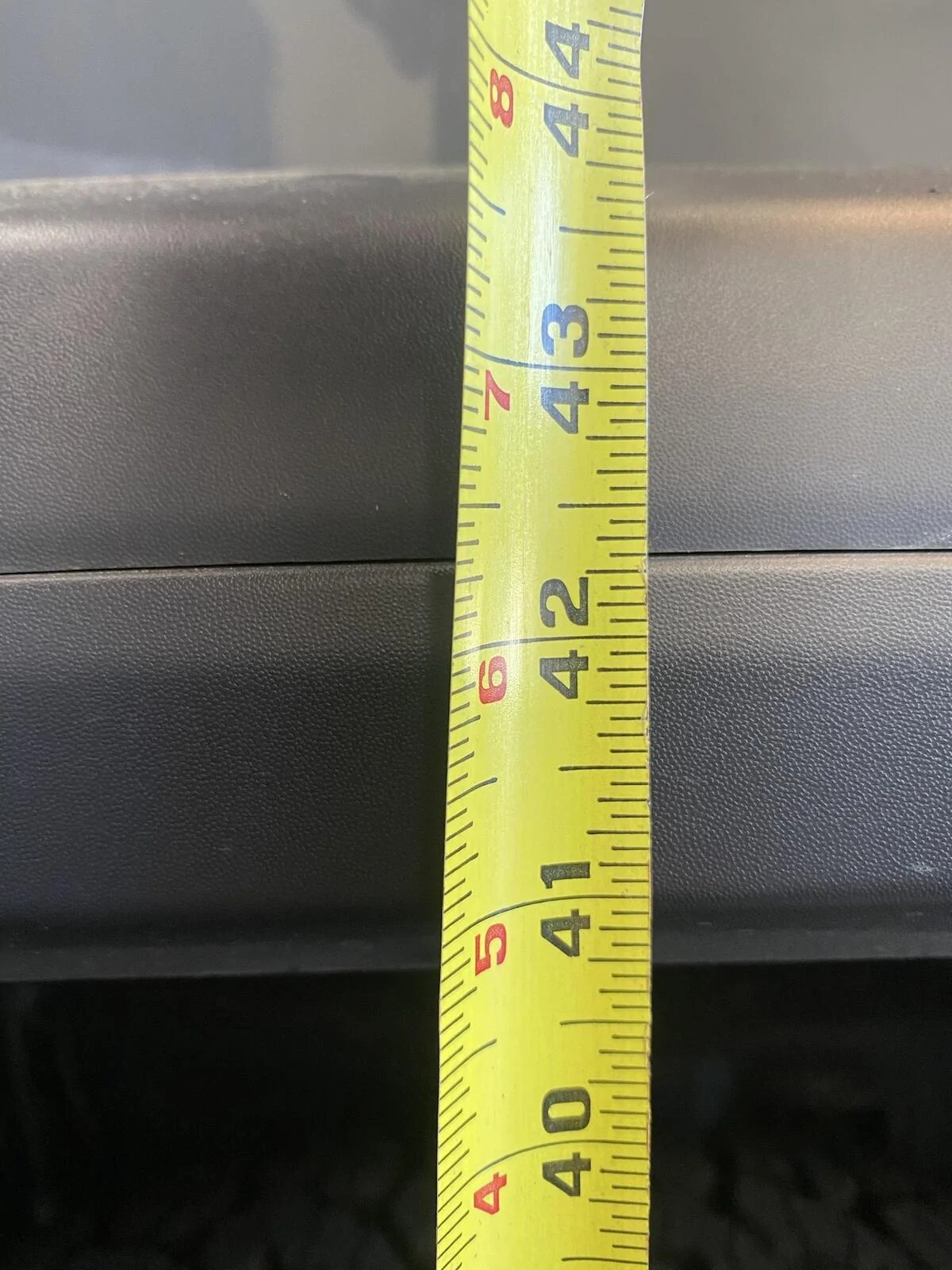

I lost about 1/2" with the new static load:
Jeep Gladiator RSI Smartcap 2tJtRdo
Jeep Gladiator RSI Smartcap U45dmaL
