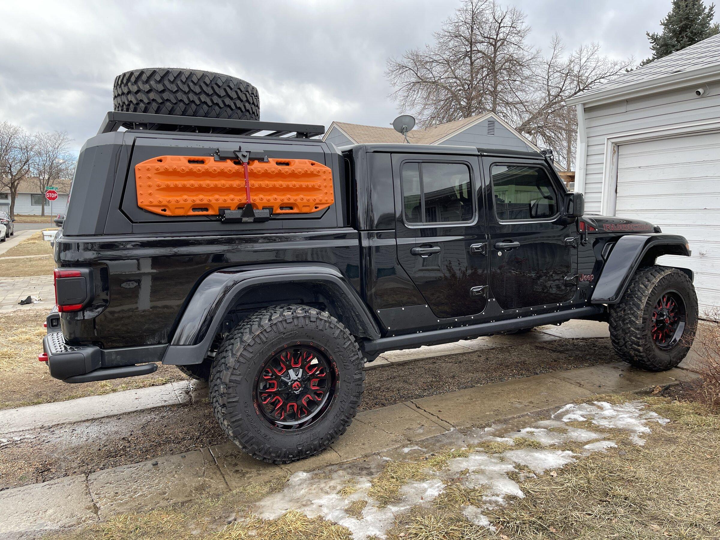

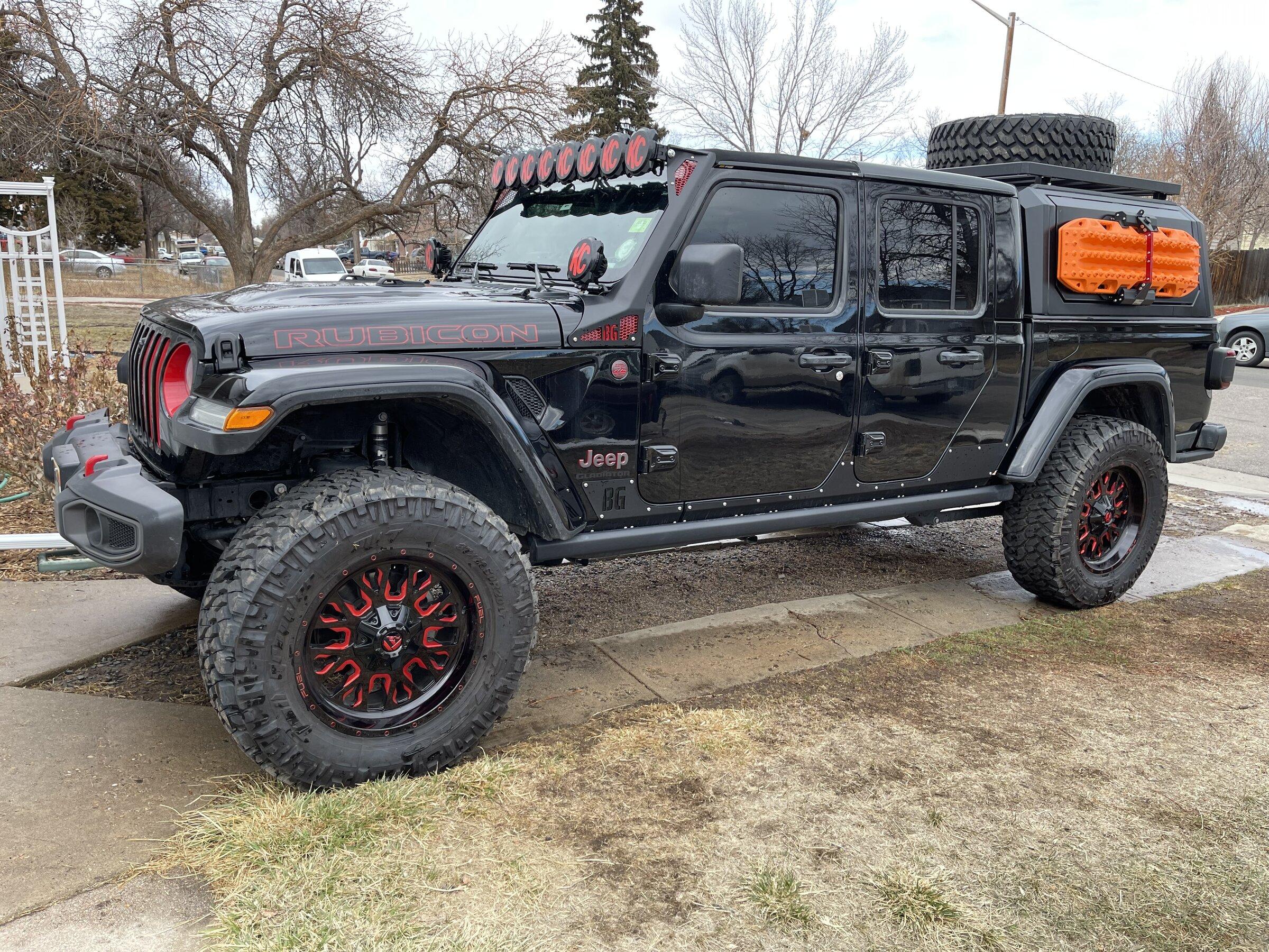

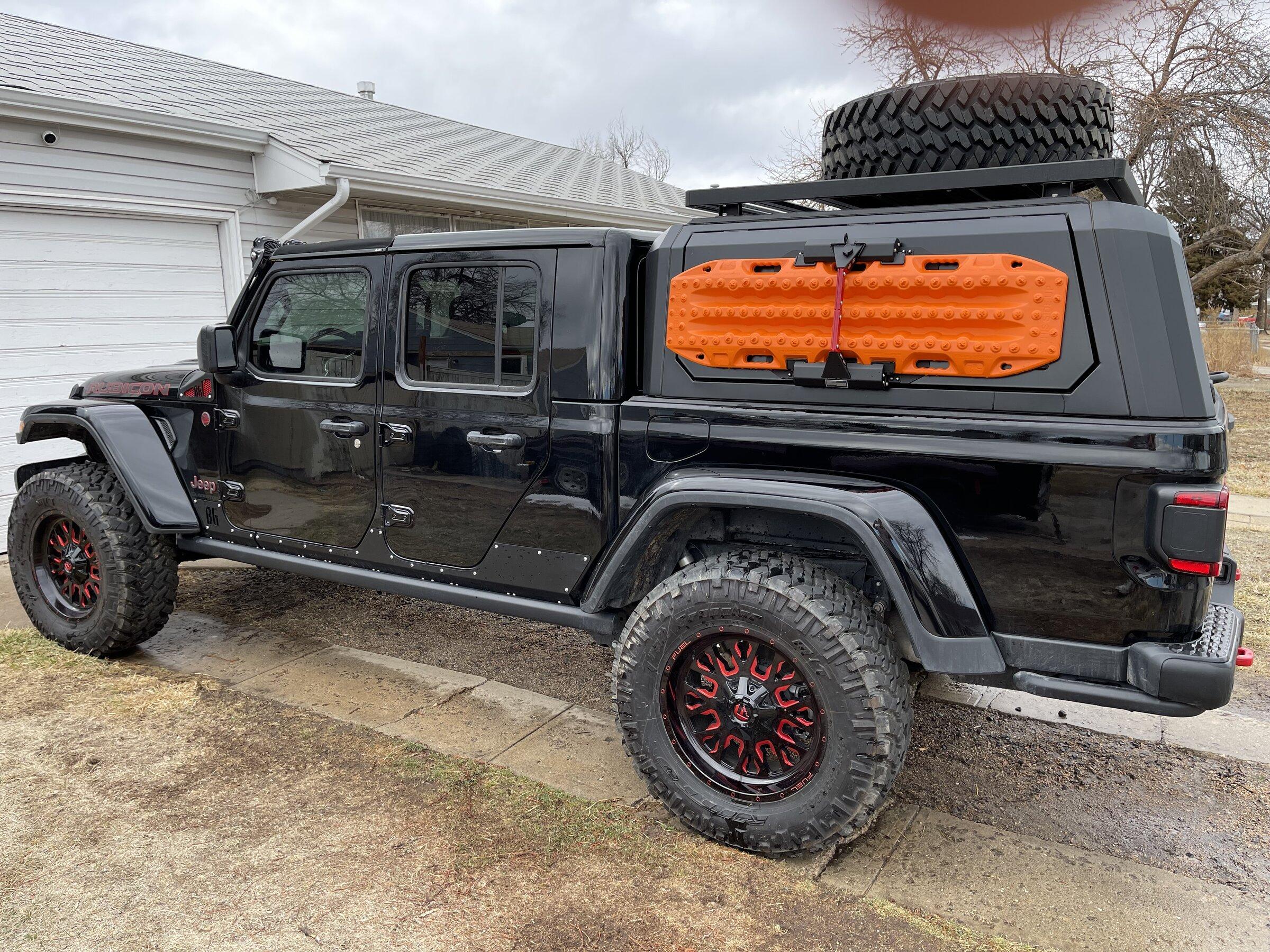

Anyone mount maxtrax on the side door using the expedition essentials mount like this:
I'm curious if you you still have access to the hinges and which gas struts upgraded to?

I did, I have an EVO-A RSI Smartcap so it’s not boxy like the Alum-cab they use in the demo which has more room to mount it higher. On the RSI it does cover the hinges with the boards in the mount. I don’t use the gullwing doors so it hasn’t been an issue. I mounted it with Riv nuts. Had to use carbide tipped bits to get through both layers of steel. Installed 8 per side. I purchased two 2-board mounts.
i didn’t upgrade the struts but I think in that video it says he used 120lb Gruden struts on his alum-cab. Not sure if they would fit RSI or not?

pix?
Deleted member 28696
I ended up removing the tire from the top awhile ago. Shows the Maxtrax Mounts installed. One set per side 2-board mount. The mounts won’t work with Maxtrax extreme boards. I installed them over a weekend. Utilized my RSI rack & bungee cords to center the mount & mark it for drilling etc, acted as extra hands so I didn’t need an assist.
