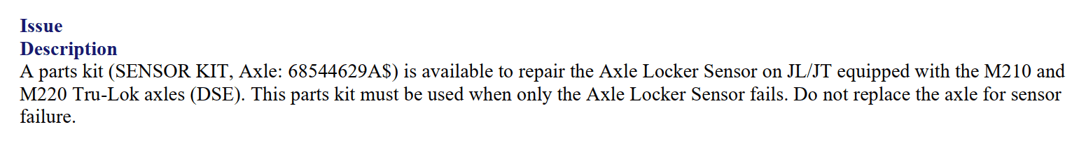

I have a TSB telling dealerships that the part is available, and I believe it has the part number on it, and saying don't replace the whole thing, etc.

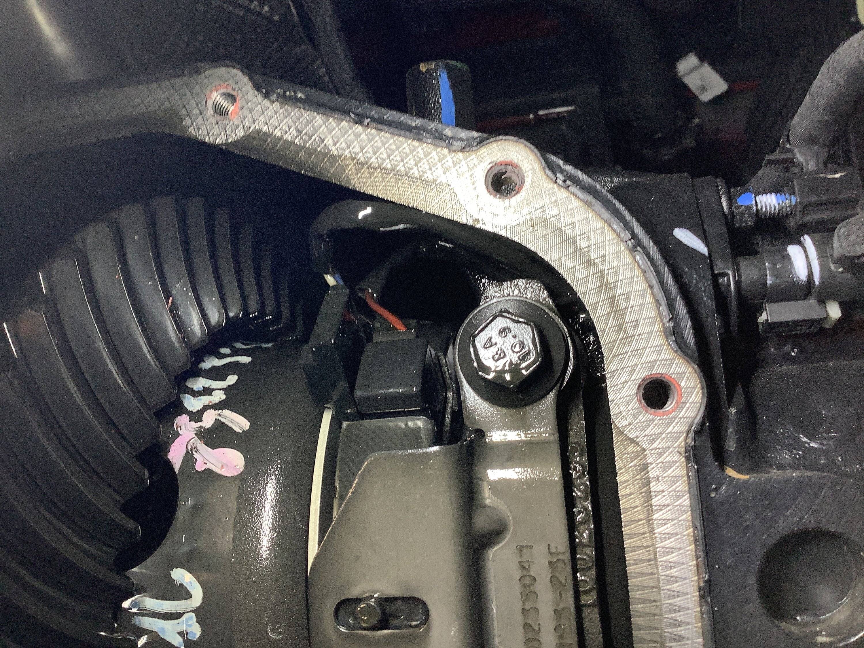

Sensor just went on Wifey’s JT.
what a surprise, pulling trailer on a hot day.
40,514
54,050

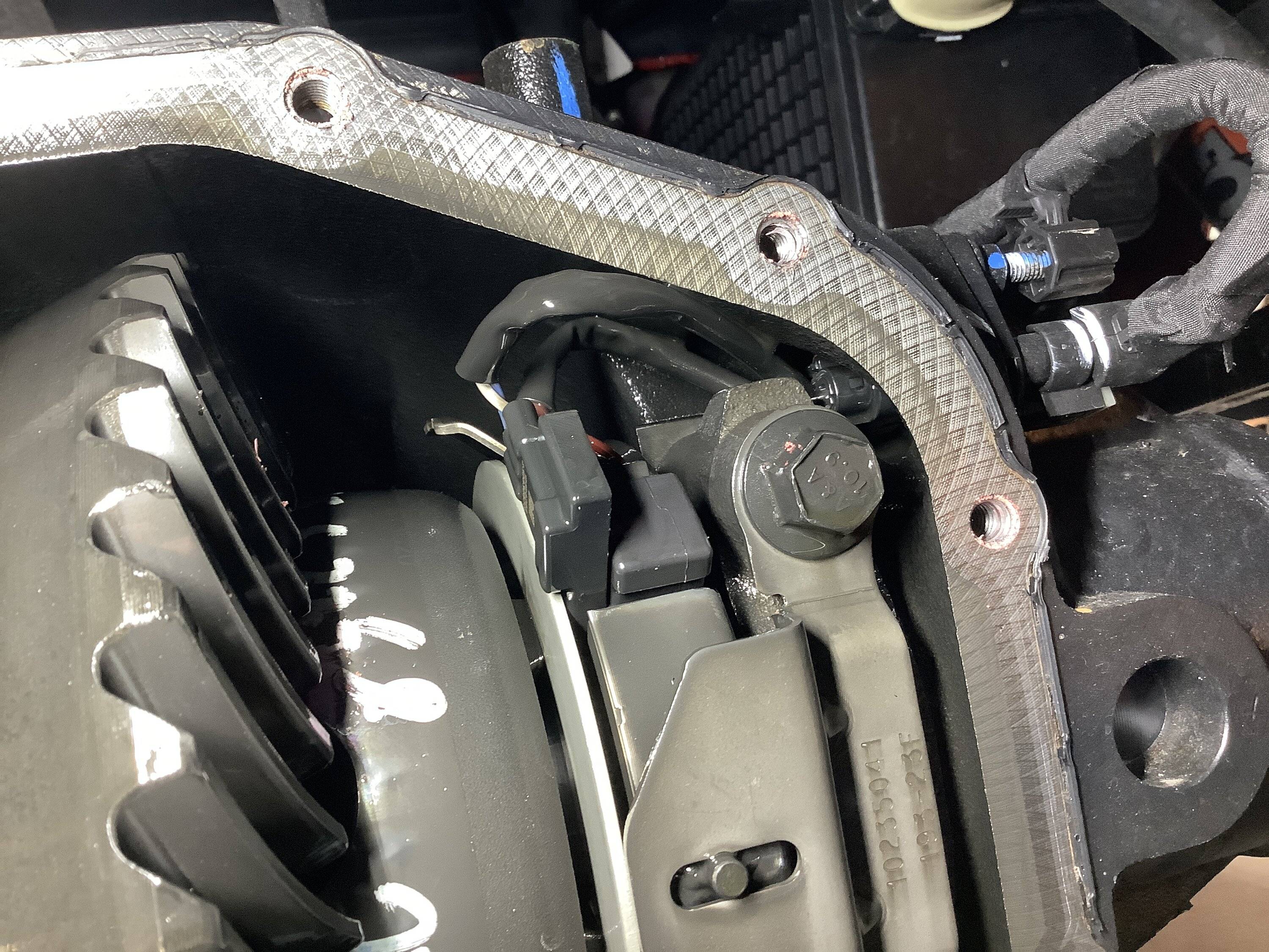

Just pulled mine apart to do this and surprise, the design changed. Buttoned her back up and my Saturday is a bit freer now! Anybody need some potting compound? :like:

I know this is an older thread but maybe someone can benefit from what I've found, that others reported on the part now is available. Locker sensor kit
