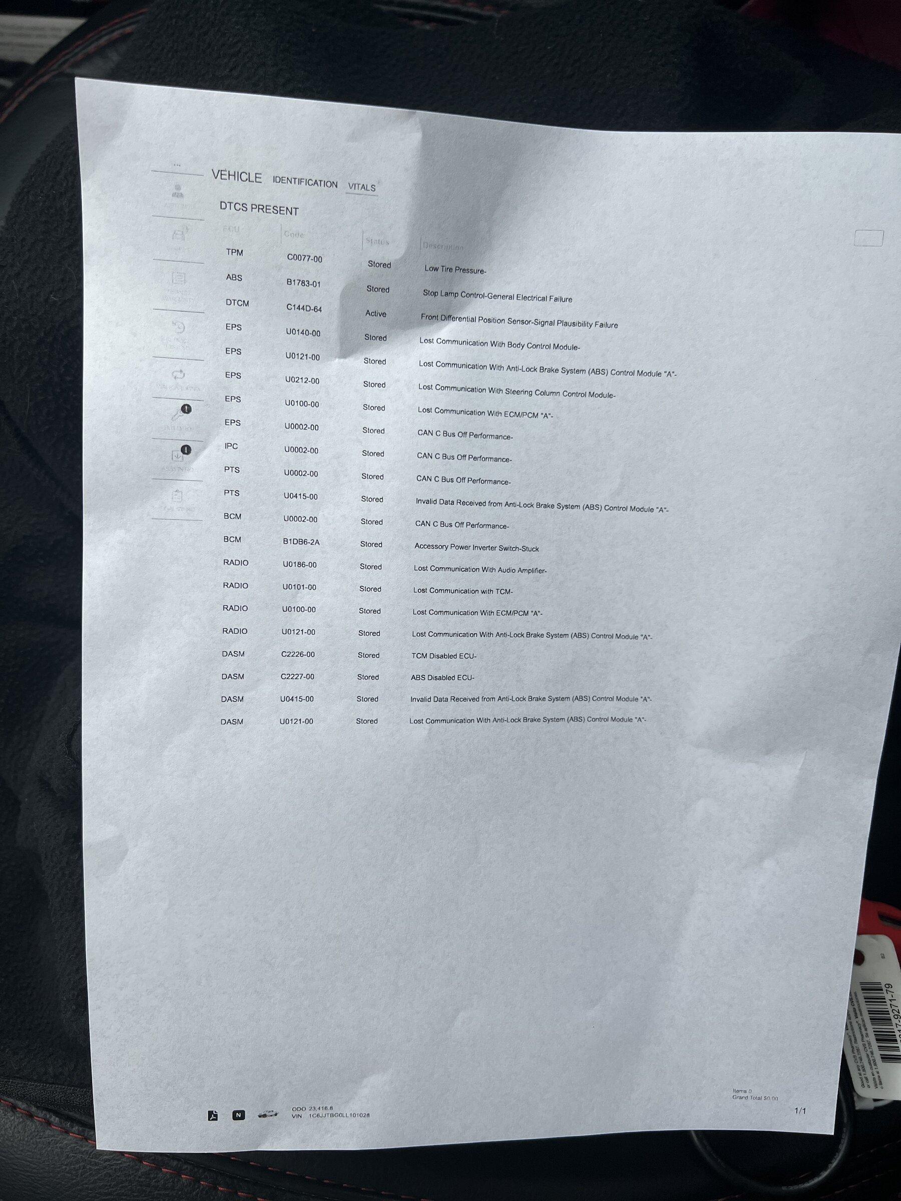

Hi jeepers,
I got into the same issue to this topic today. My issue is the front and rear lockers button flashing. I went to the dealership of Jeep today and got the scanner. It showed up that I got 21 error codes. However, one of them was about the front position sensor. What can I do to fix the issue? Also, is it a need to fix all codes ?
