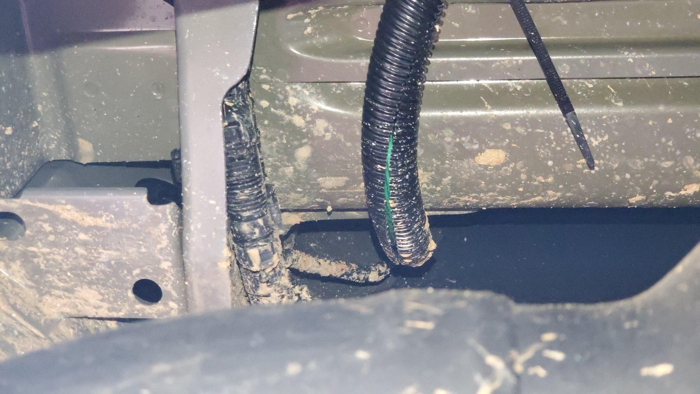

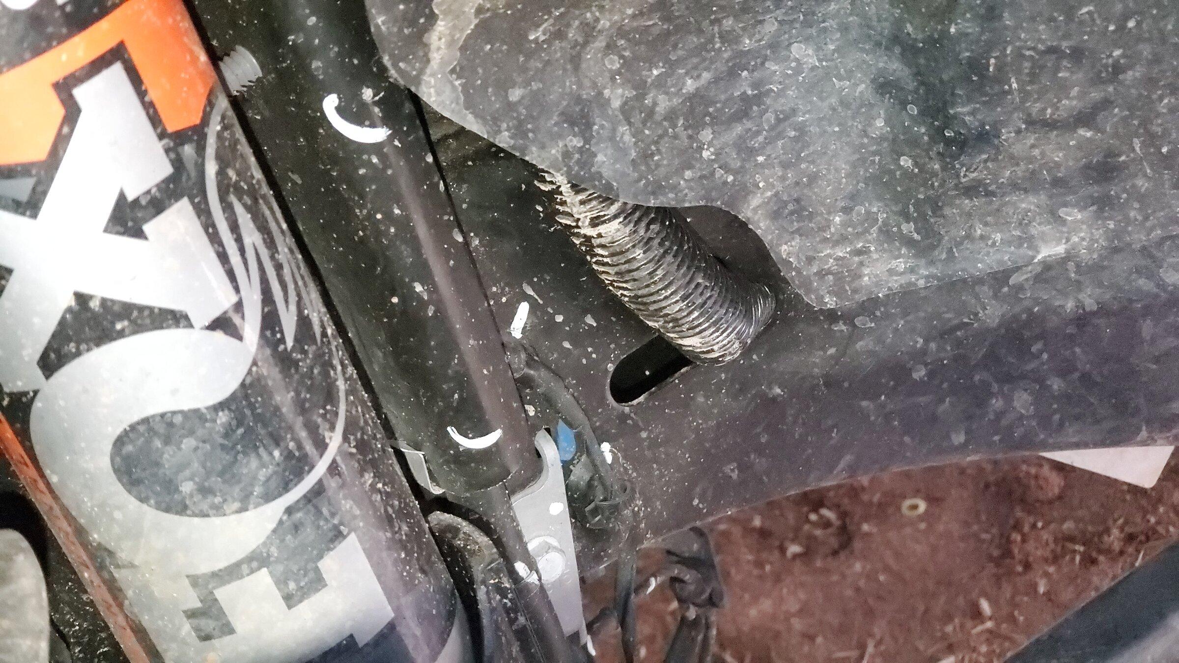

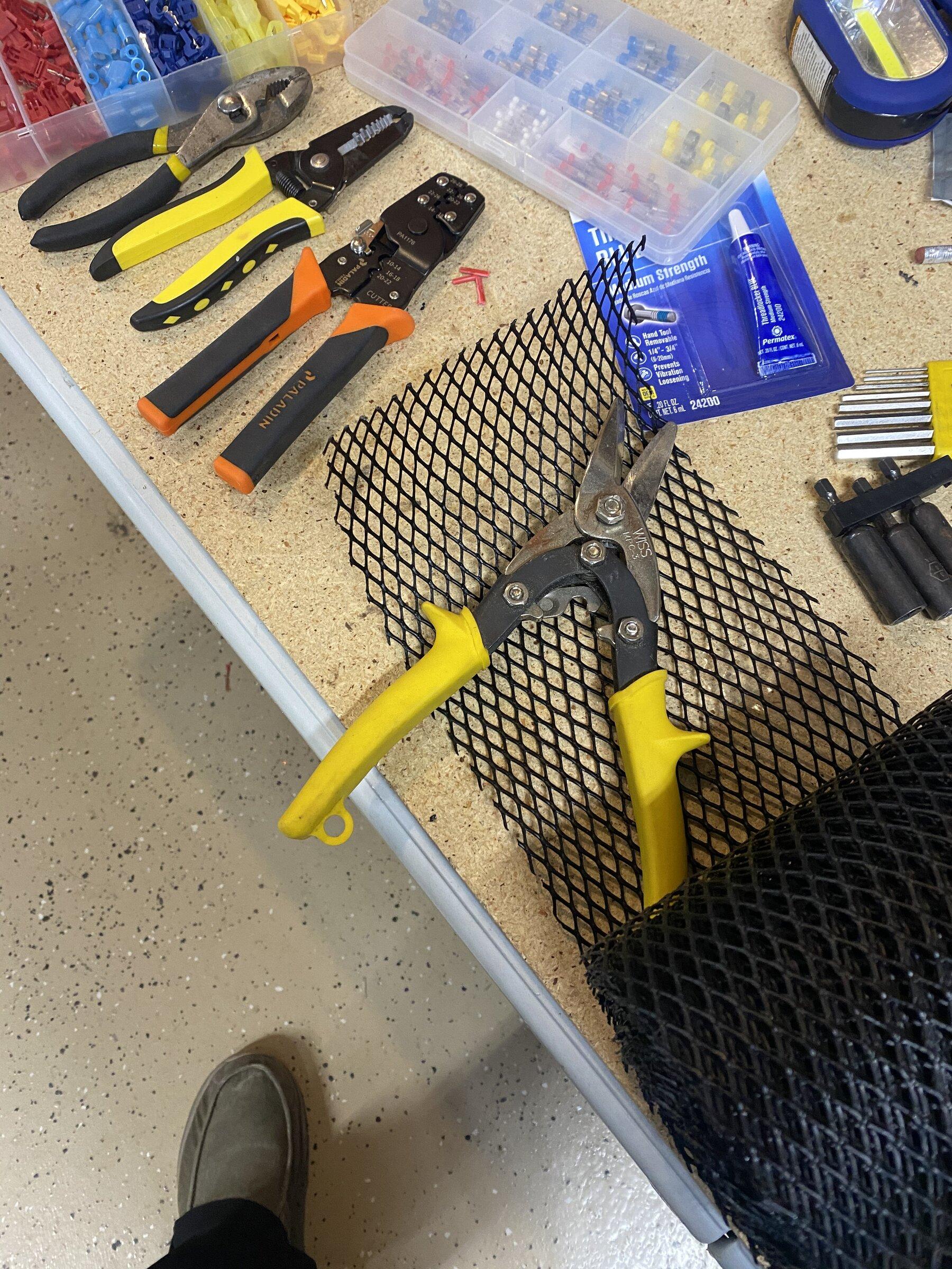

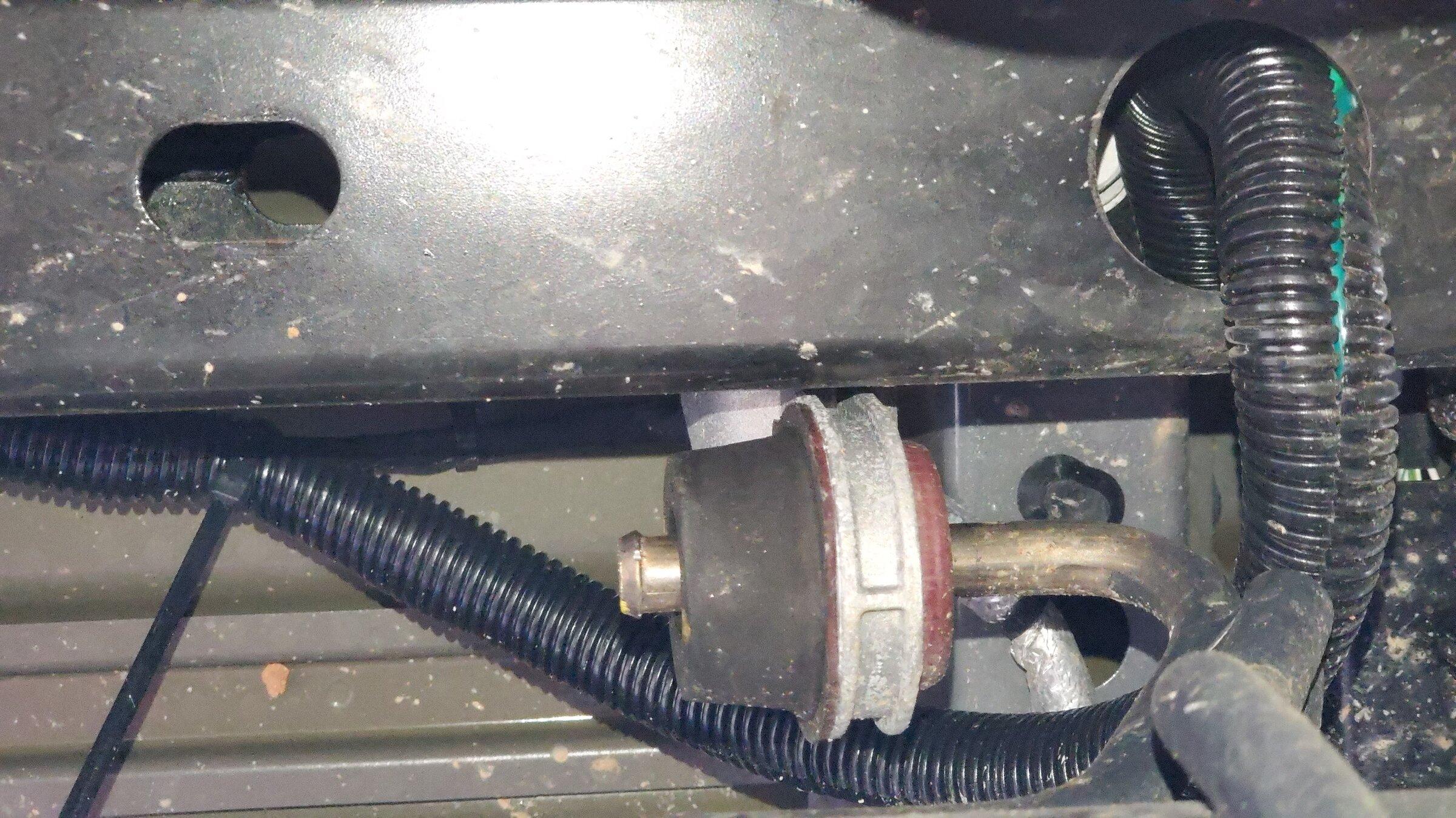

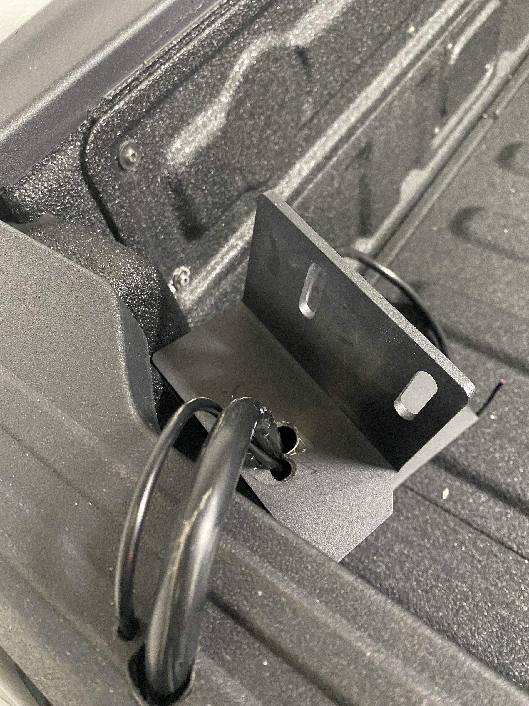

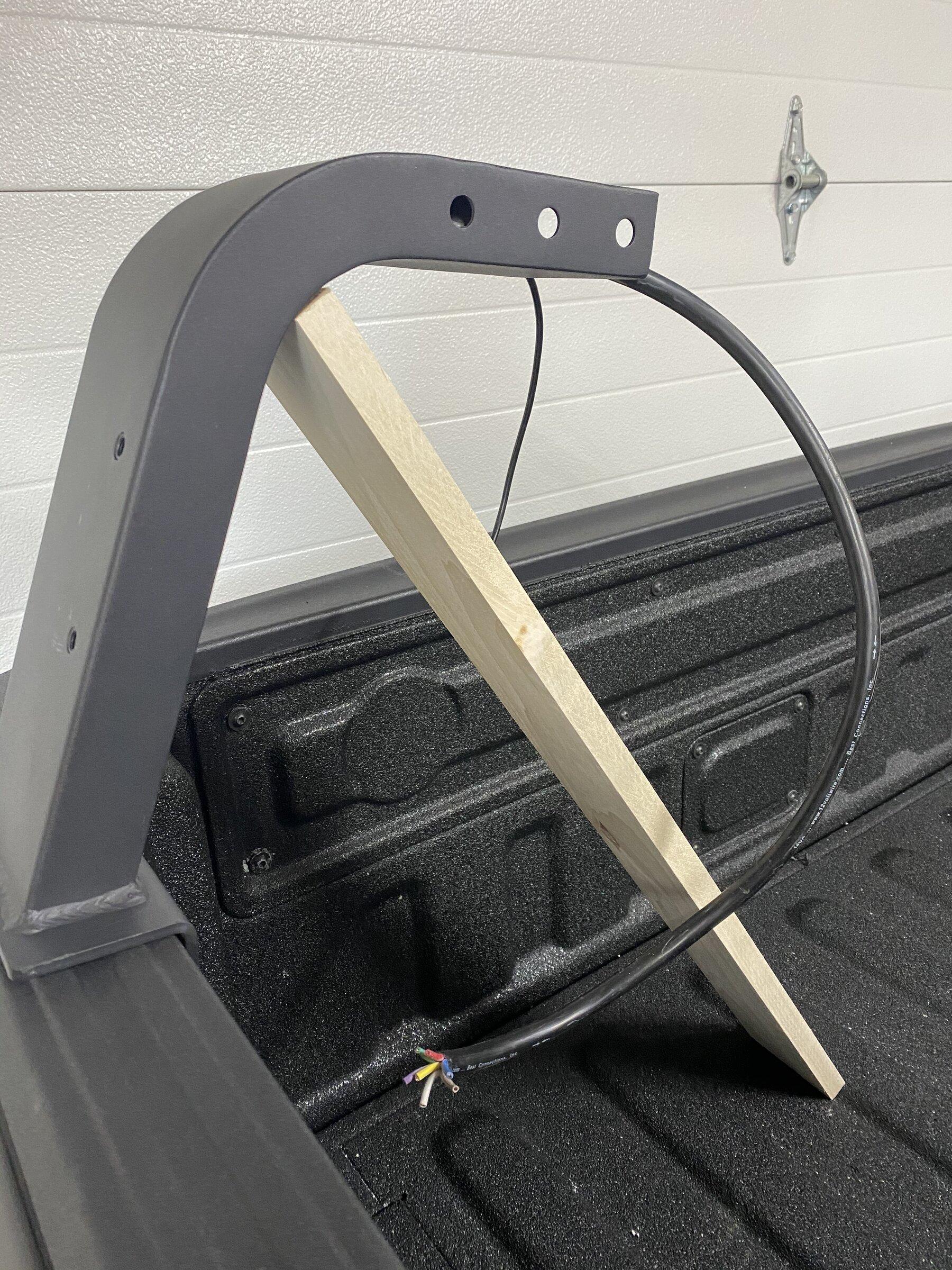

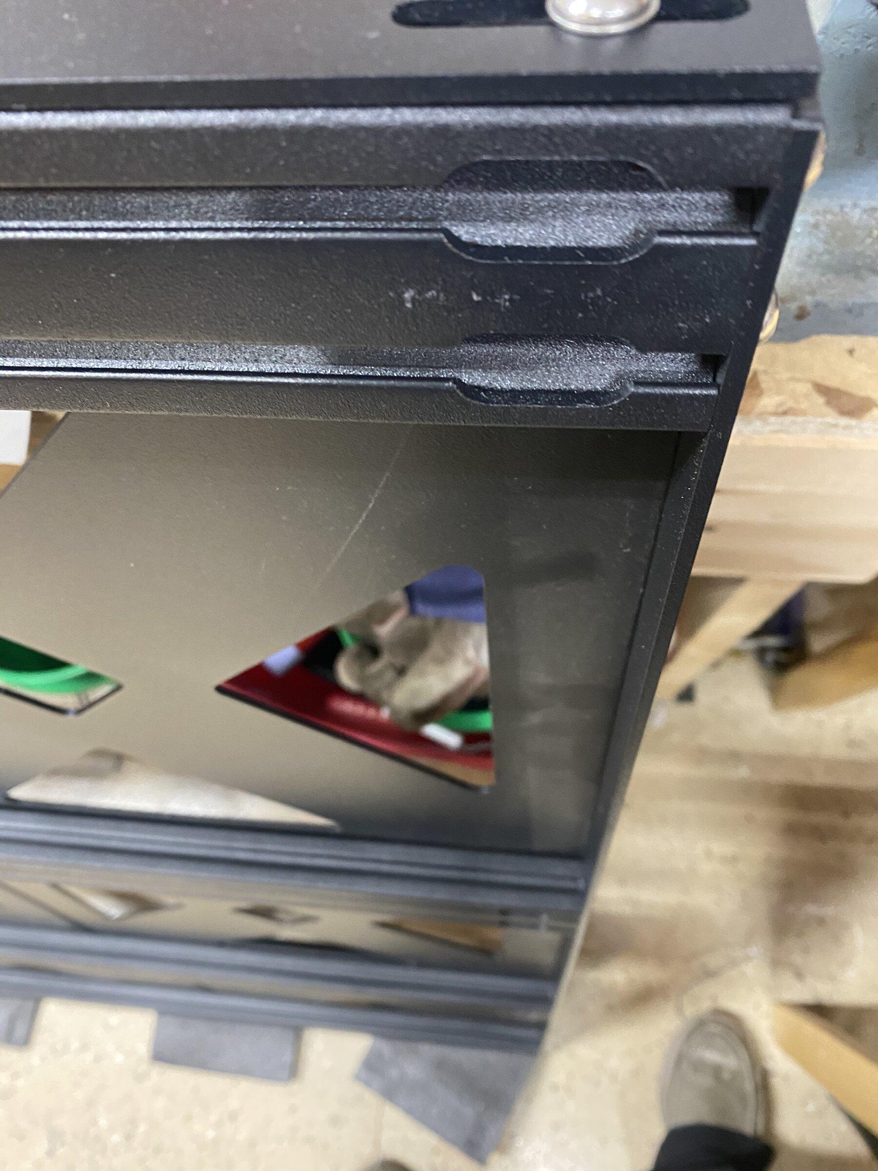

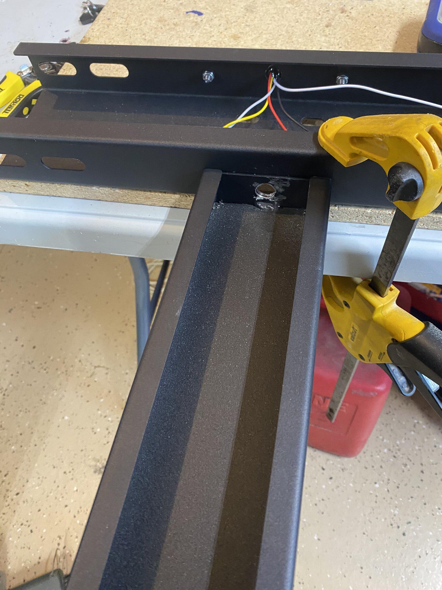

Here’s a few pics of my progress. I went with the Westin rack and JCOffroad overland basket- both work great together and perfect for what we are using them for. I ran HD trailer cable from battery area down through some of the frame tube and some just same route as other stuff that is there from factory, and up inside the bed wall to come out the top and directly into the rack tube so all is completely hidden. Notice the channels on the bottom of the basket frame pieces that allow sliding nuts to be used to mount to rack. Rubber spacers are just slices of reinforced automotive rubber hose. And plastic gutter shield tucks everything up and inside the cross tubes of the rack. All goes to AuxBeam controller. I’ll post a couple more tomorrow.

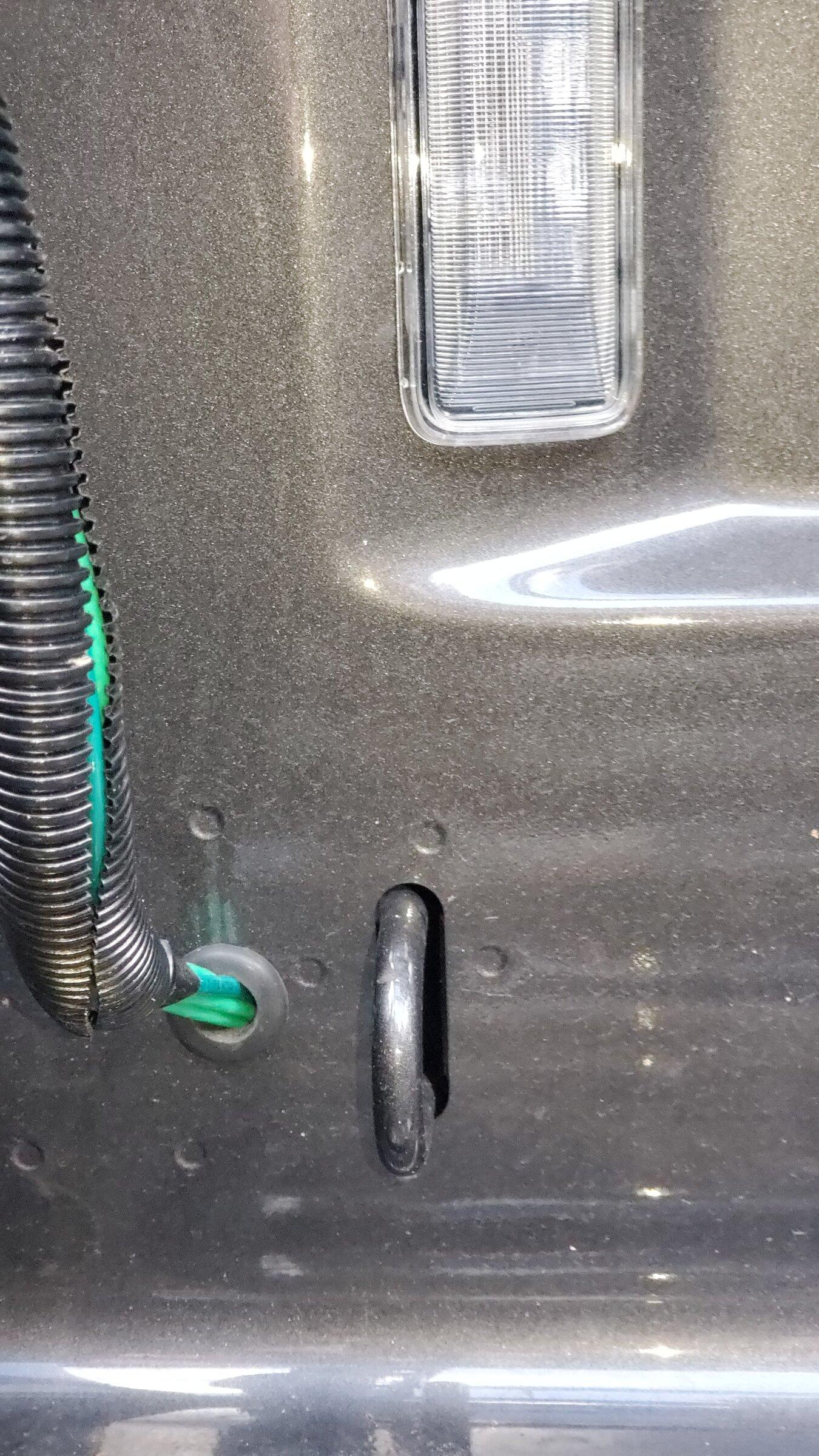

Hey all, newbie here, first time Jeep/truck owner. We bought our first Gladiator for our new business, and are setting up the rack with lights and white/amber emergency lights in back. Any special route to run the wiring to get back there? Through the cab and under the seats/carpet? Under the chassis/through the main frame beams maybe? All lighting will be controlled by an AuxBeam switch panel. Thanks!
wired my gmrs wire through the passenger upper trim and through the rear pressure vent, sliced the vent to allow it to fall around the wire and not allow things to crawl in. With the radio being inside the cab and the antenna requiring outside mounting, seemed like a good route and it worked well.

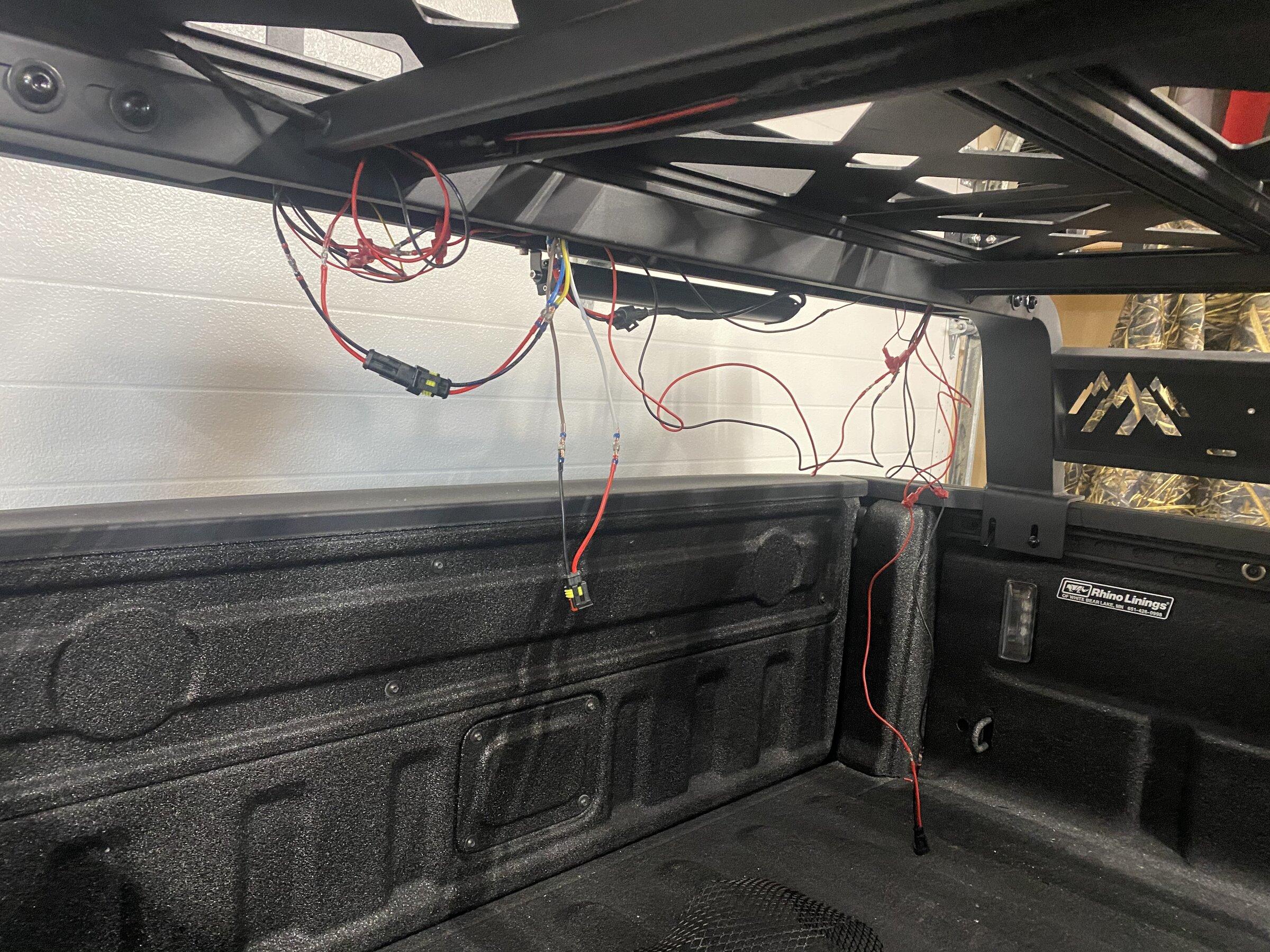

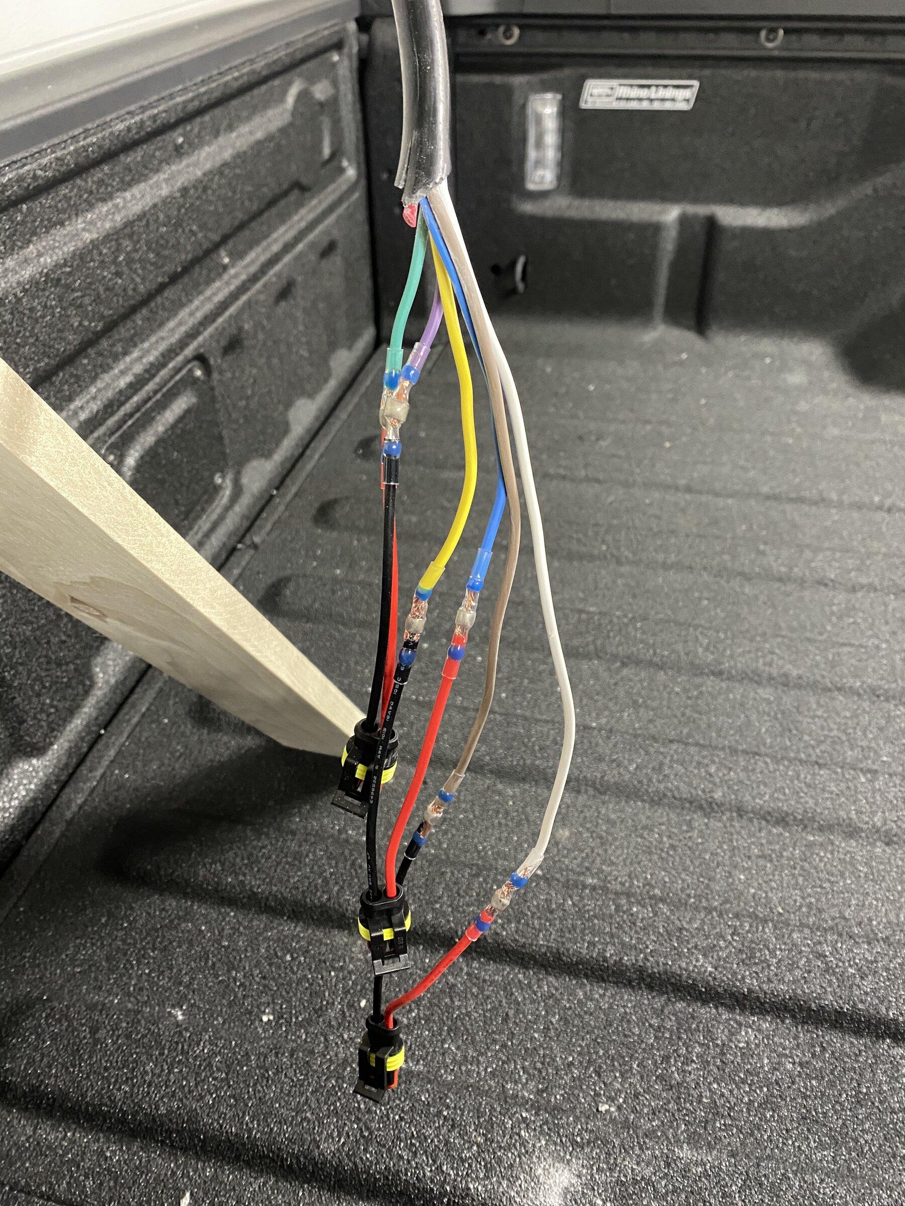

Okay finally done with all wiring and AuxBeam install. Man, once you get all wiring to box under the hood, it’s a snap to finish up. I still need to lower windshield a bit to pull control panel cord down and out of sights more.
Nice positive “click” on buttons, soft back lighting, sweet shut-off power switch that shuts down all lights with one click, top quality throughout (and I’m picky about that), everything is nice and tight, I love it. I didn’t go with the factory or aftermarket Aux switch setup because I love that open spot for receipts and such, and I like the AuxBeam control panel up on the dash where I don’t have to look down by the shift knob to operate it. And I left the first button blank as it is a 30amp switch and I’ll leave that in case I add something crazy.
Don’t hate on my one-handed wiring please! I’ll tidy things up once I’m out of the sling.
I can’t figure out how to remove the trim behind the back seats to access the vent. How’d you do it?

21 Gladiator-Willys /18 Wrangler JLU-Rubicon
Above the pocket, there is a rectangular panel that comes off using a trim tool. Behind that is a couple screws. Take those out and the. It’s just pop rivets holding it in. I didn’t take the whole panel out just made it so I could work behind it all. Let me know if you have more trouble.
