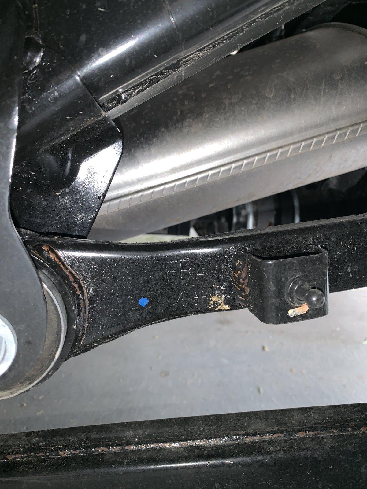

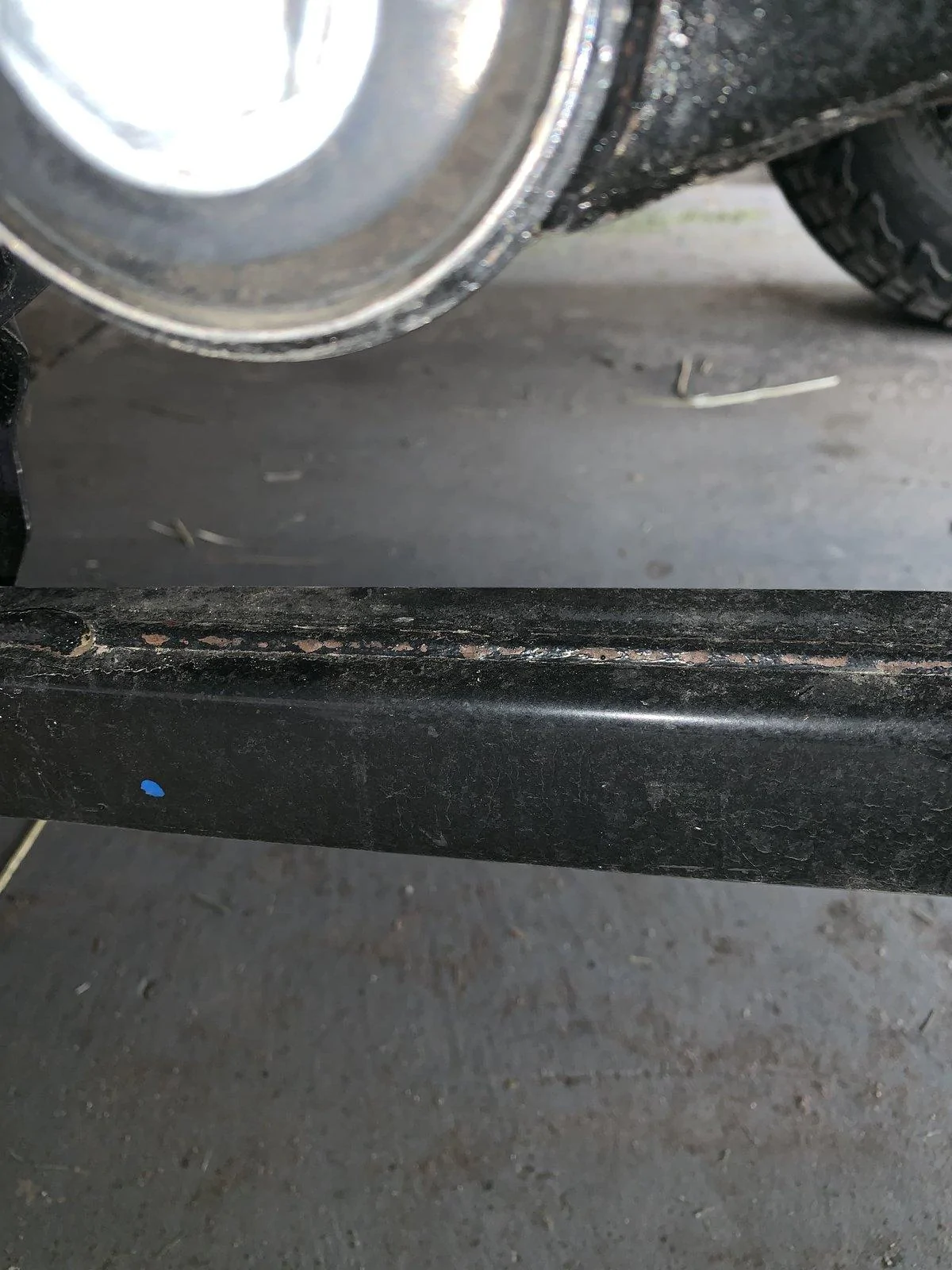

Anyone else seeing poor quality coating on your factory welds? It showed up like this with 48 miles on it...
Man, that sucks! Start spraying Fluid Film on it to stop the rust!
Yeah, that is slag leftover from the welding. E coating does not stick to it well. The actual welds themselves look pretty good though. Been a noted since the JL came out.

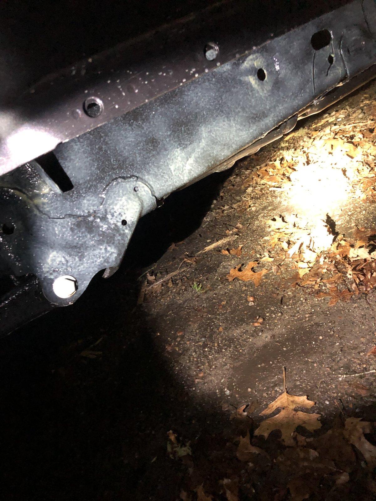

Just applied woolwax from the $100ish DIY kit that had (1 gallon in (4) bottles the spray gun with extension wand) hooked it up to my compressor ran it at 110PSI after I let the bottles sit at about 75 degrees for a few days. Outside temp 30 degrees. Only used a half gallon.
it was super easy I like how it was so thick that it barely made any overspray. The only thing that was hard was to get a perfectly even layer not that it matters.
Tip:Spray in the frame rail And add a lot of material with the top first then use the extension wand to spread it/add more for the inside. Sucks on the passenger side the fuel tank skid contraption makes it nearly impossible to coat.
I went much thicker than I suppose I have to. I did some testing with my marine trailer if you get it thick and shoot it with the hose the excess comes off a thin layer still stays. I guess we will see how well it works.
