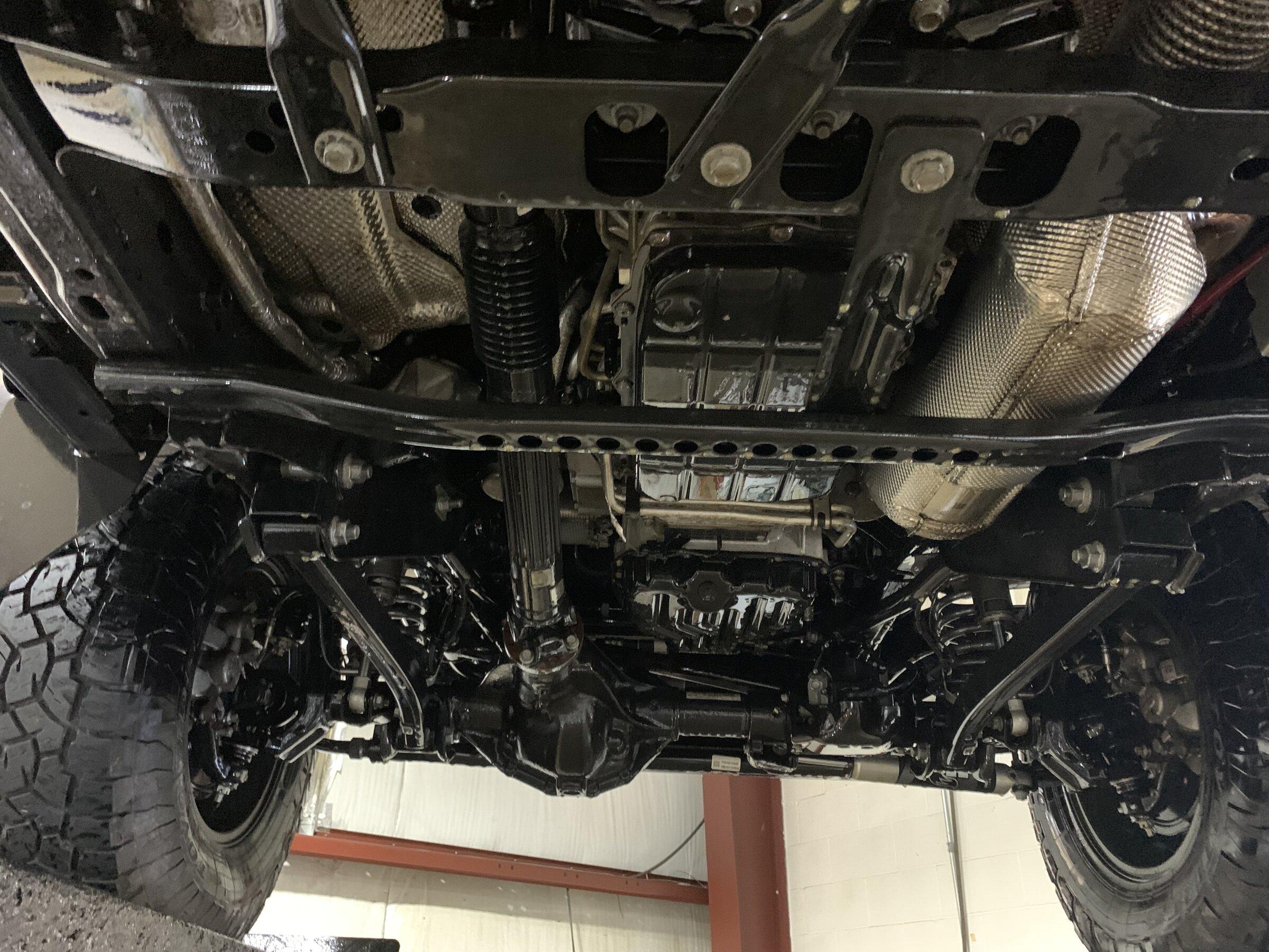

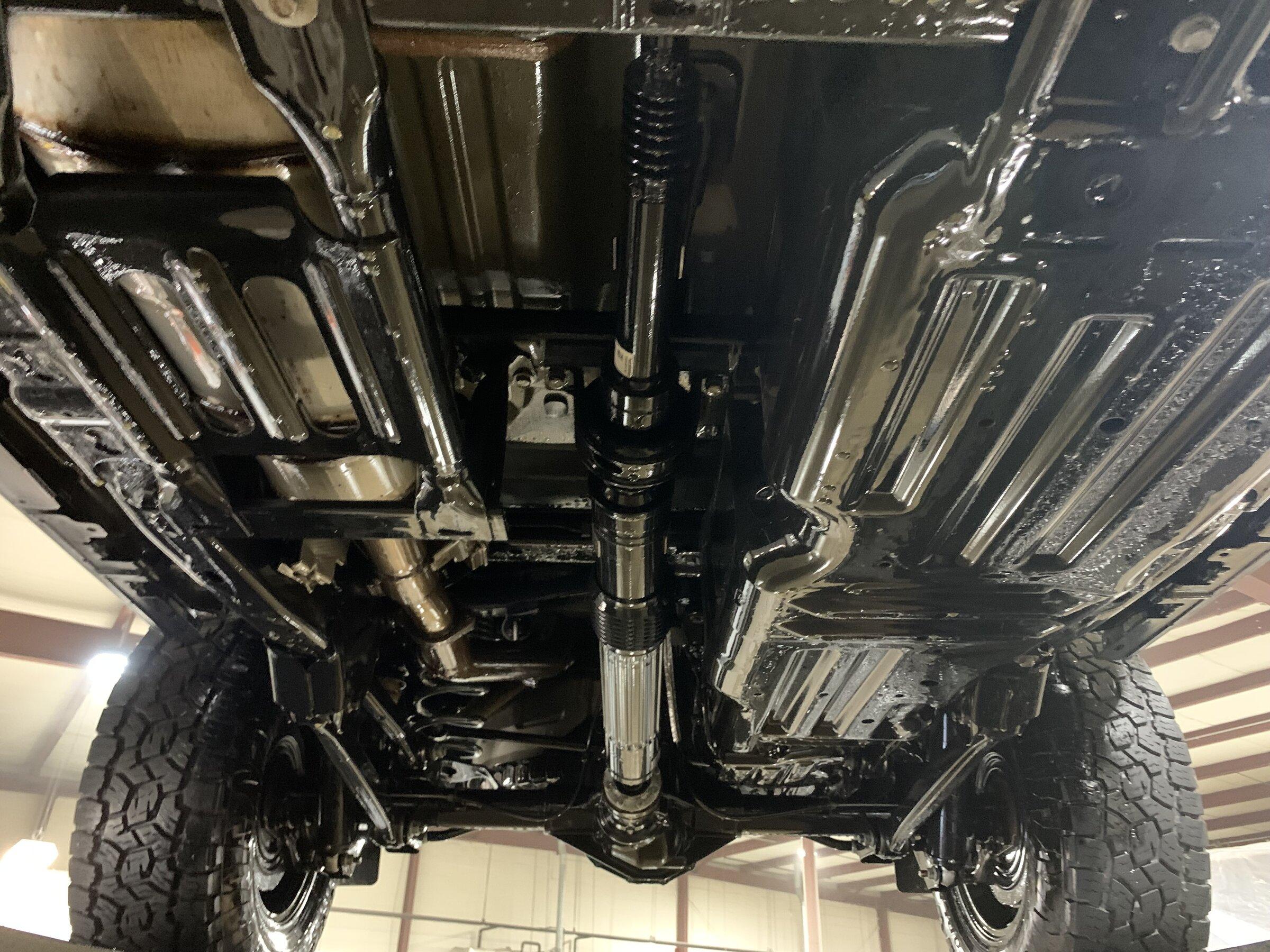

Two rounds of Krown. Ceramic applied (at home) to exterior once after hitting it with a mild cutting compound and polish. The truck has been through 2 Pocono winters, trip down and back to both FL and Texas, heading out west in June. Undercarriage shots are less than a week old, exterior is today at 25k miles. If you don't have a local Krown to apply it, fluid film is fantastic as well. Krown drills and sprays in all body cavities then plugs it but I've yet to have an untreated vehicle rust from body cavity out so at home with fluid film would be great. Stay away from "permanent" solutions. The stuff claiming rust prevention causes more problems than they are worth unless you can properly access and prep, as mentioned above Por-15 is incredible. Their clear sucks but the trusty standard black is amazing but you'll take a huge penalty down the road if prep isn't spot on.
