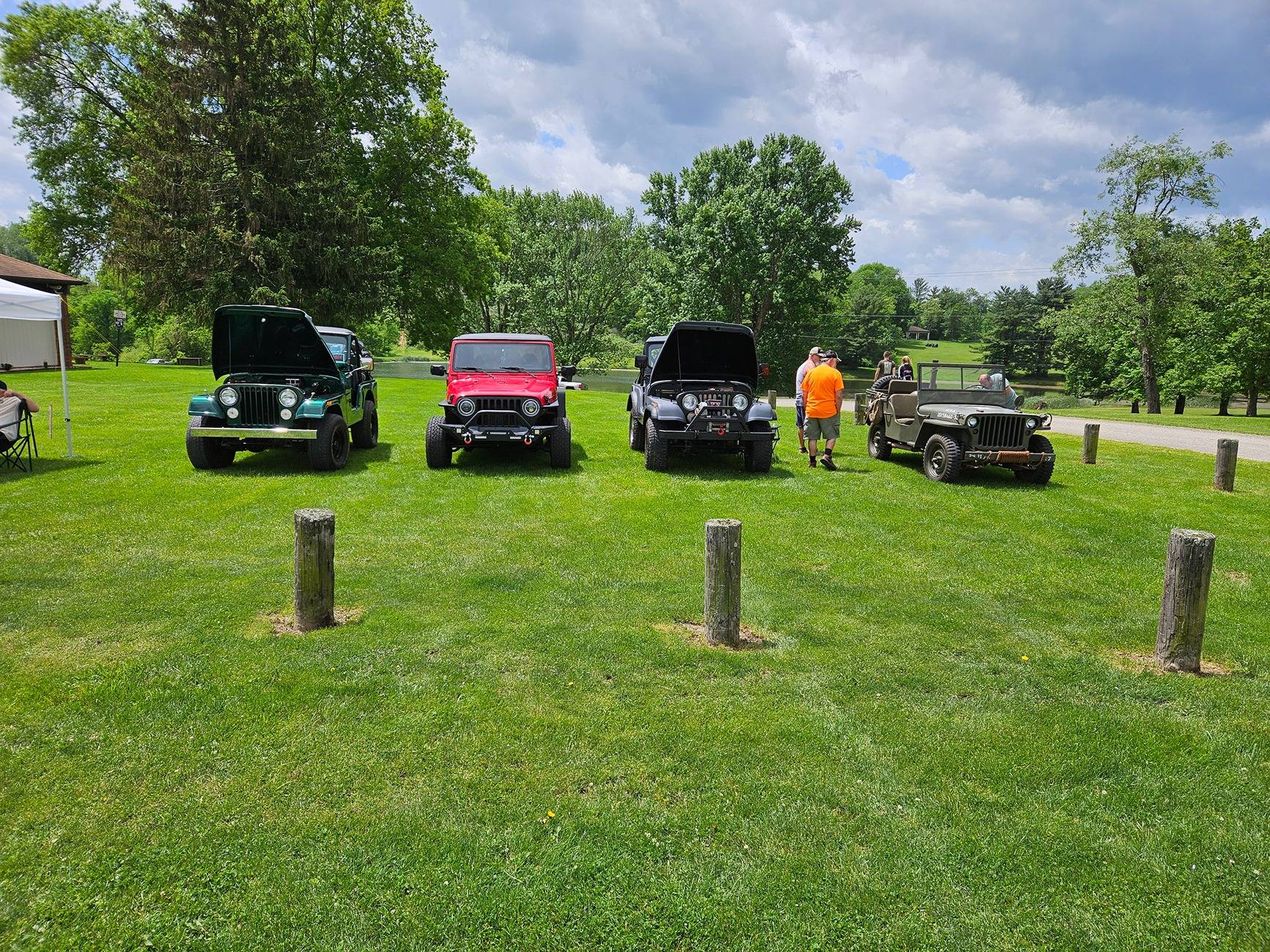

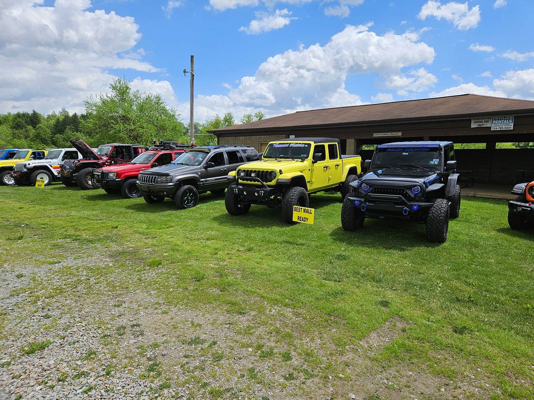

Went to the local Jeep Fest today. Didn't win the Gladiator class this year. Someone with a white Rubi with stripes and a winch and bumper won.

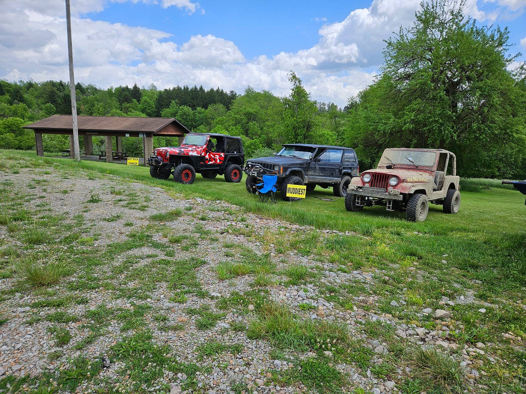

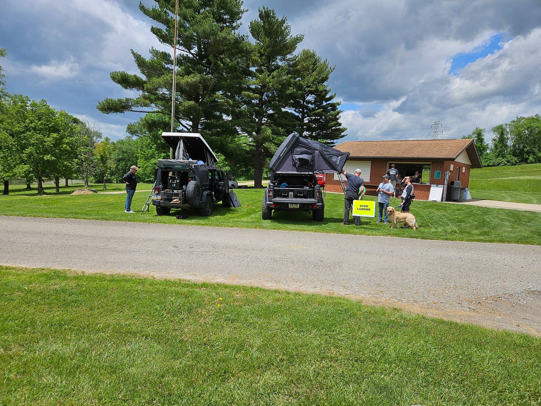

More pictures off today.

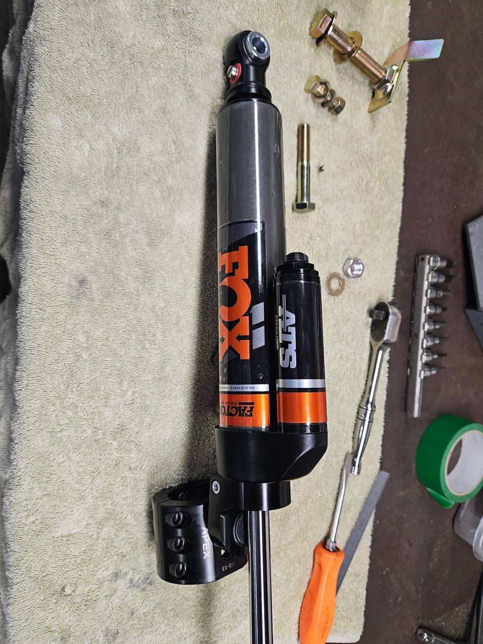

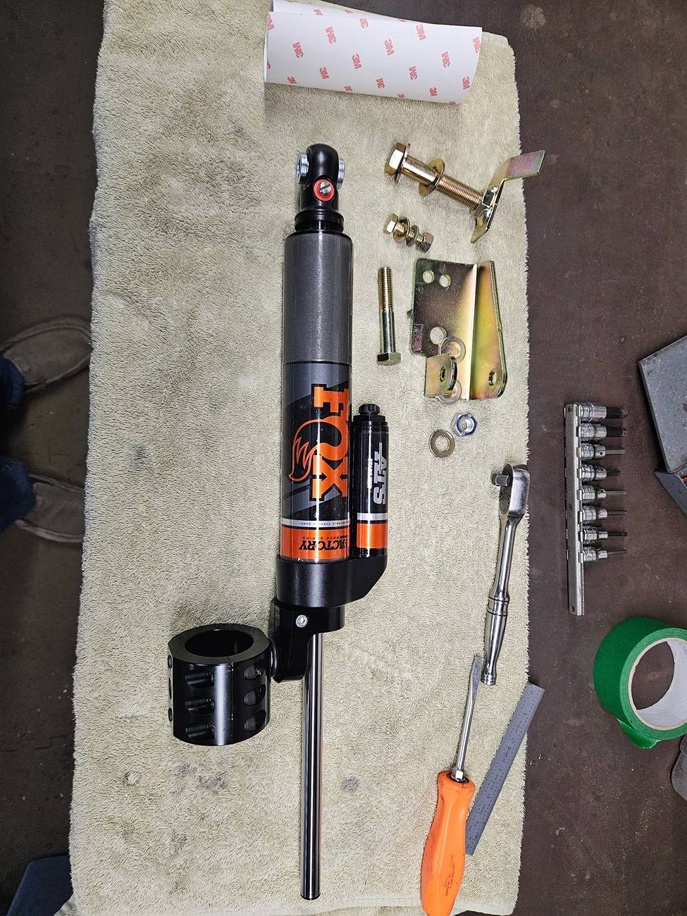

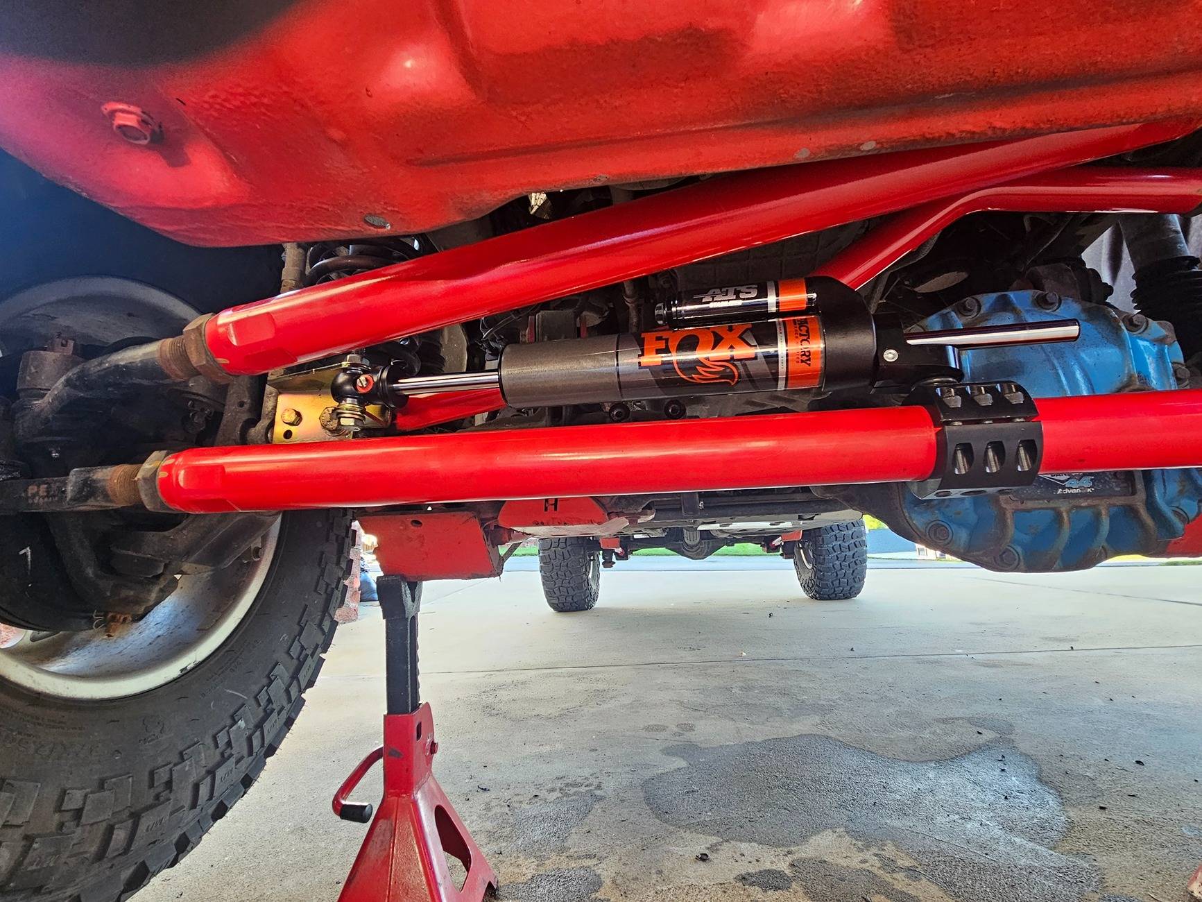

Installing the Fox ATS stabilizer this weekend.
Wrapped the body and reservoir with 3M clear vinyl to protect them from FOD.
Installed the Apex clamp on the stabilizer.
Jeep Gladiator Rusty PW Journal 20250523_190333
Jeep Gladiator Rusty PW Journal 20250523_190353

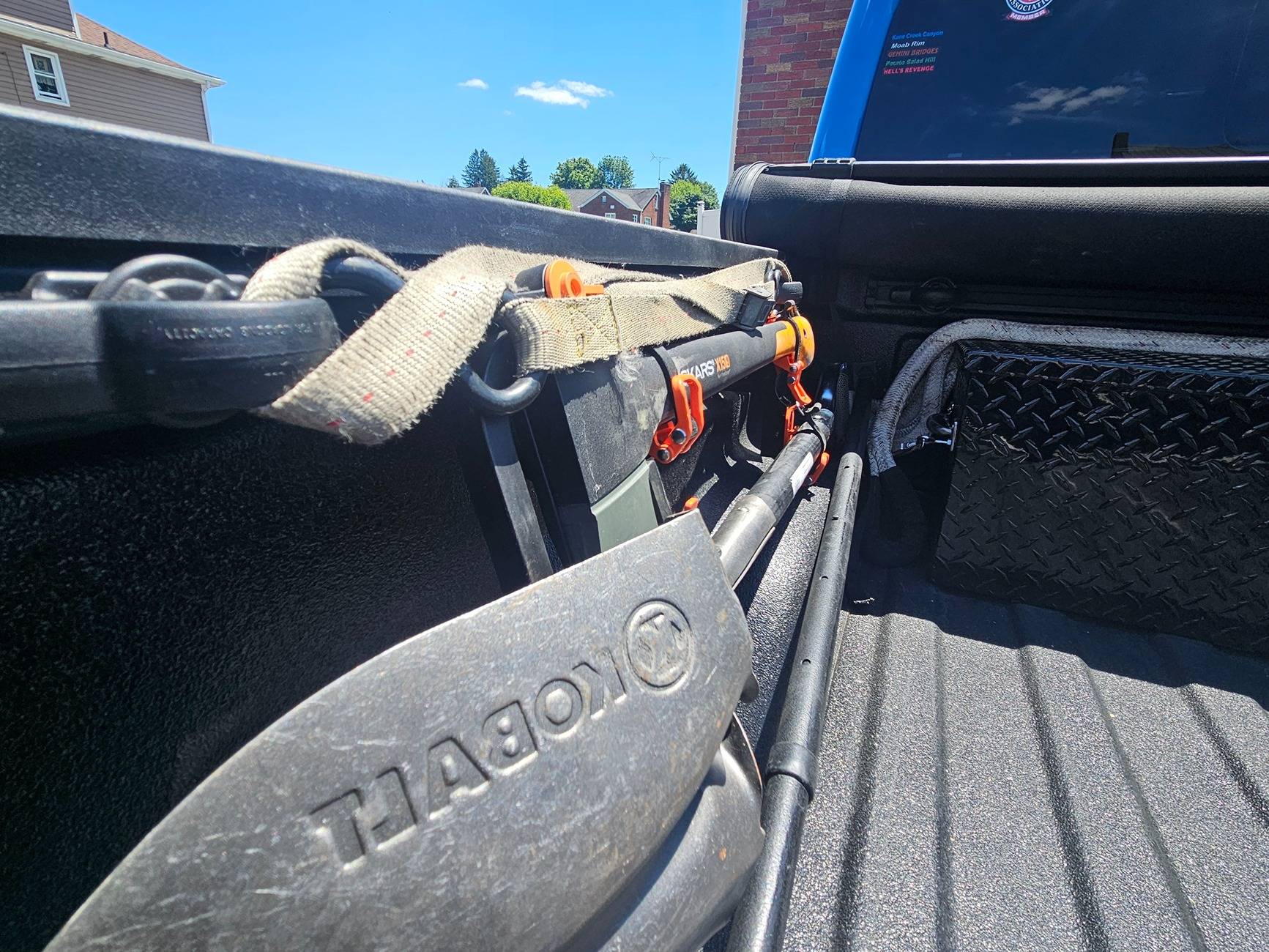

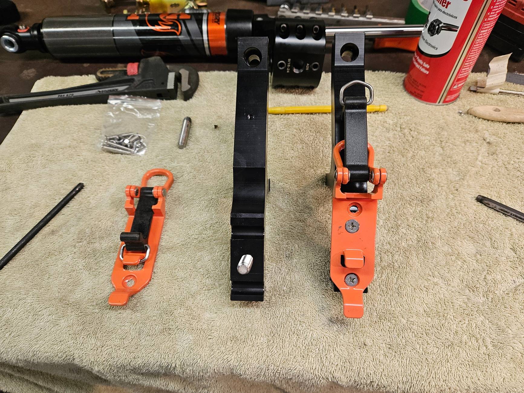

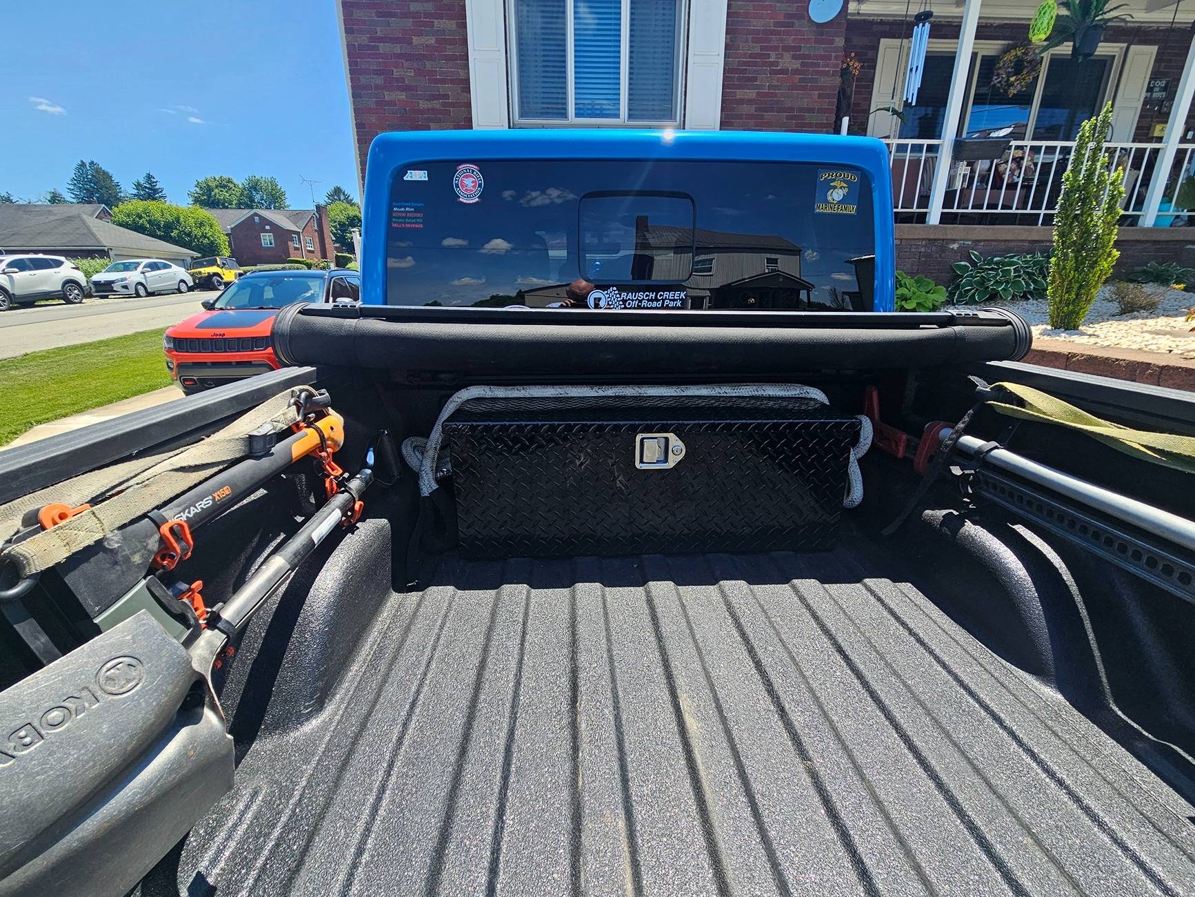

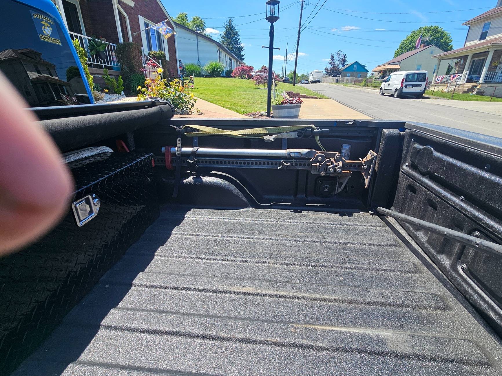

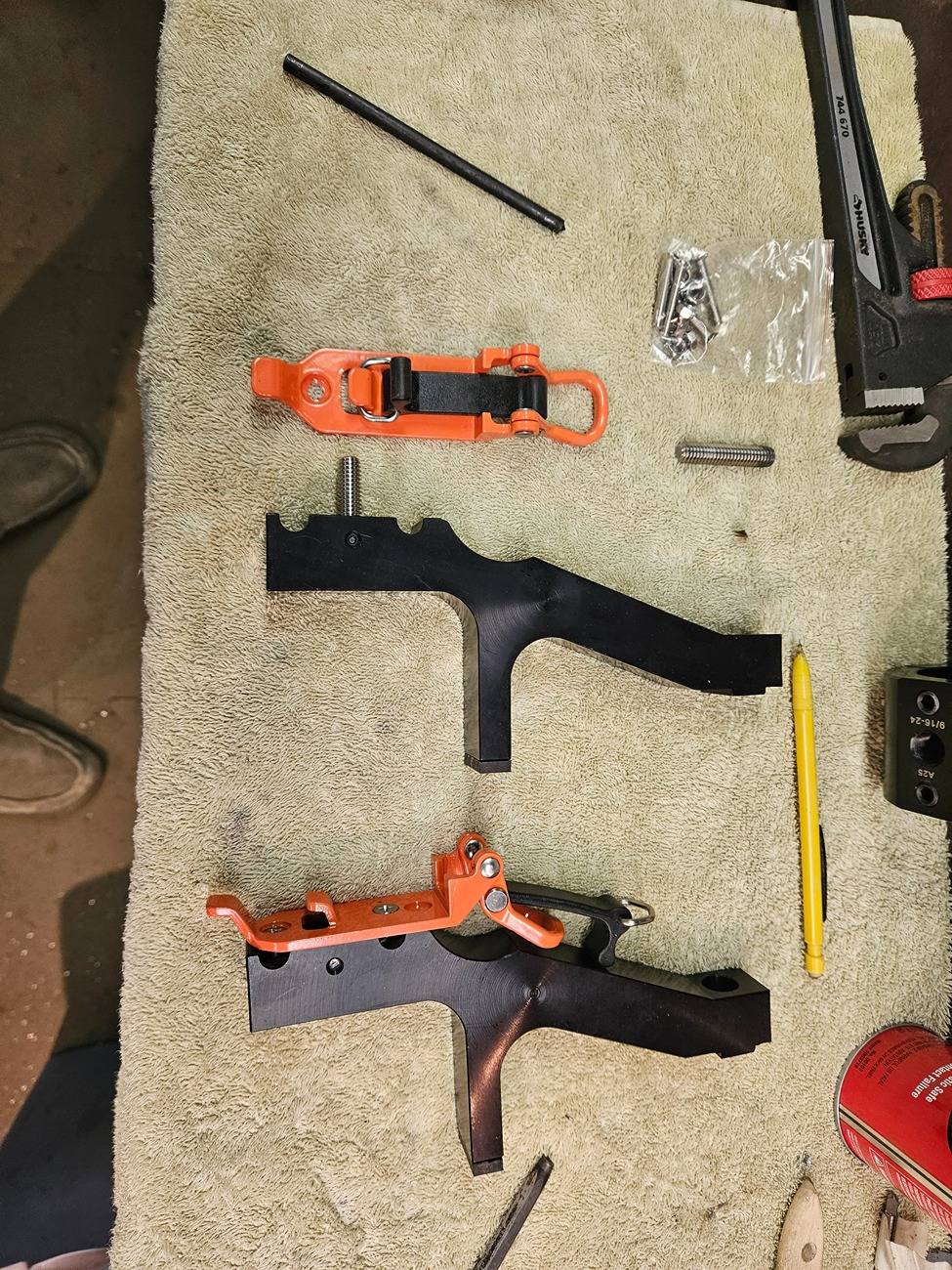

Have another project. Already have a HiLift jack mounted in the bed. Decided to mount my shovel the same way, using the same HiLift mounts. Had to remove the stud and drill and tap 2 new holes in each one.
Jeep Gladiator Rusty PW Journal 20250523_200410
Jeep Gladiator Rusty PW Journal 20250523_200425

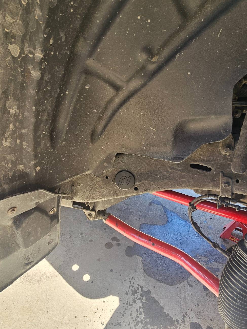

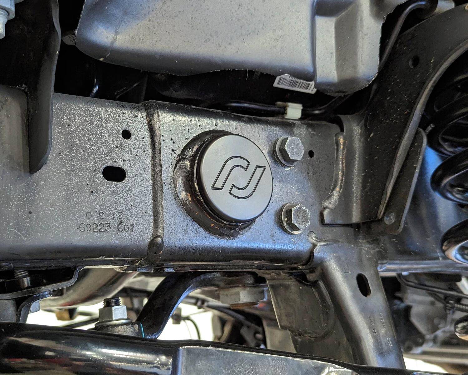

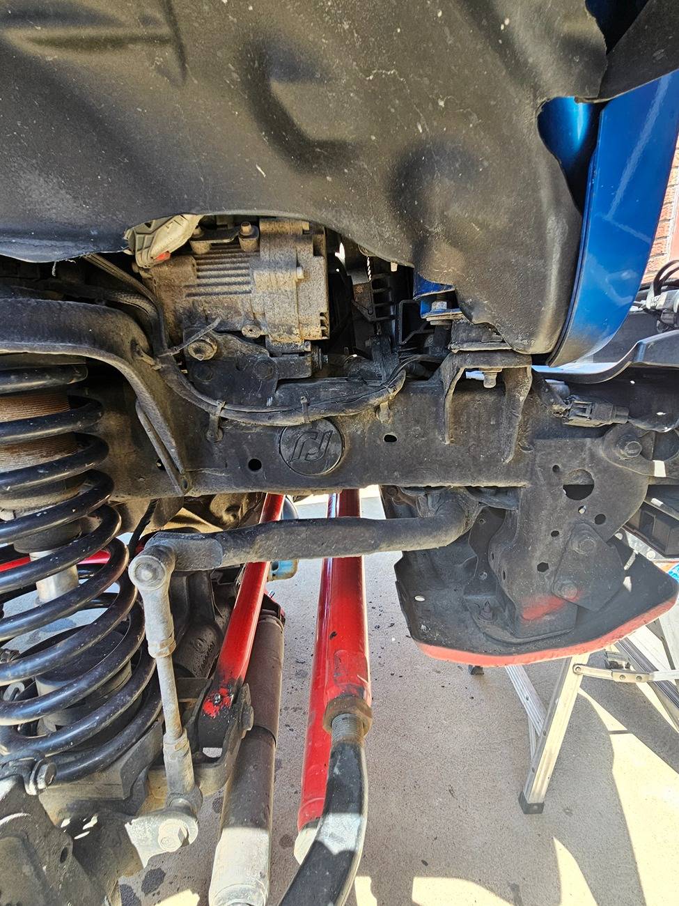

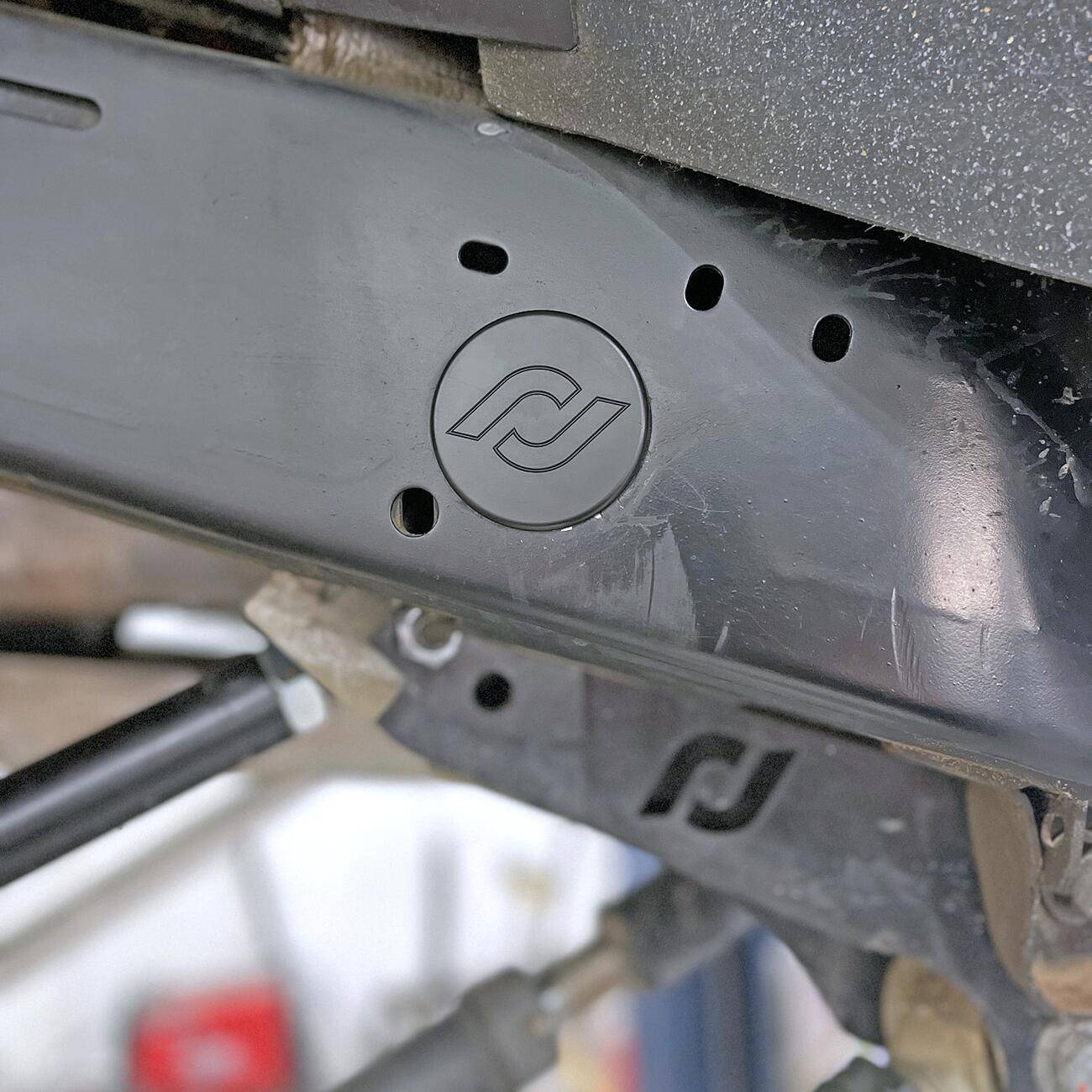

Installed the Rock Jock frame plugs. The ones in the frame were easy to install. Took a razor knife and cleaned the hole. Then used a rubber mallet to tap into place. The plugs for the cross over tube were a PITA because the holes are not exactly round. They are kind of egg shaped from welding. Had to use a die grinder with a burr bit to round out the holes.
Jeep Gladiator Rusty PW Journal 20250526_150332
Jeep Gladiator Rusty PW Journal 20250526_150338

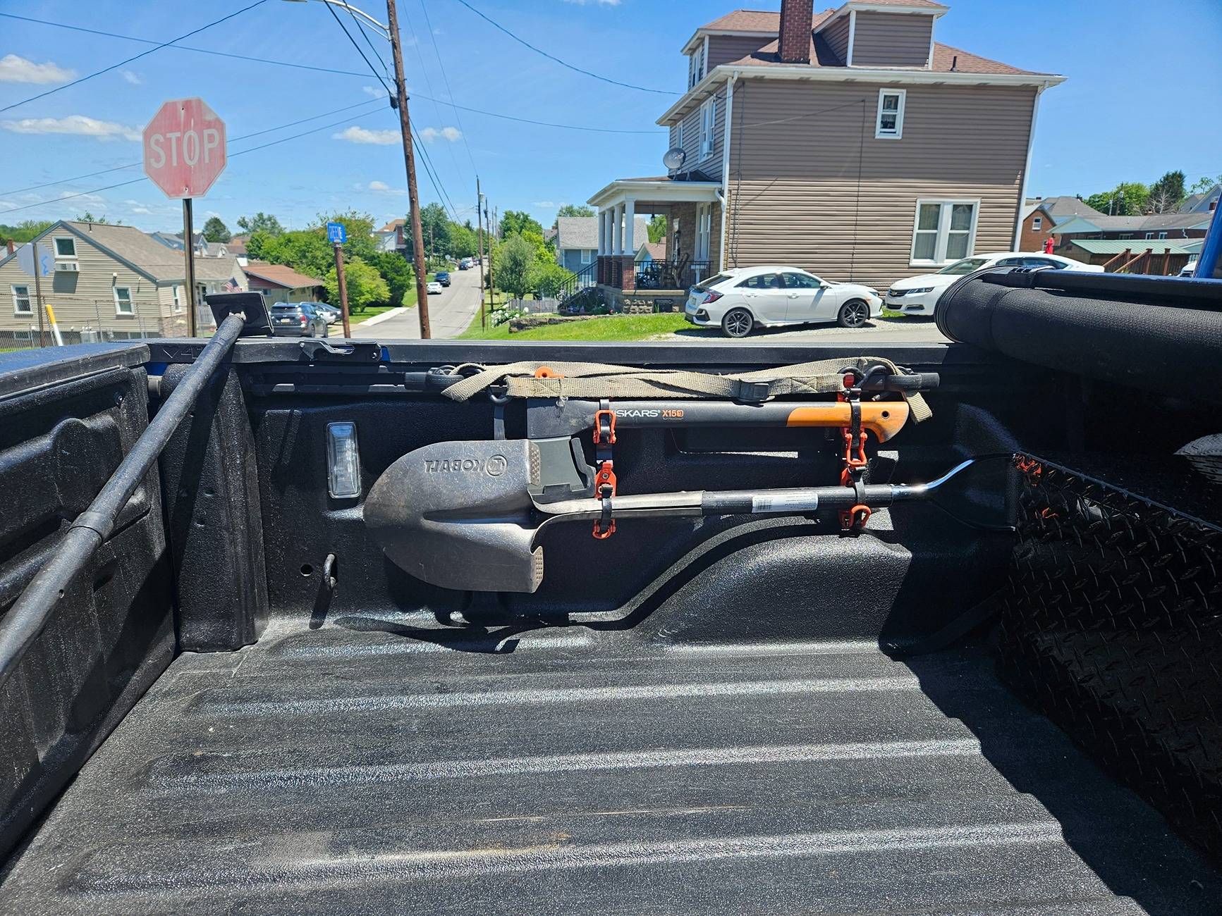

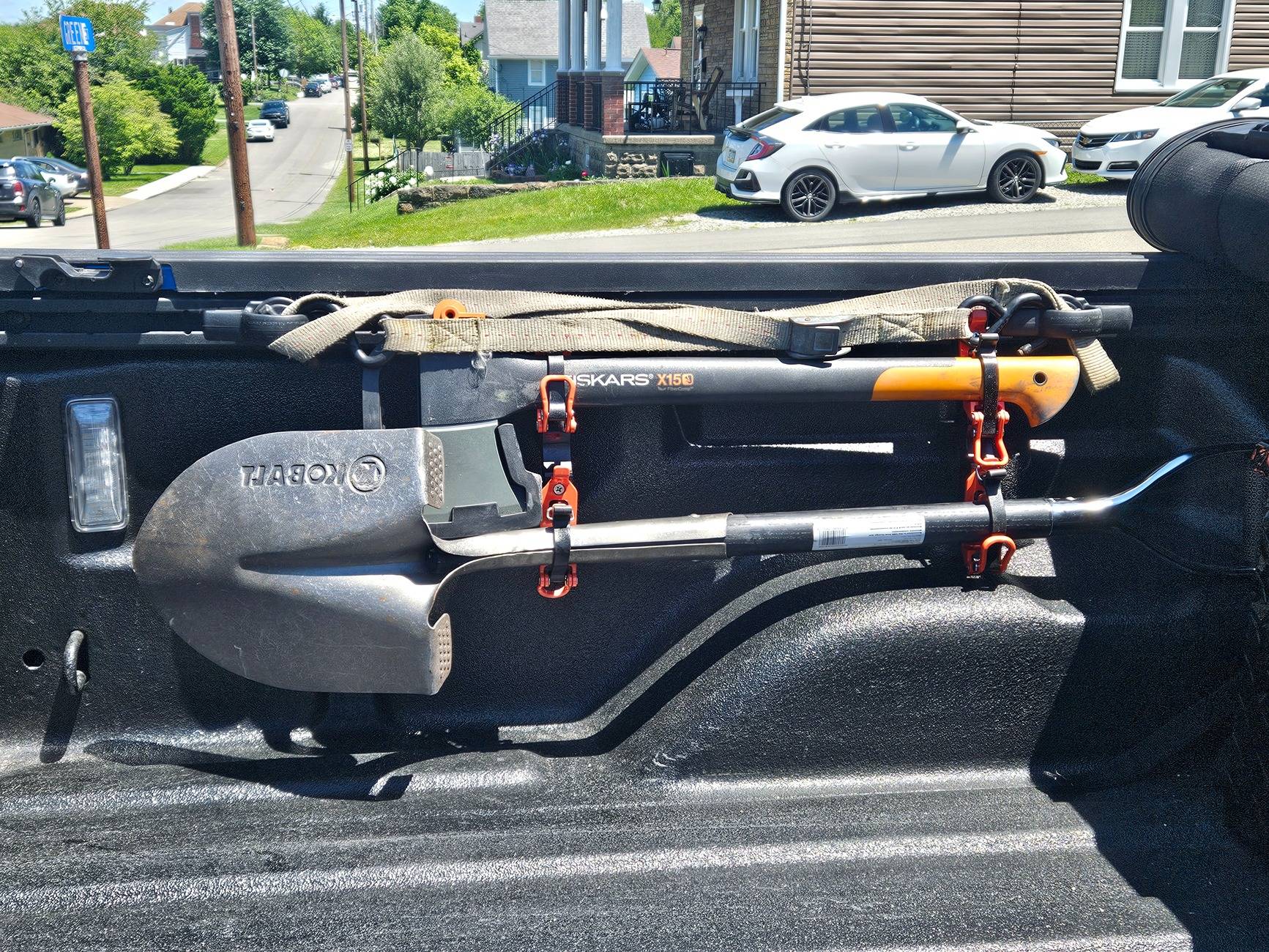

Finished installing the brackets to hold my shovel and axe.
Jeep Gladiator Rusty PW Journal 20250526_124635
Jeep Gladiator Rusty PW Journal 20250526_124642
Jeep Gladiator Rusty PW Journal 20250526_124705
Jeep Gladiator Rusty PW Journal 20250526_124816
Jeep Gladiator Rusty PW Journal 20250526_124952

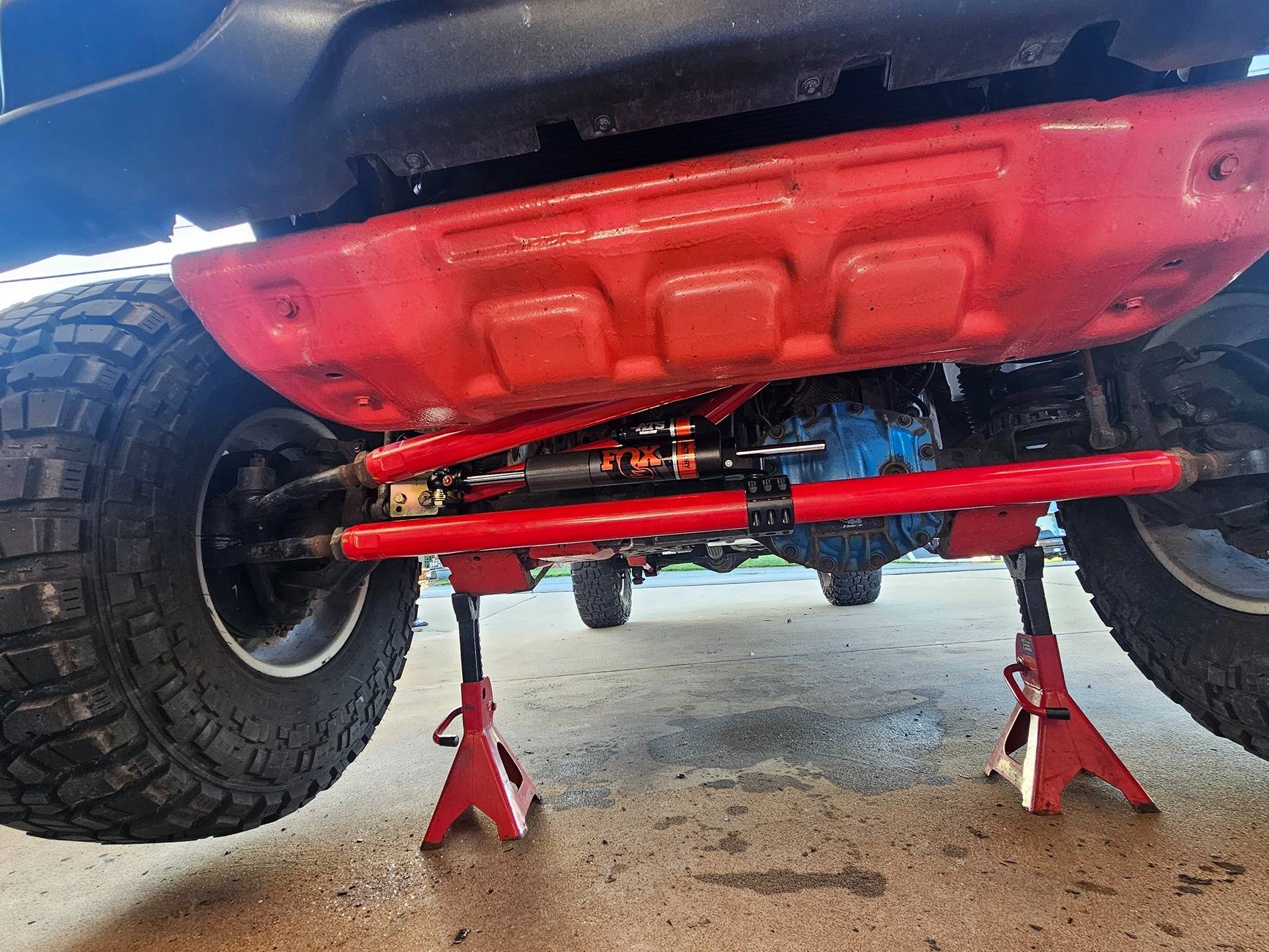

Installed the Fox ATS steering stabilizer.
Jeep Gladiator Rusty PW Journal 20250526_191811
Jeep Gladiator Rusty PW Journal 20250526_191822
12,189
32,456
Playing around with the adjustments on the ATS stabilizer. Started at 10 clicks from full soft. Yesterday went to 8 clicks from full soft. Today went to 6 clicks from full soft. Think I'll keep it there for a while. Driving back and forth from work. The roads have tram lines, bumps, pot holes, and a host of other thing that go bump in the night. The tram lines are the tar seals and joints in the concrete between lanes. When i would do a lane change. I would get a wiggle in the steering wheel. That's gone now.
