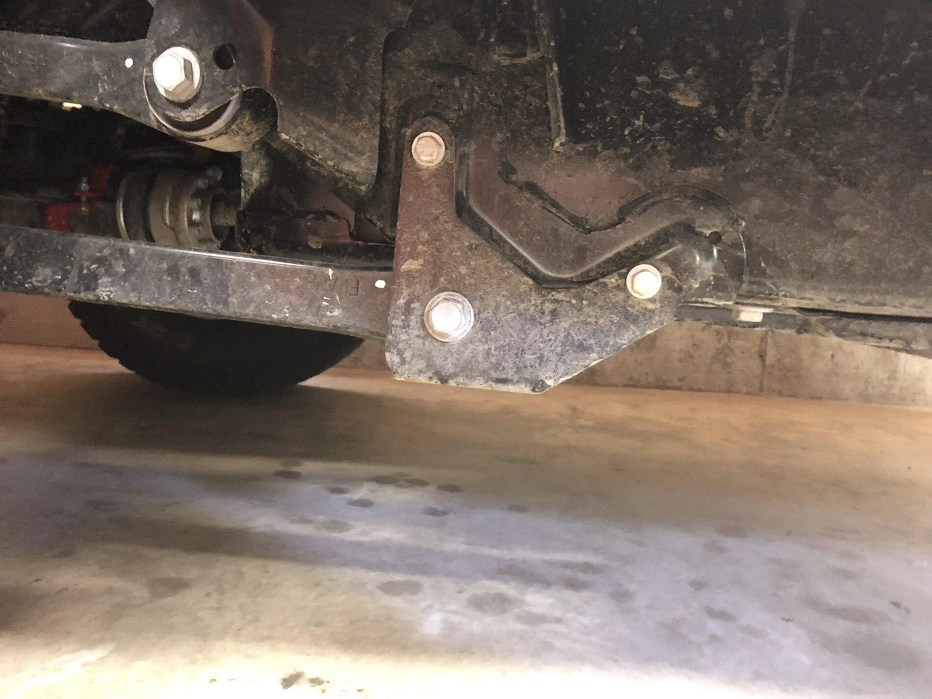

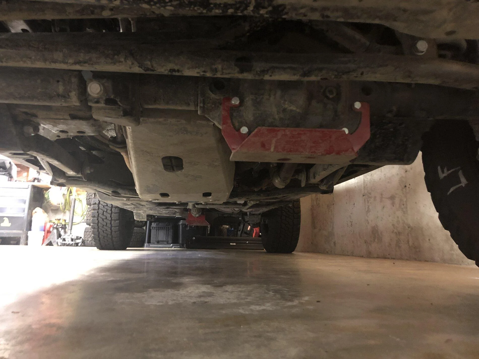

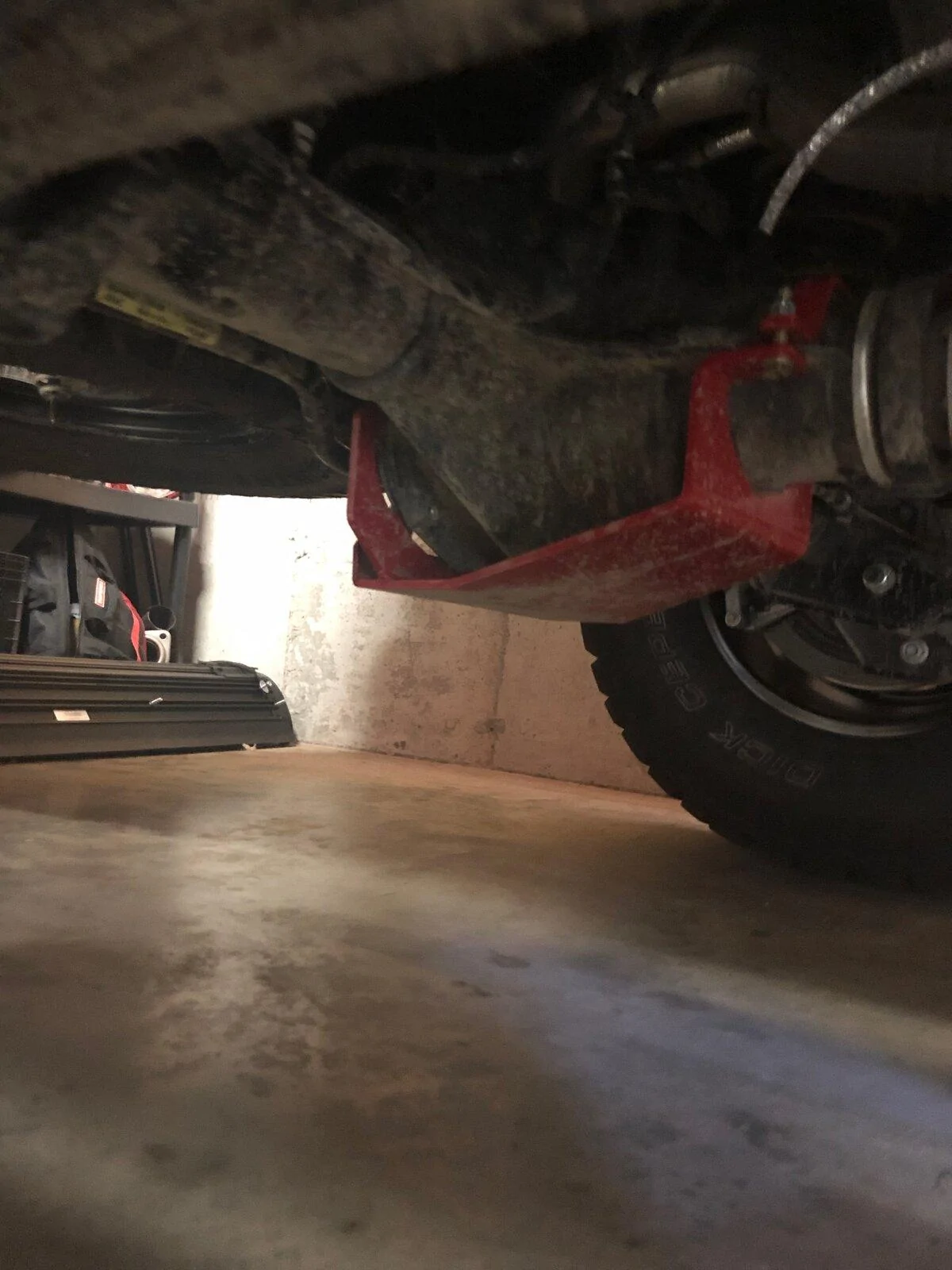

Once the damage is done its done. Skids are cheap insurance. I think the most common is the rear lower control mounts on the frame side. They get bashed easily. Then go with the axle-side control arm skids because they are low and easy to bend. The diff skids are nice for sliding over, but not as necessary because the axle housings are pretty solid. You are more likely to peel the diff cover off the housing than to damage it, I just like the ability to slide and not get hung up

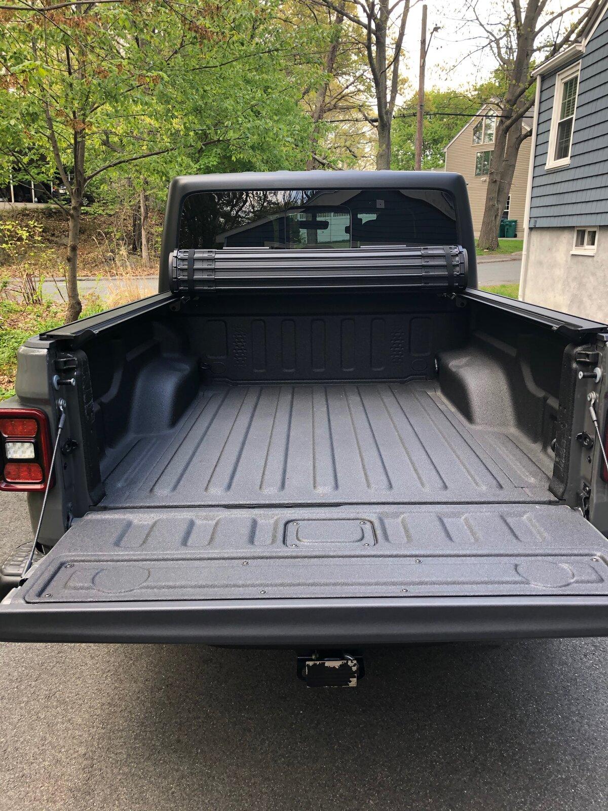

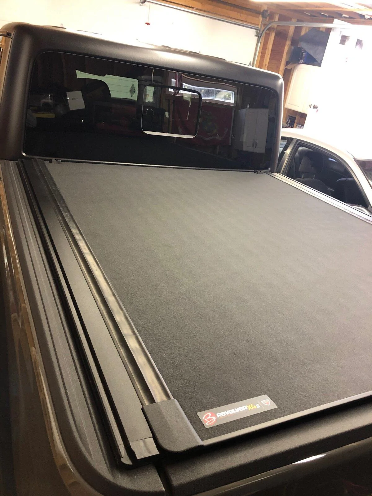

New FrontRunner Load Bars installed today onto my Revolver X4s cover. I went this route rather than a full rack so I can easily and quickly remove them when not in use. They will mainly be used for my RTT, keeping it at a height just below the roof line.
Jeep Gladiator Axeman's Rig Journal IMG_3353
Jeep Gladiator Axeman's Rig Journal IMG_3354
I didn't want the weight of a full rack, or a system that mounted under the cover that messed with the seals. The cover rolls right under the rear rail, and stops at the front rail. Front Runner does make longer legs to raise the bars higher, but I worried about the tent being too high when off roading

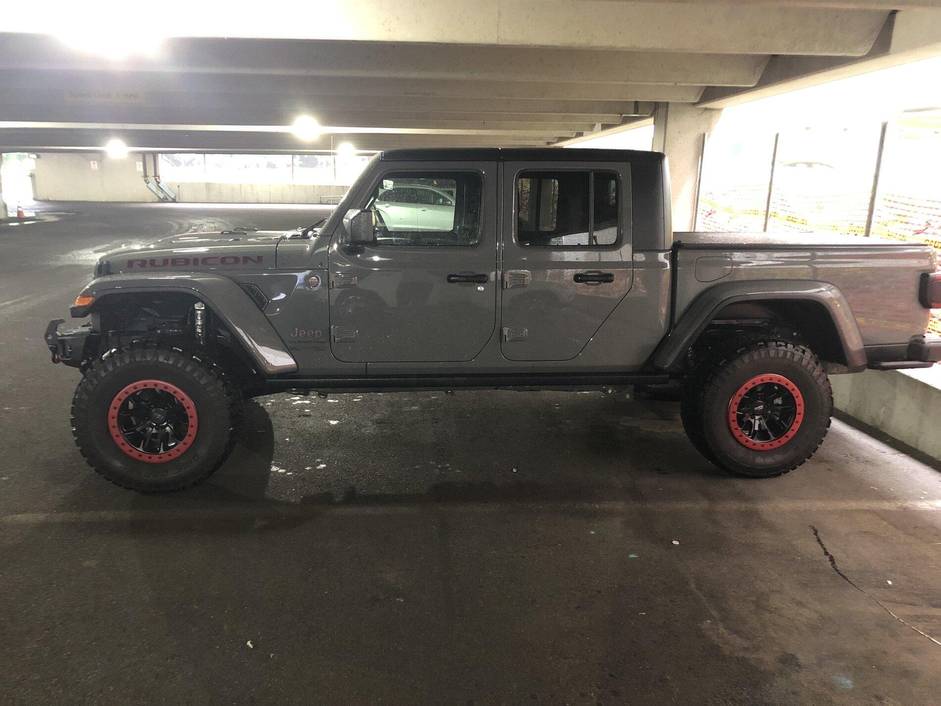

Got started on my rear seat delete/platform system. I really liked the look of the Goose Gear so I made my own version. Used 1/2" white birch plywood and truck bed paint.
Rear seat removed
Jeep Gladiator Axeman's Rig Journal IMG_3377
Cardboard templates
Jeep Gladiator Axeman's Rig Journal IMG_3379
Driver side rear
Jeep Gladiator Axeman's Rig Journal IMG_3386
Passenger side coming together
Jeep Gladiator Axeman's Rig Journal IMG_3429
Done for now
Jeep Gladiator Axeman's Rig Journal IMG_3435
Jeep Gladiator Axeman's Rig Journal IMG_3436
Jeep Gladiator Axeman's Rig Journal IMG_3437
Jeep Gladiator Axeman's Rig Journal IMG_3438
I will make adjustments as I get some use and see what it needs. I will need to get some kind of mat for comfort and traction for the dogs. Will likely also add a few tie down points, but I am happy the way this turned out.
Is this the specific rack you went with from front runner? https://www.frontrunneroutfitters.c...ts/pickup-roll-top-load-bar-kit-1475mm-w.html
I have a very similar set up using a soft cover and voodoo crossbars, but like the idea of a hard rolling tonneau and removable crossbars when the tent isnt in use.
Its not, but it is the exact part numbers. I just went through their customer service for the legs and load bars, but they did order me the same part numbers listed on this existing kit.
Thanks for the response. I'll confirm with frontrunner. Noticed any issues with that setup? Main concern is weight on the t-slot when off road.
no issues so far. I don't have the tent on often but have wheeled with it a few times
