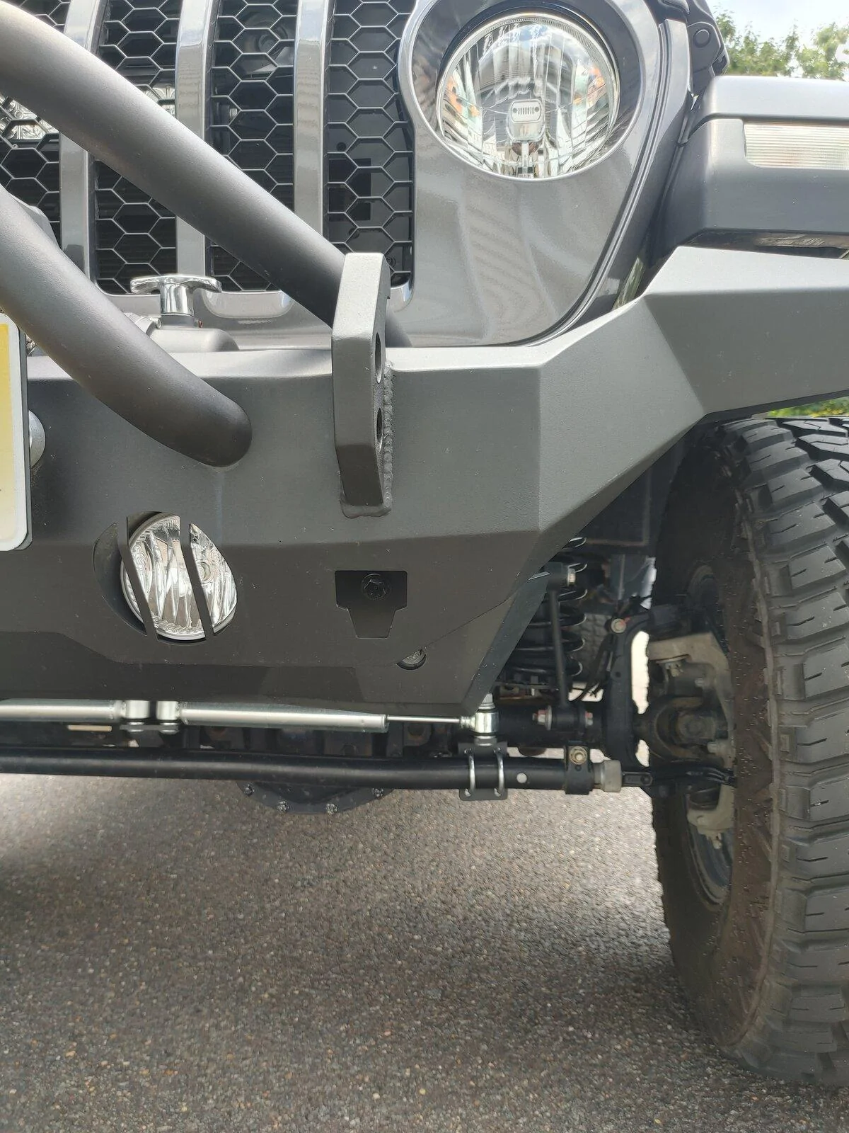

@Benbean66

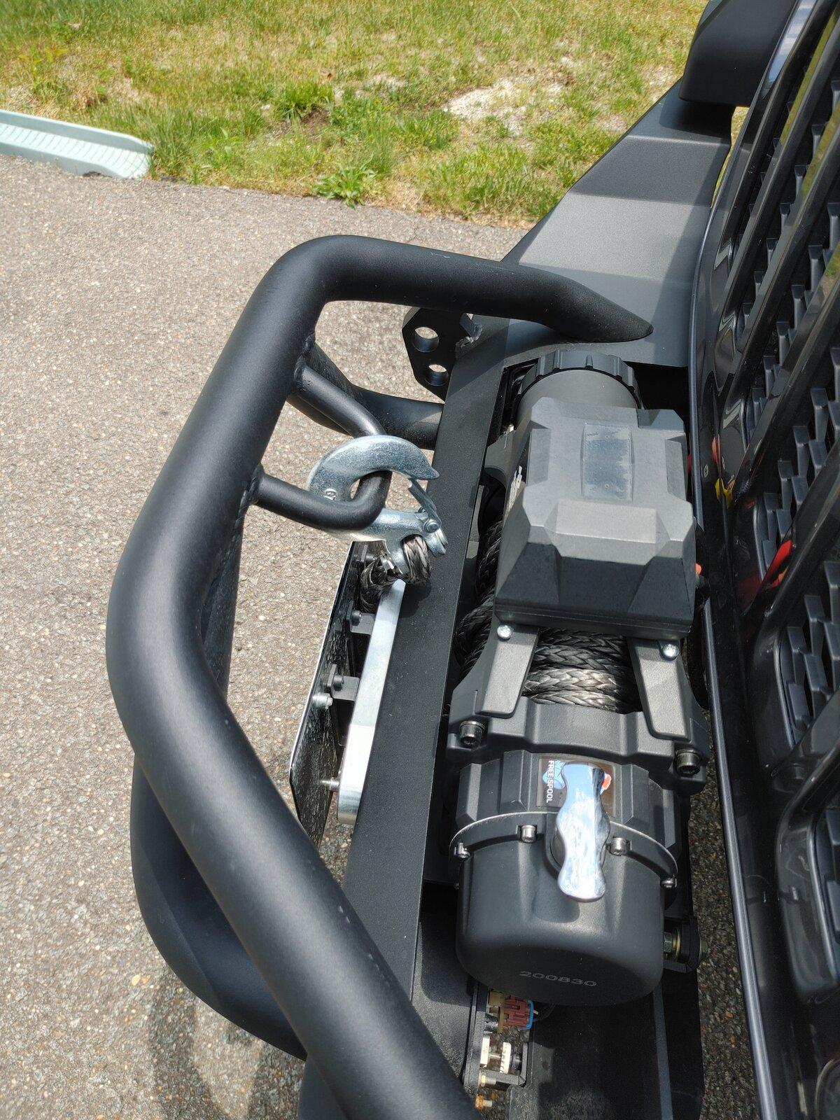

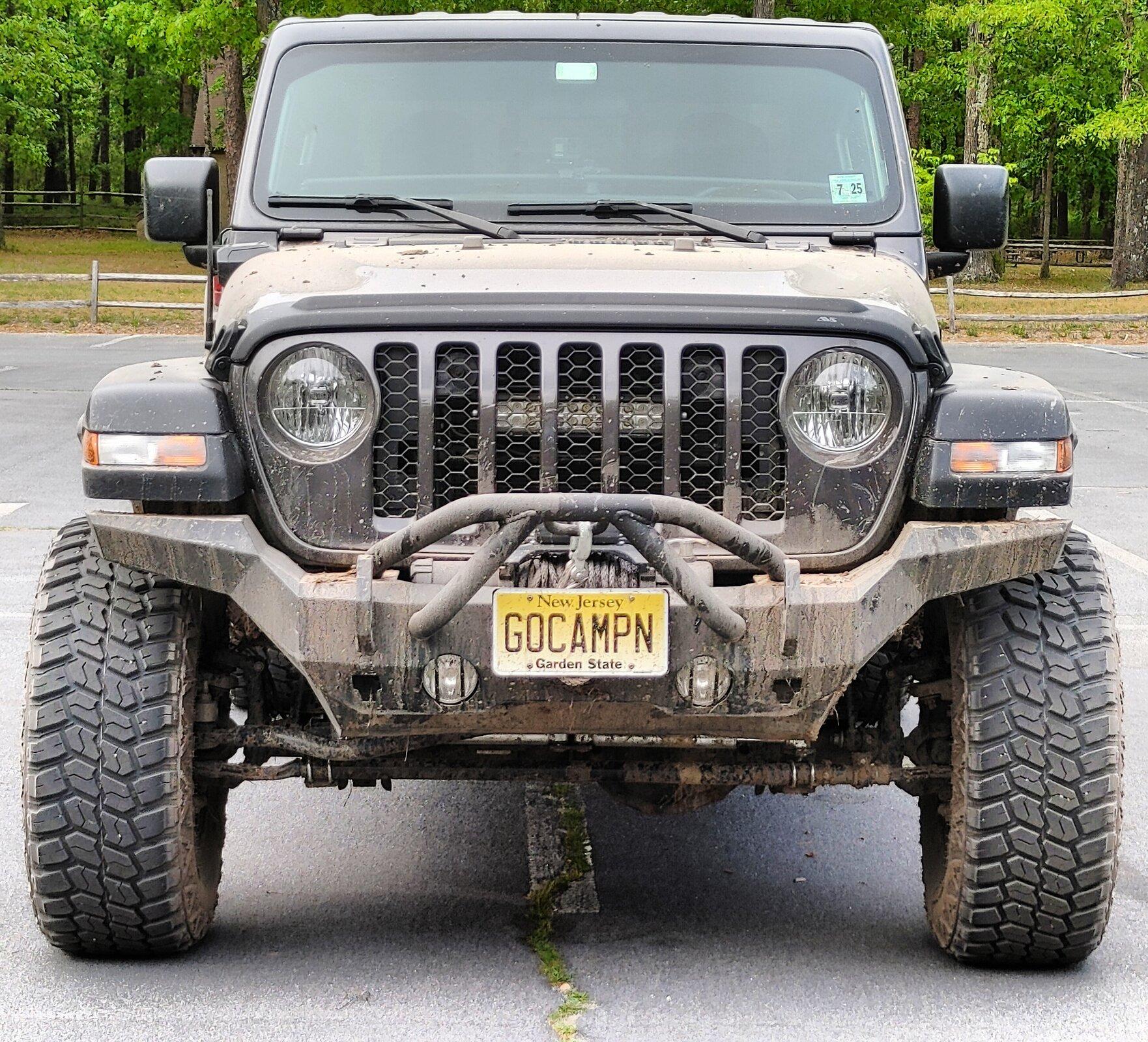

I really love this bumper. I used to have the Rugged Ridge XHD series front bumper on my JK, which had interchangeable end caps to convert from stubby to full width as needed. The difference and reason I went full width here is that I had huge steel fenders on that JK. On this truck I actually enjoy the look of the stock fenders with the lights and such - so I opted for full width to give them a little protection from underneath. I have already hit a tree on a tight trail with it, so good choice! Haha.
As for the "X-Striker" style bar, it's more so just a brush guard if you were to compare it to a stinger. It won't help you climb anything or kickstand you if you go end over end. As far as downsides, no. My only follow up would be to sleeve the small curved rod that the winch can clip onto, wrap it with shrink tube or rope or something. It rubs the powdercoat so I have had to hit it with spray paint to clean it up again and prevent rust.
Jeep Gladiator Rig Journal - Ethan / GOCAMPN 0607211243_HDR

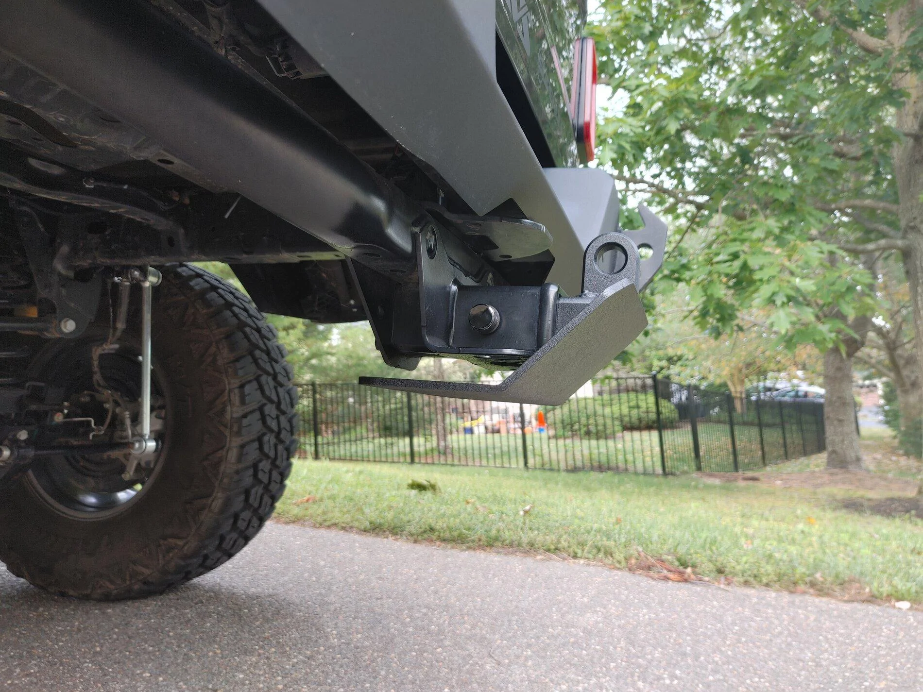

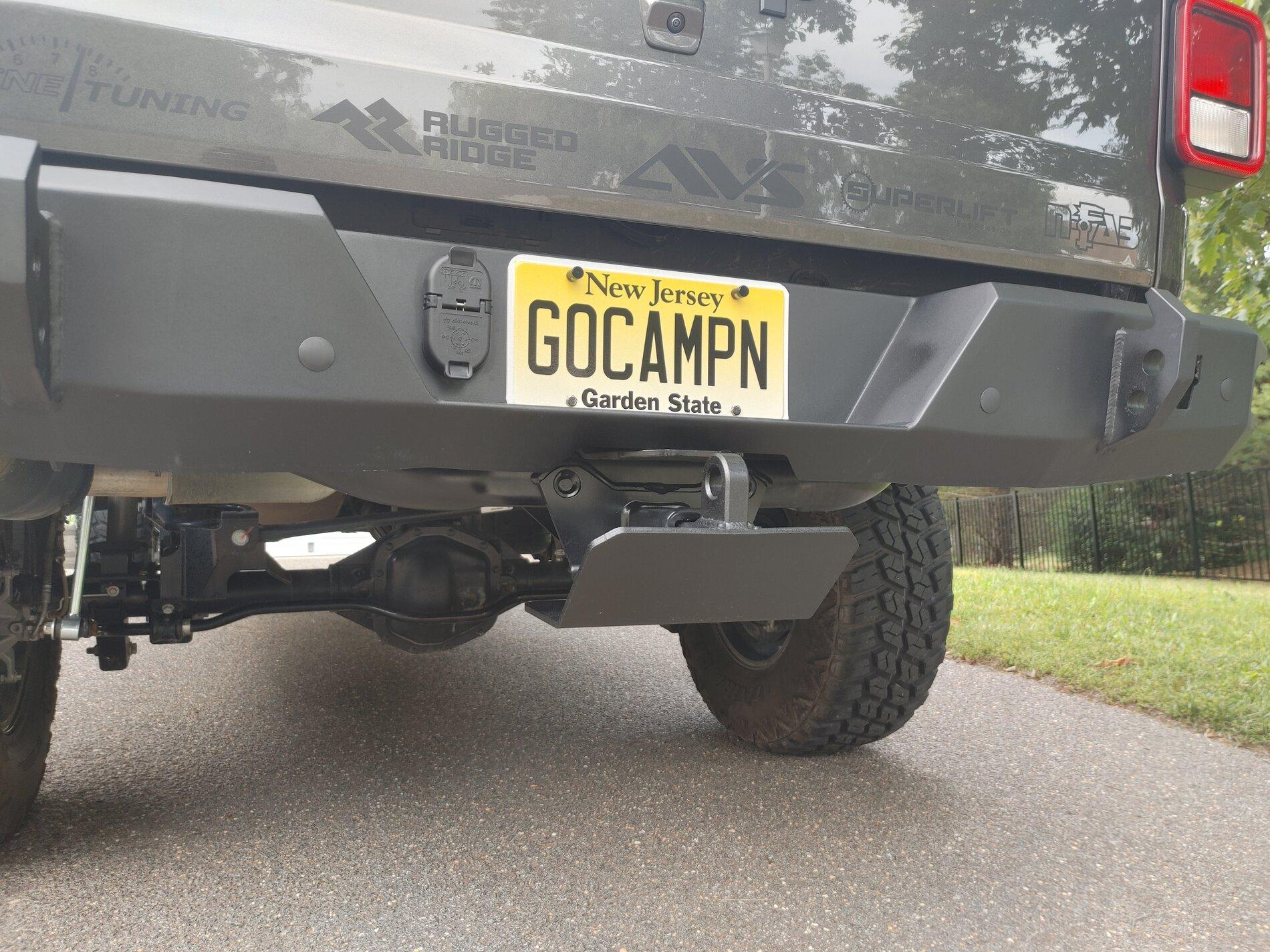

Also, it does come with lift points for your jack. On the rear bumper they are positioned perfectly with no obstructions but on the front since they are directly beneath the built in tow hooks the jack doesn't go in all the way. It still worked, but I would like to see them move the hole to the inside by an inch.
Jeep Gladiator Rig Journal - Ethan / GOCAMPN 0607211243a_HDR
Jeep Gladiator Rig Journal - Ethan / GOCAMPN 0601211833a_HDR
@Benbean66
Great information. I appreciate your input. I see what you mean about the jacking points. And I like the winch cable loop. My OCD has always had an issue with winch cables going off to one side, haha!

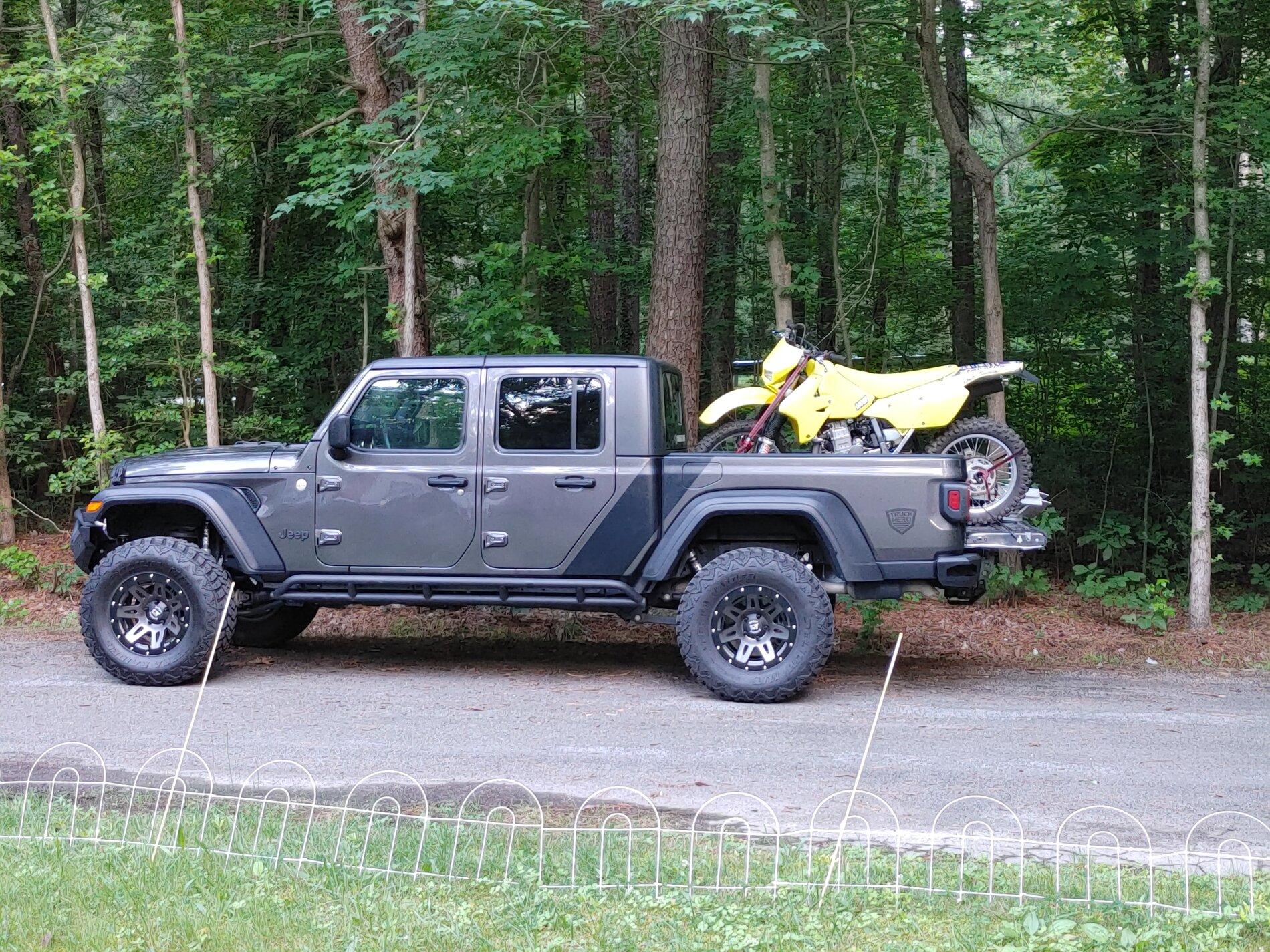

Well I'm nice and sunburnt from Bantam! Now making my way down to VA for some two-wheel action. 2007 Suzuki DRZ 400 in the bed, and pretty much no sag at all.

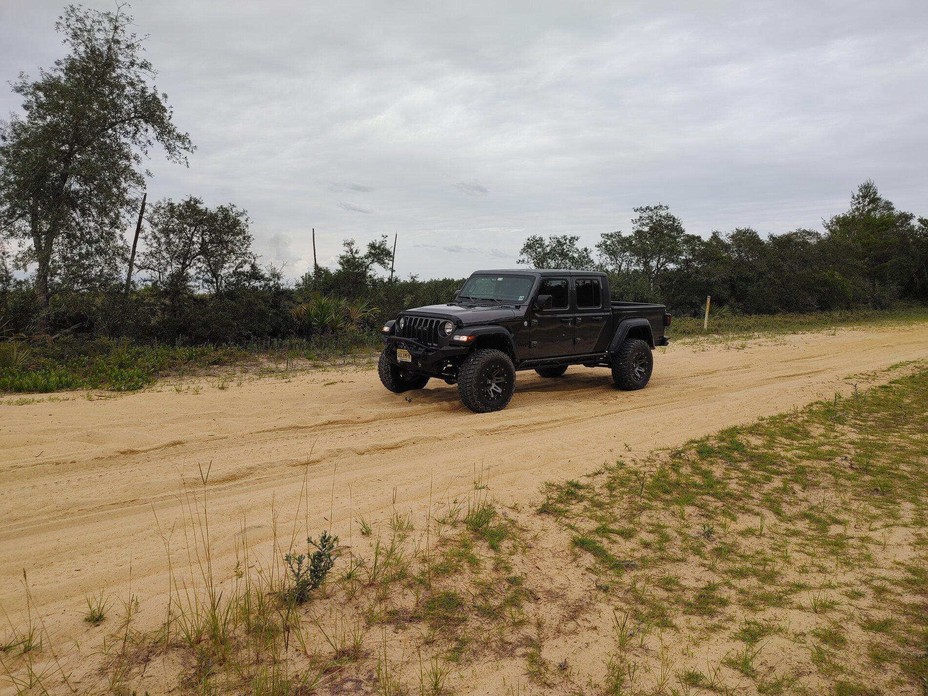

Last week we also ventured down to Florida to visit some old friends and of course took a day to see Busch Gardens. Hopefully next time I can go to Galaxy's Edge at Disney, they were all booked up! :mad:
The Florida Jeep Badge of Honor trail "Tread Lightly! Four Wheel Drive Way" is an actual trail. I was under the assumption it was just a series of fire trails in the woods and any of them earned the badge. I suppose it still is, but when you visit the ranger map/sign does have a highlighted trail to follow. I did a smooth out and back on the main line of the trail which was wide enough and made of varying soft sand and hard packed sand. I did need to engage 4WD in a couple spots where I dug in a bit but otherwise smooth sailing. The side trails that dart off in every direction are tight! Be ready for pinstriping.
Jeep Gladiator Rig Journal - Ethan / GOCAMPN 0618211642
Jeep Gladiator Rig Journal - Ethan / GOCAMPN 0618211612a_HDR
An amazing thing about this trail is that there is a freaking bombing range on its East side. I got lucky and two jets were doing bombing and strafing runs while I was there. I wasn't able to get a decent picture of the little mushroom clouds but the sound of the guns and watching the planes was a thrill to remember.

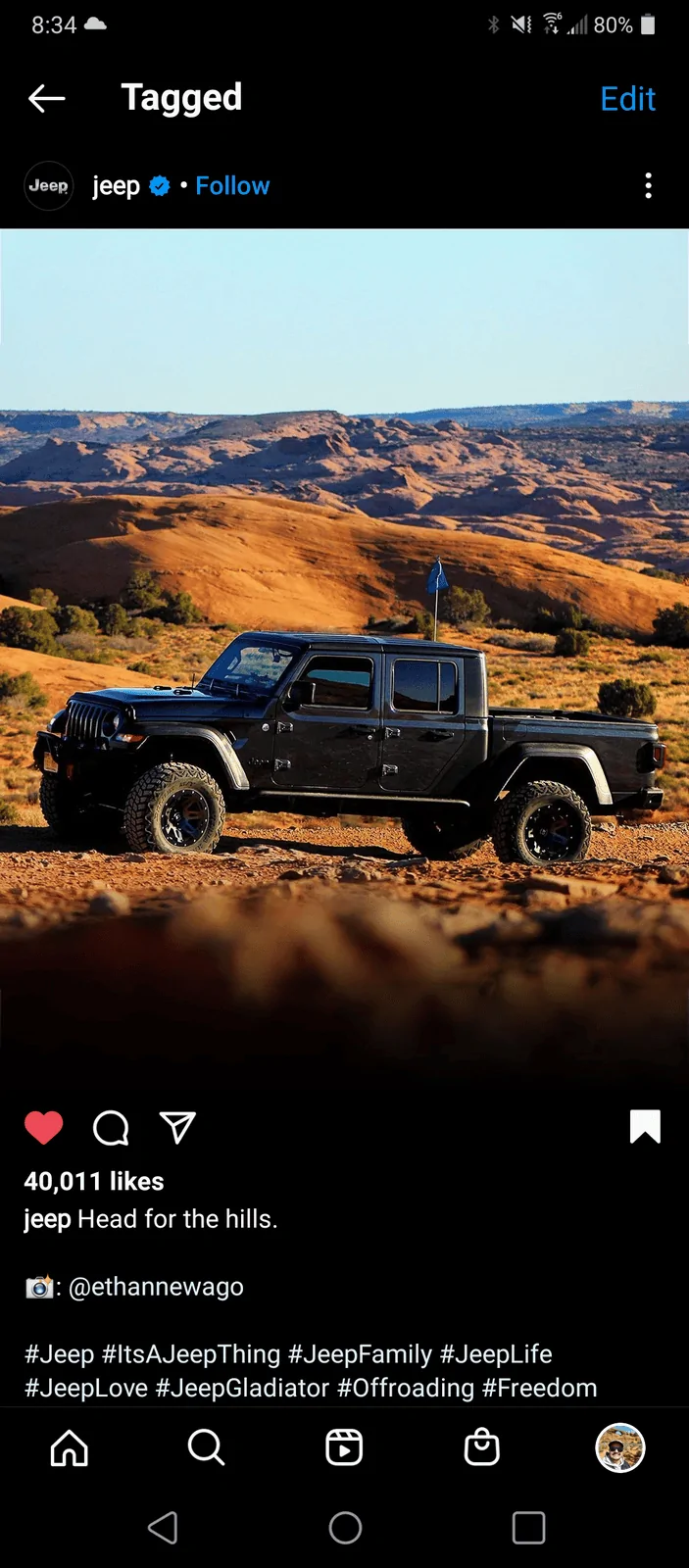

Jeep featured! Signed away the rights to this photo from EJS and have already been told it was spotted in a dealership in Arizona!

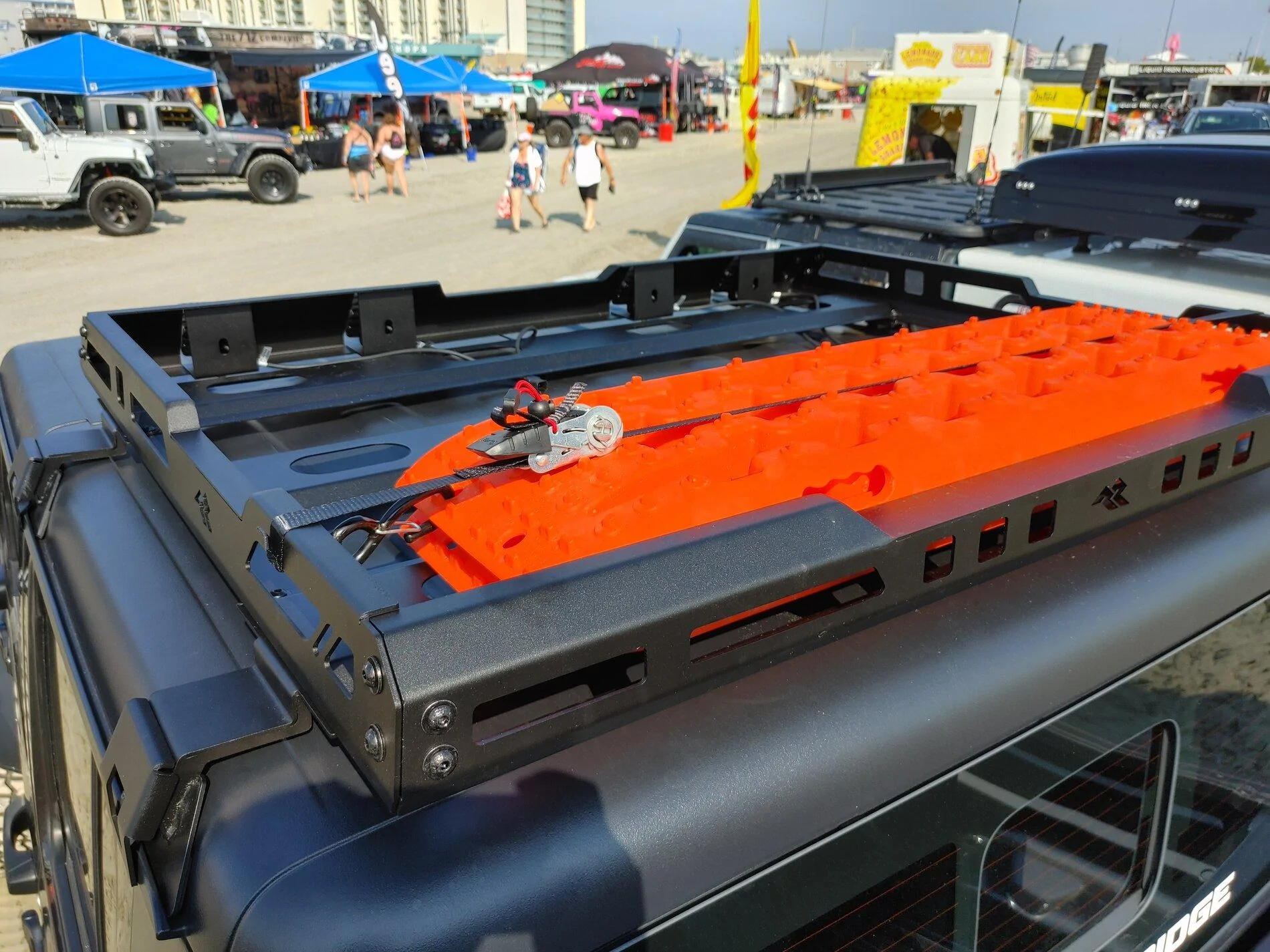

Spent the weekend with Truck Hero and Rugged Ridge in Wildwood. Installed the all new JT roof rack from Rugged Ridge, releasing later this year!
I also got 4 of the Rugged Ridge LED Cube Lights mounted up but it started raining, will try to take care of all the wiring tomorrow.
2020 Jeep Gladiator 3 LED Cube Lights | Rugged Ridge
As a little hidden gift to those of you following this thread, enjoy 20% off ruggedridge.com and free shipping with code: INVASION until July 23rd. :like: :jk:

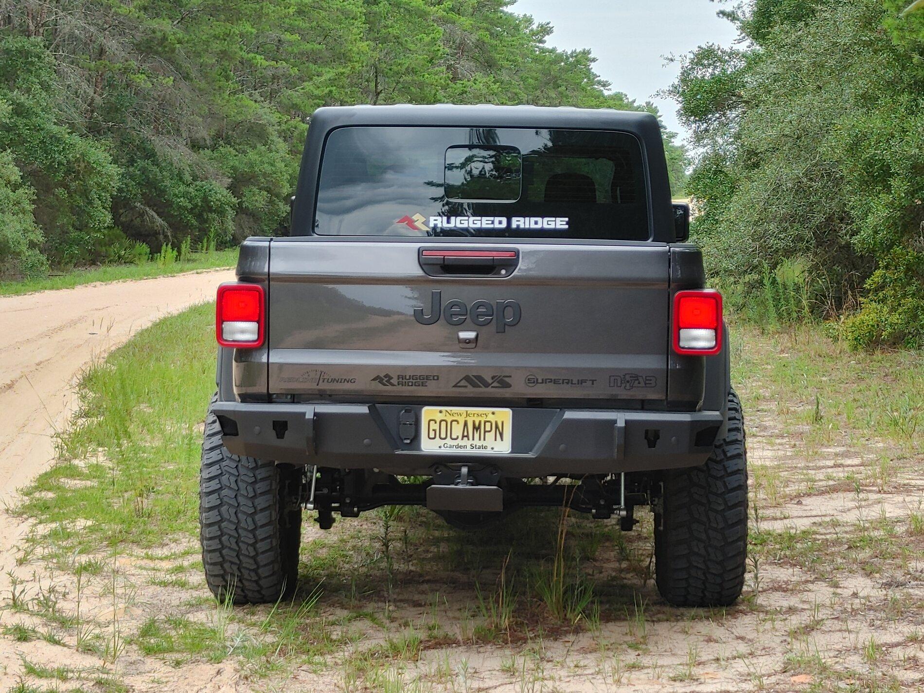

Additional rear shot, and yes the front panels can still come off easily!

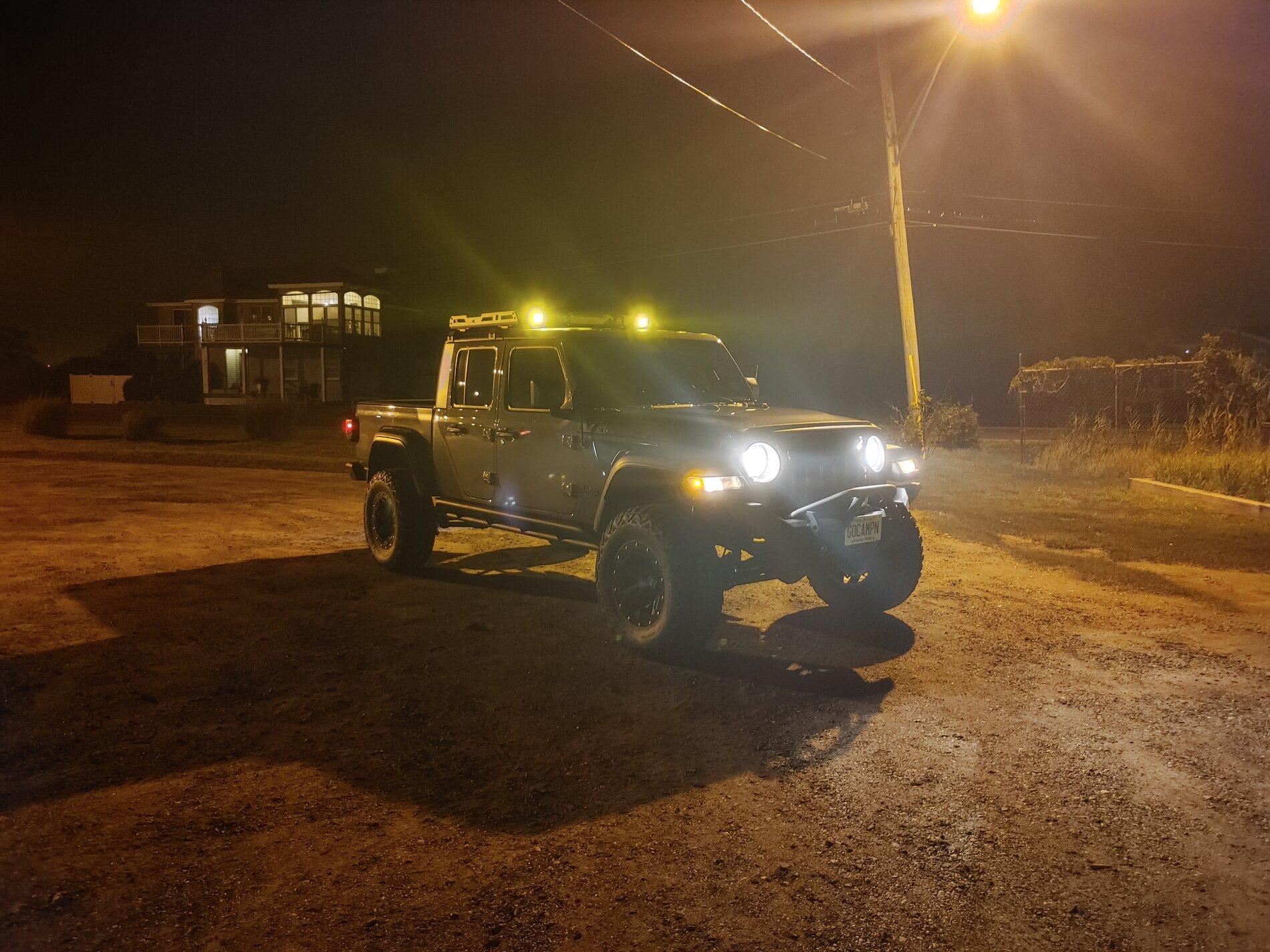

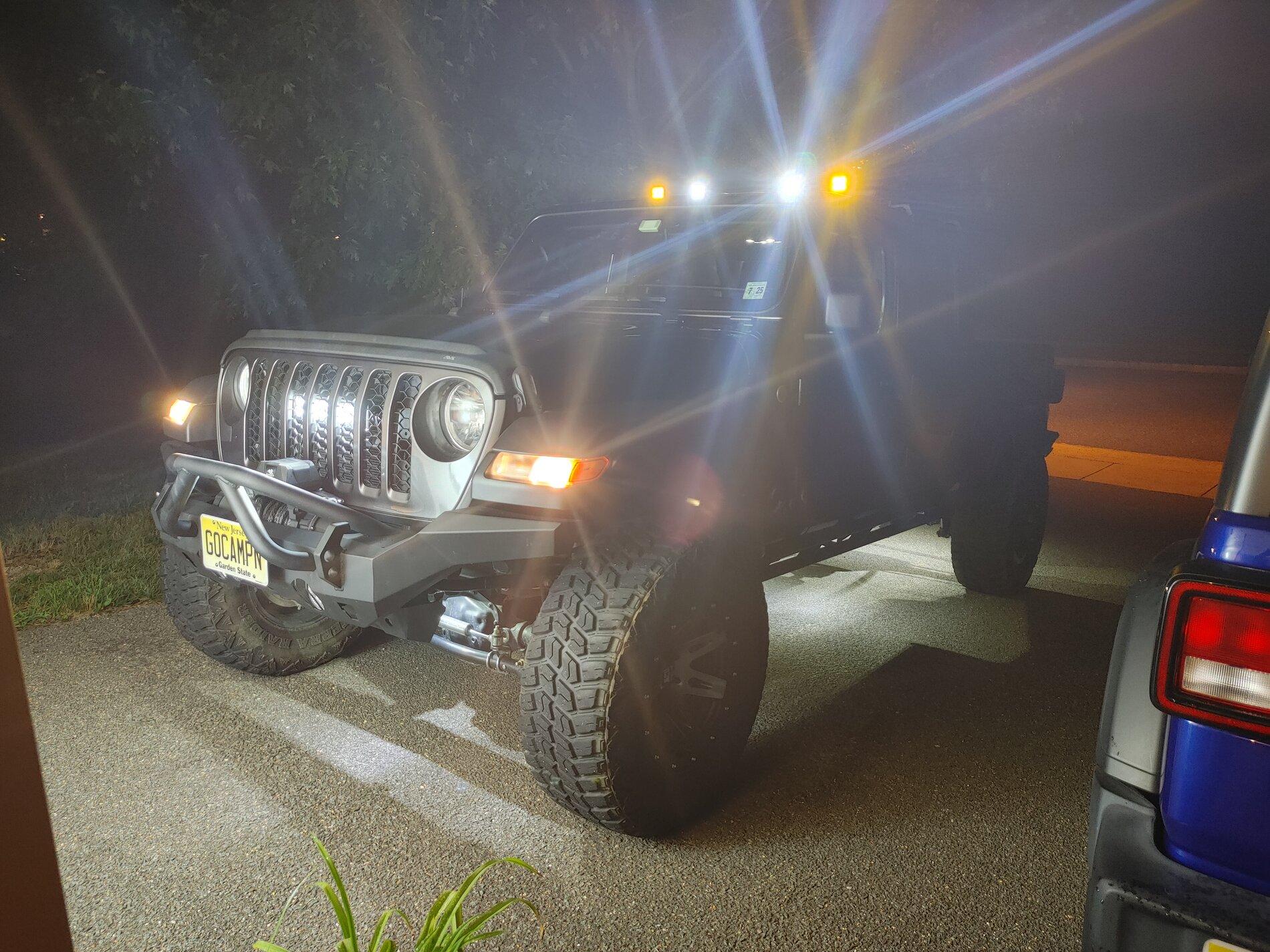

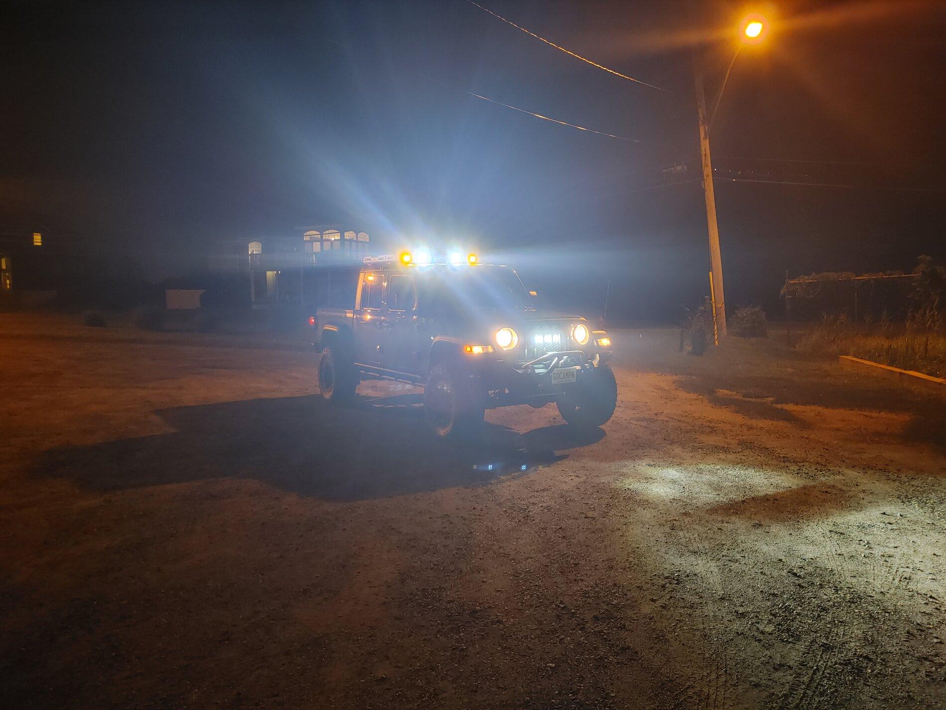

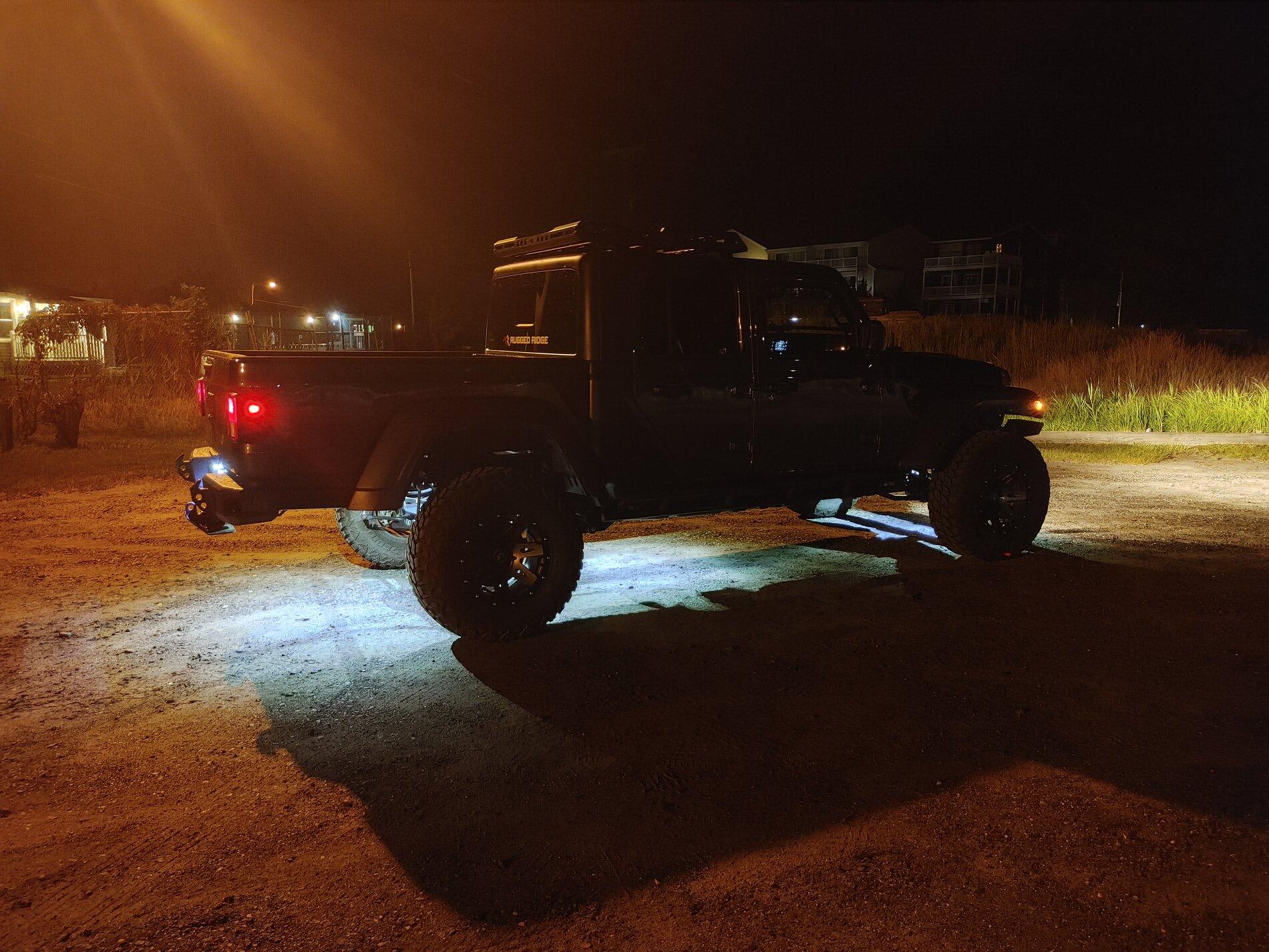

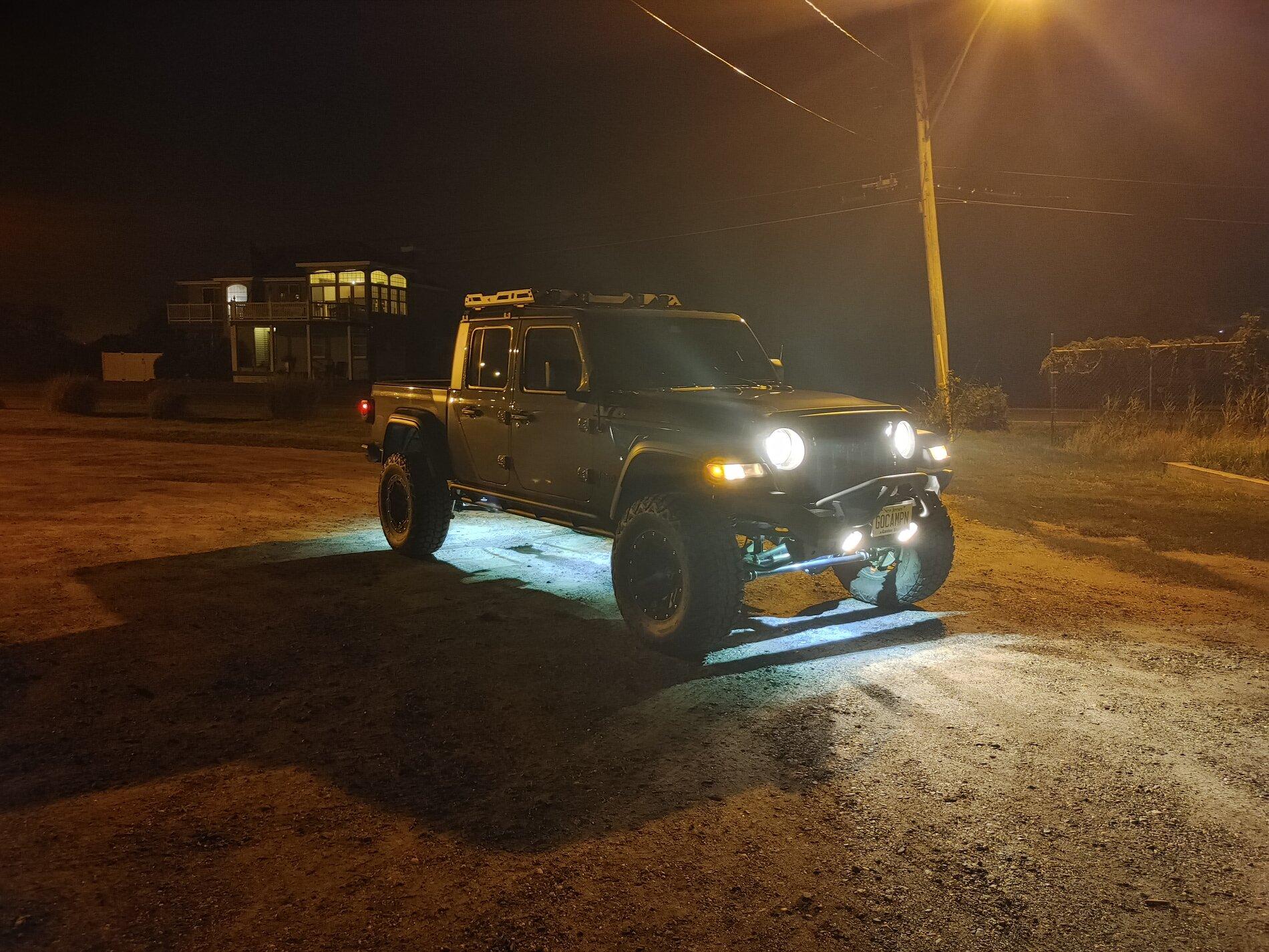

Too lazy to mess with my cell phone camera settings for night but got everything wired up. :CWL:
Aux 1 lights my two center led cubes and the led bar in my grille, Aux 3 lights the amber cubes, Aux 4 is the rock lights. I need to find some goodies to hook up to Aux 2...

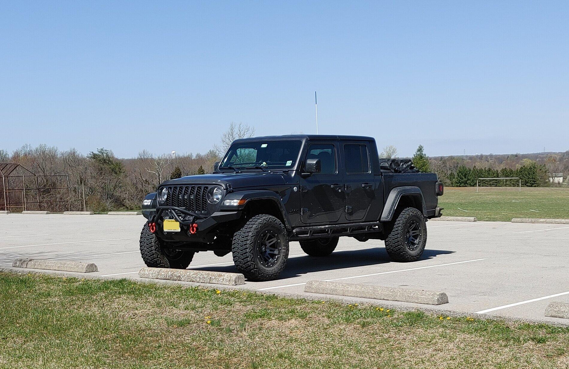

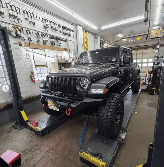

I ended up not being able to install the wheels right away. The front wheels actually rubbed on the bumper and I was worried about turning. Luckily, Superlift Suspension came through clutch and delivered my 4" lift kit. Complete with Bilstein dual steering stabilizer, Superlift track bar brace, and Fox 2.0 shocks. Yet another local shop taking care of my dirty work.
Thanks Superlift, Fox, and Bilstein for the parts! My heroes. :muscle::jk:
