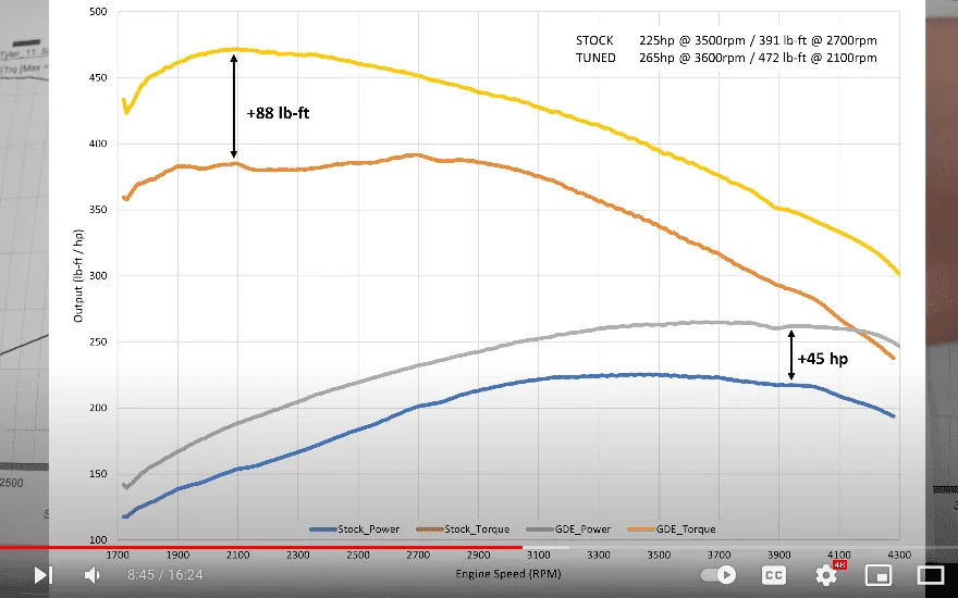

It's great to see they have them in stock and I like the fact that they ended up posting a dyno. Likely couldn't feel a 10hp & 20lb/ft gain but I think it's safe to assume that any decently designed intake for this platform will be a force multiplier when combined with a tune. GDE netted 472lb/ft to the ground on a wrangler EcoD recently. Banks is right up there as well, 460 something to the ground. These were on stock filters. We'd likely break into the 500s with an intake.
Jeep Gladiator S&B intake Screen Shot 2022-02-11 at 1.45.31 PM

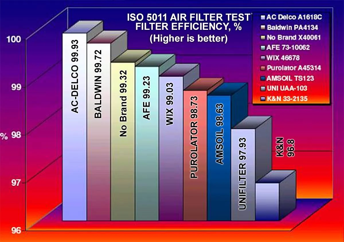

K&N lets more dirt through than almost any other filter and has the least capacity to hold dirt over time. My last choice.
I thought they finally dialed things in, I remember pulling one with 20k miles and it looked & felt beat to hell and that was just under normal use. The material seems to break down way too easily, surprised that is still the case, this was way back.
250
40,604
54,295
I have actual scientific tests in a room with a dyno where multiple filters are compared and tested for specific things. Not only does K&N let more dirt through, they have less capacity to hold dirt so need to be cleaned much more often than others, and there have been other dyno tests showing the increases in performance are only for a short time until it begins to accumulate dirt and at high RPM ranges - outside of normal use.
In short, they are likely best for short time track use.

In your testing what type and/or brand of filters provided the best mix of filtration and flow? Anything close to the filtration of OEM?
250
40,604
54,295
I have other charts but the AC/Delco was among the best filters if not the best.
Jeep Gladiator S&B intake ISO5011-efficiency

Yep Shadows is right, K&N should be the last choice especially for a turbo engine. If I see a car or motorcycle with a K&N, I steer clear. I've had good luck with aFE in the past
I will be ordering the Banks this spring. Im pumped. If I can have the power when I need it and keep decent mpg when Im not ā€œon itā€, i will be happy. 25mpg today on 500km loop on winter #2 diesel. Not bad. Love this diesel!

AFE is not far at all behind AC/Delco and Baldwin for the efficiency tests.
