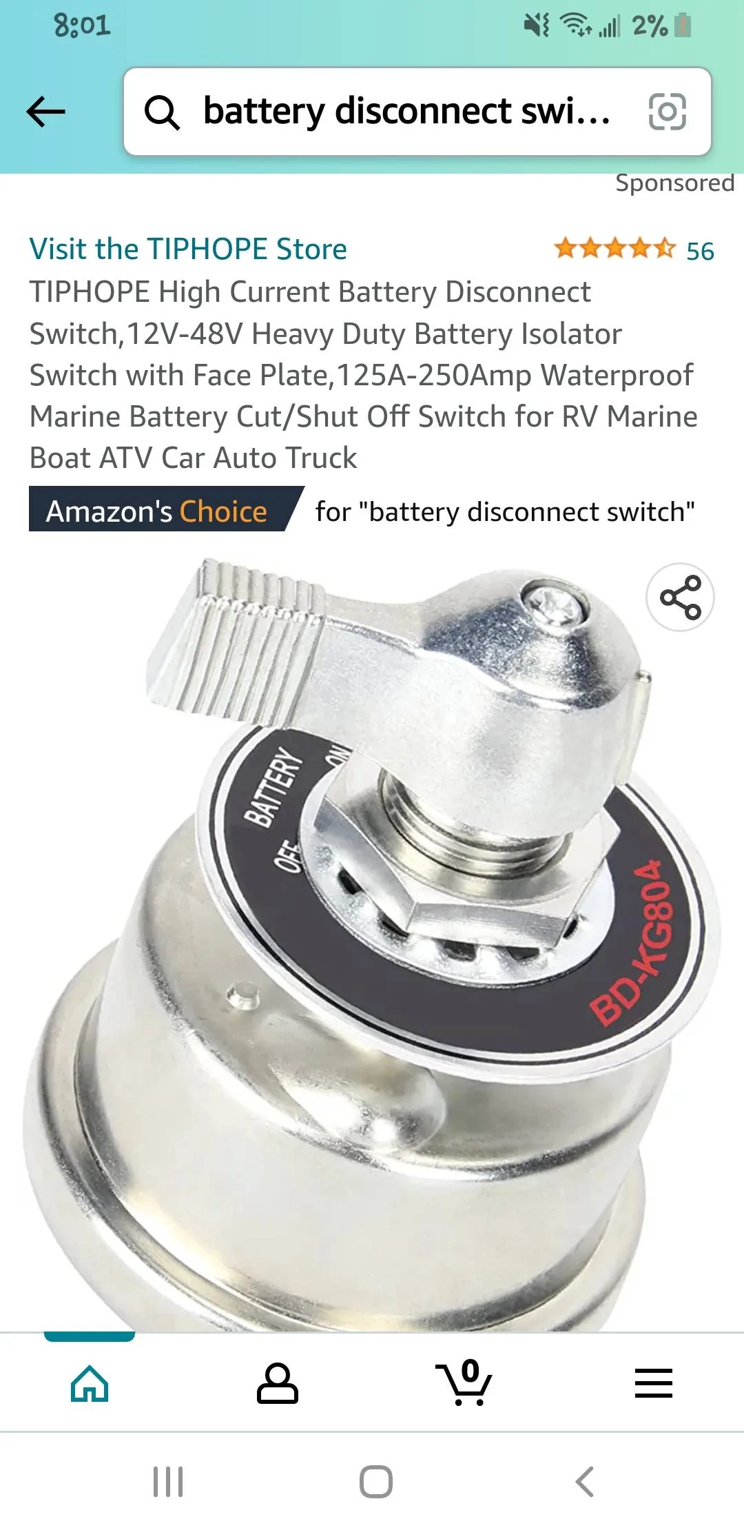

Every piece of equipment I have ever operated has had one of these , easy fix for you
Jeep Gladiator Safely disabling your Gladiator through fuse box? Screenshot_20230310-200146_Amazon Shopping

If you disrupt the flow of current between the batteries and the truck, it creates other issues. This shuts down the computers, which are normally always on, so they have to boot up before it will start. The emissions will be in a constant state of reset, so it will be very difficult to pass a Smog Check. Anyone with the 8.4 Uconnect will also have trouble since it takes a while to recover after losing power.
