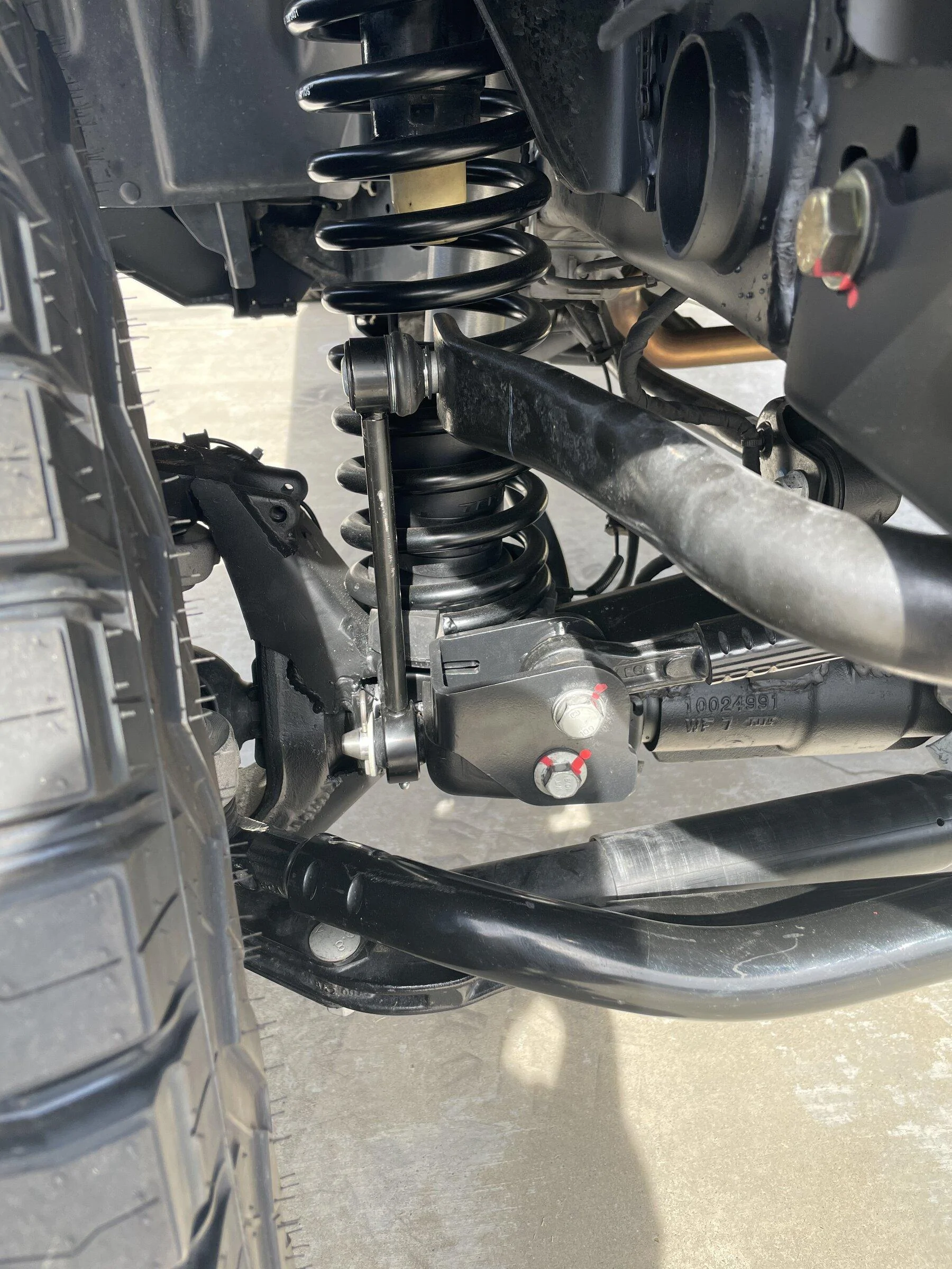

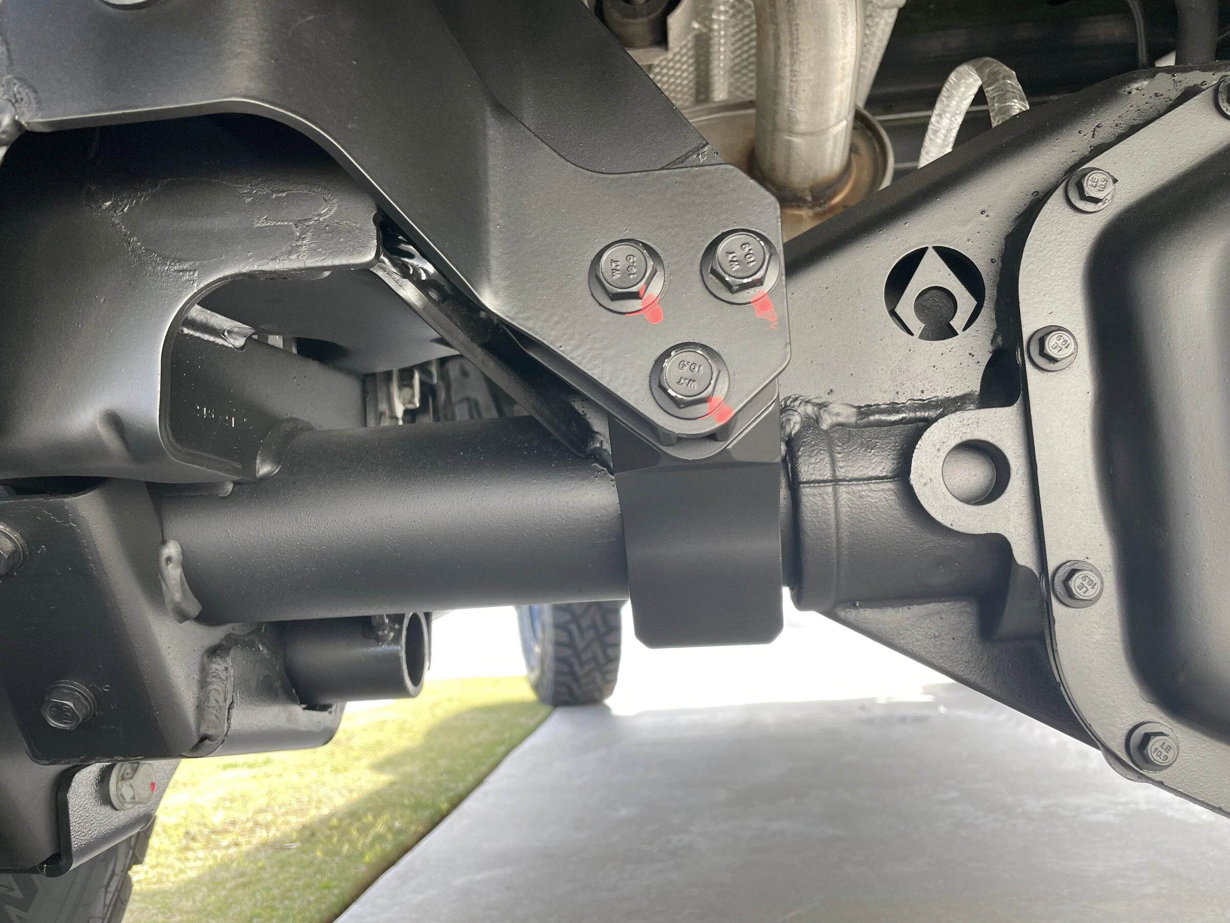

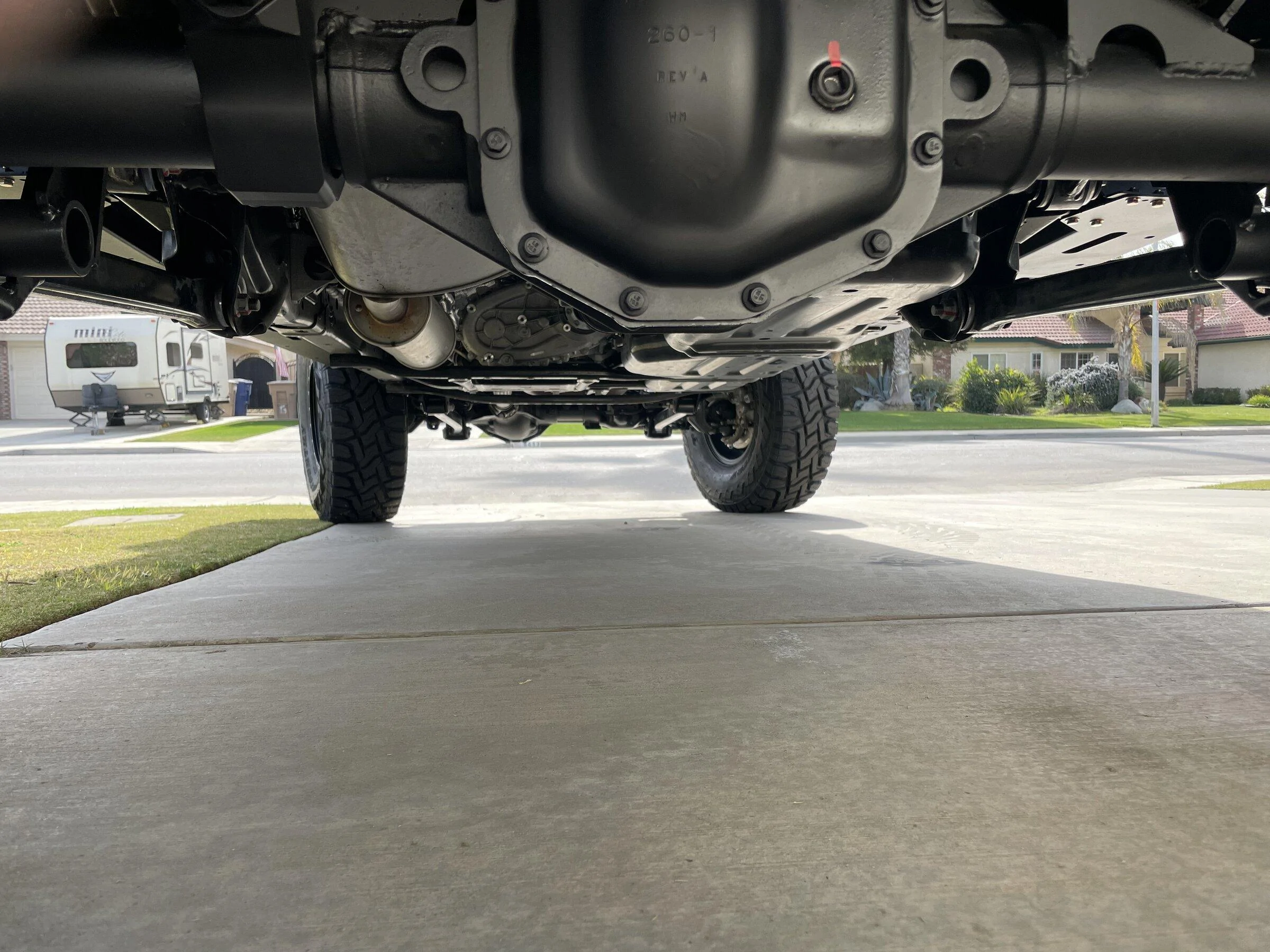

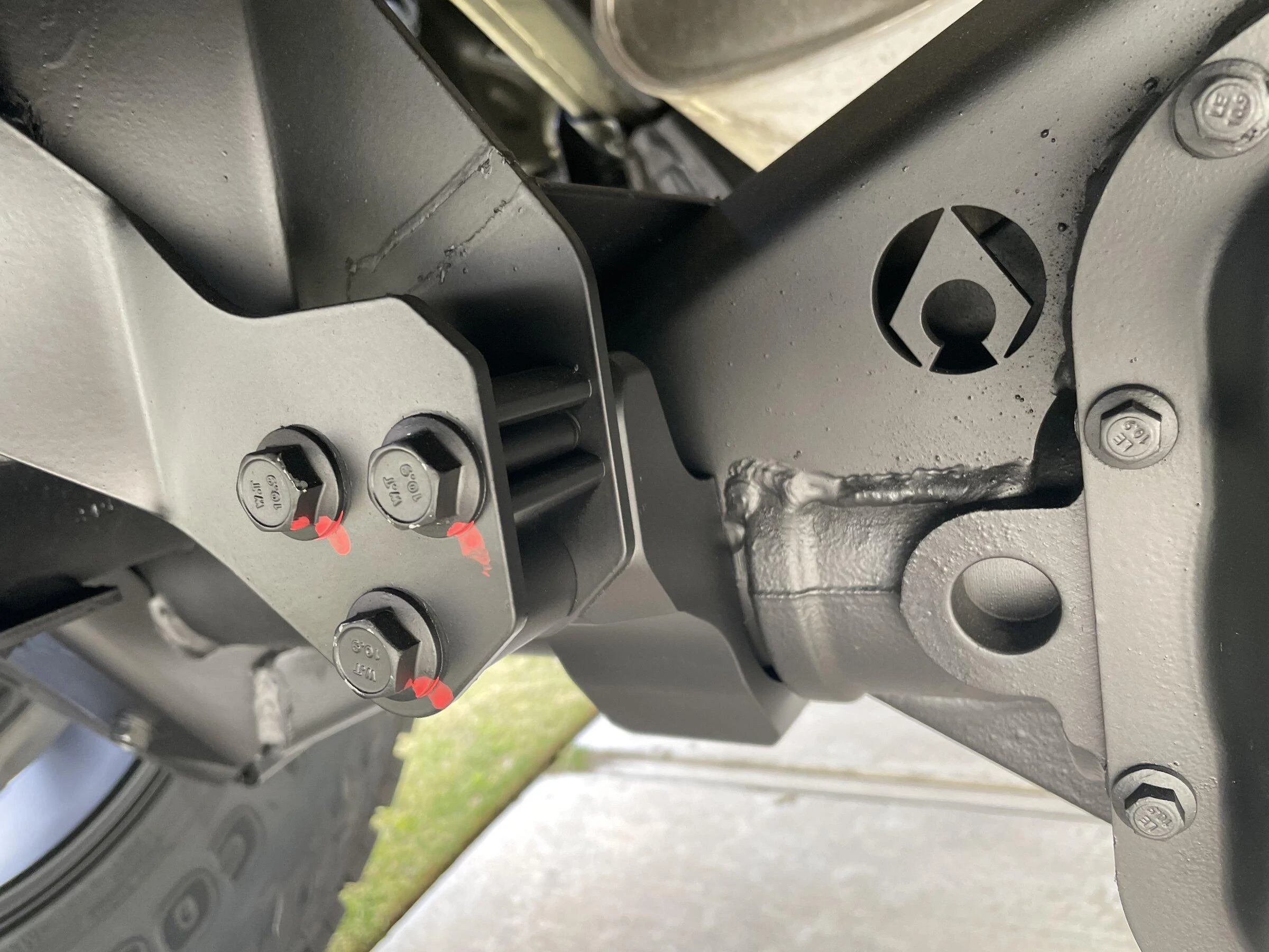

The trussing front and back turned out great, although it presented some challenges. Up front the c-gussets rub ever so slightly on the larger Teraflex coils and had to slightly modify the plastic seats the coils sit on. Out back the Teraflex rear trackbar bracket had to be altered a bit and welded which really just makes it even more robust.

Looks like some very good quality work. Lots of nice paint for you to scratch up now!

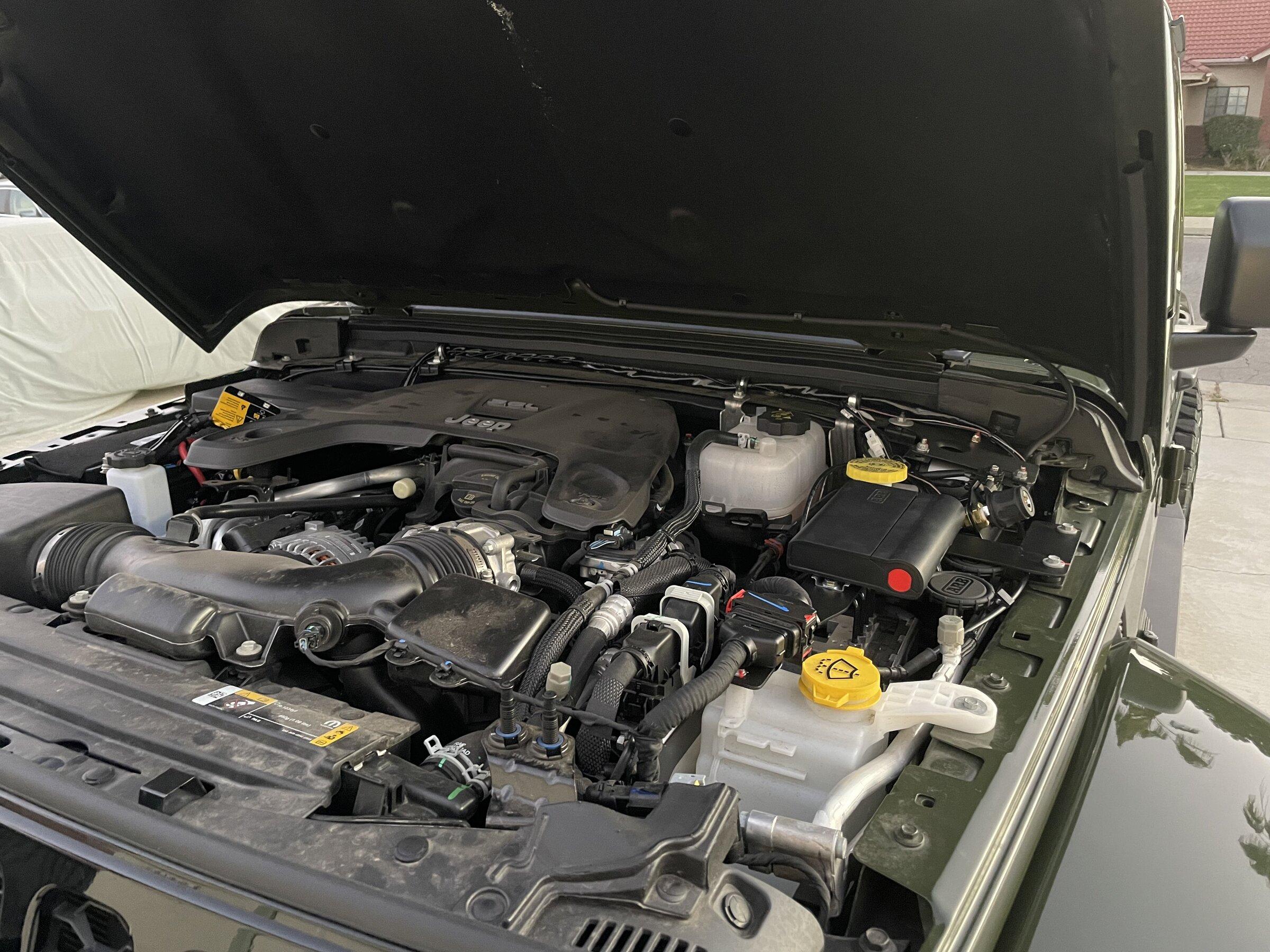

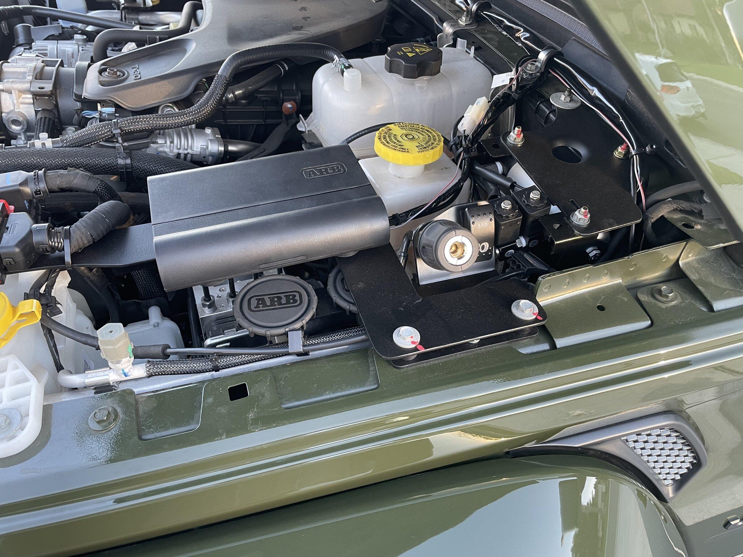

A bit on the ARB Linx. So in the pic I am posting below you can see the modified Grim bracket. The guys at 4wp Bakersfield custom built a bracket so we can mount the Linx brain high up in the engine compartment, on top of the Grim bracket. It turned out pretty nice and it is going to make wiring up lighting a breeze.
One other cool thing to note is the switch on the Grim bracket. My guys were able to wire it so you can activate the compressor using the switch in the engine bay and/or the Linx unit. One cool thing I figured out so far is the Linx will automatically kick on the compressor when selecting lockers. I also have setup the Linx so front lockers are only available after locking the rear. There is a lot of functionality to figure out with this unit.

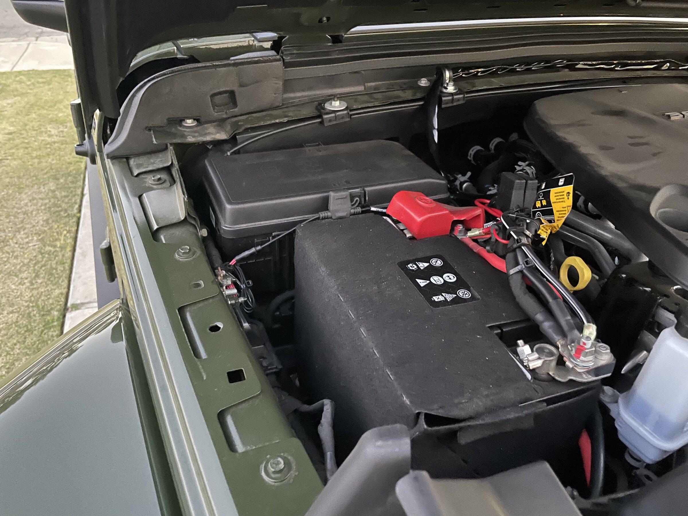

Some other angles of the work with install of the ARB gear. The wiring turned out clean seeing it was easy to run along the top of the firewall. Kinda annoyed seeing the guys did not wire the low/high beam and reverse light taps on the Linx. These make it possible to automatically turn on/off accessory lights (well really any accessory) based on those. Something to figure out soon seeing I will be adding some lights up front.

Clean install! There does seem like a lot to sort out around functionality. Have watched a few install videos and some of the arb videos plus the instructions. The effort looks worth the functionality

Thanks! Yeah the bracket turned out great with one minor hitch being I have to loosen it to get out one of the air filters. Adds a minute to that no biggie. I installed their bracket in the cabin yesterday will get you a shot when I get a break. I also figured out they did not wire up the light taps so I need to go and talk to them about that. Have lights on order so we’ll probably sort it out then. Thinking of adding KC cyclone lights under to give some better trail lighting, and will program those to trigger on reverse. Overall I am happy so far just a few minor bits to work out.

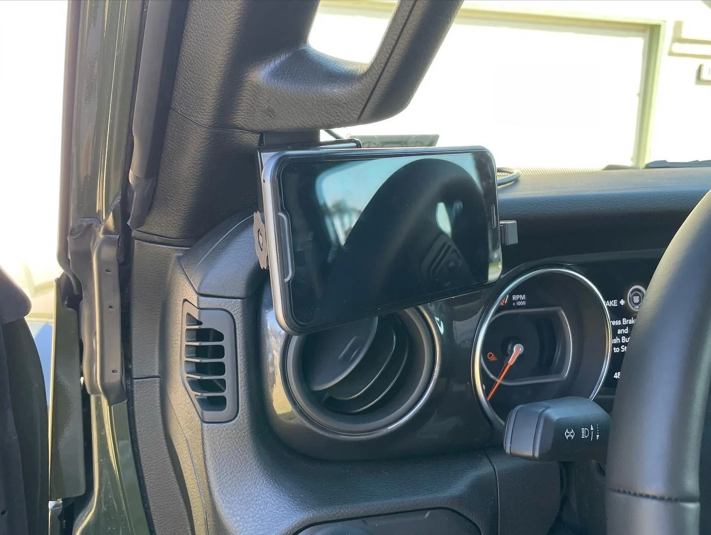

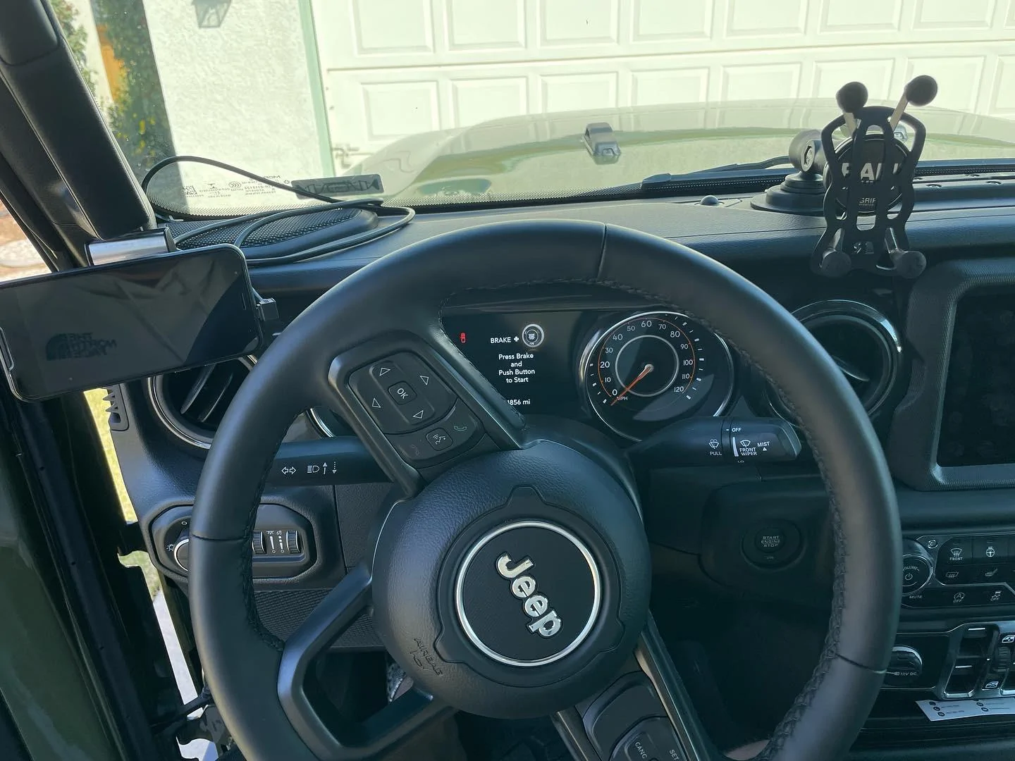

Pics of ARB’s bracket to mount the Linx head unit in the cabin. It took me around 30 minutes to get this done mostly due to lack of knowledge and instruction.
