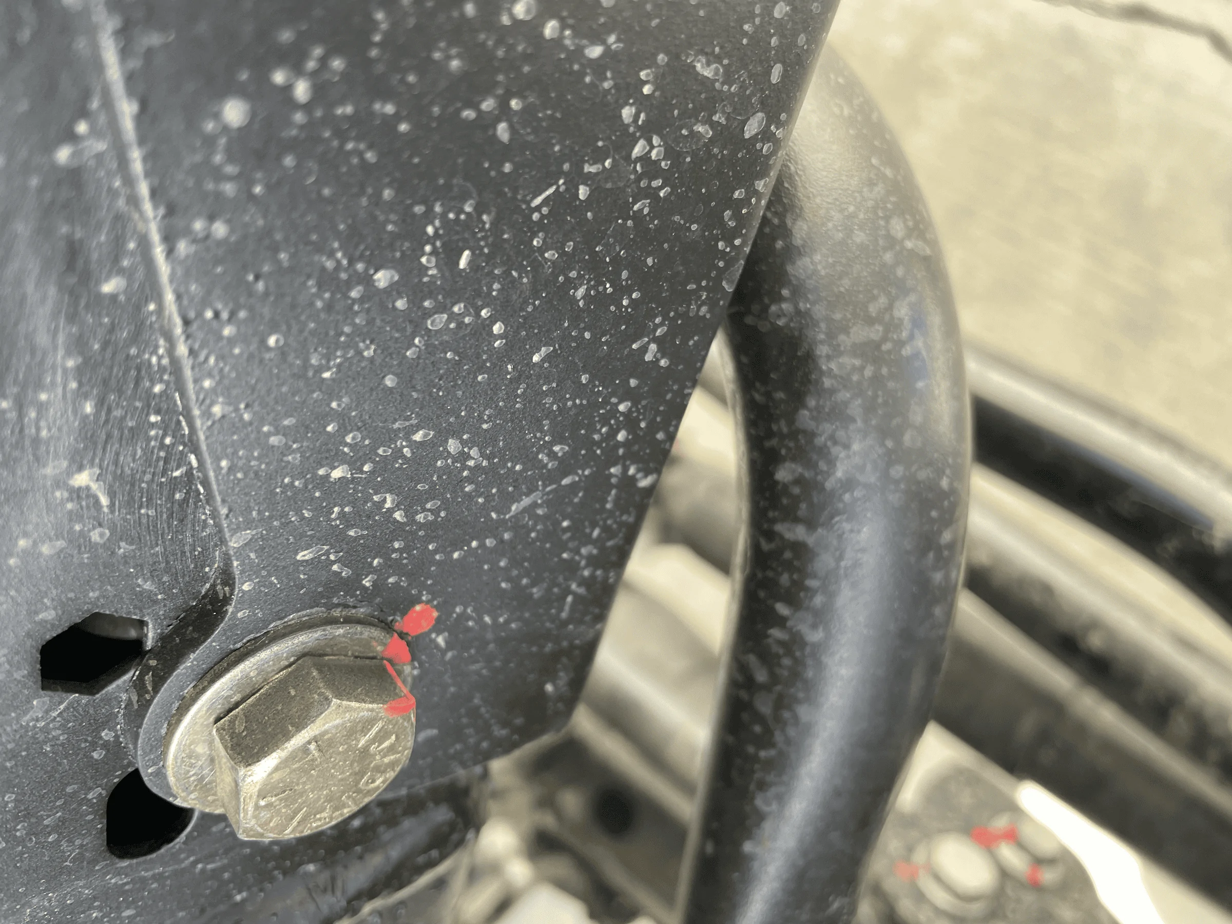

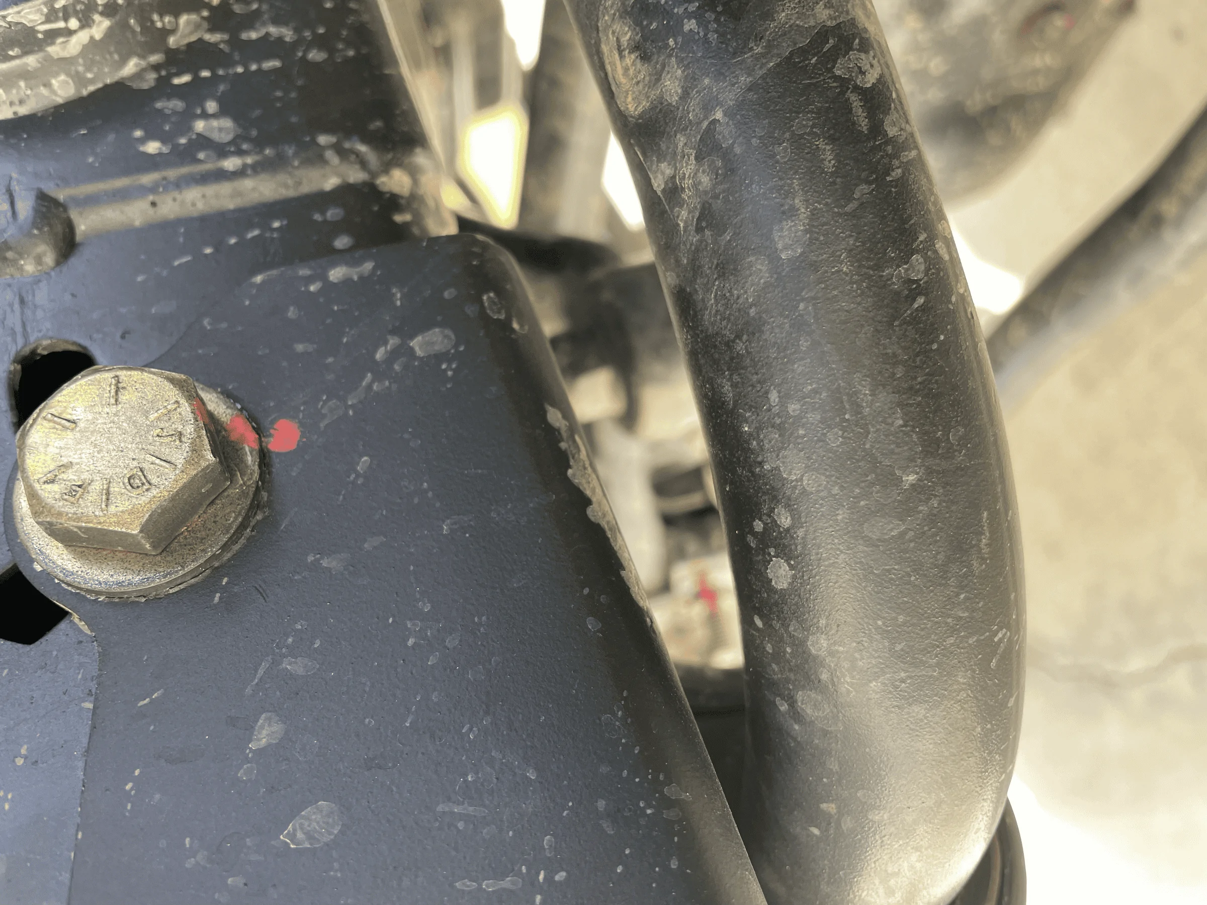

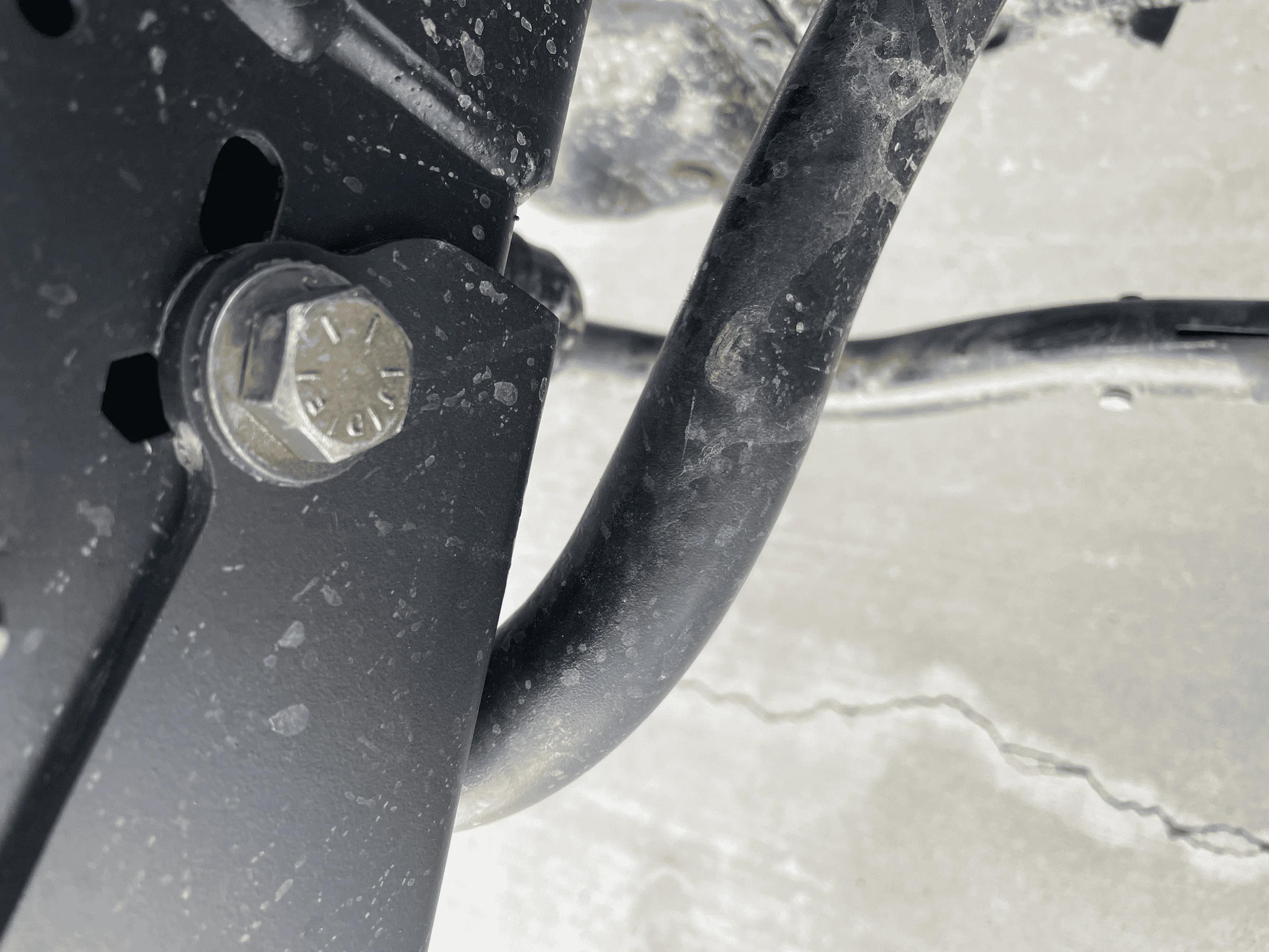

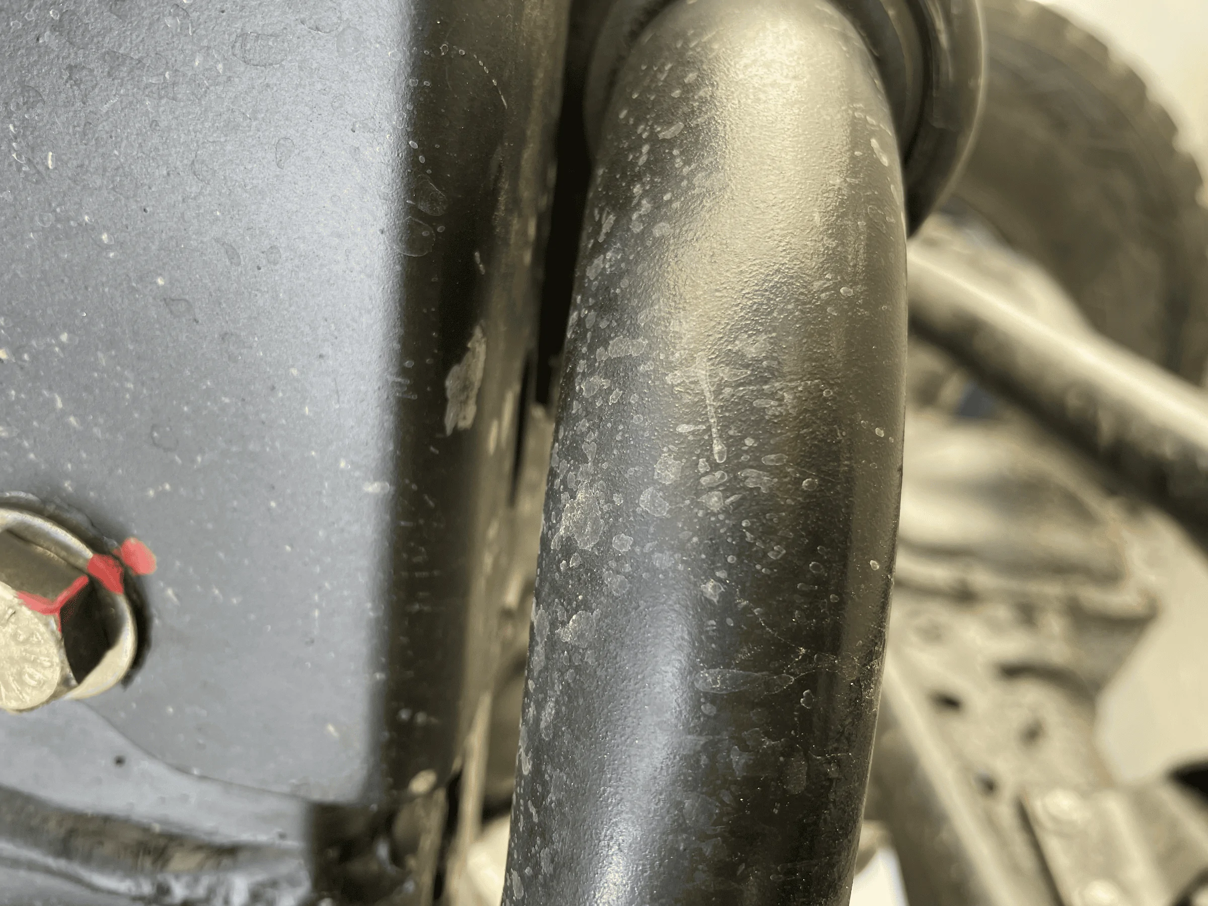

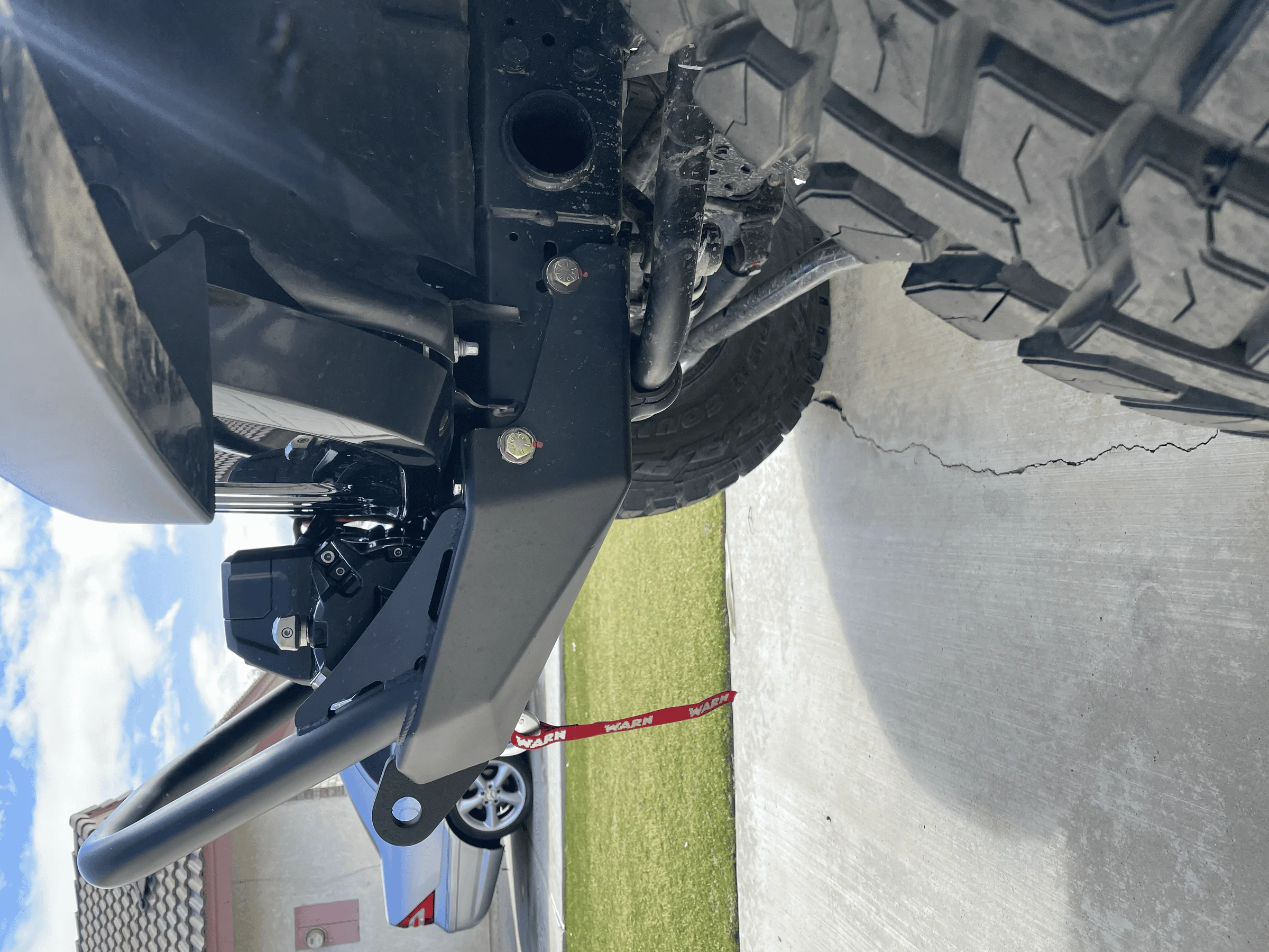

I decided to go with front and rear Anti-Rock sway bars. Due in part to my front bumper choice. It turns out that the front sway bar didn't line up quite right. I needed to use some washers or make a shim to drop the mounting of the sway bar to the bumper down about 1/4" or so which would prevent the rubbing seen in the photos.
Second issue was we didn't get the brackets that are supposed to come with the Teraflex sway bar disconnect kit. These brackets set the point where the end links attach about 2" higher than were we have them now. We ended up putting the attach points in the place where JKS would have you do it. Had to grind off the tab used to mount the stock end links to make it work (same as JKS install). The problem going this route is the Teraflex links are too short and therefore you can see in the photos the sway bar is just below level. Of course you'd want it just *above* level in a proper installation. Rather than go through the hassles above decided to do the anti-rock up front.
An aside I talked with an engineer at Motobilt about the issues with the rubbing. After some back and forth he said when they mocked it up they used short end links and they didn't ever run into the problem but that he could see how it was a problem. His suggestion was to do the washers/spacers or to go with the anti-rock which is what everybody with this bumper seems to run 🤷‍♂️ I got credited back the cost of the disconnects by 4wheelparts which was nice.
The rear anti-rock was more a decision based on not having a rear sway bar right now. Teraflex did not send the longer links for my 4.5" lift. They would be sending me eventually their new rear sway bar kit which includes a setup very similar to an anti-rock. Being I'm now going with the front anti-rock, and I was not wanting to wait any longer, I pulled the trigger on the rear anti-rock. It is quite a bit more than the Teraflex offering, basically double the price. It does look nicer but I assume functionally it'll be the same thing but we shall see.

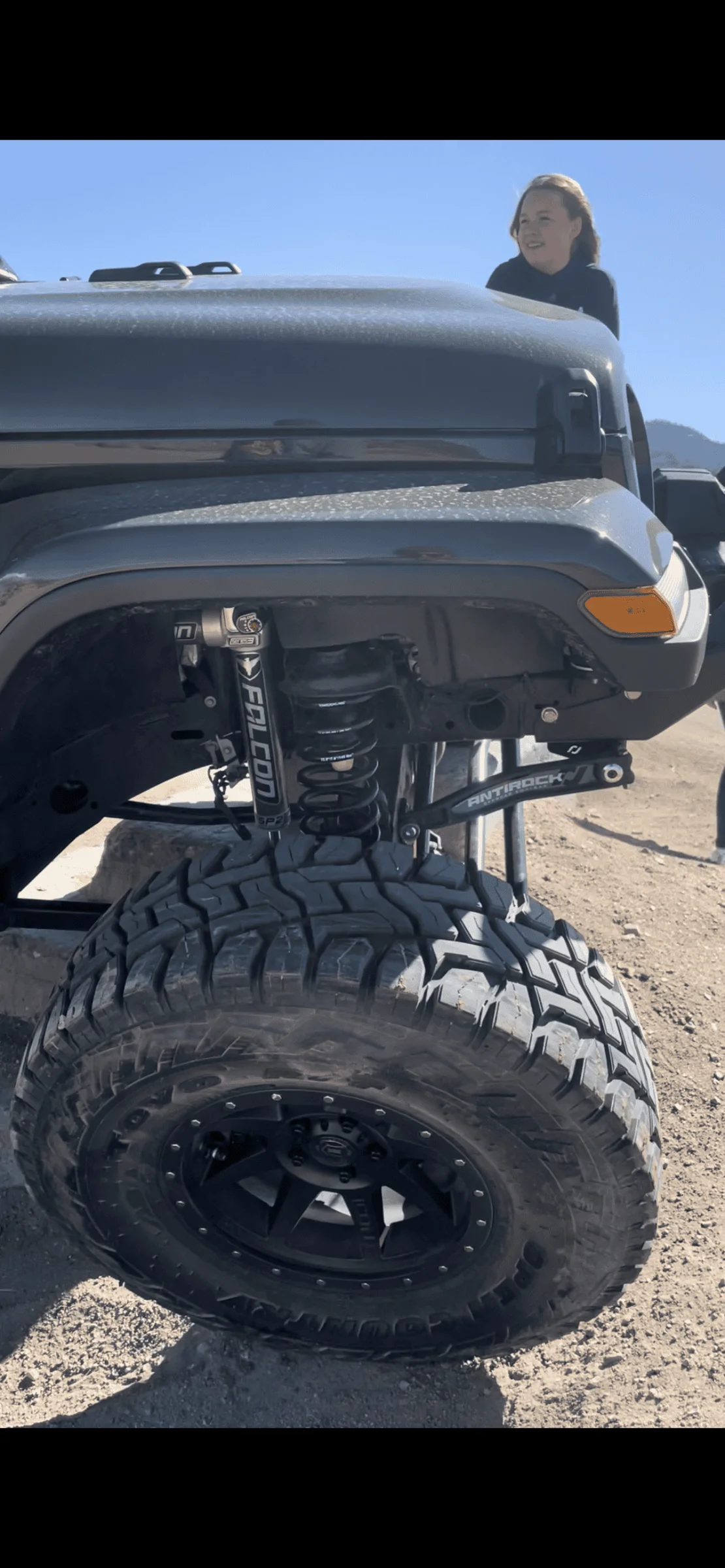

Falcon sp2 3.5 eAdapts are installed. The wiring needs to be run and connected. they are massive and look cool too lol. I almost swear the Chadiator sits slightly higher, like 1/4” or so, on these as opposed to the Fox. The mode selector switch fits seamlessly into the A-pillar and I am starting to think I have too many screens/buttons/switches/controls. Its kinda becoming tech overload. Would be cool if the Linx could do the job of managing the Falcons modes. The Fox 2.0 IFP look brand new as they should. Will be listing them for sale soon.

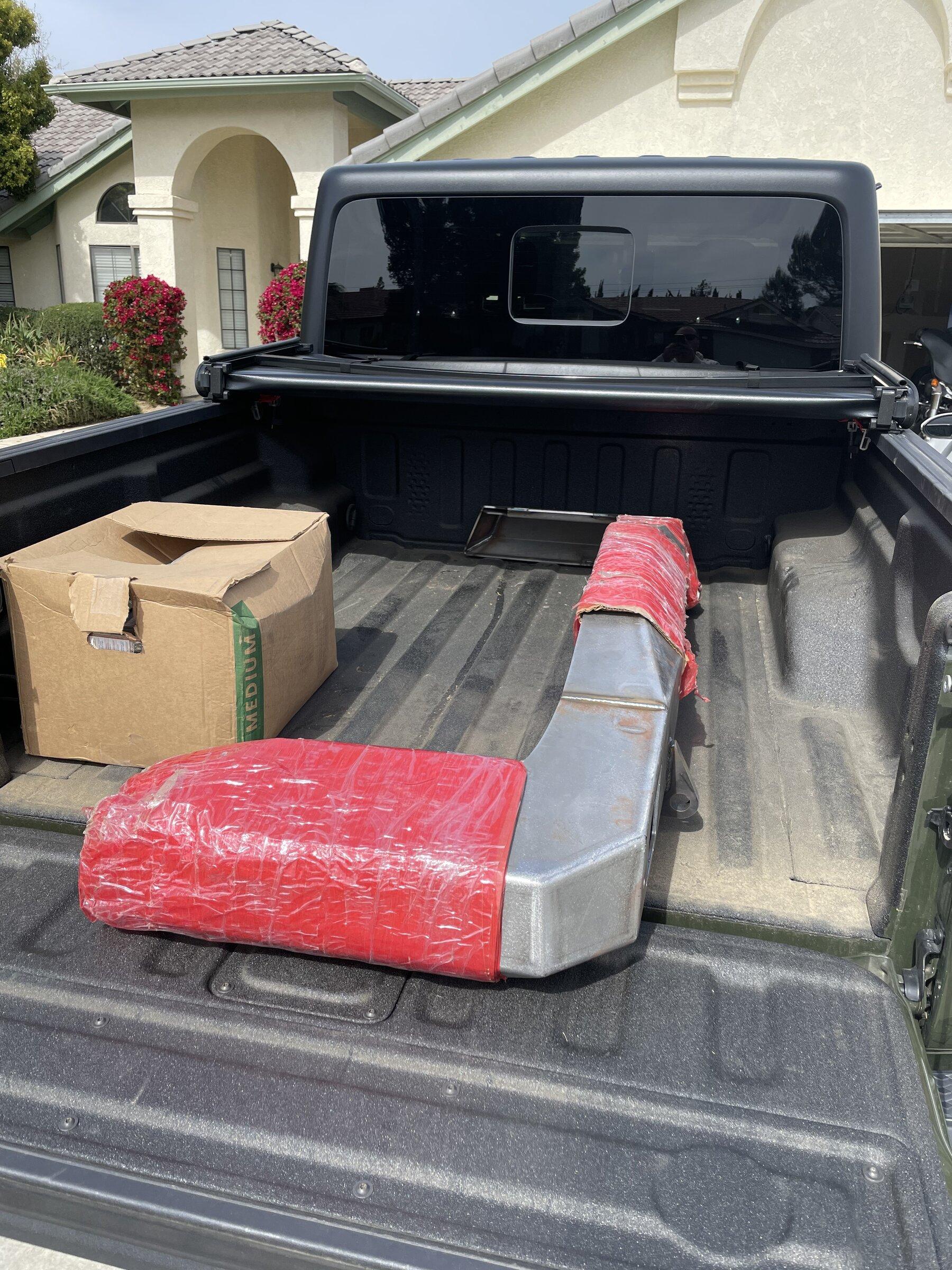

Motobilt is having a 10% off sale on all their bumpers. I liked the build of the Tomahawk up front so much that I'd been considering their Crusher rear. Well I now have this bumper ordered and on the way. The bumper wraps fully around the bed to the rear fenders and sits out a bit. Should offer a lot of protection in the rear which is the only place I'm lacking. I liked the Fab Fours JT bumper too, it offered the same set of features and protection the Crusher does, but the Crusher is a little more the look I'm going for.

This Beauty is on its way to be powder coated. Motobilt Crusher its freaking huge. I am glad I finally got to put my deadlifting skills to work in the real world lol.

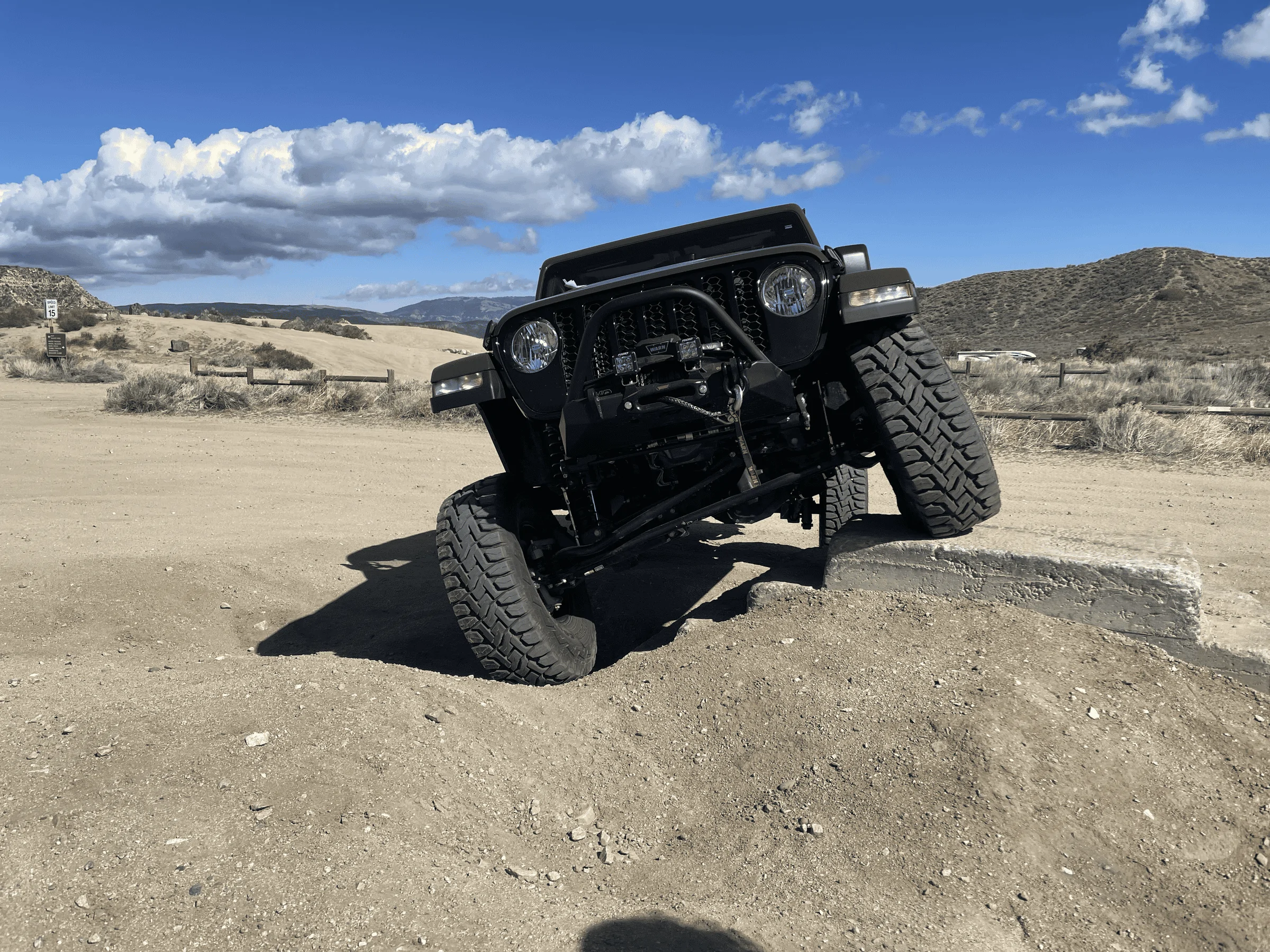

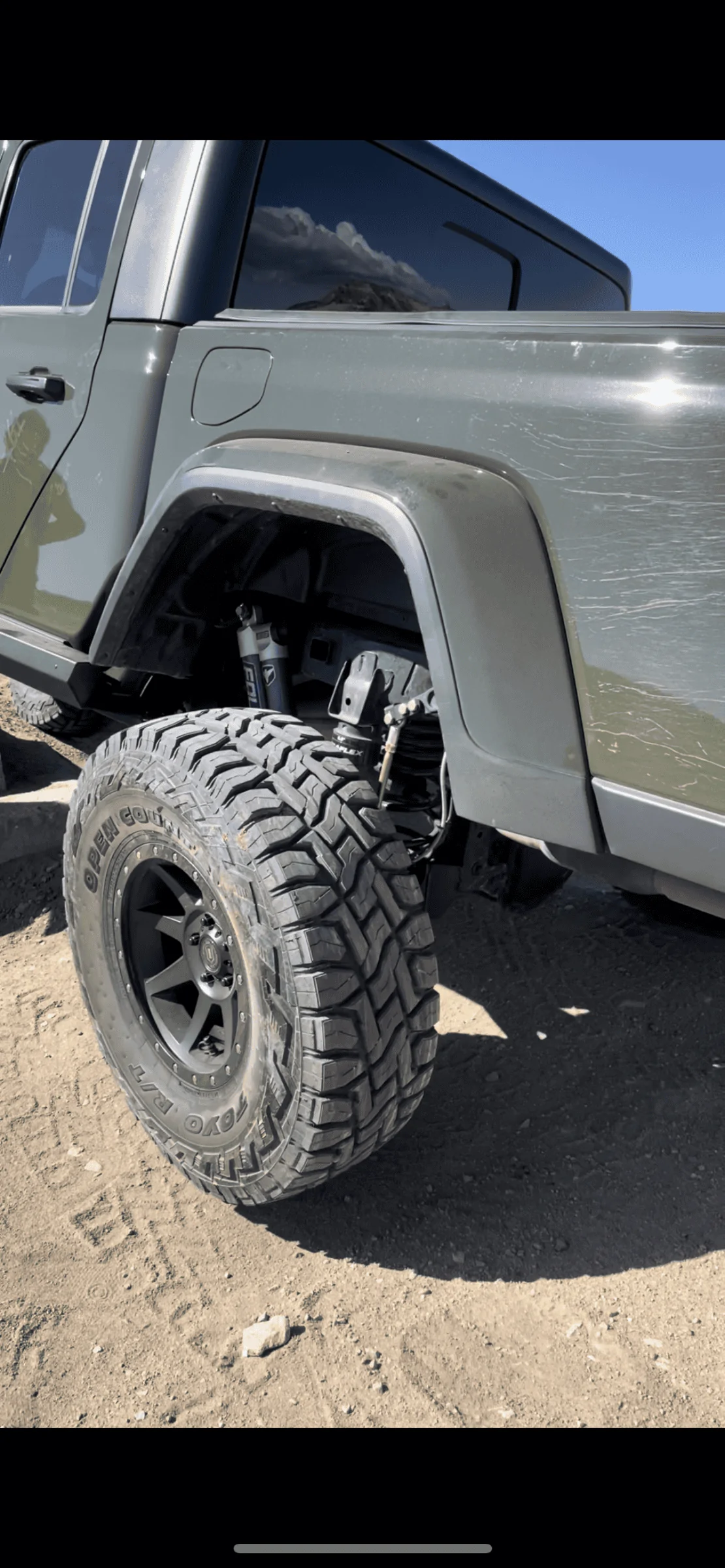

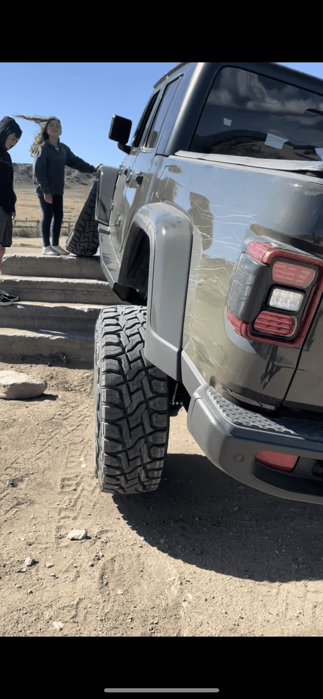

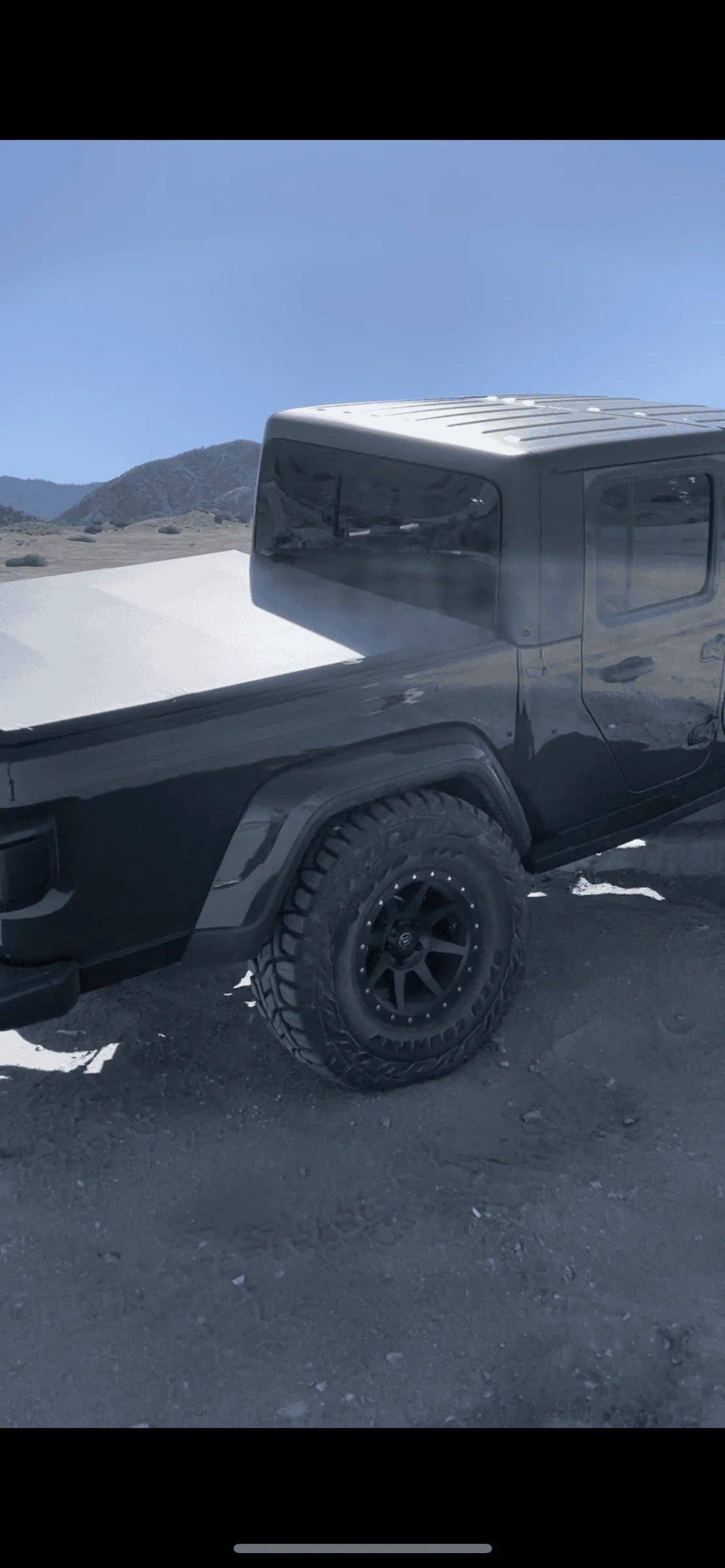

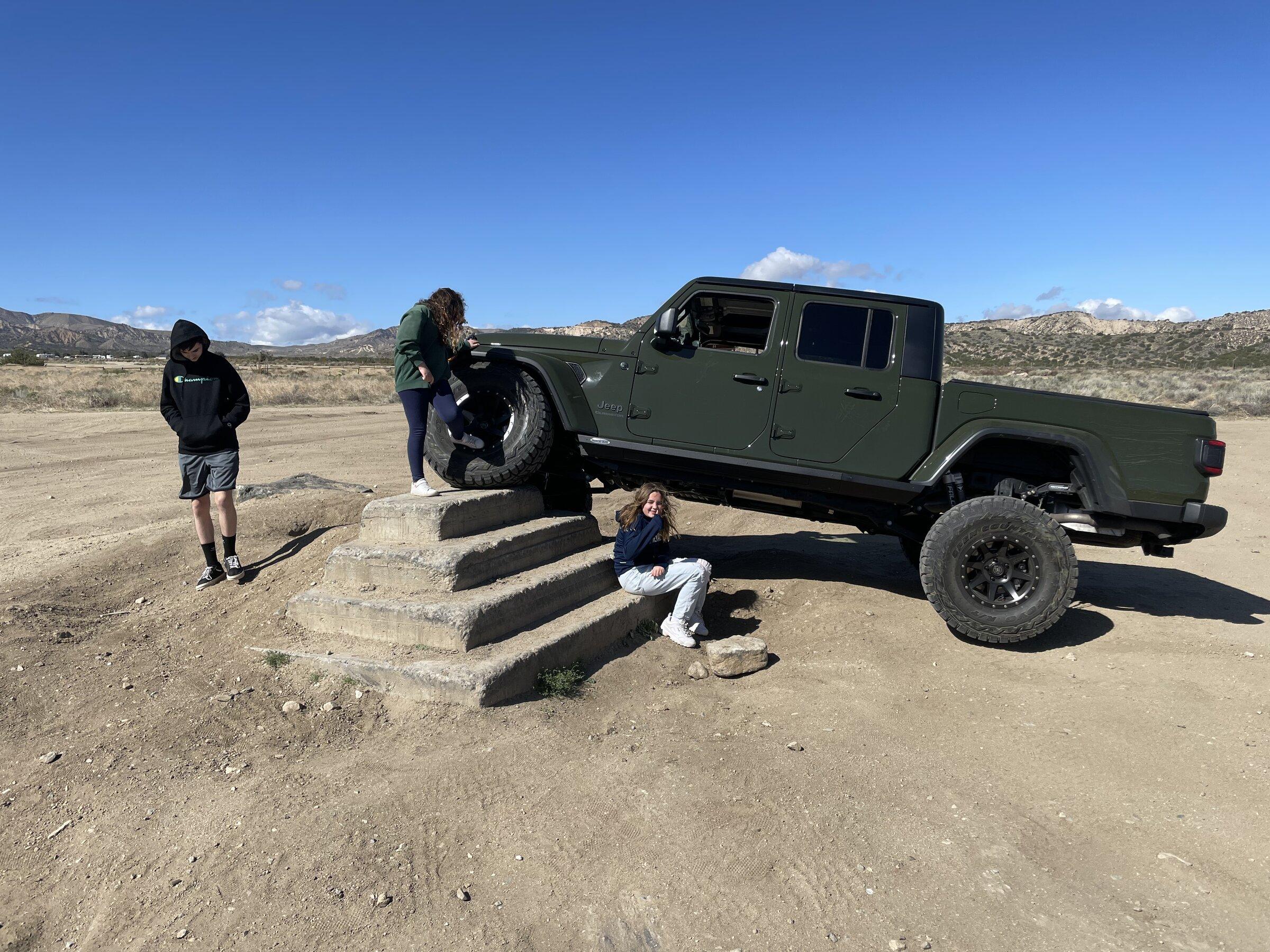

Some pics from today did some light wheeling at Hungry Valley nearby. Got to put the new Falcon sp2 3.5s to work as well as the anti-rocks. The Teraflex Delta brakes also got a real test doing some climbs and descents.
