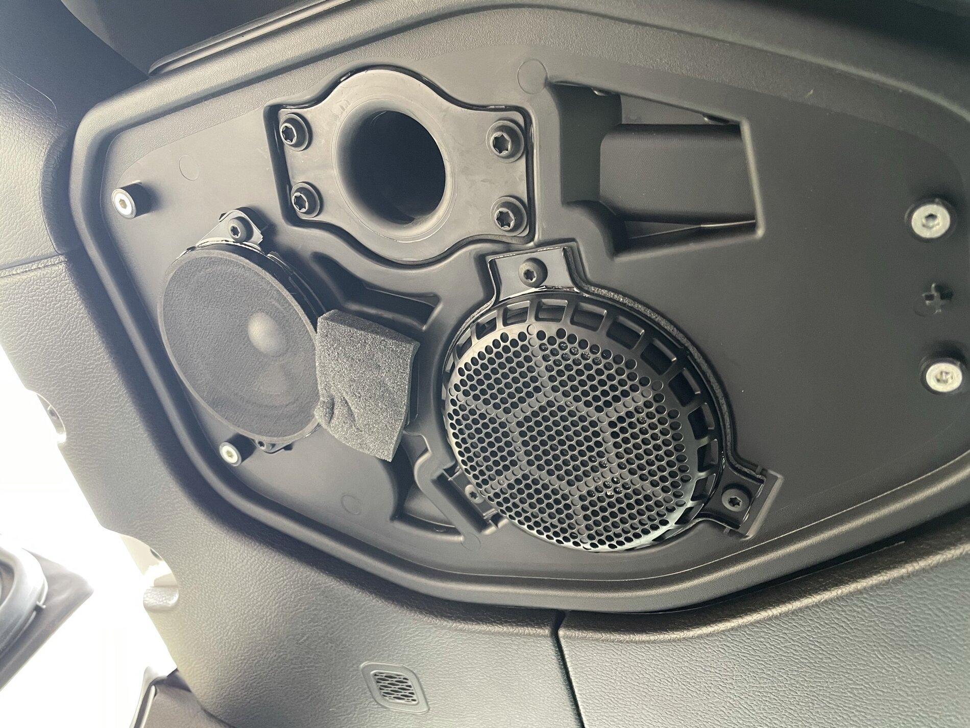

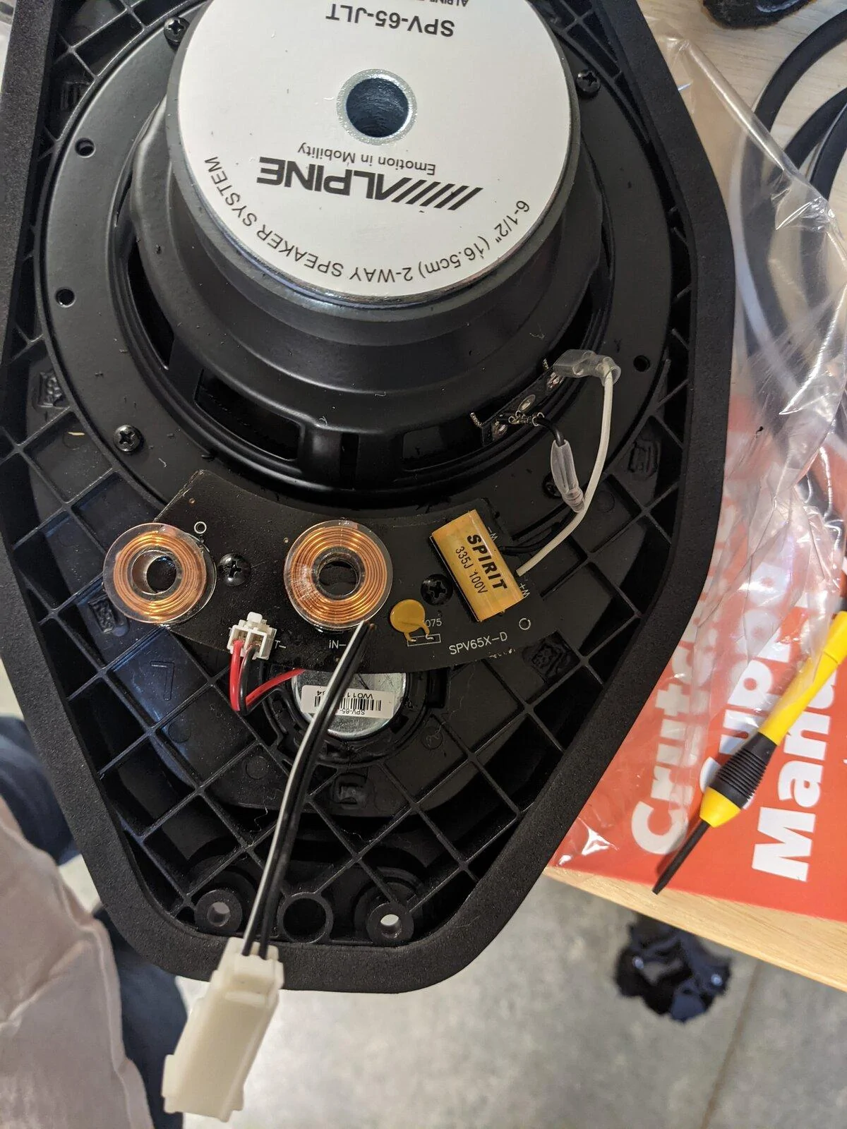

Those are the adapters you used? Why not plug them into the larger speaker as opposed to the mid?
There is a built-in crossover with one connector. Plug the small speaker to the oem harness for the small speaker, disconnect large speaker from crossover and use the crutchfield adapter to connect to the other one harness connector (don't use crossover connection).
Back of new speaker without the crutchfield adapter:
Jeep Gladiator School me on upgrading system PXL_20201230_170106681
Im trying to order via Crutchfield. How can I find the crossover adapter? If I enter 2020 JT for model w/ 8" UConnect, it says the SPV speakers won't fit. On Quadratec, in the parts included list it mentions "Crossover Wiring Pair". Is this the same adapter as Crutchfield?
When you add the speakers to the cart, it added the "aftermarket" stuff and it included the Metra 72... Adapter (see page 2 of this thread).
You want to unplug the white/black cable from the new large speaker, then use the Metra 72... Adapter and plug to oem harness where the old large speaker connected. Connect the small speaker to the oem harness where the small speaker was connected.
