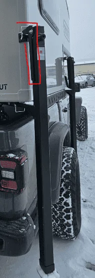

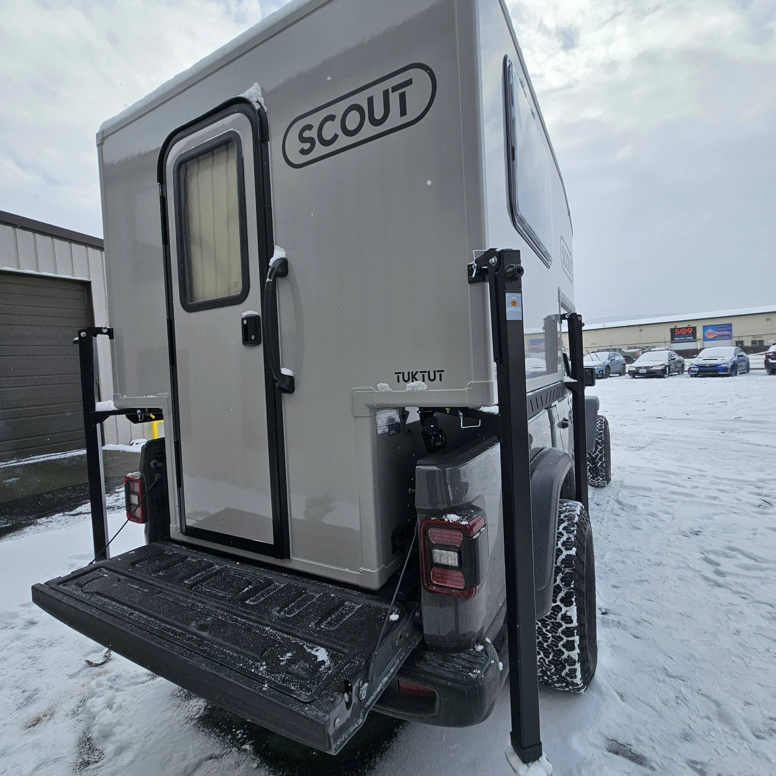

I'm sure you will love your scout .
I picked mine up friday and believe was the first retail delivery. If you have any questions or want pics , let me know.
Depending on your wheels offset , I don't see 37s going in. I have 17in wheels with offset -18, 35s and it was basically mms of space left between the Jack's.
These Jack's are amazing though. Worth it 100% . They come off so easy. The trip home will be heavier but once it's home, remove the Jack's in seconds and can take the camper off easy after the trip
One of the best thought out designed campers that are with in gladiators center of gravity needs.
Jeep Gladiator Scout Tuktut - Official Thread 20240112_104000
Your Jeep looks great and I can't wait to see if more people start purchasing. In regards to the jacks, yes, they are fantastic and super easy to use. I won't leave mine attached and will probably just use them at home most of the time. I noticed in you photos that you have the jacks in the "slim" setting meaning that they are tucked-in to the camper as close as possible. They have a wider stance if you flip out the top bracket leg. Yours are currently folded down. You may already know this but I wanted to call it out :) I leave the rears jacks in this configuration but "extend" the front jacks out to clear my 37's and fenders. It's still close though when loading and unloading. I have 17x9" Methods with 0" offset for reference.

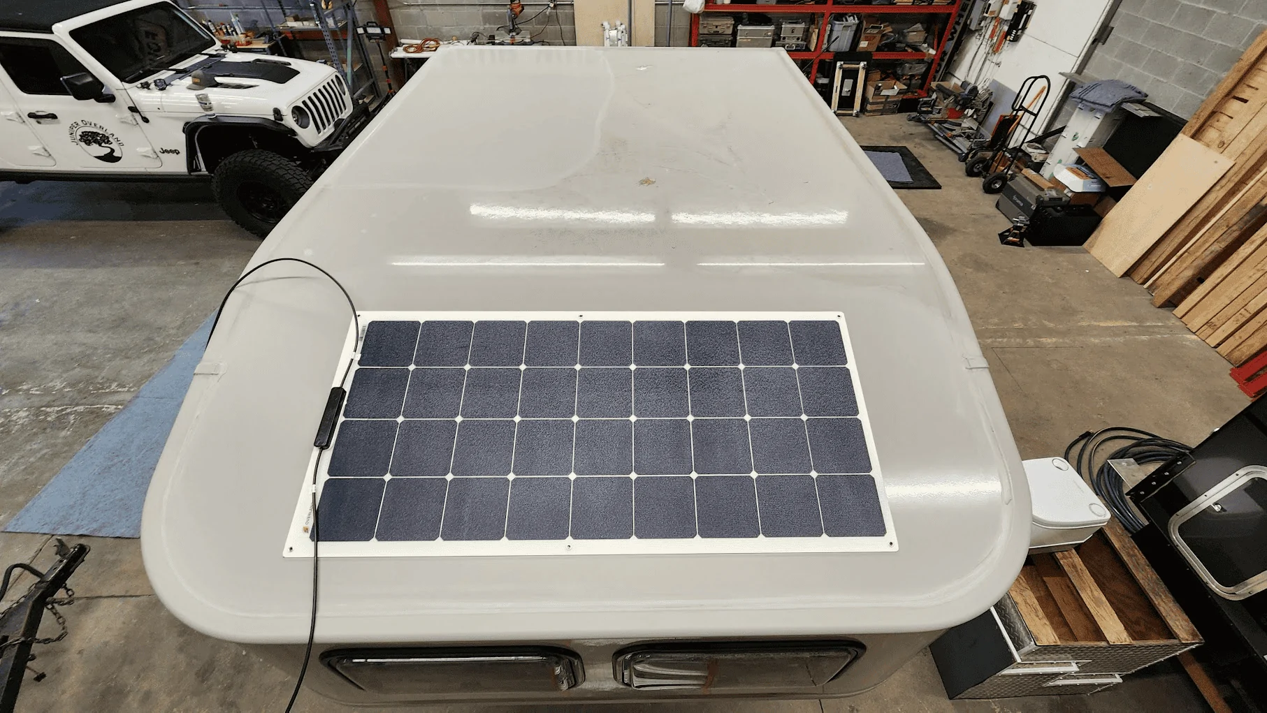

Buildout has been kind of slow lately, but I added an Overland Solar 130W ETFT Semi-Flex panel last night. It's secured with 3M VHB tape and I'll also run a bead of Sikaflex around the perimeter. Plan on using a Scanstrut cable seal to run the wires into the camper.
Jeep Gladiator Scout Tuktut - Official Thread 1708448253051

Looks great! I was planning to do the same thing on mine. I just didn't know If I wanted to run it in or connect it to the external plug it came with .
Wish it came from factory like the YOHO

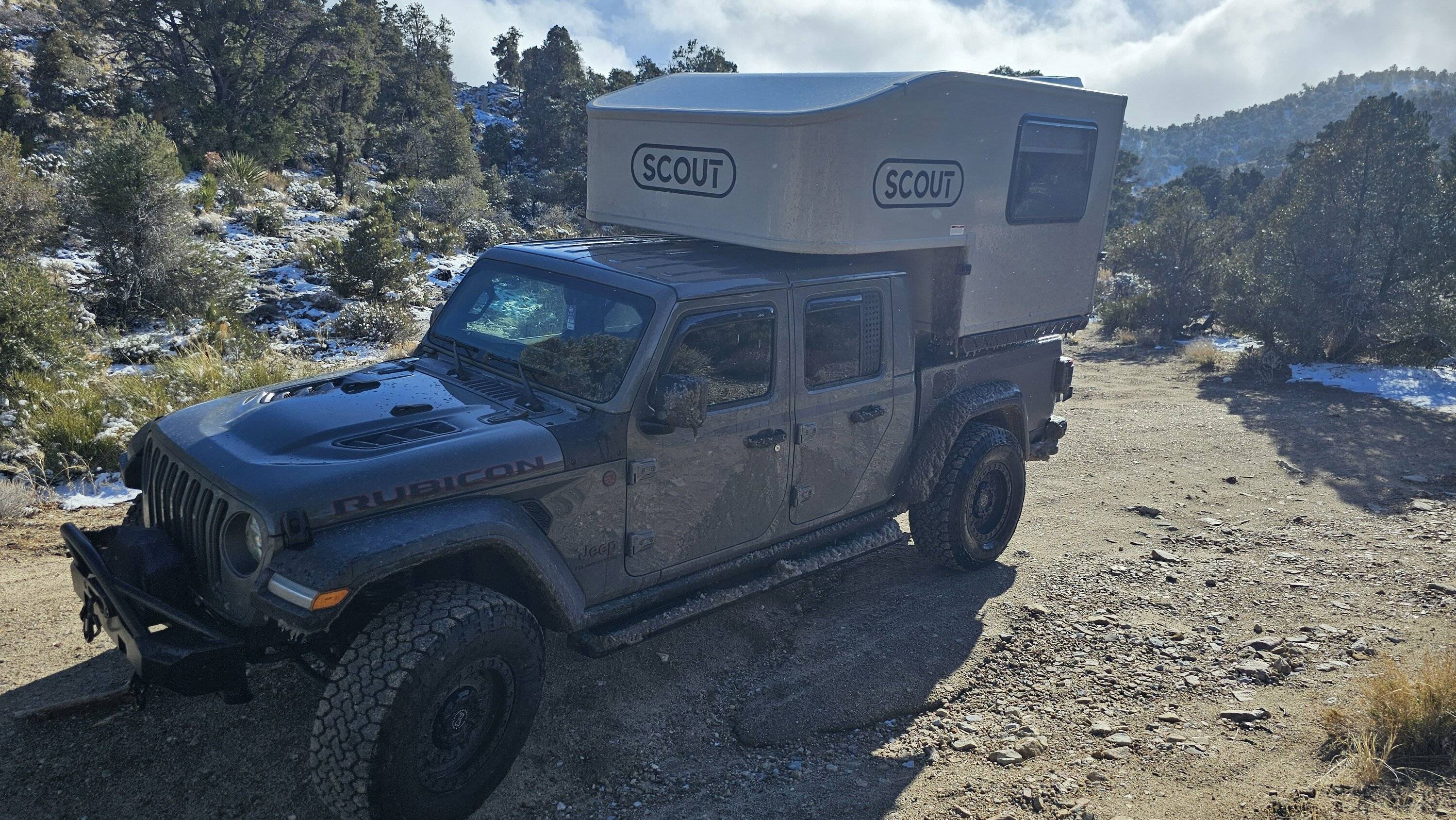

Iv taken this thing everywhere already. Many snow trips and mountain driving Probably 4k miles of driving with it on .. Average 12-13 mpg. Not to bad. This was just a small 3/10 trail.
Jeep Gladiator Scout Tuktut - Official Thread 20240207_135505(0) (1)
