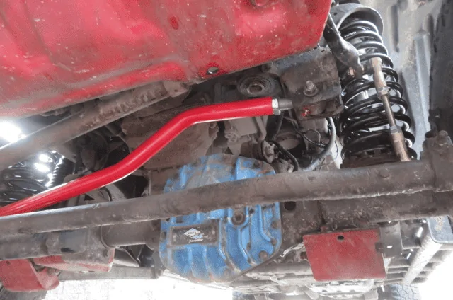

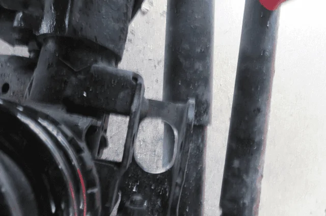

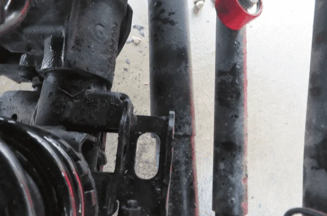

I have the SteerSmart brace and the Core 4x4 track bar. Didn't have any problems with the install or operation of it. What I had to do with the Core track bar was to enlarge the hole on the bracket on the axle.
Jeep Gladiator Sector Shaft brace compatibility 1692928100683
Jeep Gladiator Sector Shaft brace compatibility 1692928133215
