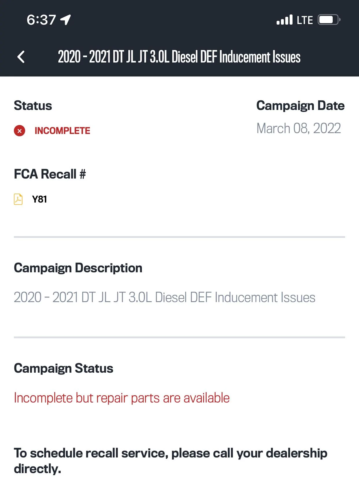

The new software update is supposed to have something to do with lack of DEF usage as I understand it. My truck has only used like a gallon of DEF in 5,000 miles, which is why it was originally scheduled for the TSB turned recall software update.
As for warranty, they’ll have a pretty hard time claiming you put dirty DEF in it. I’d give a quick call to Jeep Cares if they try that stunt.

There’s a PCM update out now in form of a recall for this.

Jeep Gladiator Service DEF system see dealer warning message 28B02581-9C8E-4F7C-8B2C-CBD28C024D15

Got mine back. Had code p208b-00 and p20c6-00. There was a star case s2118000006 which they performed and did the Y81 recall and said that should fix it. Somehow I have my doubts. Its going to be around 0 tonight so I'm leaving it out and going for a long drive and see what happens.
