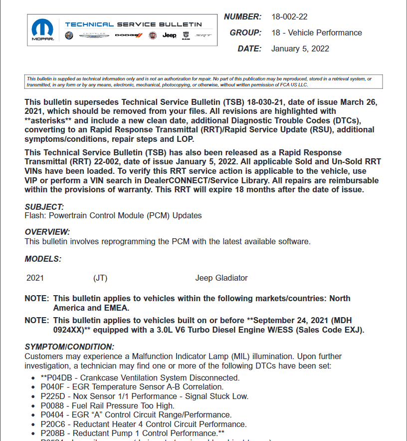

last week codes p20c6 & p208b with the truck will shut down in 200 miles & will not restart service def , they tested per star told jeep knows but no update currently run it
Last friday p20c2 cleared code after calling dealer making appt. For tues , Monday on way to work new CEL code p208b & engine will not restart in 165 miles service def , which on way to dealer message went off , CEL didn't
dropped off Dealer called said there was an update now TSB 18-002-22 haven't been able to find sent a message to jeep cares for a copy
Reprogram pcm from 68520201ad to ae will see what happens Tomorrow on the way to work

I called my dealer to take my JTWD in due to the latest DEF fail, and he confirmed that TSB 18-002-22 is out, and references the P208B error code.
They are going to do a software update, I hope this is the fix.
