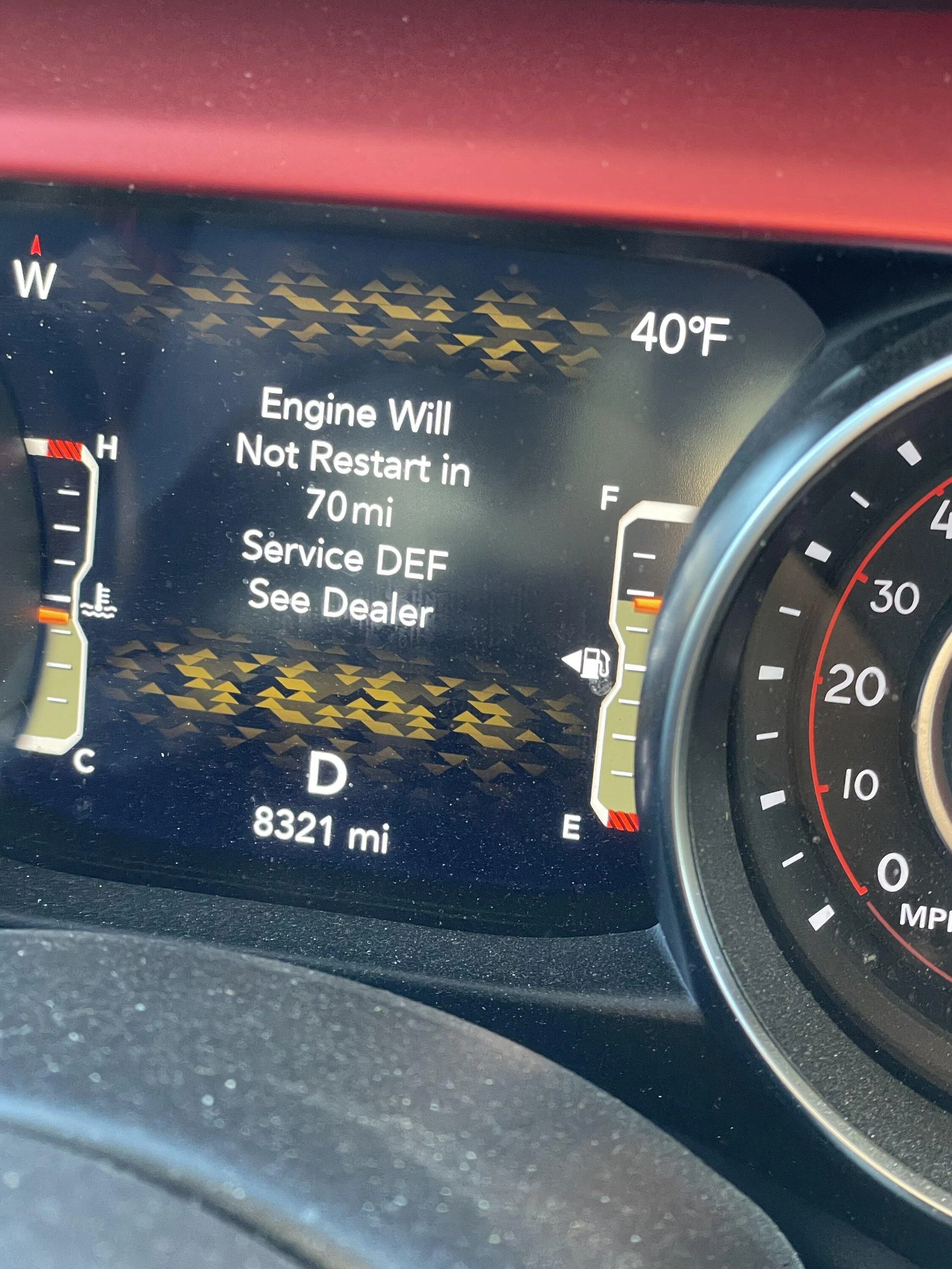

I have gotten the ā€œ150 miles till no restartā€ message two different times while we were up at our cabin in June Lake. High elevation(7600) and colder temps. 1st was around 3500 miles second was around 5500 miles. Both times the message disappeared after turning off the next day… Now with 8000+ miles it has actually gone to 13 miles before no restart and so I have had it towed to Carson City Nevada to the Jeep dealership. PITAss!! I’ll let you know what the prognosis is when it gets assessed.
Def full and you drive it like you stole it to warm it up?

Yes filled it up when it said I had 75 or so miles remaining. It was about 1/2 full and I added another 2.5 gallons of premium blue DEF and drove on shoulders and the ā€œwake upā€strip on the side of the FWY on and off for 50 miles to try to shake up the tank and nothing…?
