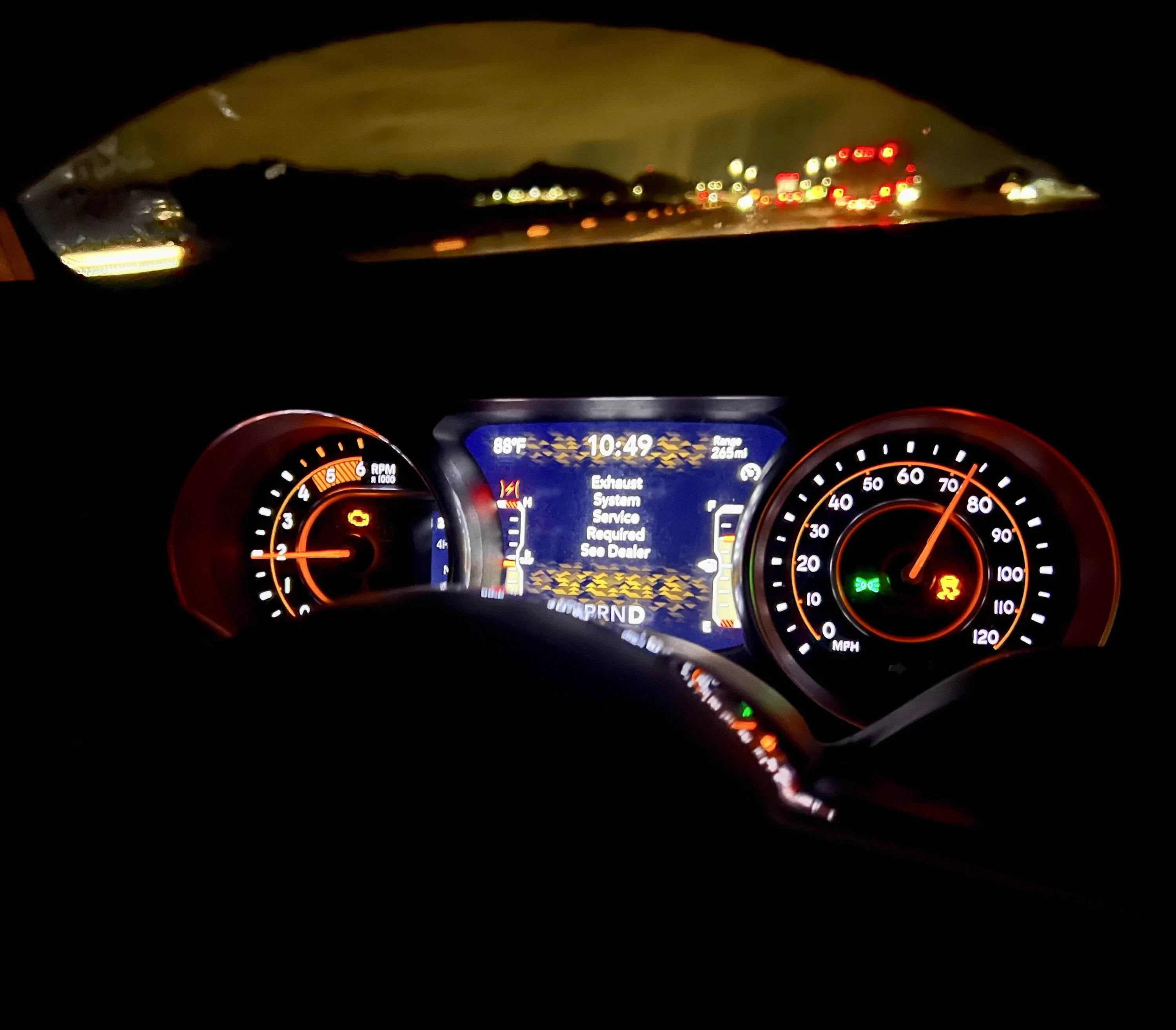

Hey everyone, recently bought my JTRD - haven’t even hit 3k miles yet and had a warning of “Exhaust System Service Required, See Dealer.” I use Hot Shots EDT every fill up, rarely idle, and was on hour 8.5 of a 9 hour drive from central CO to El Paso when this alert first showed up.
Sat in the dealership for a day while they troubleshooted and ended up forcing a regen.
I learned that there is no notification when the Jeep diesels begin a regen so I’m guessing I may have accidentally turned off the jeep/gotten gas during a regen.
Does anyone have recommendations for an aftermarket regen notification system or something that will work for this issue? This is my first diesel so I appreciate all the help I can get.

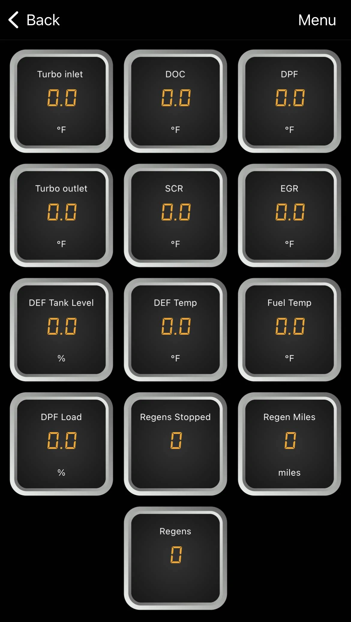

Get a Bluetooth OBD2 dongle and an app like Torque or OBD Fusion and create a panel like the one I used.
You can track regens, temps, etc…

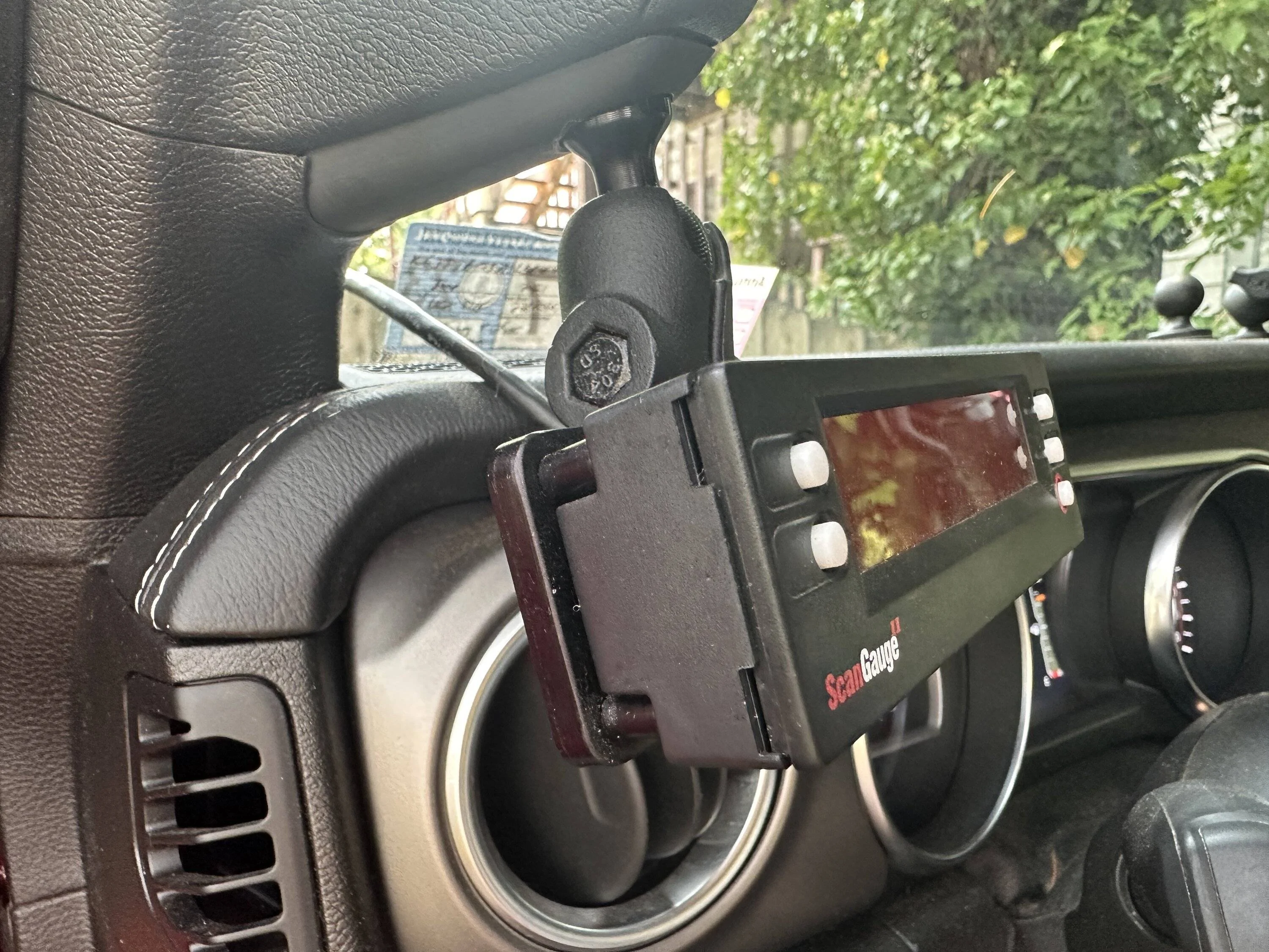

I’ve got this:
ScanGauge - SG2 II Ultra Compact 3-in-1 Automotive Computer with Customizable Real-Time Fuel Economy Digital Gauges , Black , 5 Inch https://a.co/d/2aV3BJk
I’ve got it mounted to the bottom of the grab handle with a CMM ball adapter and a ScanGauge RAM backing plate.
I tells me if I’m in regen but also the DPF % so I have an idea of when I’m likely to go into one. I frequently still don’t notice when I do but at least I can check before getting off the highway. Mine loves to start regens when I’m creeping up a trail at 5mph.

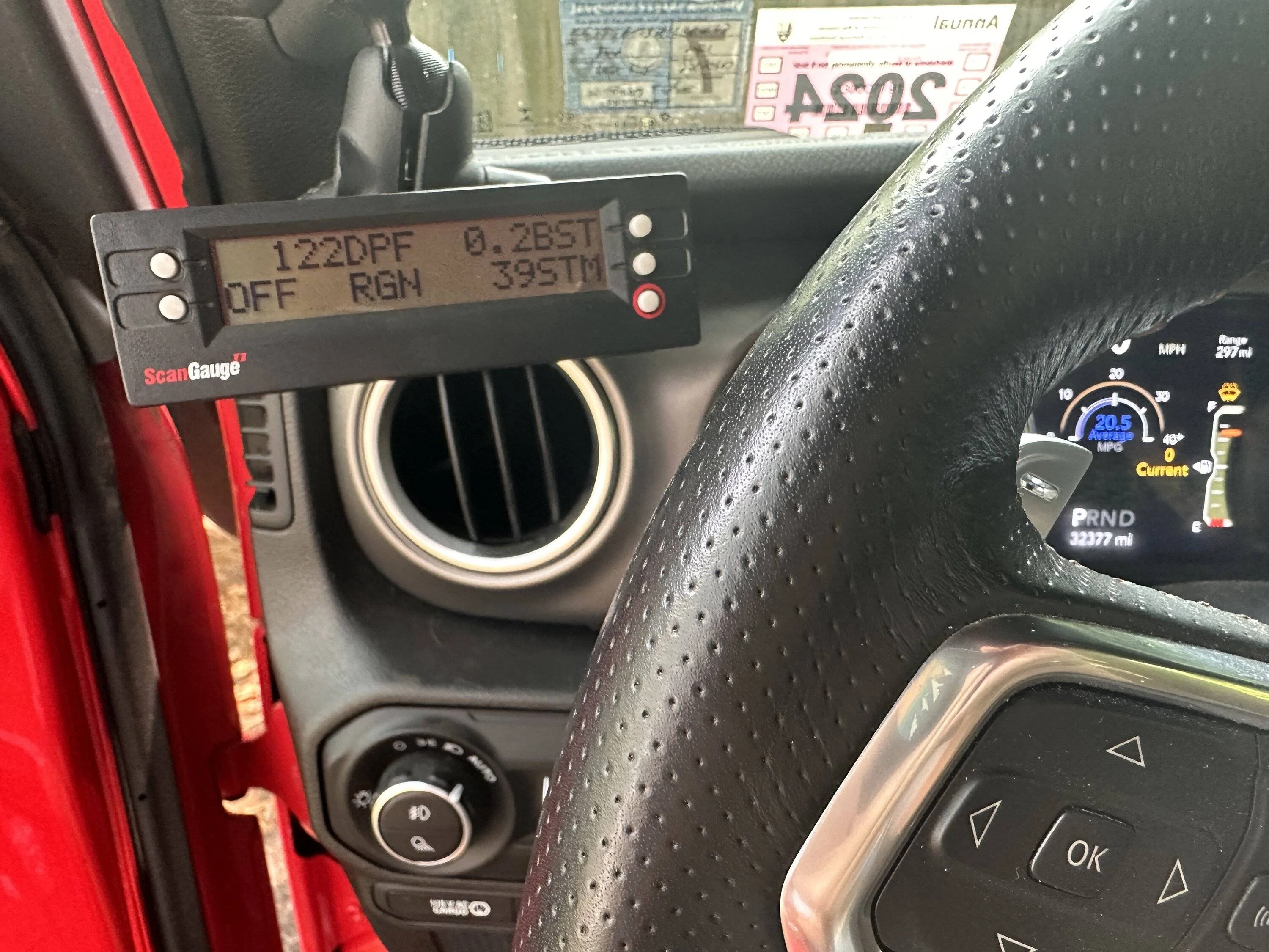

I have my gauge set to display the DPF temp, Regen on/off, current boost and soot mass load (STM) which tells me how “full” the DPF is. It usually goes into regen between 60-75%. I also see it doing a passive regen on the interstate when this value decreases.

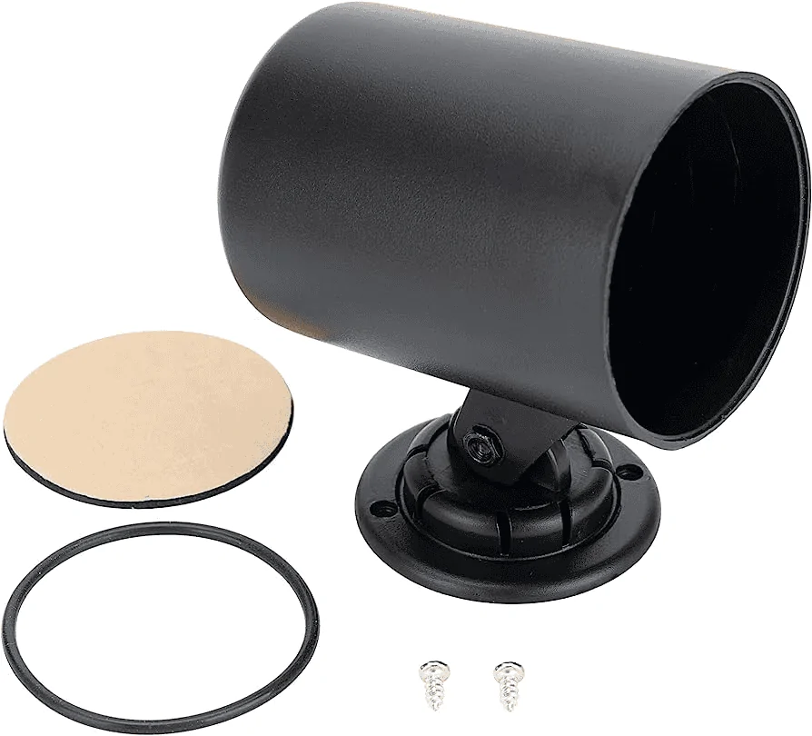

@Rusty PW, have you seen any Ram Ball mounts for this gauge? I’ve only seen the suction cup versions.

It occurs to me that I could simply screw a round ram ball mount to the back of one of these. I’ve been tempted to get a Banks tuner and one of these gauges. I’m just paranoid with the fuel system issue and warranty if they discover it. Thanks for the link.
