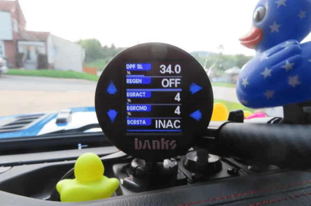

I got my Idash installed today. So i will be paying attention I hope.
I'm not familiar with how the iDash is programmed, but there are 2 different types of regen that you would need to pay attention to (although I'm sure you know this)
DPF Regen status = 0 means no passive nor active regen
DPF Regen status = 1 + DPF regen type = 0 means Passive regen
DPF Regen status = 1 + DPF regen type = 1 means Active regen
These are the PID's that can be read from the OBD2 port...
If there's a way to program the iDash for regen type you would want to know that.
Also knowing the soot level % will give you an idea of when you might be hitting an Active regen (typically when it hits around 80%).
Will be interesting to see if the stats coming from the iDash differ from the OBD Fusion app that I use.

On the idash the regen status will show OFF/PAS/ACT you can also set an alert for active regen, set the high parameter to 2 for the active. If you set it to 1 the alert will go off during passive regen which is almost anytime the DPF temp is high enough, which is very annoying.

Do you mind sharing what parameter you are monitoring to get the soot% to show?
The top reading. DPF SL % (SL= SOOT LOAD)
Interestingly enough, mine doesn’t have that option. I’ll try a firmware update and see if that does the trick.
