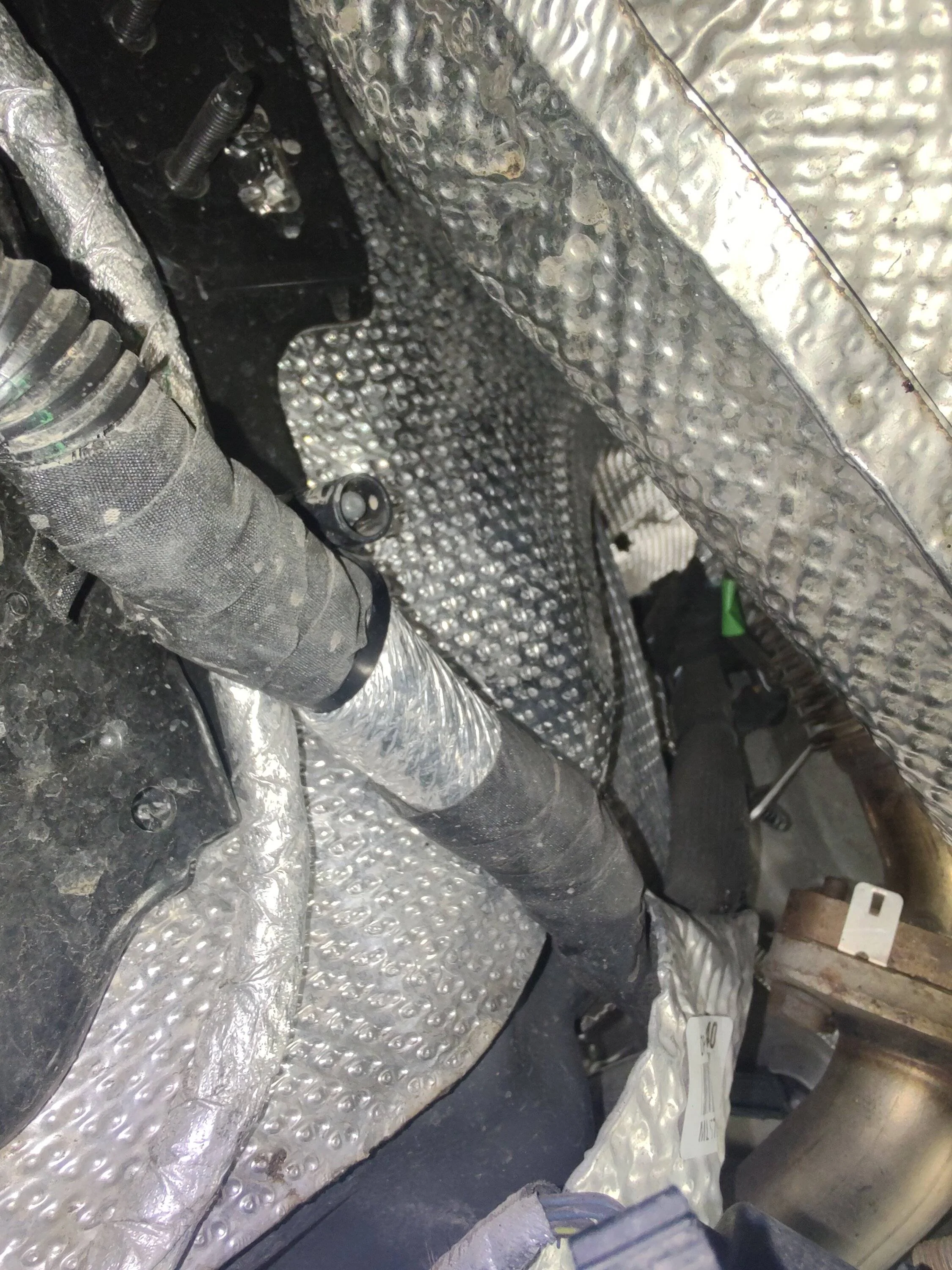

It's a really simple fix. You just gotta get on the ground and look underneath and just inside the front passenger tire to find the wires. I haven't had it come back in over 3.5 years since I moved the wires out of the way

Some have had a grounding issue. The ground for the power steering pump on the frame has paint on the stud. Removing the ground wire and cleaning the stud has solved the issue with some.

I'm going to look at the wiring harness everyone is mentioning. I couldn't get to it easily from underneath, going to remove the wheel well cover.
I only have 5,000 miles, not sure how the wiring harness could be charged enough to wear through to the actual wires...??
(Or is the problem a bad connection in the harness, aggravated by vibration or heat from the EGR tube?) Am I looking for actual cut/chaffed wires?

I don't think the wiring harness is chafed or damaged, I think it's just getting hot enough it messes with the communications protocol.

Since my post and what I found on the forum in the link in post one and what I did in post 15 I have had no issues. 60k plus miles
