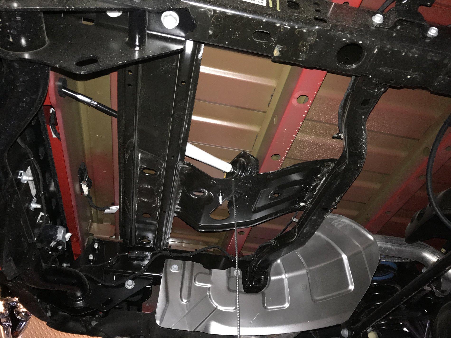

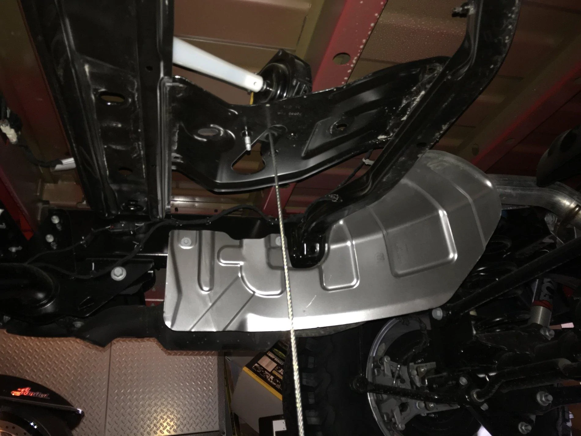

I was concerned because there is a brace beneath the winch system for the spare that has a raised (lowered?) height. In looking at it, I expected the bracket to intentionally make the steel spare wheel make contact instead of rubber. I'd say there was about an inch to spare.

These darned trucks even look good from the BOTTOM side..........
Thanks for the pics - now I know without crawling on the frozen snowy ground at -5 to see what the space looks like.

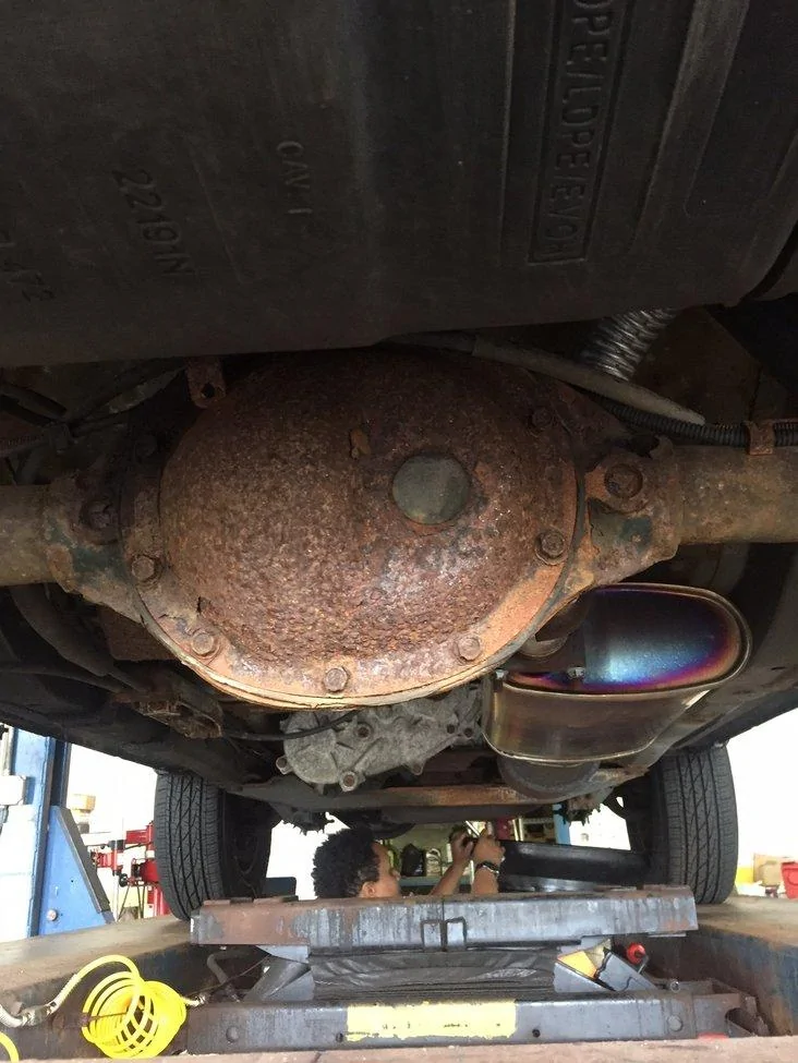

Yeah, that one looks good. Mine's only four months old and already looks like this:
Crap - I'd be pulling that differential out of there, cleaning it up and painting it nice. I can't handle that look.
You've maybe seen the pics of the underside of my SX4 - a 1982 - the differentials and skid plates. I stripped and painted the differential, re-plated the u-bolts, powder coated the brake backing plates...... I'm going to go nuts if this new truck looks like that underneath any time soon. I guess when spring comes I'll be under it cleaning and prepping and repainting.

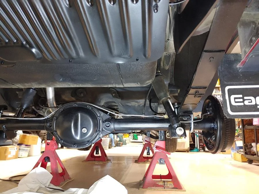

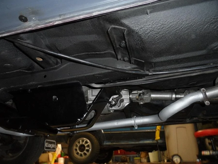

Hey - this one isn't from this century, either - 38 years old................ this is how I hope my JT looks in that many years -
