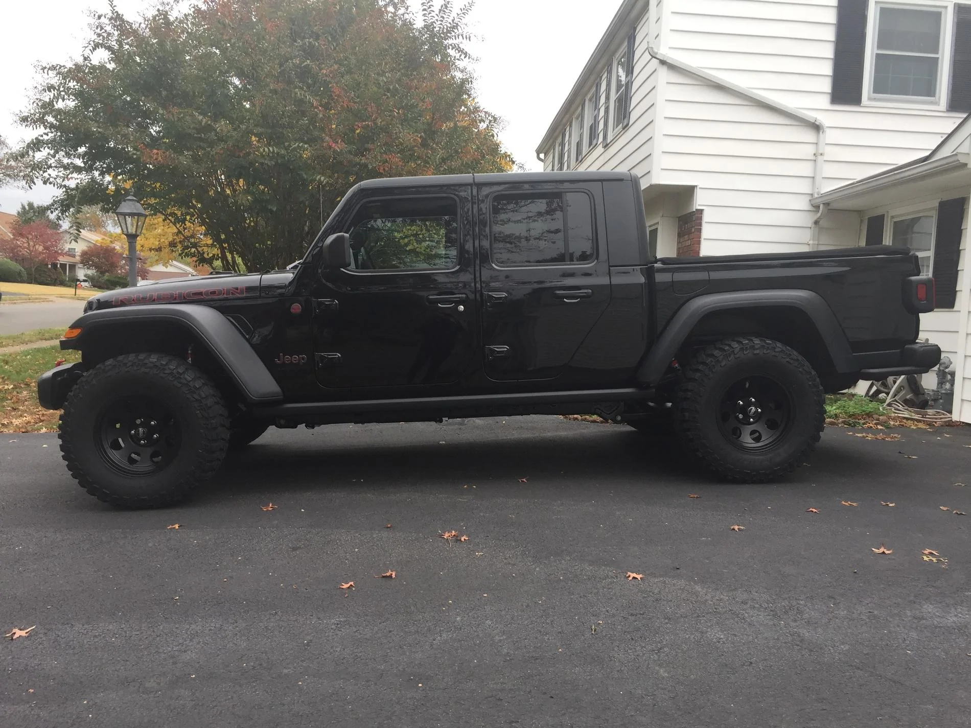

I just replaced my spare wheel, with a matching rubicon wheel. It needed a new tpms sensor. The spare did not have one it it. The good news is that it was self learning and did not have to take it to the dealer. I did get the sensor from them and had them look it up by vin. I did not want to loose the tire fill alert feature.

It is on MINE - I have 5 matching Overland wheels - including the spare. xx,xxx miles spread over 5 tires means each tire wears a bit less and in a few years you don't have an unworn spare that has to be replaced due to being over x years old.
Further - it's actually RECOMMENDED for 4x4 vehicles to do a 5 tire rotation because they all wear more evenly and there's virtually no real difference in diameter. Wear a set of 4 down to minimal safe use and then toss on a spare. Not a differential killer - but on a limited slip it will over miles build up heat (I've rebuilt a few with blue disks) No, not a big deal and is it likely? No, not really. But why not spread that wear and keep things more even over 5 vs. 4.
Why NOT do it is my argument.
Some say "why" and I say why the heck not?
