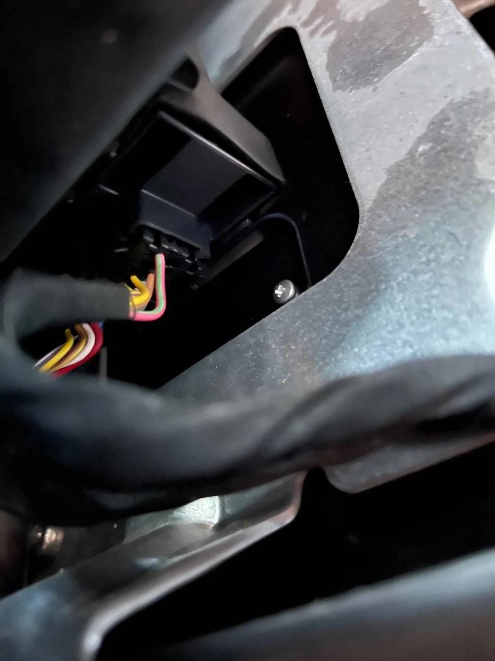

Cables are hooked up to my Tazer.
I would agree it is odd. But for the life if me it's not there.
Speaker upgrade was one of the first mods I did. Within the 1st year. I don't remember the SGW being on the speaker when I replaced the driver's side knee speaker.
Only places my JT had been were the dealer for Jeep cares oil changes, tire shop, and my buddy who put the leveling kit on.
It had ro have been lifted. I don't see any other explanation, but who?
Anyways. Can't change it. What should I do now?
Contact Benny @AllMoparParts.com about getting a replacement.

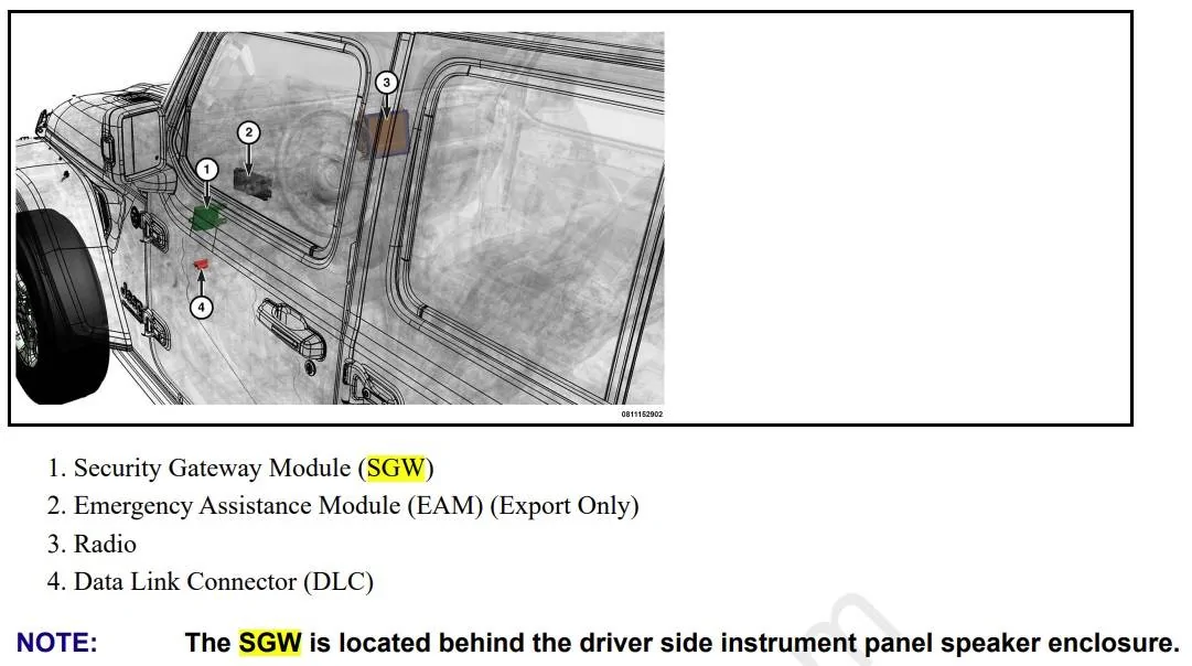

@red/green hawk did you ever find it?
No, it's not there. It should be attached to the back of the driver's side knee speaker box. I bought a new one. Waiting to take it to the dealer and have it programmed.
