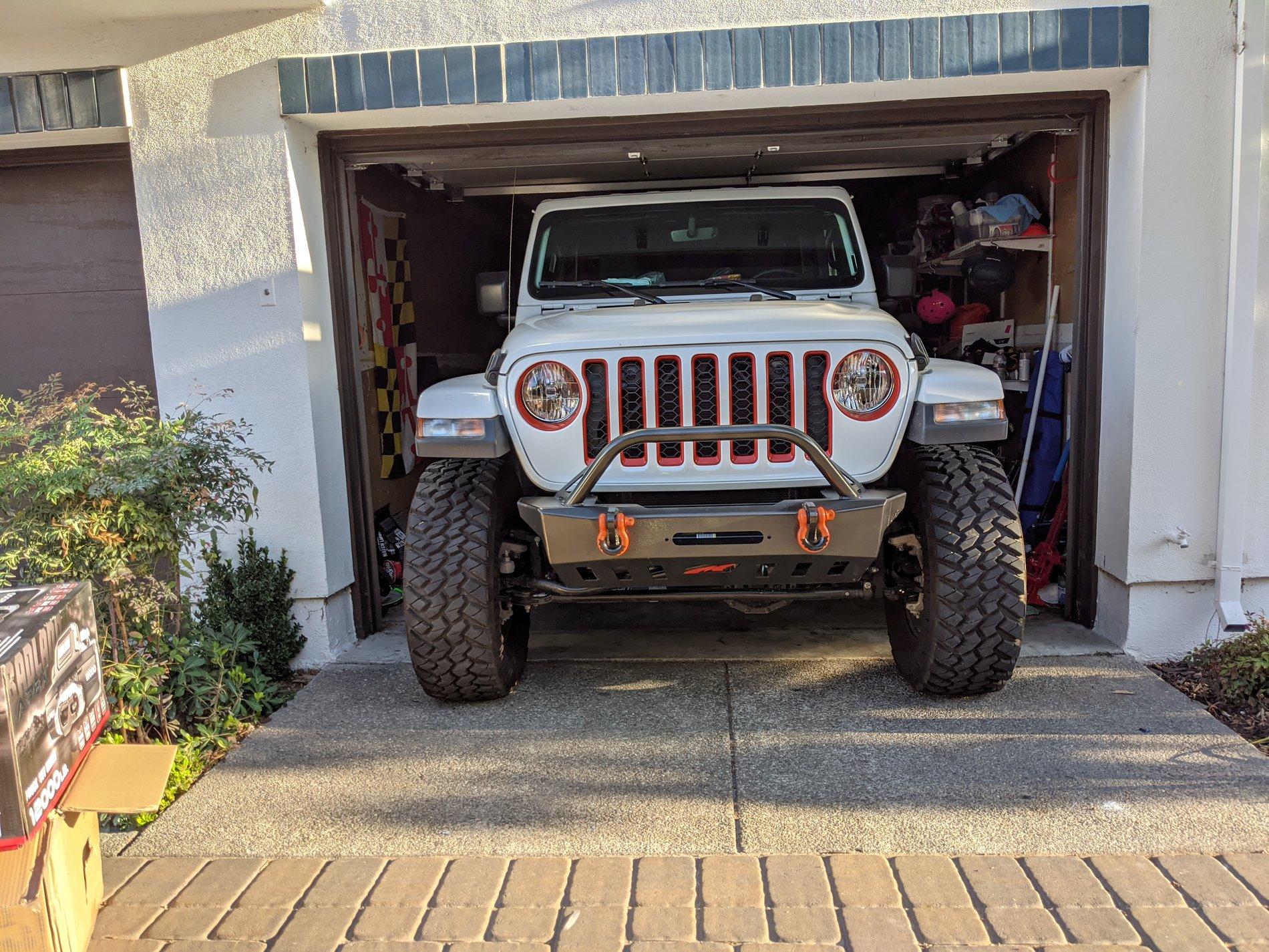

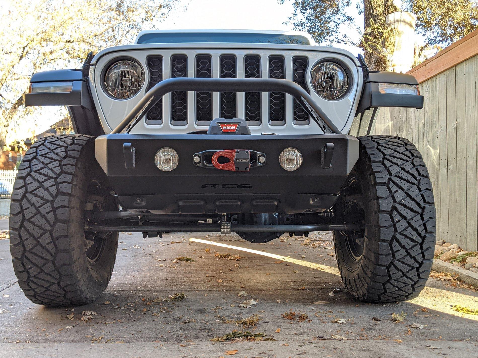

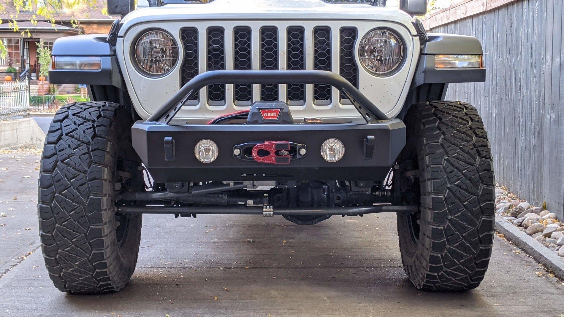

I've started to embrace the suck that became my exterior paint job...nobody knows if it's from wheeling repairs or suckage paint. I'll get the exterior ground down and redone by a pro eventually.
I did have to drill holes. It wasn't fitting with a few holes drilled to 5/8 so I just drilled them all. When I did that it slid right on.
Can confirm Badlands winch is too large. Will return. Warn it is.
These shackles are close in color but not quite. Will paint up some bare ARB ones.
The bumper itself is perfect.

I don't even notice the suck anymore, so I am gonna keep it.
There was NO way the bumper was gonna fit with the winch. The winch was as far back on the mounting plate as possible, and it barely snuck into the leading edge of the mounts. When I put the bumper on I got like 1/4" of the each of the 8 mount bolts through the hole at best before the bumper hit the winch itself.
It's too deep of a winch front to back. It's the housing around the ends is too big. You could cut a notch off the bumper and it should work but I can't guarantee it'd be enough. and then it's just smashed into the bumper and grille.

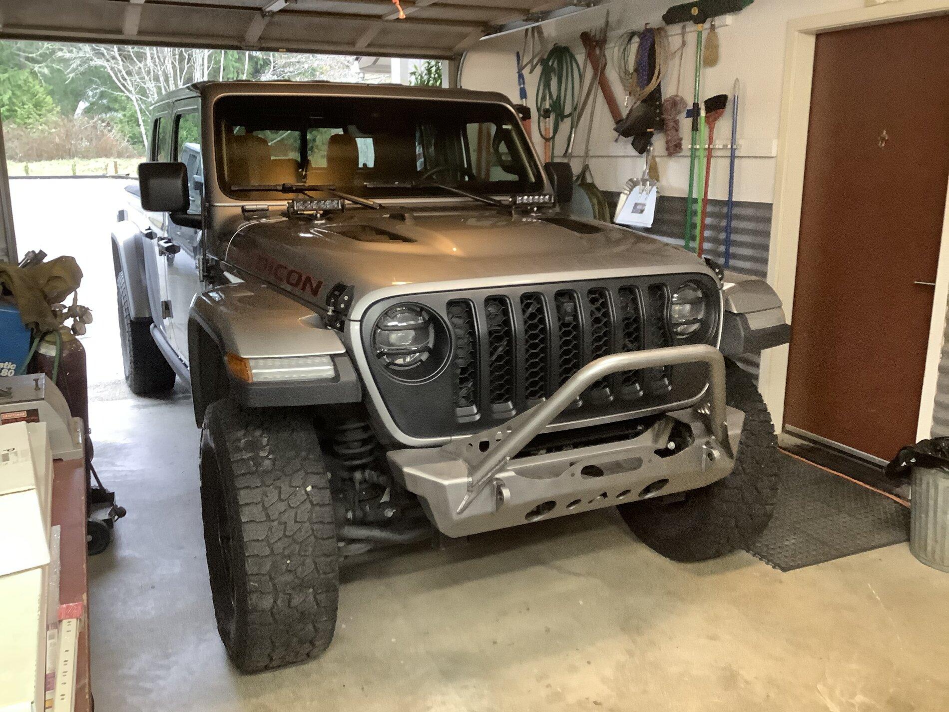

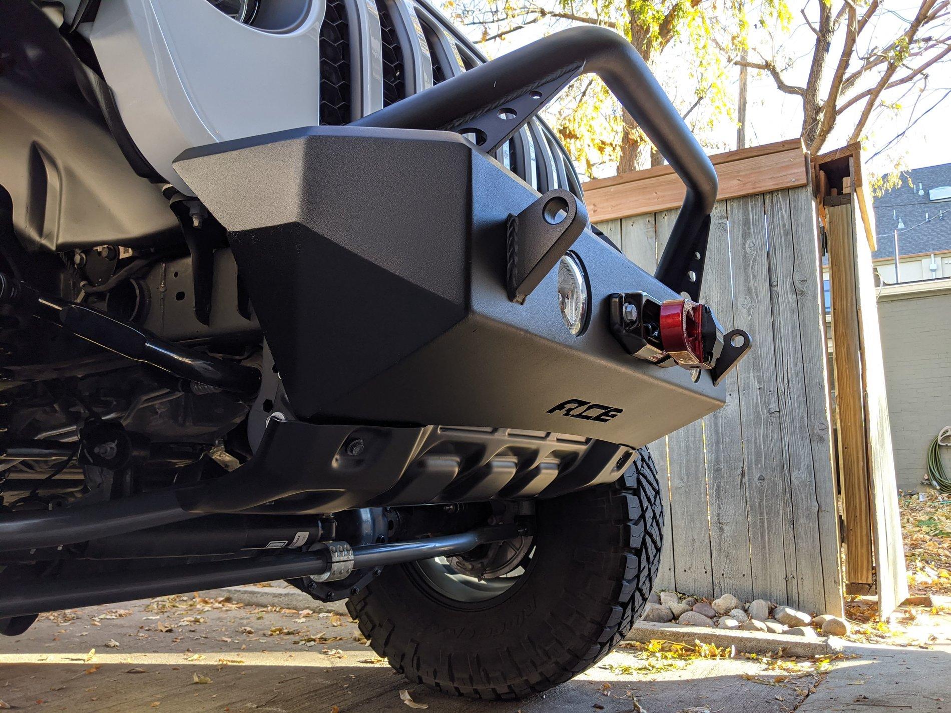

Ace Engineering Expedition Stubby w/ OEM skid trimmed to fit. Ace should have their own skid out soon though.
Included a "with" and "without" skid photo comparison too. I like it without but I do appreciate the protection of the skid

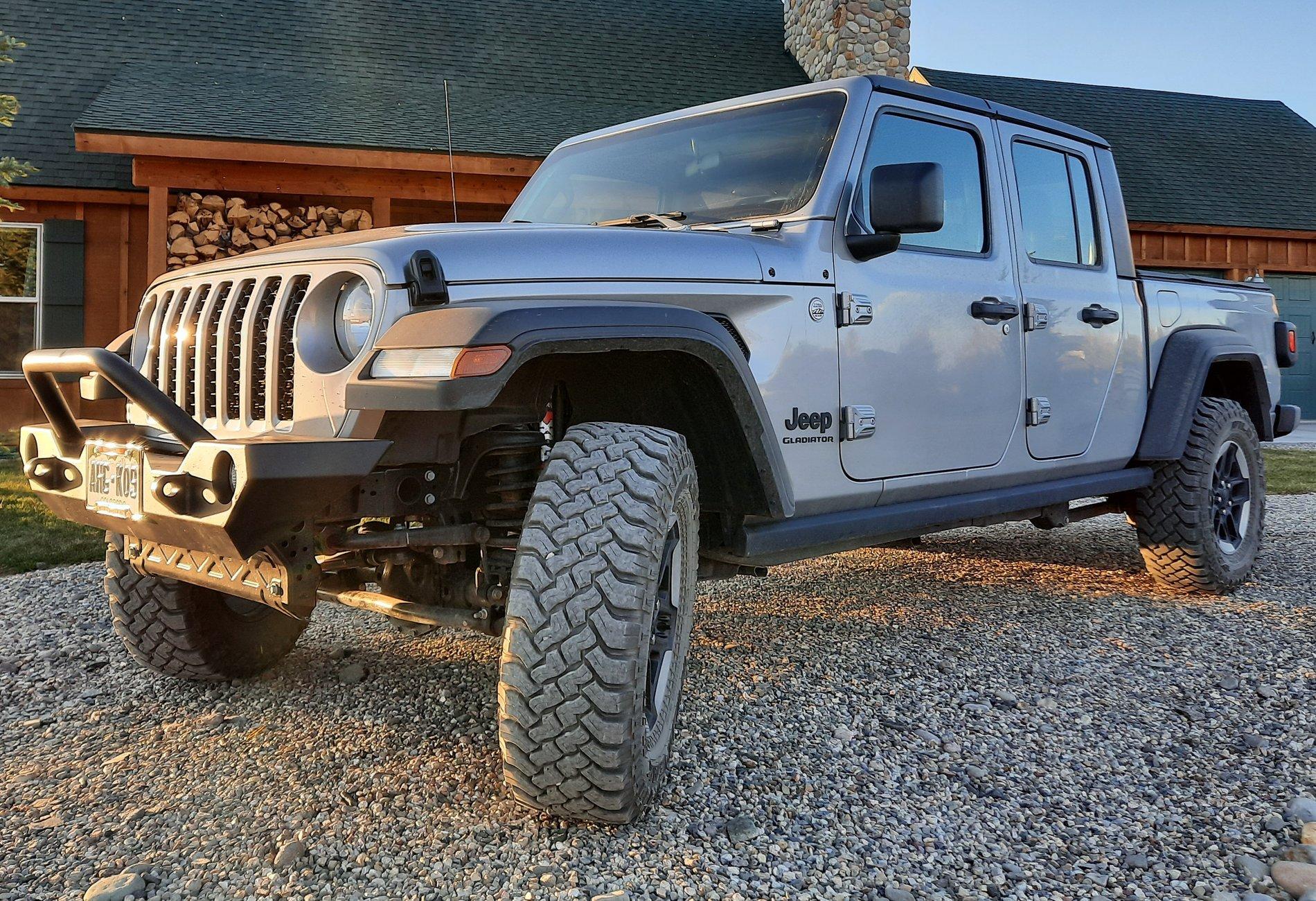

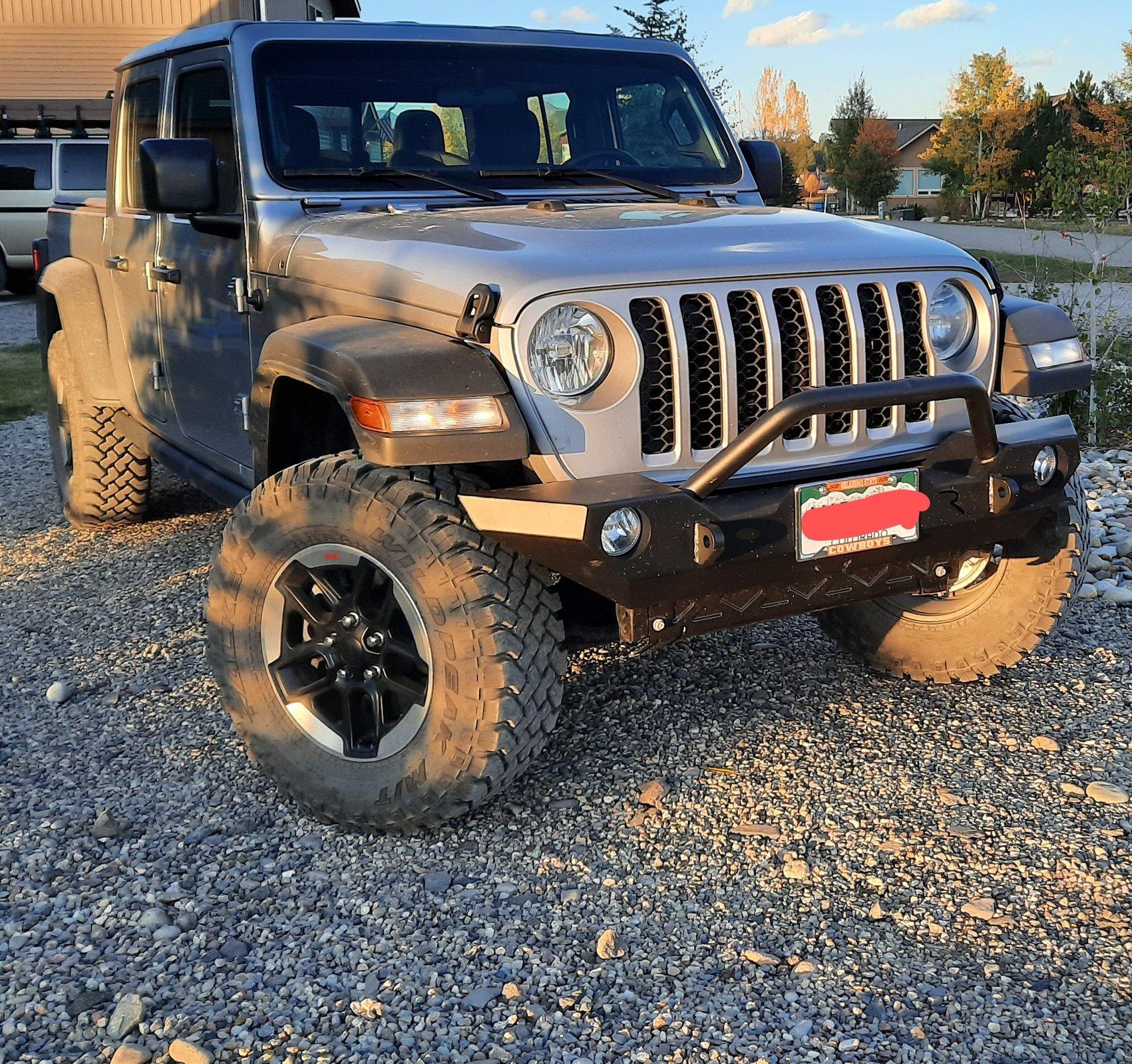

Rampage Bumper off Quadratec ($280 on sale!). No skid BUT I could have trimmed and replaced stock one, just liked the look better without...

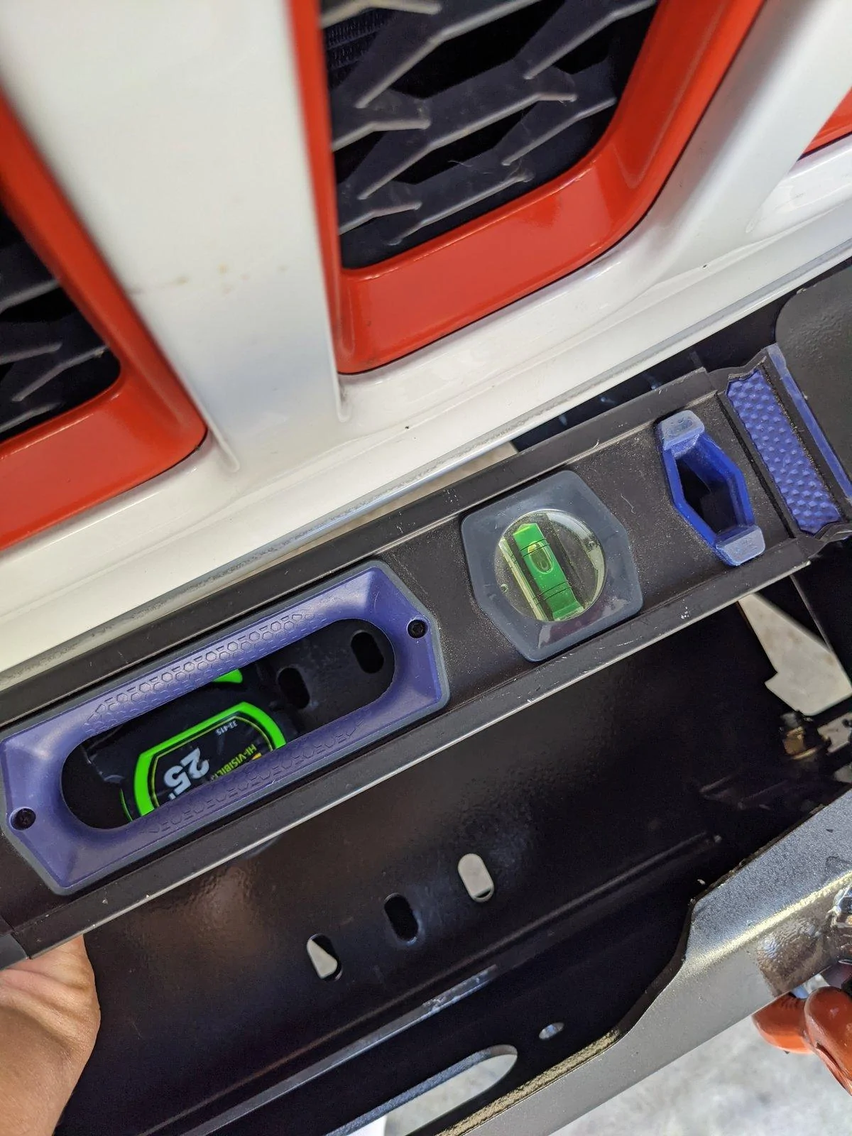

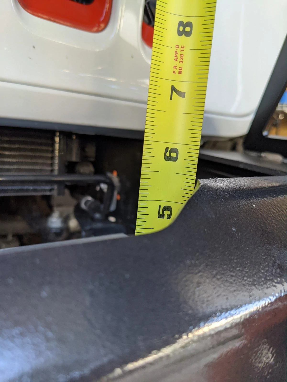

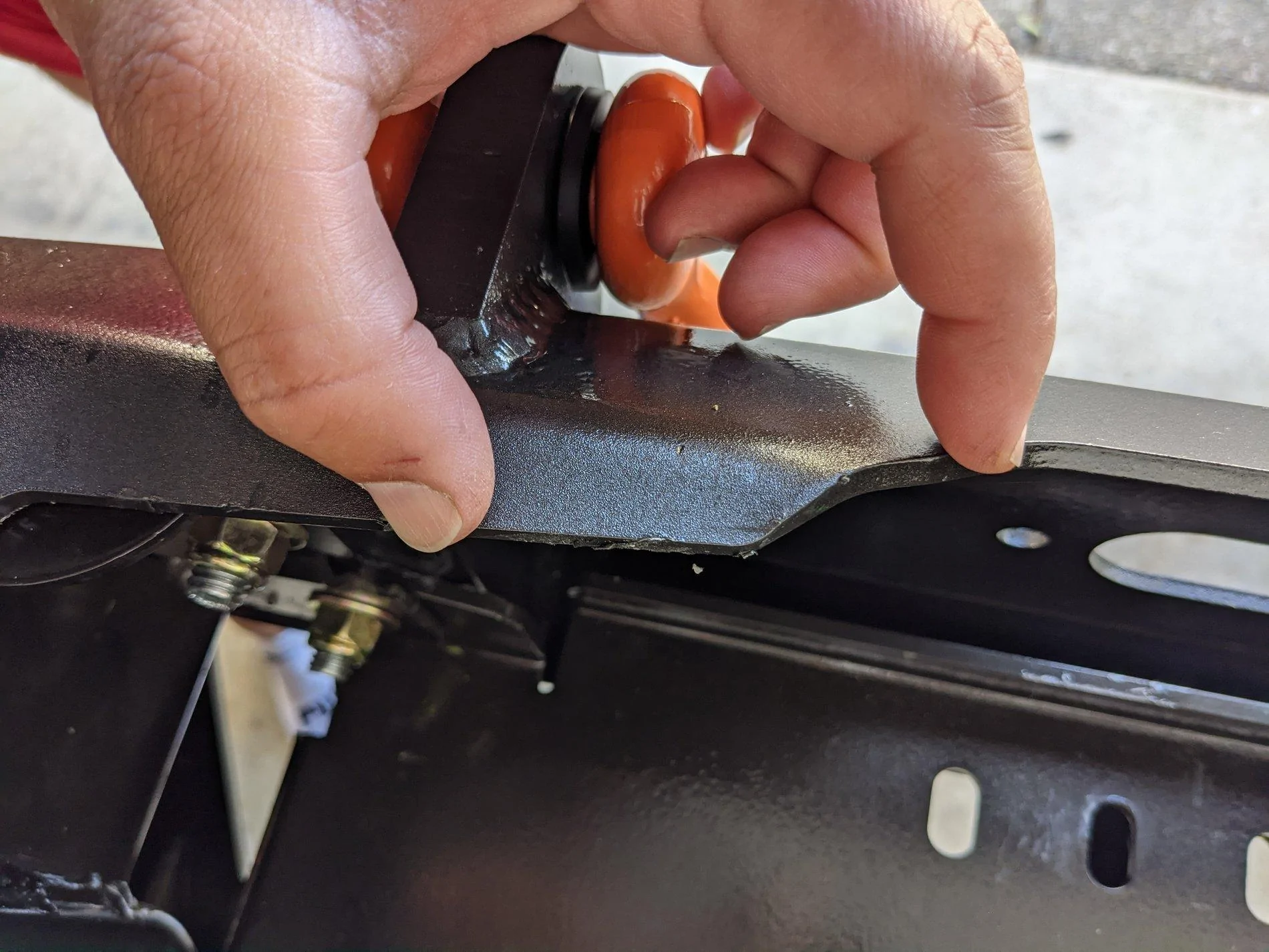

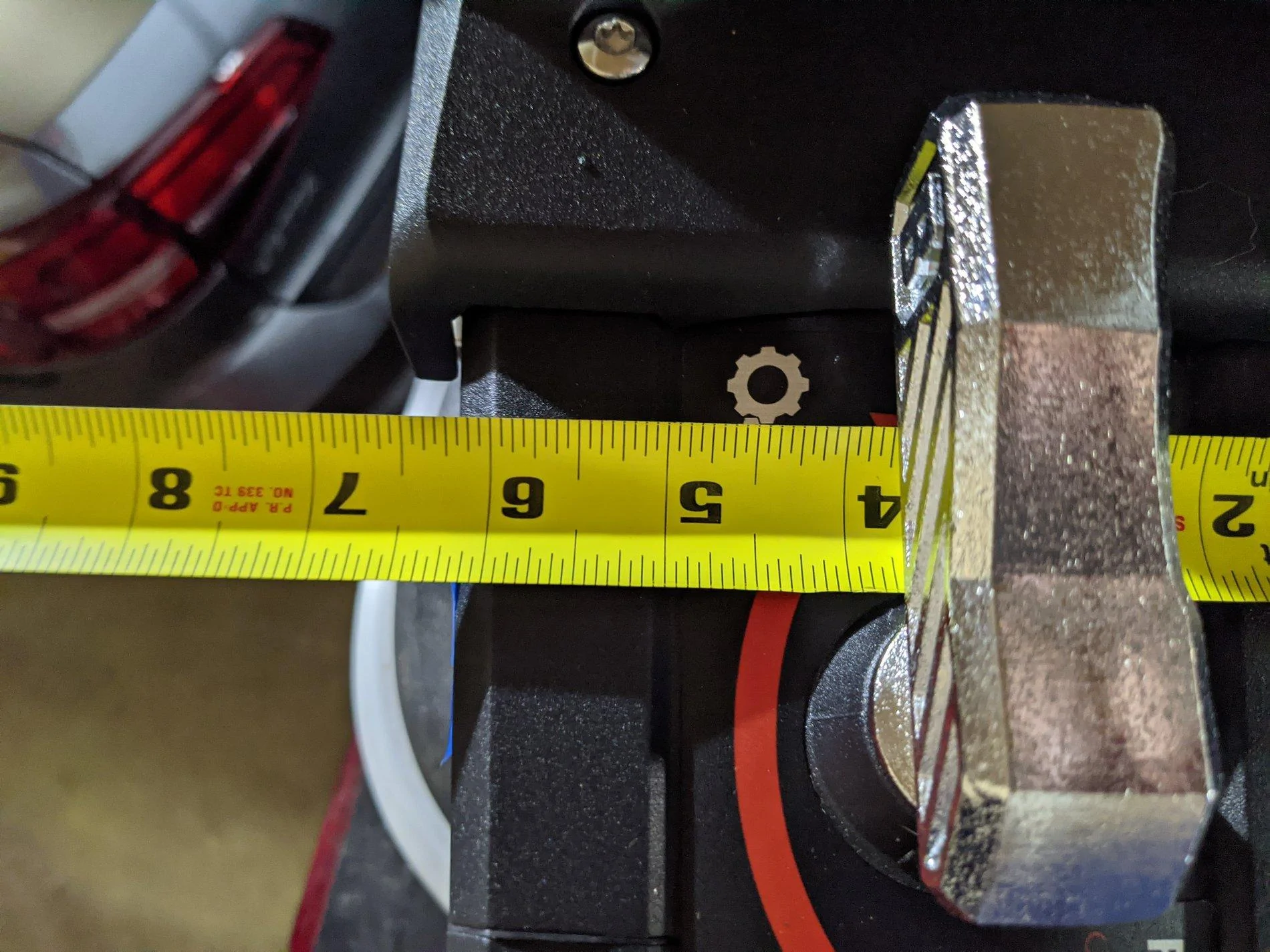

The corner of the bumper sits at 5.5"
Jeep Gladiator Show me stubby bumpers options with skid plate PXL_20201030_154245032
At that point you have 5.75". It measures 6 but it's rounded. Going from the center point it's actually 1/4" closer than the pic.

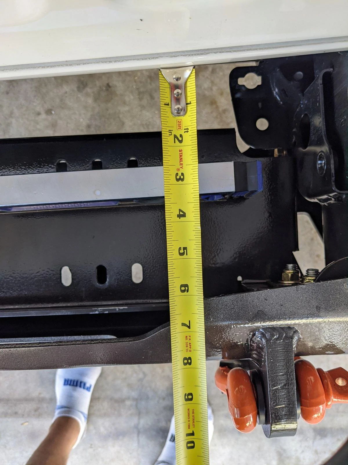

You can see the gap on the level in the second picture. Have to measure from the shortest edge that the winch could mount to.
Jeep Gladiator Show me stubby bumpers options with skid plate PXL_20201030_154254829
Jeep Gladiator Show me stubby bumpers options with skid plate PXL_20201030_155035890

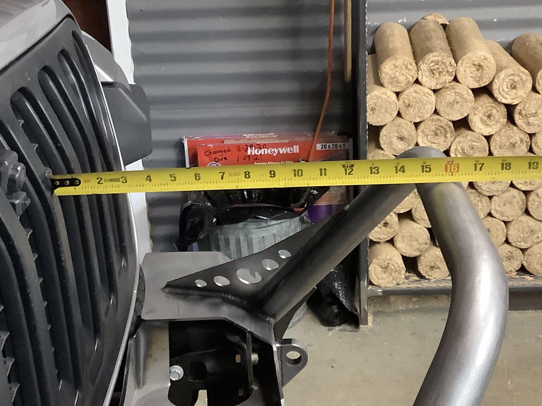

This is a measure giving yourself some clearance for the cables. Blue tape is the front. 6.25 or so.
Jeep Gladiator Show me stubby bumpers options with skid plate PXL_20201030_154705544
You could grind off the point on the bumper if you wanted. If you take away this chunk it will fit.
Jeep Gladiator Show me stubby bumpers options with skid plate PXL_20201030_155414257
This all lines up with what I saw. That I could get like 1/4".. maybe 1/2" of the bolts through. The bolts are like 1-1.25" in the photo below. That missing length is because the bumper is hitting the housing, and the cable is like crushed on the grille. Need to have that little corner taken off, but it depends how much needs to go, that's where the shackles mount and I'm not sure if it would impact the strength if you cut it back. It's certainly not providing any foundation to the shackles, so should be fine.
