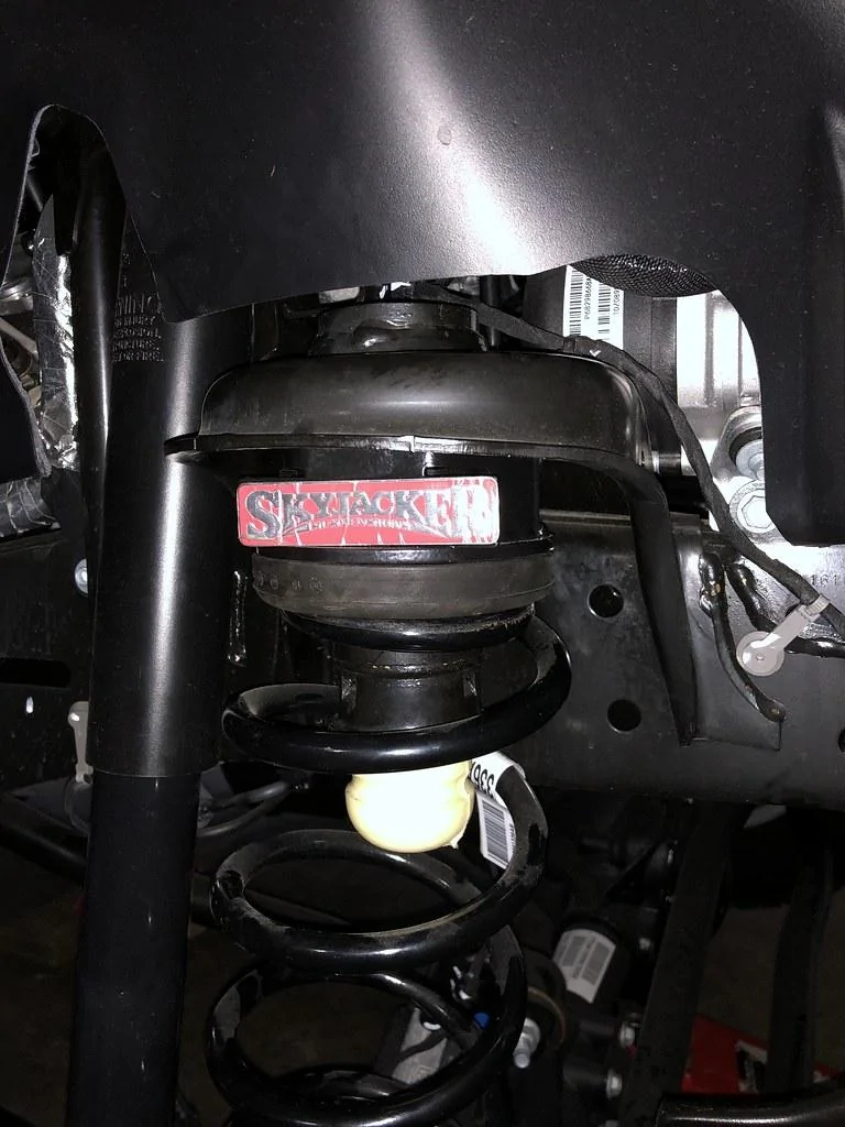

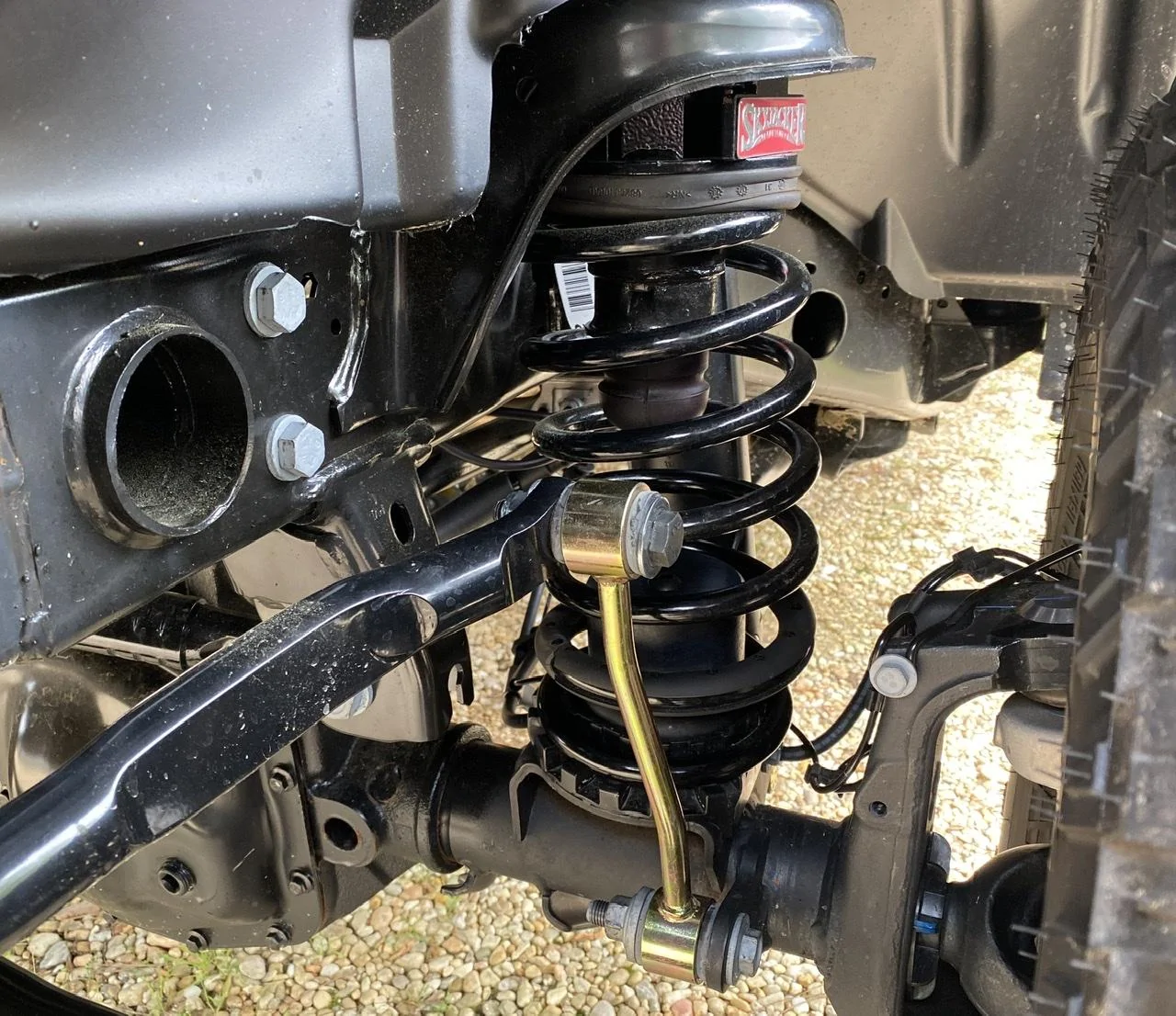

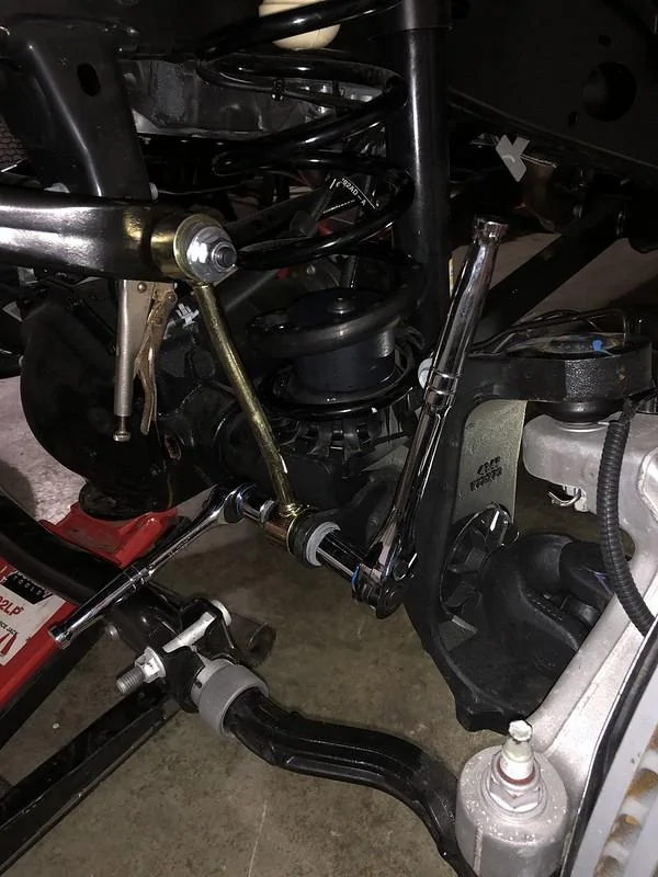

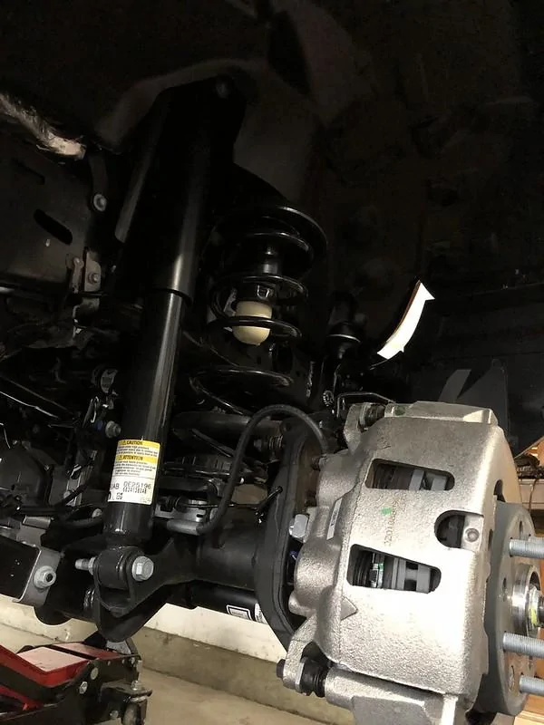

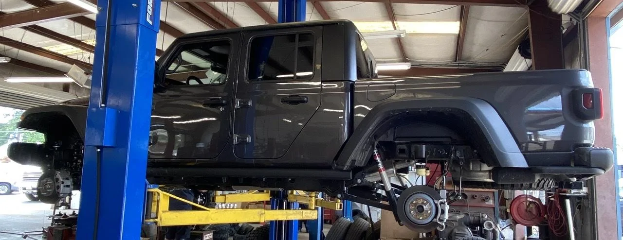

Figured I would post some photos of my install of the lift, overall it was pretty simple to install.
shot before I ripped into it.
Shock coming off
right before the spring came out
Boys helping me, my favorite part of this jeep is having them help me.

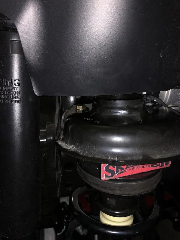

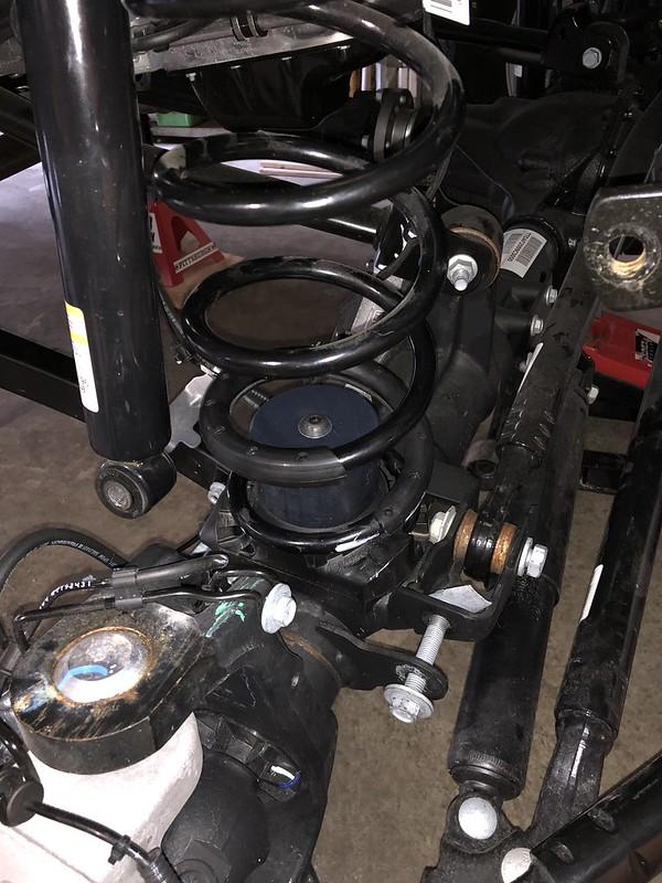

got the spacer in,
Bump stop in.
The bolt to put the spacer on took a while to get on.
passenger side done.

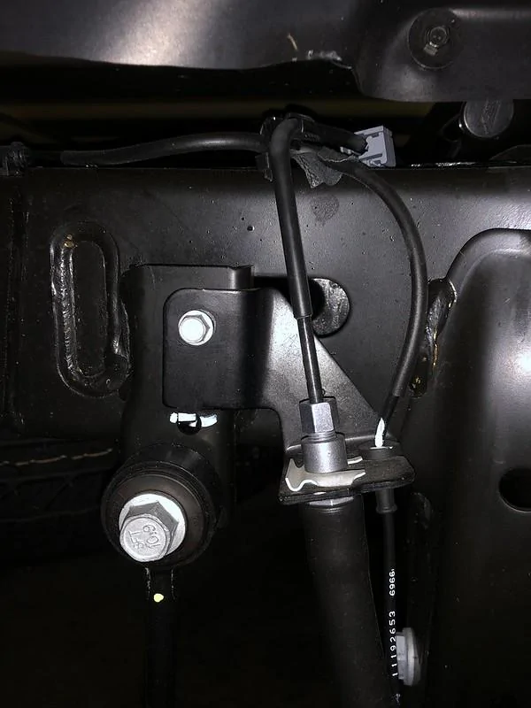

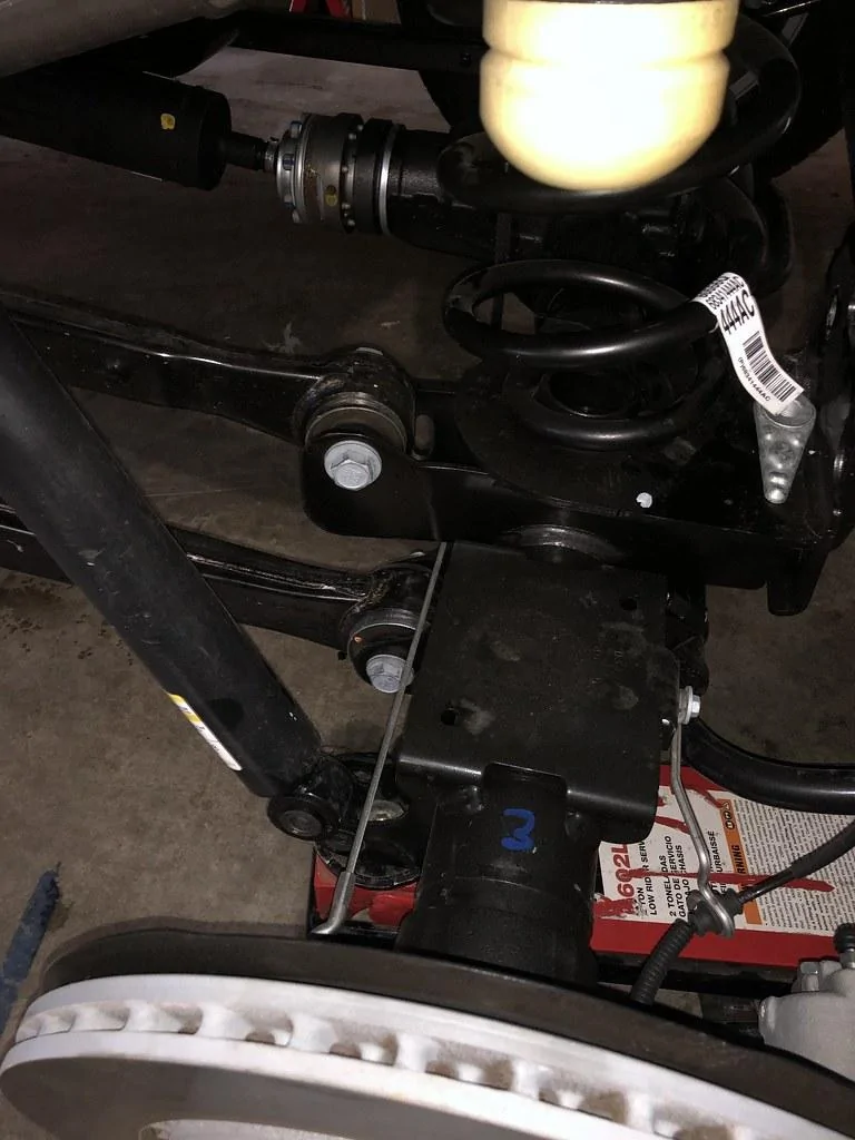

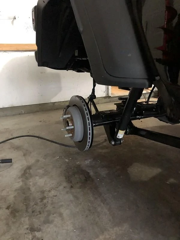

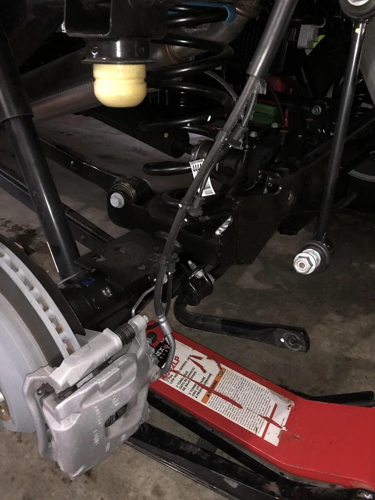

Rear
Rear break line was pretty tight when getting the spring out be careful
