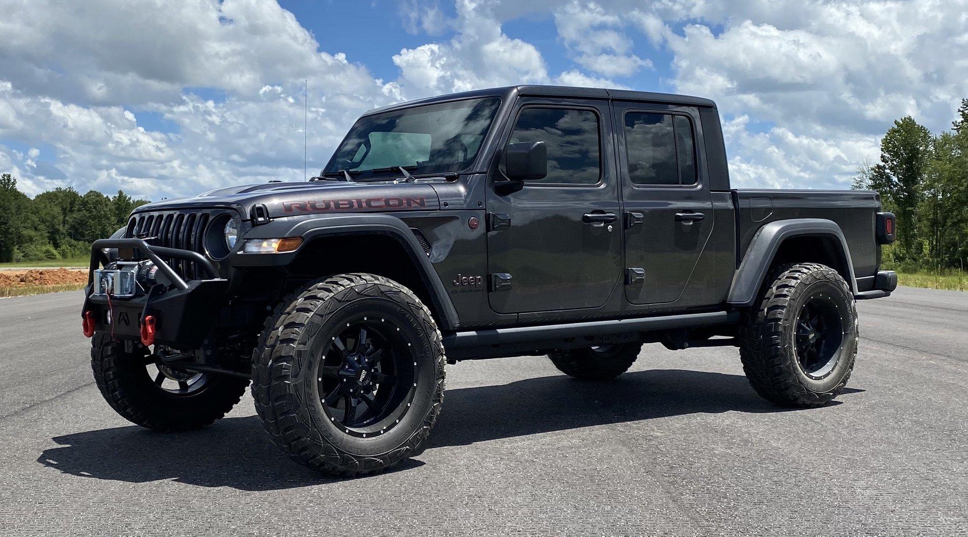

Alabama Mud Machine your rig looks sweet! I'm considering the same setup. How level does the truck sit after the lift? I tow a 5k wake boat so don't mind a little rake but would like to keep it .5" or so.
Alabama Mud Machine
Mar 5, 2020
1,954
2,404
Lake Martin, Alabama
Thanks man. If I didn't have a 75 lbs. steel bumper and a 100+ lbs. winch with a steel cable on the front, that adds about an extra 1" to 1.5" of front sag, it wouldn't be as level as it is, being that I have a Rubicon. Between the Rubicon's 3/4" taller front springs, and the Rubicon's high-clearance front fenders that sit about 1.5" higher than the other models, it sits a lot different than the other models. It makes it have an optical illusion that makes it look like it's sitting high in the front, but if you look at the rock rails while sitting on flat level ground, it DOES actually have some positive rake (rear sits slightly higher than the front) by probably a good 1/2" to 1" or so. I haven't hooked anything that weighs 5000 lbs. behind it, but you should be ok, if I had to guess...
Here it is sitting on flat ground (it's a runway we just paved back at the beginning of the year, and nothing has landed on it yet), so this is about the most level ground you're going to find anywhere...
