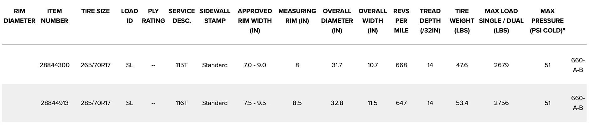

I just put on a set of Wildpeaks AT4Ws on my 2020 JTR and they were great, but I was never a car guy and didn't realize my shop put on P rated 2857017 116T (I told them to fit it with my driving routines: Highways). I used to have the factory Falken Wildpeaks AT3W that actually has a C load Range.
I spent sometime online and heard a lot of different voices, and as of right now I think they might be just fine for me.
99% of the time I'm in cities and I'm too busy in the next couple of years to go off-road, only some gravel roads and camping trips in Canada, rest of the times on Highways going 130km/h below.
Should I be worried about The load range? or it will be just fine for me, as they are being driven for some decent distances I don't think I can swap them anymore.
I have attached the spec of AT3WC and AT4WSL in below, other than the weight of the tire itself, I think it hasn't changed much.
Other than this, will I fail inspection because my door sticker indicated a LT285/70/R17 C and I've read online that it might not pass the inspection due to different load index. Just considered that in case I might move before out of province before this tire gives up.

AT4W:
Jeep Gladiator SL/P Tires Fitted instead of C Load Range 2026-02-28 äø‹åˆ11.45.41
AT3W:
Jeep Gladiator SL/P Tires Fitted instead of C Load Range 2026-02-28 äø‹åˆ11.28.52

Ok the best thing you could do to set your mind at ease? Drive your JT over a Cat Scale at a local truck stop, loaded as is on a normal day. That’s to find out your total curb weight with you and your normal equipment. Let say for the sake of argument that is 5,000lbs for a nice even number. The look at your sidewalls for manufacturers weight rating at max PSI. On the graft you posted that’s 2,679 lbs at 51psi. Thats a total allowable legal limit of 4x2,679=10,716 lbs! That in theory means your 5,000lbs truck could run those tires at half of 51psi! So yeah you have nothing to worry about running those tires at 30 for smooth ride but loosing mileage, or 35 for slightly flinty ride but little more mileage. To be totally safe and legal, be sure to find the payload rating, mine is 1,044 lbs. and the GVWR is 5,800lbs. That means if you truck weighs 5,000, you can legally haul 800 lbs! Total load all together.

Don’t P rated tires have a fudge factor ?
You’ll never overload those SL tires with max weight.
I think I would never over load the truck since usually just me and my partner on it.
