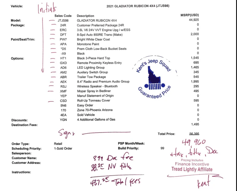

Well... here is my quote from 2021 (this configuration I didn't go with as I did go for the diesel but since it is no longer an option it wouldn't be a fair comparison) and the configuration from Jeep's website. It is a jump of $3,545 MSRP, about 6%. You'd likely be at the MSRP from 2021 when starting to negotiate at invoice prices + a few extra dollars. You can see my price before taxes and fees was under $50k two years ago. Today it is likely $52-$53k.
Inflation is eating away at everything. Deals are still out there yes, I'm just getting at loss of value on the dollar when getting an insurance pay out.
EDIT: just noticed I built out a 23 not a 24, but the 24 configurator looks to be down at this time.
