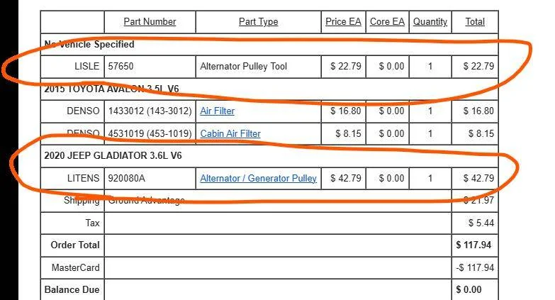

Okay, this one definitely is new on me .
I didn't know these had a clutch 🤯
That's why I love this site . Always something new
It literally decouples the alternator from the engine when you need a boost in power, and I believe even when the batteries are 100% charged and/or hot.
These can literally shut off the charging system and take the alternator out of the equation - saves power, prevents spinning a heavy alternator rotor when it's not needed.

Please refer to post #26 in that thread. It outlines the exact part order.

To all who are curious about the Alternator Decoupler install. Took me less than 2 hours. One piece of advice: When trying to relieve the belt tensioner, there is a cylindrical part below the alternator which blocks the tensioner -it is 2 bolts. remove the bolt on the left and just loosen the right hand one and let the piece rotate down and away. then get a 3/4 socket extension and a breaker bar for leverage, insert the extension into the tensioner, and when facing the motor ( i stood on the bumper) apply force and wait for the hydraulic tensioner to release. before this stage i already had the alternator loose, i removed it completely to get at the decoupler pulley. Don't forget they are reverse threads on the pulley. Overall not a difficult swap, and considering a local shop quoted me $1300 to replace the alternator I'm pleased with this sub $80 fix so far.
Absolutely.
I understand the way shops have to work these days (or even years ago, to make any money), but it's frustrating to me when I know 1 part can resolve an issue vs. swapping a whole assembly.
It's a waste of good parts - and that bugs me to no end as well.
And - now you know a lot more about your Jeep.
