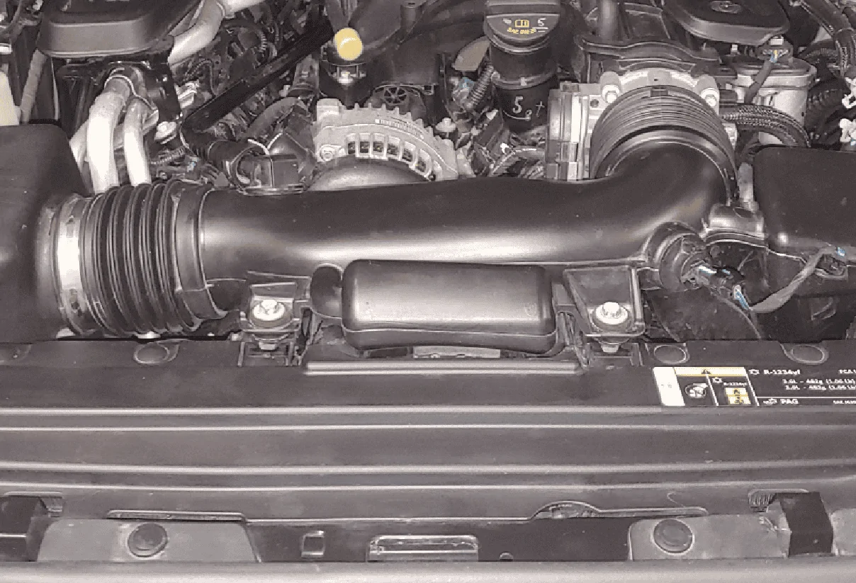

Pully is unavailable from every source I could find.......... not sure why. Also, any Alternator from a junked JT you better look at good, cause the location of the alternator makes it an early casualty in a frontend wreck.
That being said, I got a bit of a price break on a new alternator, so that's the route I'm taking. Other than tires, track-bar, and shocks......... it has been a fairly low cost vehicle for 3 1/2 years.
No more than any other vehicle, really.
Alternator restoration and repair is what I do.
My experience with salvage parts is that you can easily tell if there's physical issues with the alternator. If the case is intact and it spins free, it's not damaged. At least I could tell at a glance.
You could tell by looking at the Jeep if there was going to be damage. It would take a massive hit to get back that far.
Something would have to get over the top of the frame and crush the radiator support to get to the alternator which sits back a ways.
New is always best, but I'd never be afraid of a salvage alternator on this new a vehicle.
You can't tell electrically, but if it's in the salvage yard, it was working before it was wrecked.
These sit way back in the engine bay. Would take a hell of a collision and it would be pretty obvious if there was damage like that.
