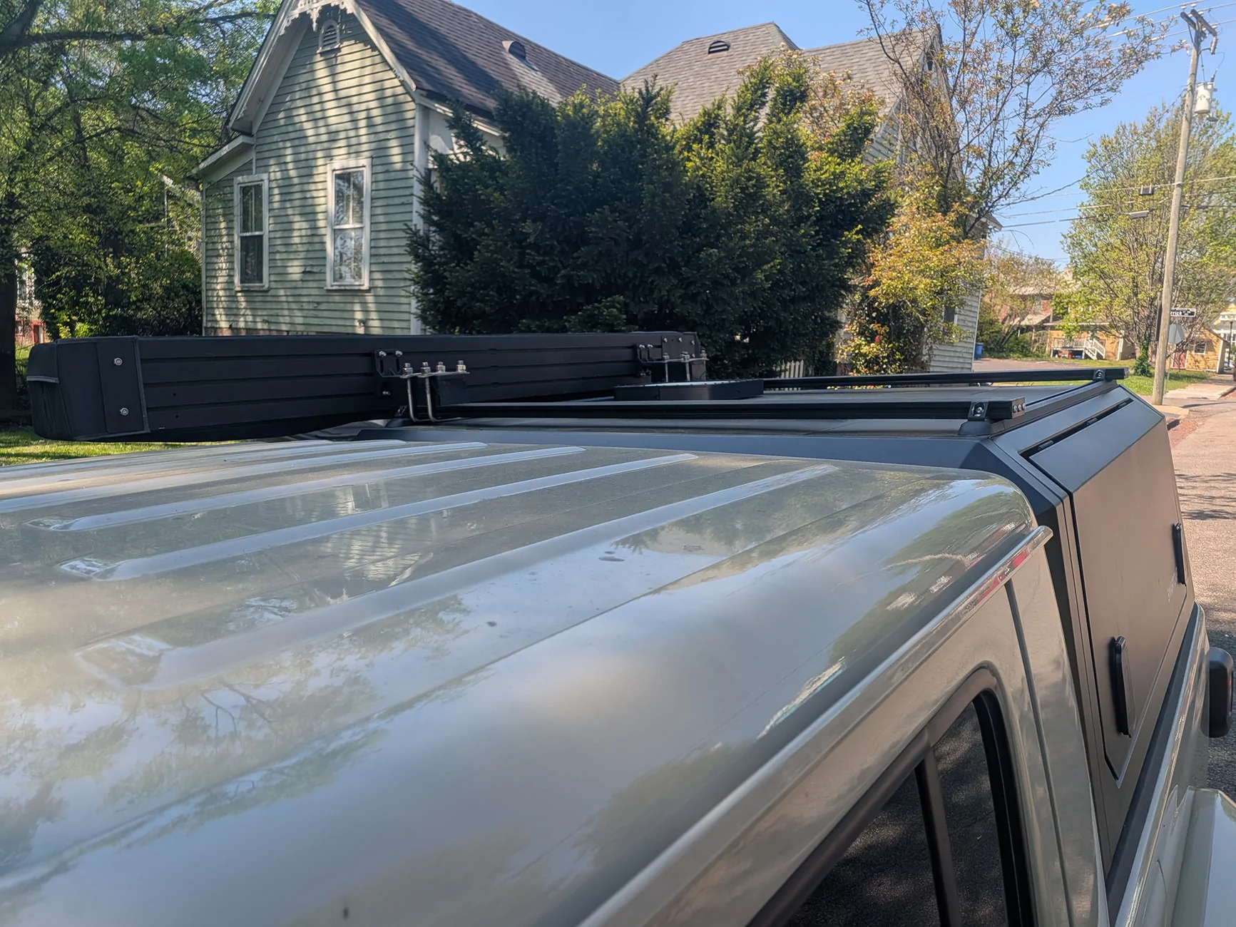

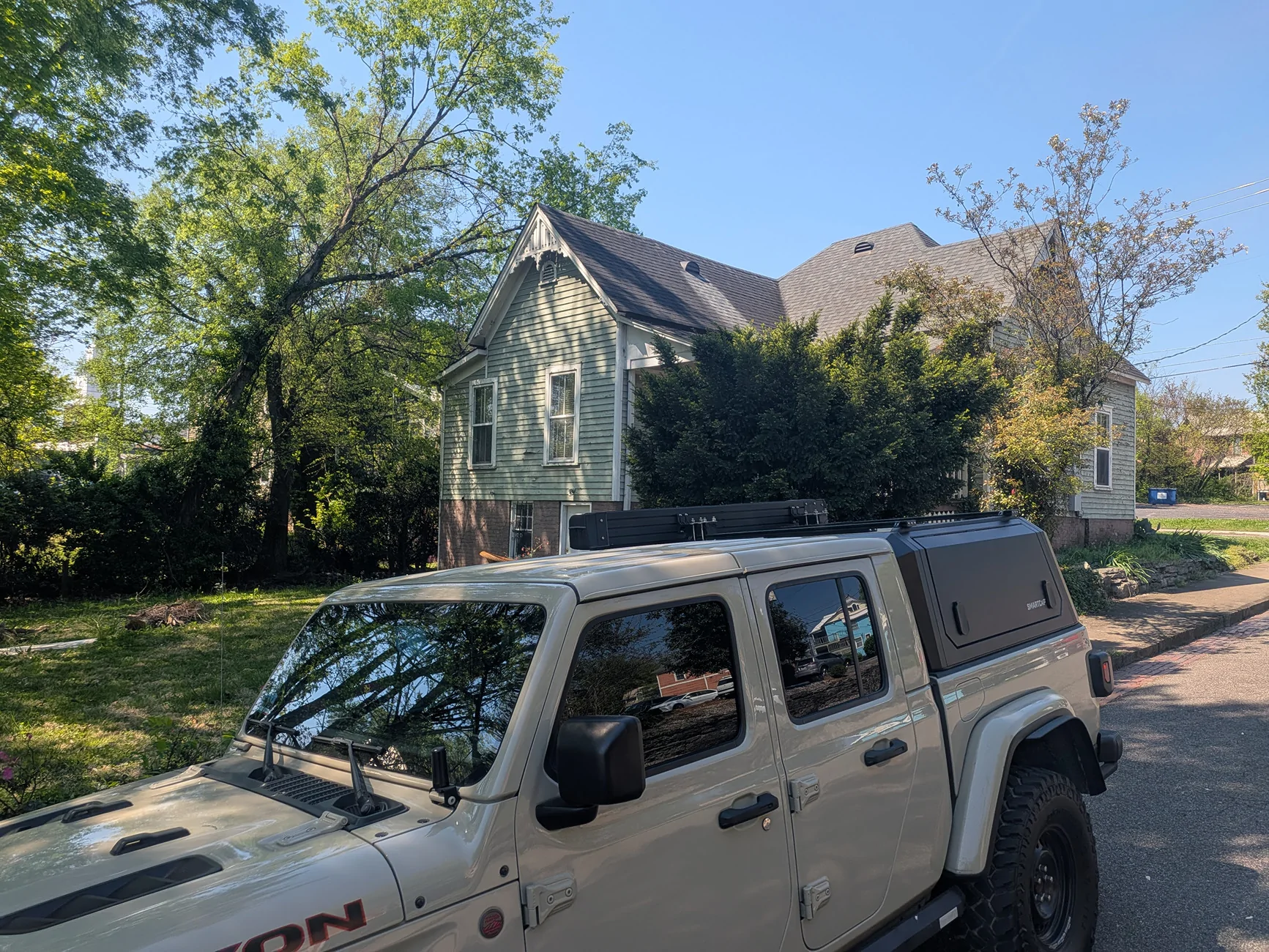

Anodized Aluminum extrusion and various bits from TNUTZ.com is what I used. I have a set of the official SmartCap bars on another truck. I just wanted something that sat lower, and looked cleaner.

That looks pretty slick!

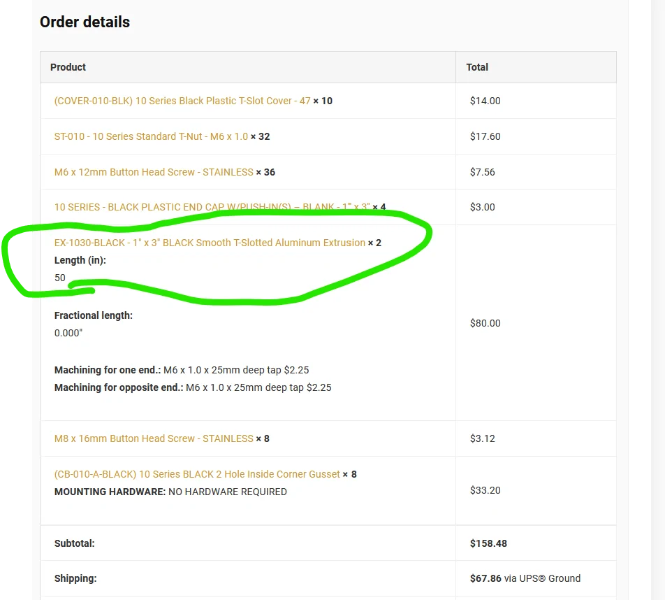

FWIW, I used 50" extrusion with tapped ends. So the images I posted earlier should give you an idea of the overhang.

hey @Thunderspud...question about your mounting hardware...I'm putting together a similar system for my smartcap. Those Corner Gussets only fit the 6mm screws, but the 8mm goes into the existing rail hardware. What did you do to connect them?

Yeah, I should have mentioned that in the initial post. When I first placed the order I was hoping the stainless M8 hardware I already had in the shop would fit through the gussets. When they didn't, and since I needed it done that day, I used a step bit to make enough room in the gussets. In hindsight, it would have been much easier with the regular L brackets they sell instead of the fancier "inside corner" variety.
FWIW, I did order new M6 tslot nuts from McMaster, but I haven't gotten around to switching them out yet. Not even sure I will, honestly. The little bit of loss of the anodized coating on the gussets isn't even visible, and they have been up there for multiple seasons now and don't show any signs of that or any corrosion) being an issue anyway.

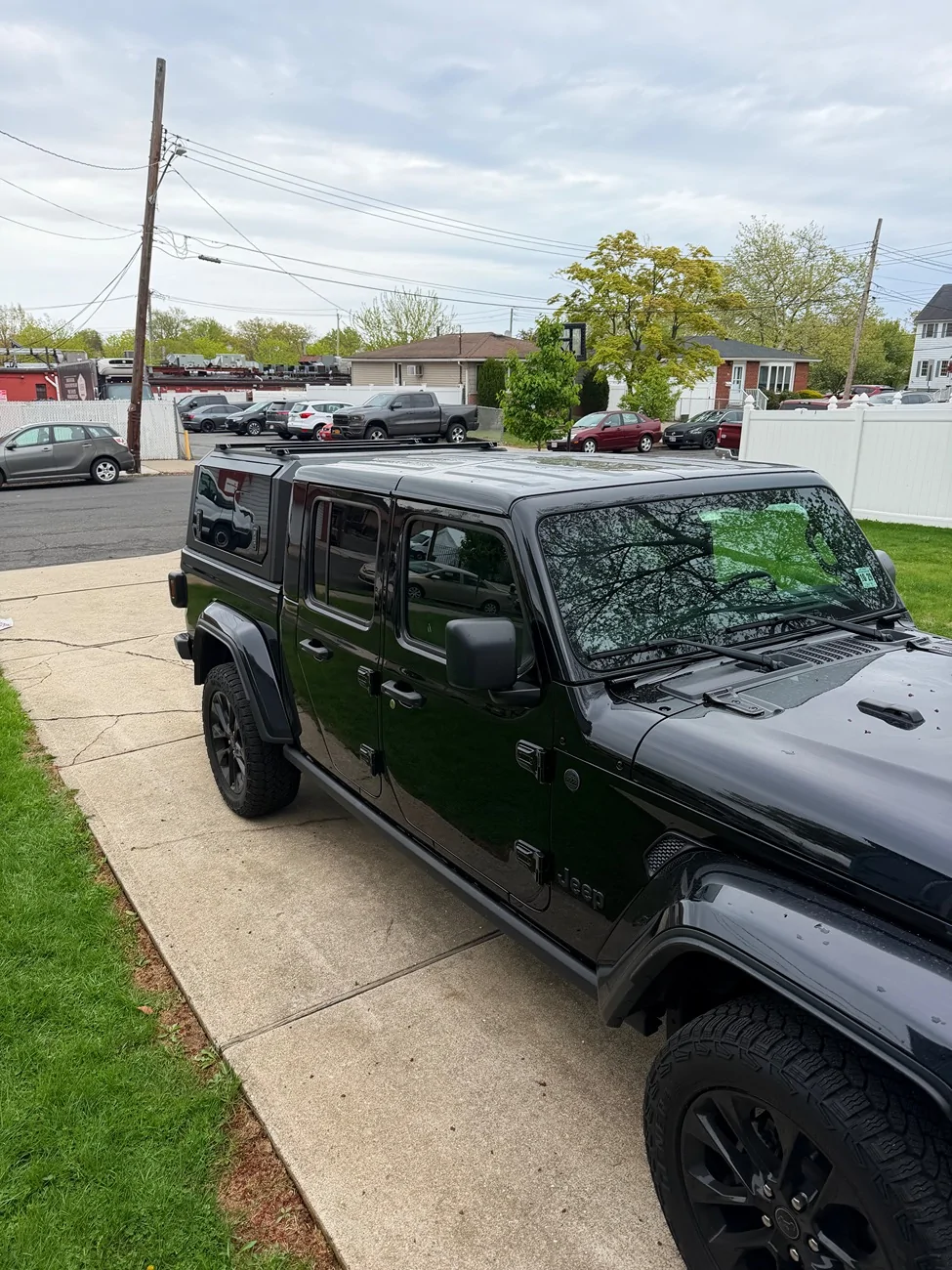

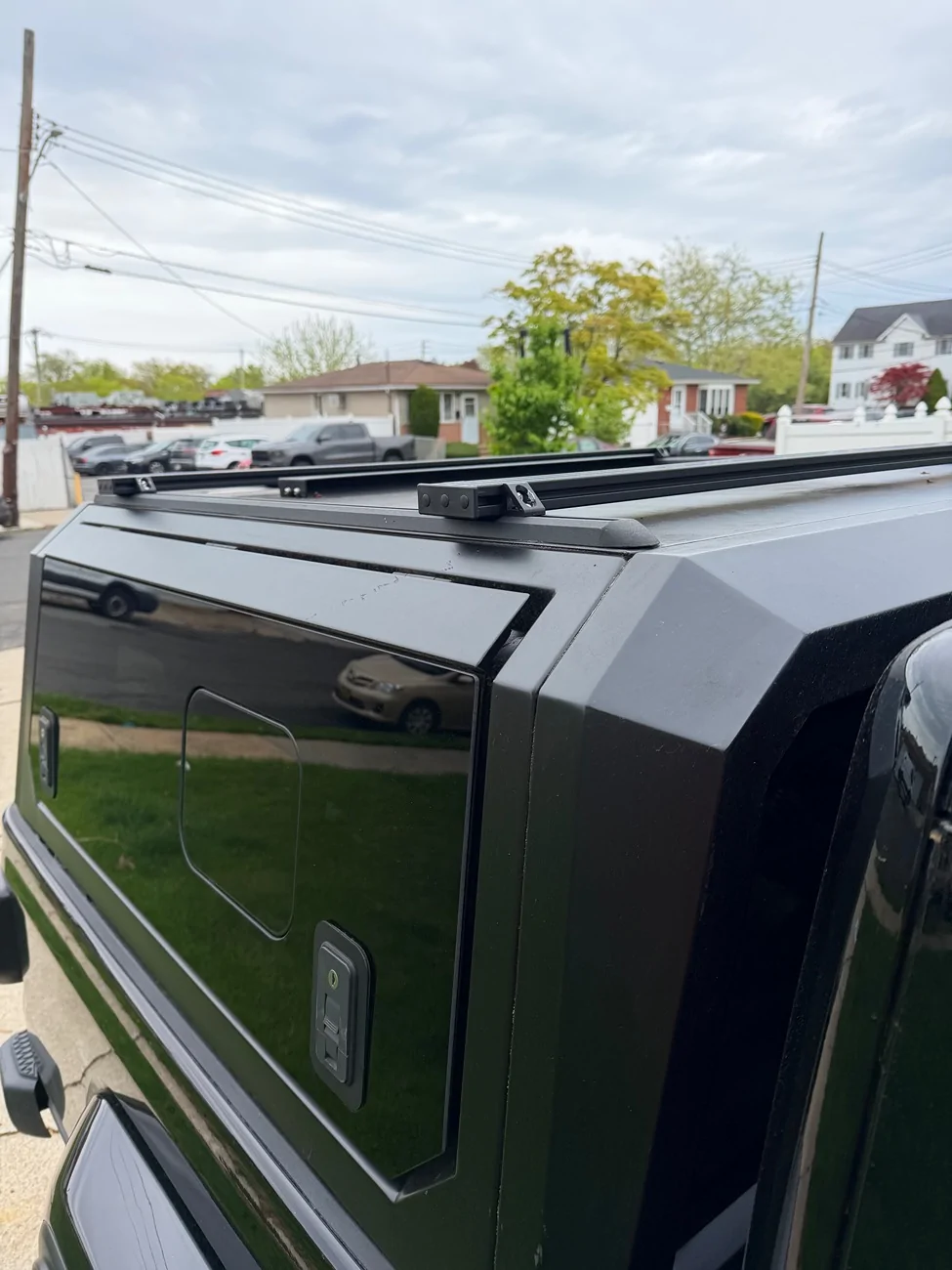

A little time with the drill press this morning has me all sorted out. 👍
Jeep Gladiator Smartcap Load Bars Options IMG_9734
Jeep Gladiator Smartcap Load Bars Options IMG_9735
appreciate the idea and the parts list!
