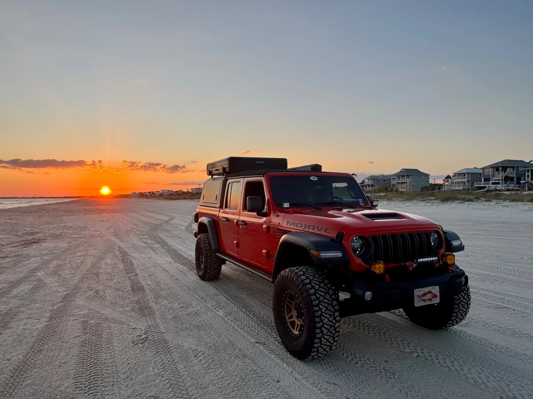

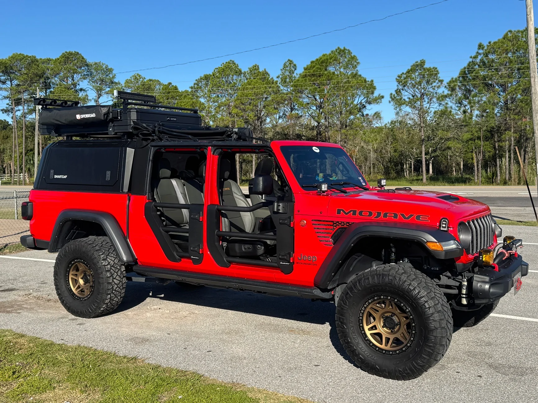

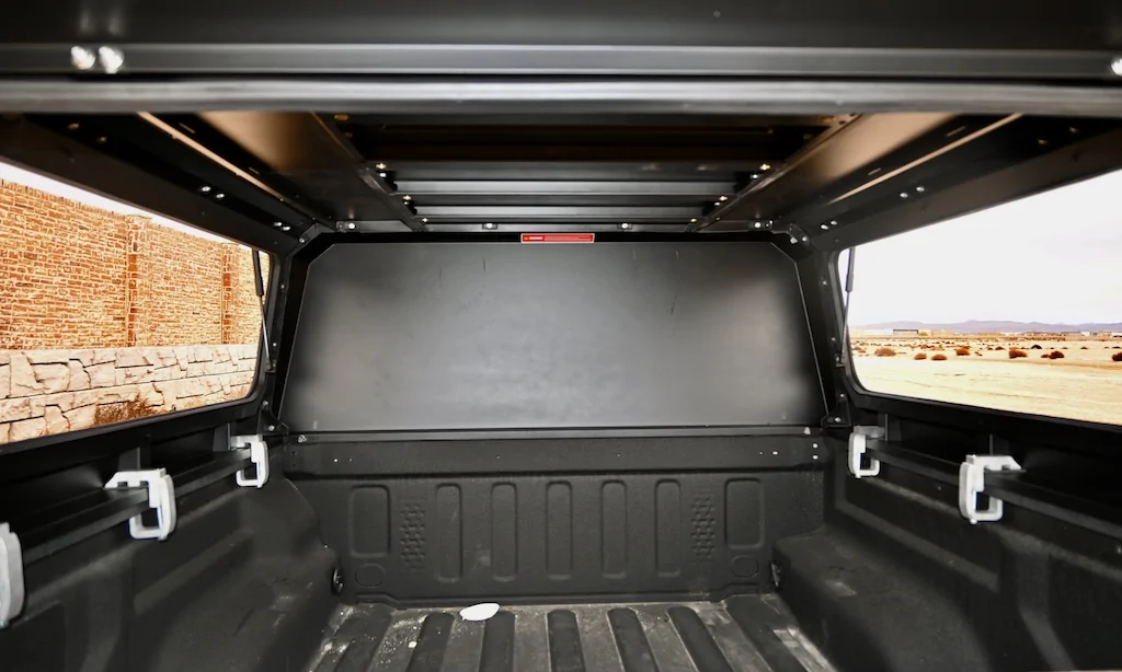

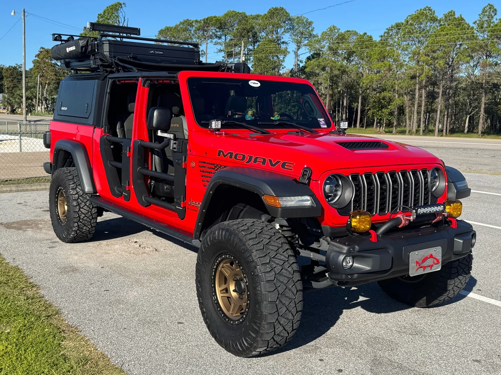

The Defender is made in SA, Actually, I believe all the Gladiator products are made there. I have one and love it with a full passenger bin and ordering a driver half bin. Build quality is fantastick. I went with the Defender as the price difference for a couple of glass windows is not worth IMO. I have no issues not seeing around the Jeep and dont really miss being blinded at nigh by lights from behind me, also, the extra security is just peace of mind. When I built mine I used black exterior waterproof RTV sealant on all seams. I also added an extra seal in front of the D-rubber on the front portion that goes against the cab that I Got from Amazon as it is thicker than the one they supplied. I sealed each corner of the cap from the inside between the cap and bedrail as I was getting small, and I mean small dribbles in very heavy rain, after that, not a drop leaked inside. Also, and this is just me, the Chinese knock offs are ugly and have exposed hinges on the outside. It's your money, lots of choices out there, best of luck with whatever you get.
EDIT: If you ever decide on a RTT, no issues with the weight. I am running a 170 pound aluminum hard shell tent, 270 deg. awning and shower awning on their cross bars. I am not a small guy and its a solid platform with the wife and I in the tent

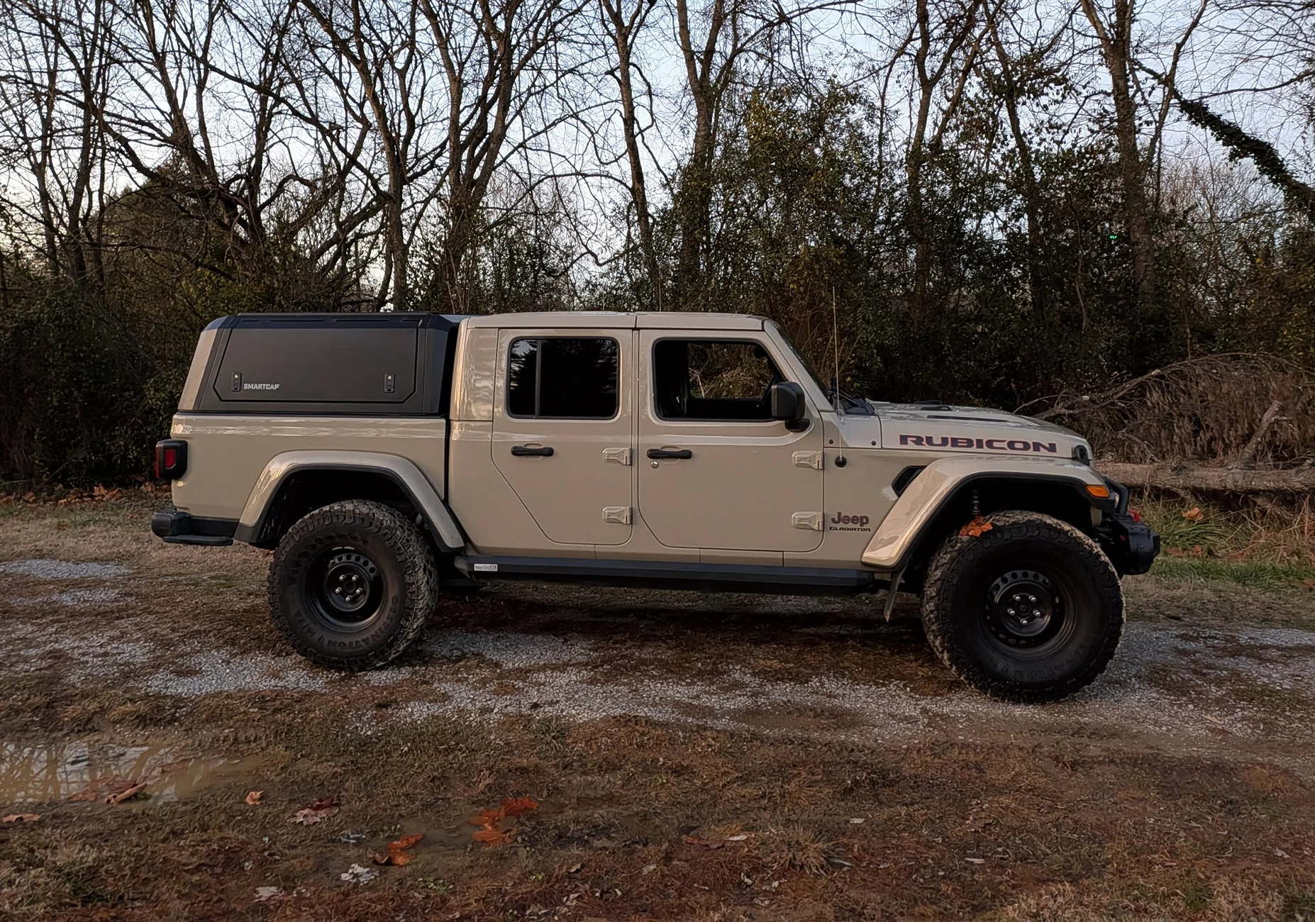

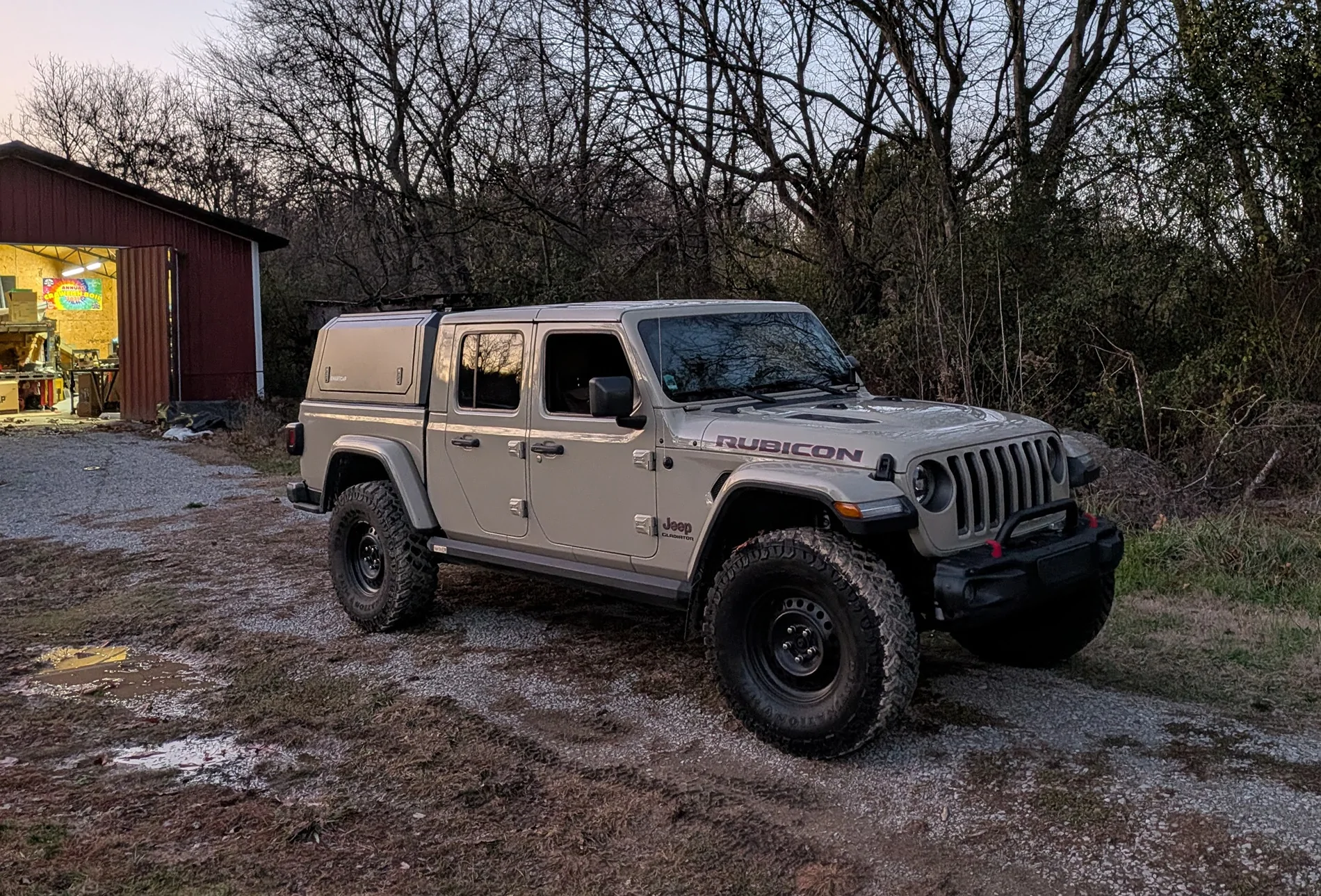

This was my reasoning as well. I also seem to prefer the all matte-black look of the 4 stainless panels over the much shinier glass. All the caps match the lines of the truck so well that the fancier EVO Sport almost makes it look like an SUV.
