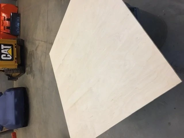

Has anyone else had any luck finding baltic birch near them or is this a local thing? I've seriously been trying to build this sumbitch since March but my local supplier sells out of 3/4 sheets as fast as they come in even at $80 a pop
you don’t need 3/4” plywood. 1/2” is what I and GOOSE Gear use. Remember it is much stronger than ordinary 1/2” plywood you get at Lowe’s because it has a lot of layers.

Well it's all out of stock locally it seems. I was going to go thick because I'm leaving a lot of it open to allow airflow to all the electronics I plan on mounting underneath.
At this point I'm getting frustrated waiting and I had to go back to my 60% GG platform on that side for a recent trip. Starting to wonder if the headache would even be worth it.

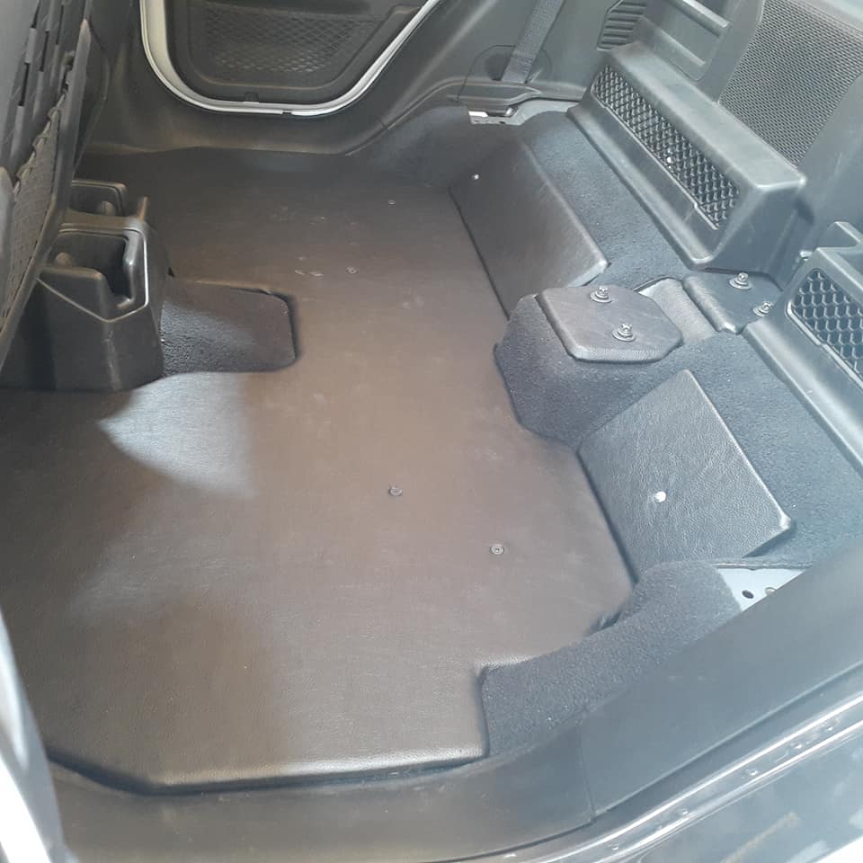

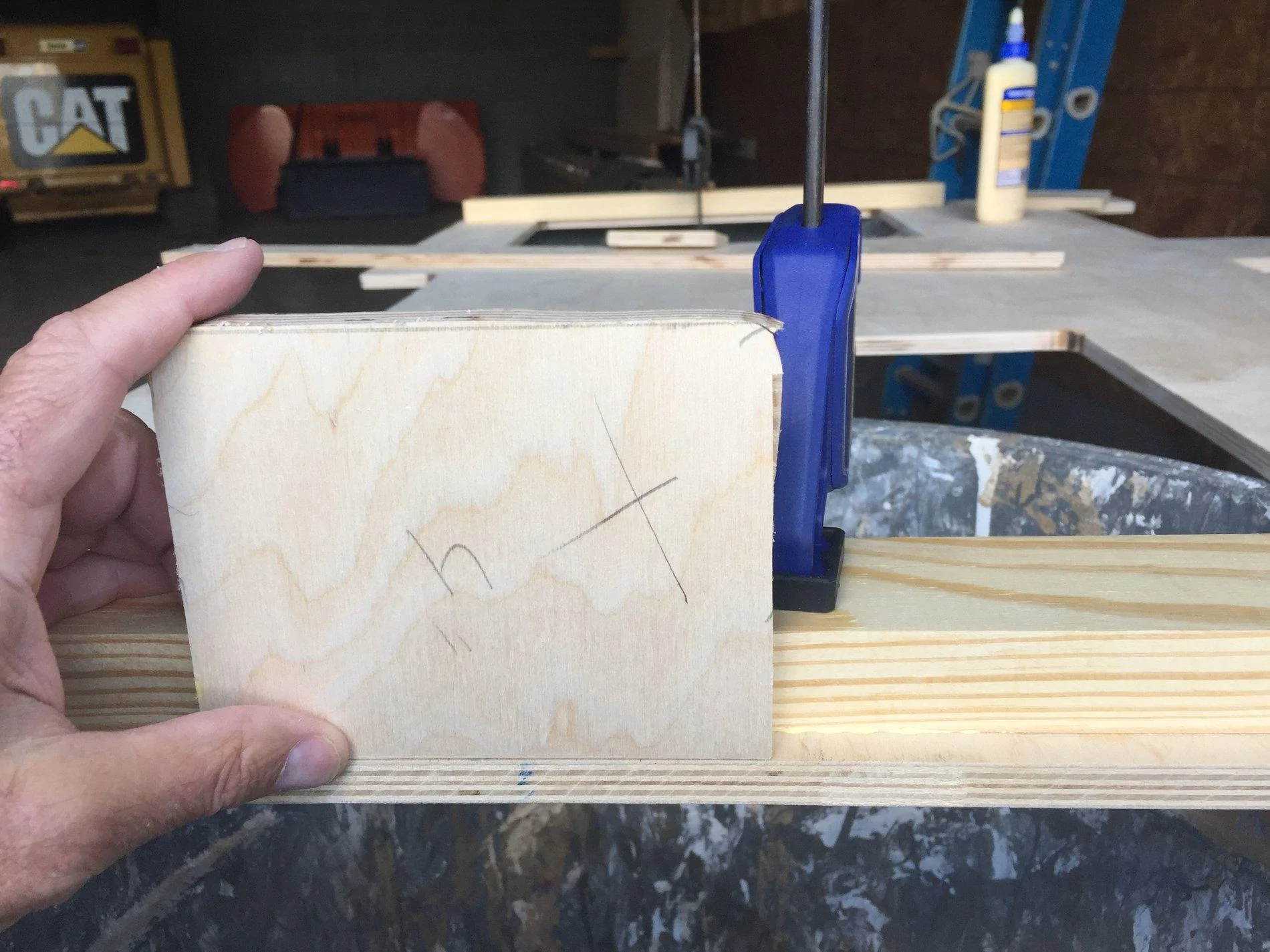

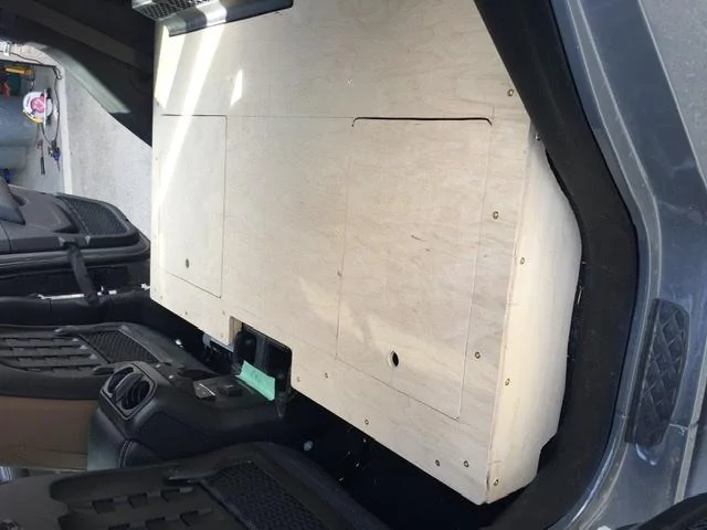

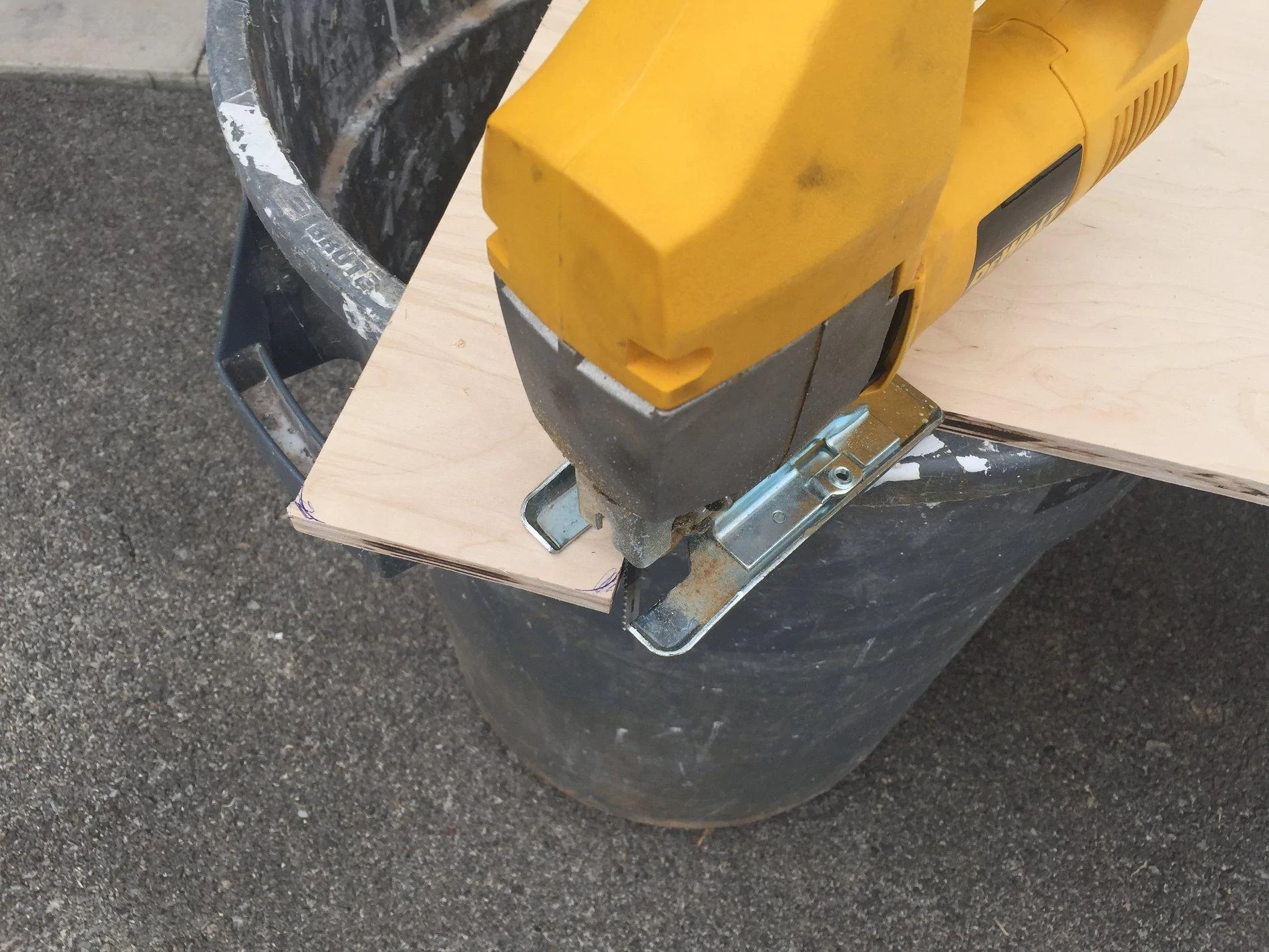

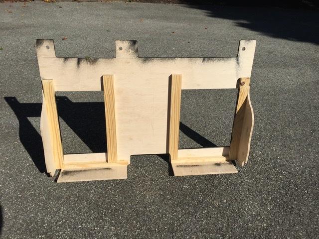

So here is where I went with mine. Started by removing the seat and laying out a general template using card board. Then I transferred that to plywood.
I wanted to keep the under seat organizer, as I use that space a lot. I measured out how much the front would overhang, and then screwed/glued in the front support. I played around with some different ideas on how to do a door mechanism, but ended up settling with what would be easiest to cut.

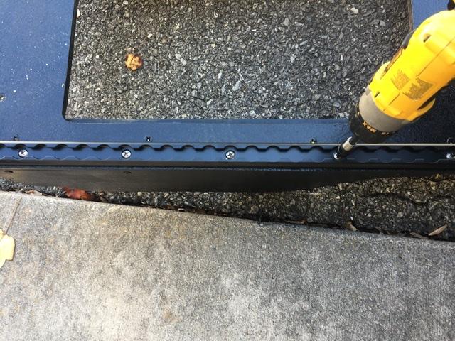

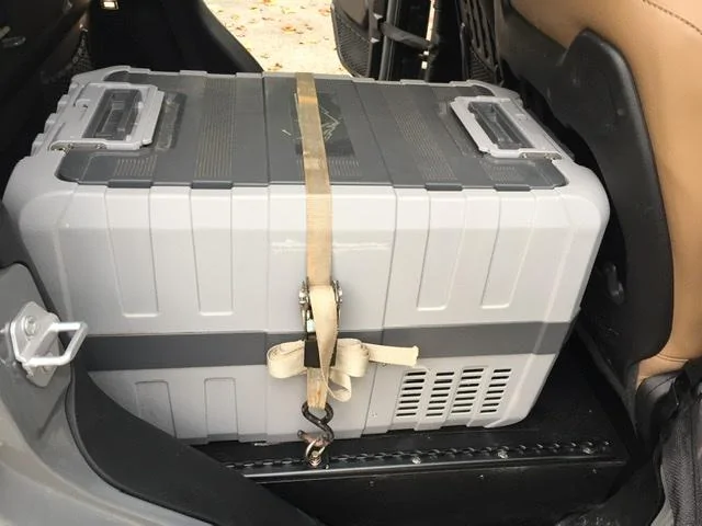

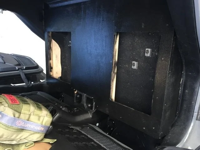

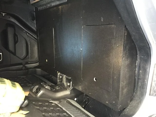

Once I had that done, I sprayed the rest of the platform with Rustoleum truck bed coating. I had planned to take this to my local Line-x shop, but he told me it was $250 per sheet of plywood, and even though mine was small, he would end up charging me $75. I went to the hardware store and grabbed 2 cans for $9 each. Ended up going through about a can and a half, doing about 3 thick coats. It turned out well, and hides the woodgrain which I like. I then added some track so that I could tie down a fridge or a box securely. I secured the rear end with some 12mm x80mm bolts, using some plastic spacers under the wood to try and make it as level as possible. My driveway is angled, but I can take the bolts out and refine as needed.
It got a little dusty when installing, the light highlights it, so it looks a little funky. But it gets the job done.
What is the measurement from the floor to the bottom of the plywood sheet
