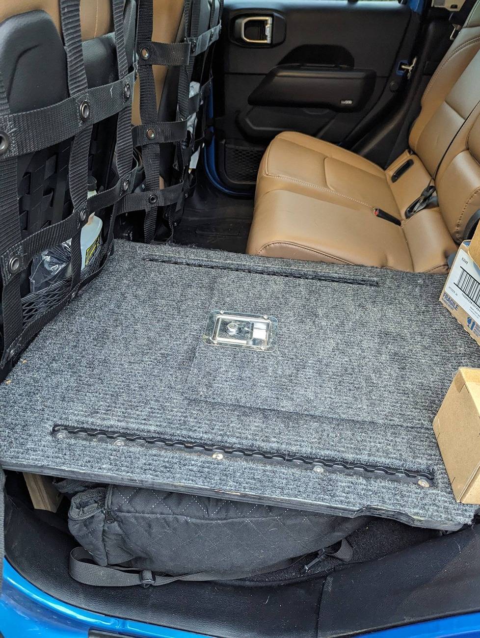

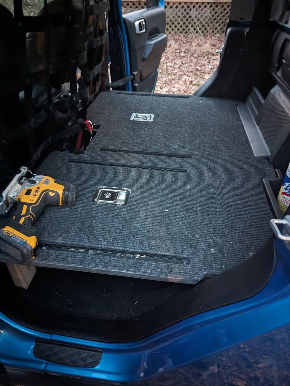

If you have any woodworking skills this is the way to go. Takes about 45 minutes to take out seats and install platforms or to remove platform and install seats. I have mine up higher at top of cargo net on the doors so that I get more storage space underneath. I have made side panels so is an enclosed storage space(not shown in these pictures).
My rear passengers are the family dogs for most trips. If I need space for humans I can install seat or seats as needed. Plus think about the 1500 or more so you saved by doing this yourself. 3/4 inch cabinet plywood was my choice for the build with 2x4 supports in the front( I don't even have to remove them when taking out they stay on the platform piece as it fits thru the door opening ;) ). I built it as a single platform before I modified it into the 60/40 configuration. I am very satisfied with the way it turned out and how much I saved by DIY vs finding something to meet my particular needs.
For the rear supports I used 2x4 pieces mounted onto Simpson L brackets. The platform screws into threaded inserts in those 2x4s. I also have US Cargo Tie down insert L track strips and the rings for when I need to secure items like a Fridge or other bulky items. underneath the platform where the tracks are there is a piece of 2x4 to provide the necessary reinforcement to provide support.

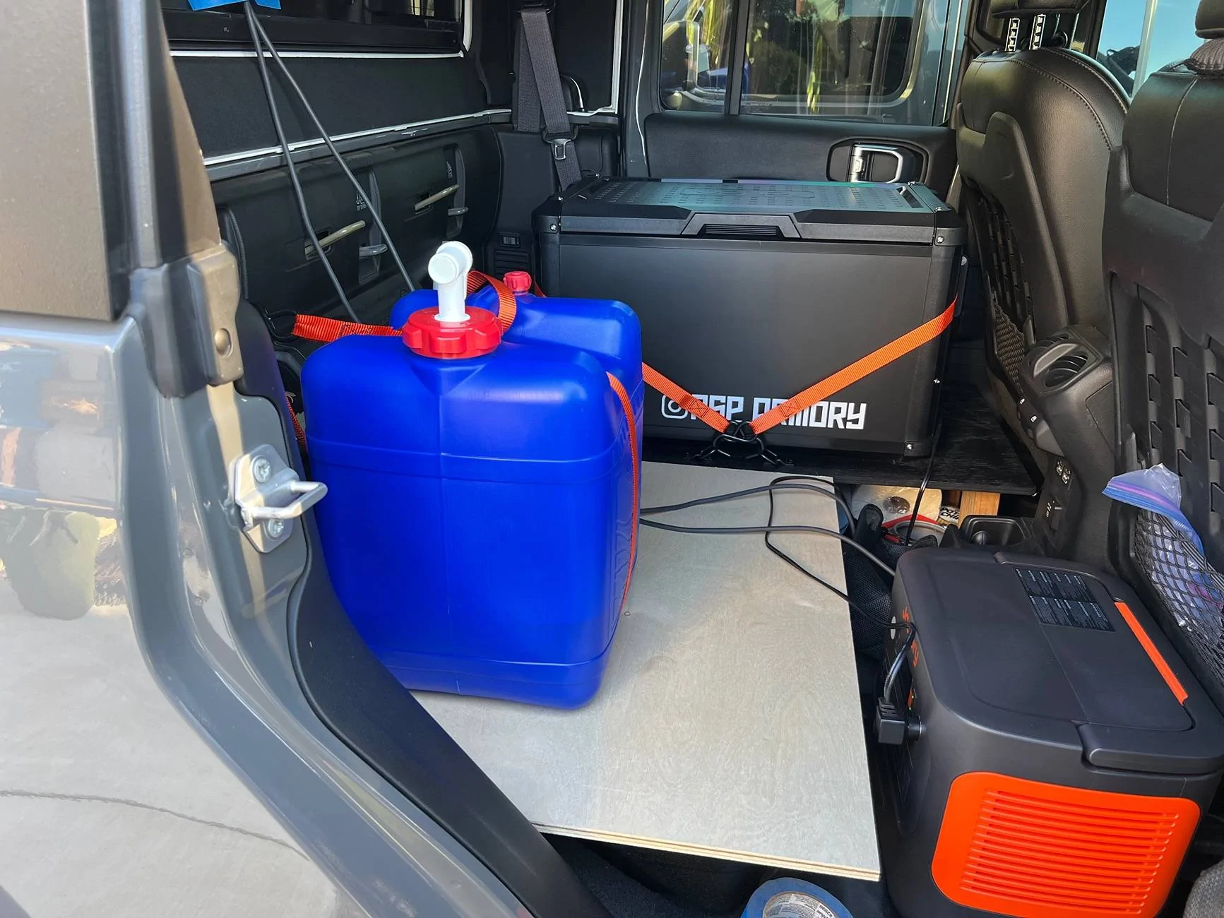

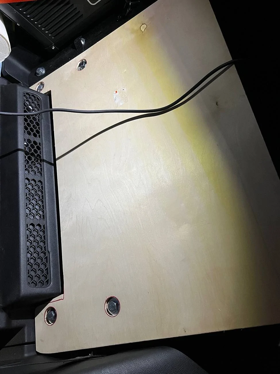

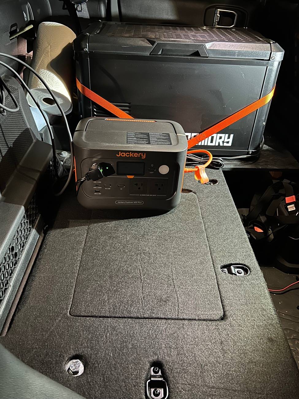

I went ahead and did the other 60% but I didn’t go all the way forward so I could still tuck the Jackery. I can travel with more of the essentials inside up front.
I used birch this time. Smoother wood for sure and it is lighter. But almost double the cost. Looking at the bigger picture I still saved hundreds if not thousand dollars just doing this and I can still reinstall the seats back in by just doing the four bolts

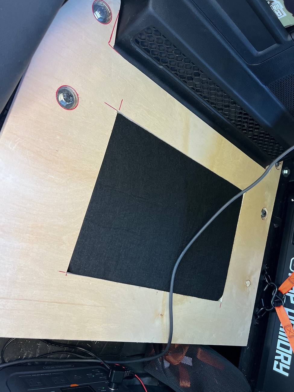

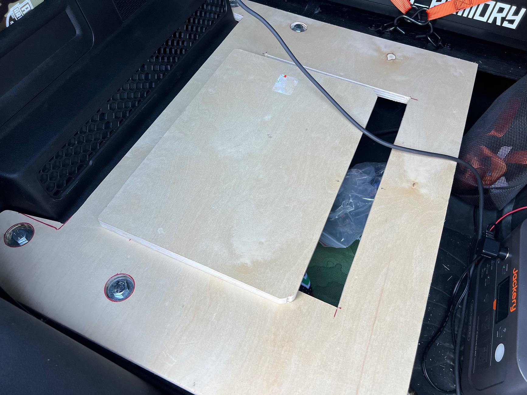

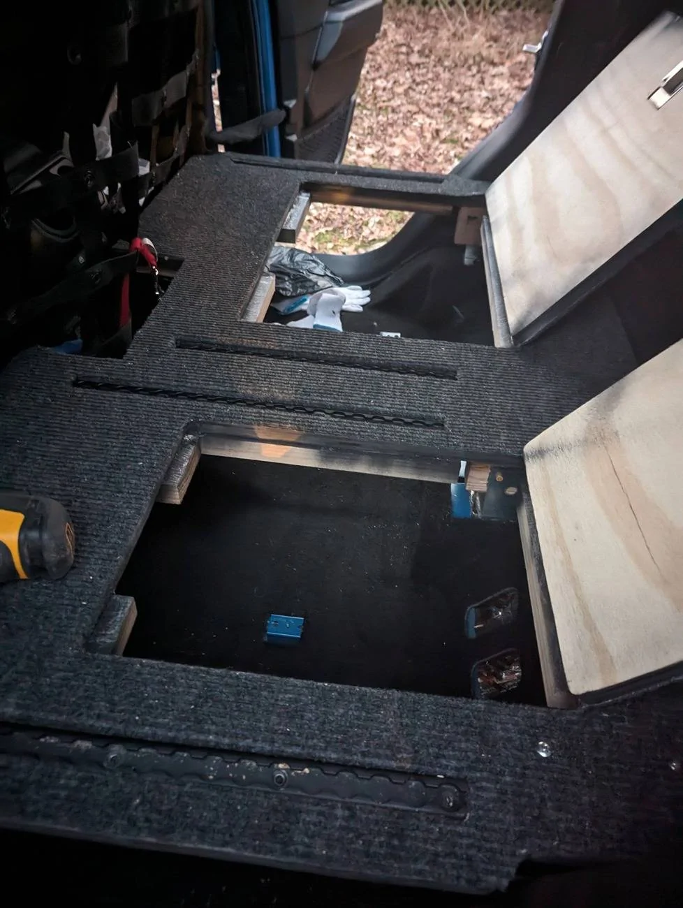

cut another piece and went with 3/4” birch plywood so I could recess all the hardware. I added more d rings to hold down cargo from going everywhere when driving on trails. And made a trap door to access storage underneath
