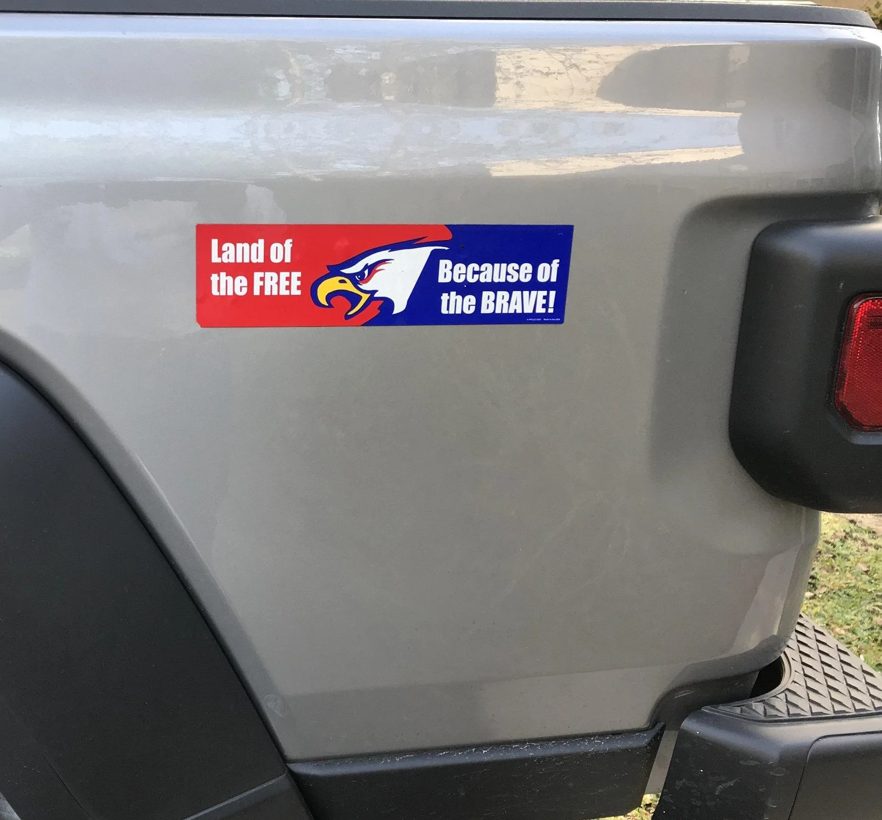

I figured that out a long time ago. Tried to attach this magnetic sticker to the tailgate.
Had to put it on the side. Fail to understand why Jeep did that. Save a few pennies I guess.
Aluminum is more expensive than steel. They did it to save weight and to help MPG. The bad news is if you get it damaged, has to be replaced.
