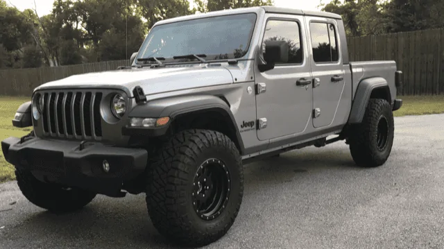

I put the daystar 2 inch spacer on the front which after you remove the factory isolator it only came out to 1.5 ...I got the rear 3/4 but ended up not putting it in yet because the stance came out perfectly level. The ride is pretty dam close to factory but feels a lot more stable with the 35's. By no means did it ruin the ride...a higher spacer lift might be a different story.
