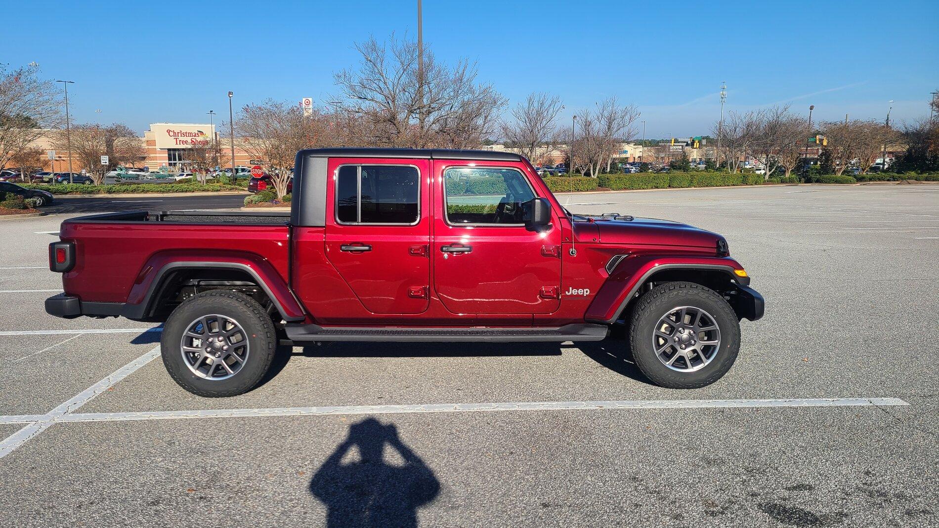

I just finished installing the Iron Rock Off Road 2" Spacer Lift. It's dark, so I'll take pics in the morning. So far, love the height and I kept the rake.
Here is my lift. These were taken just after dawn.
The first one is before. The second one is this morning after the Lift was installed. At first measurement, I gained 2.25" up front and 2.5" in the back. That may settle a bit so I'll measure again when I re-torque everything after 100 miles.
