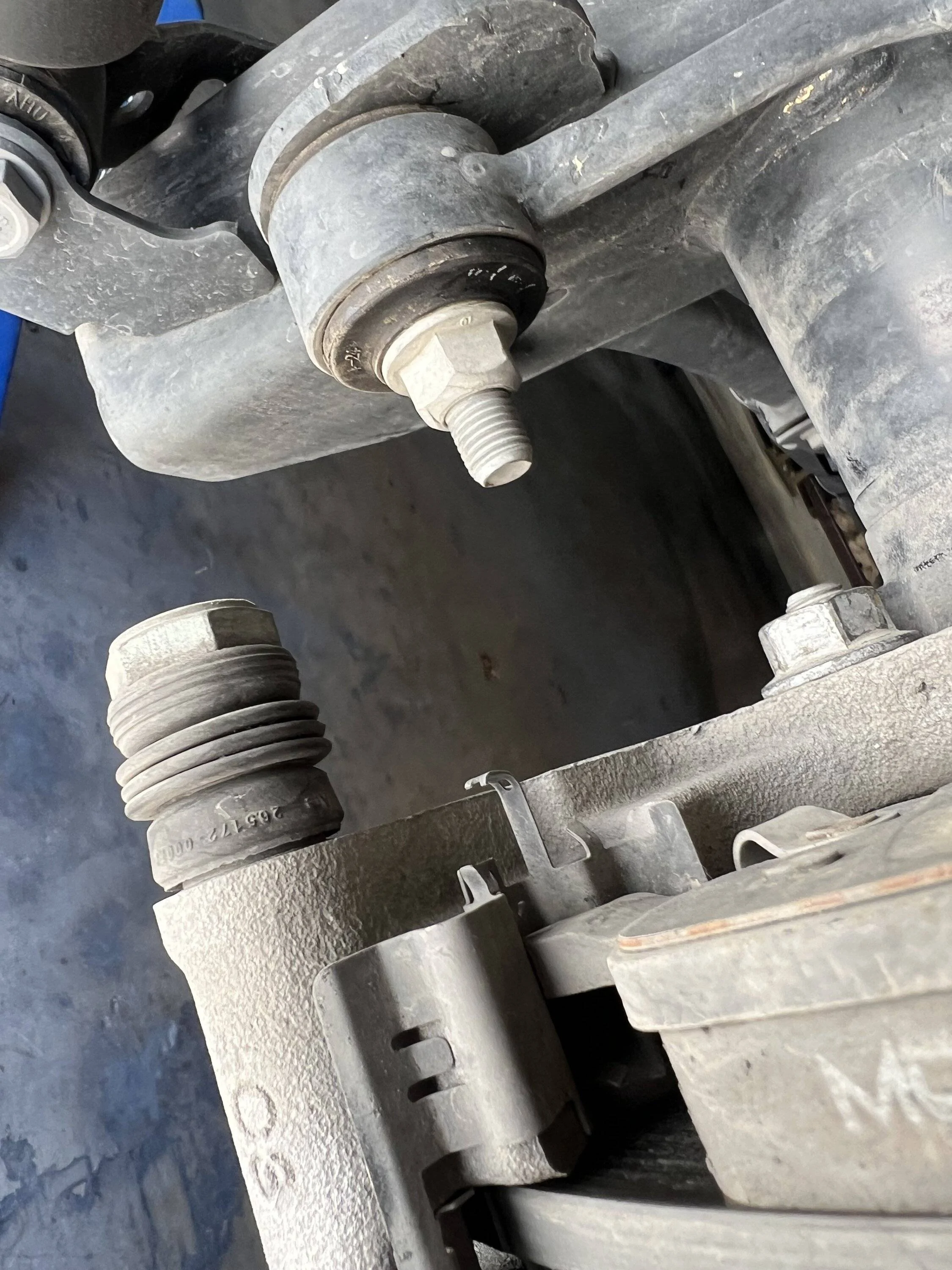

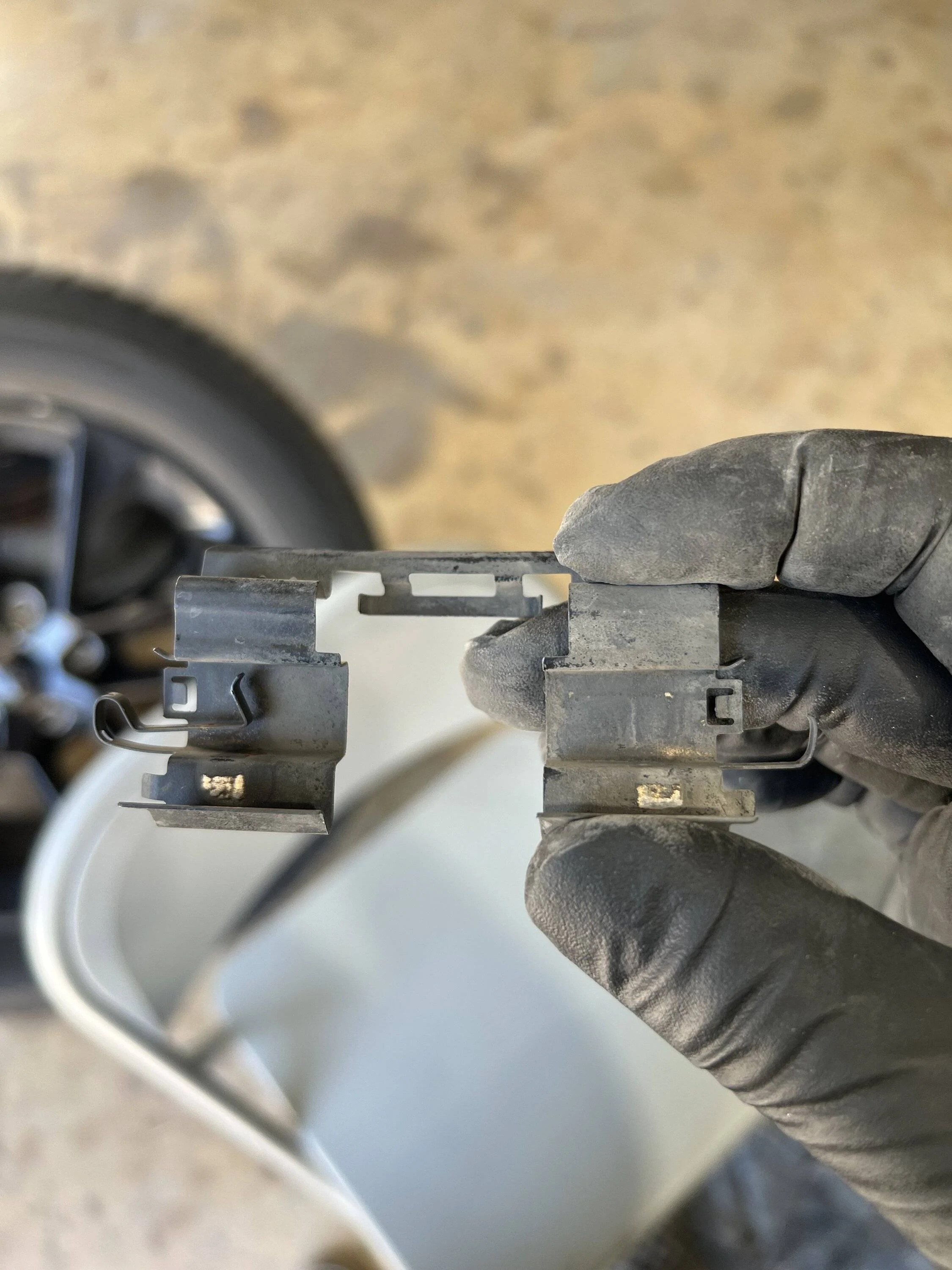

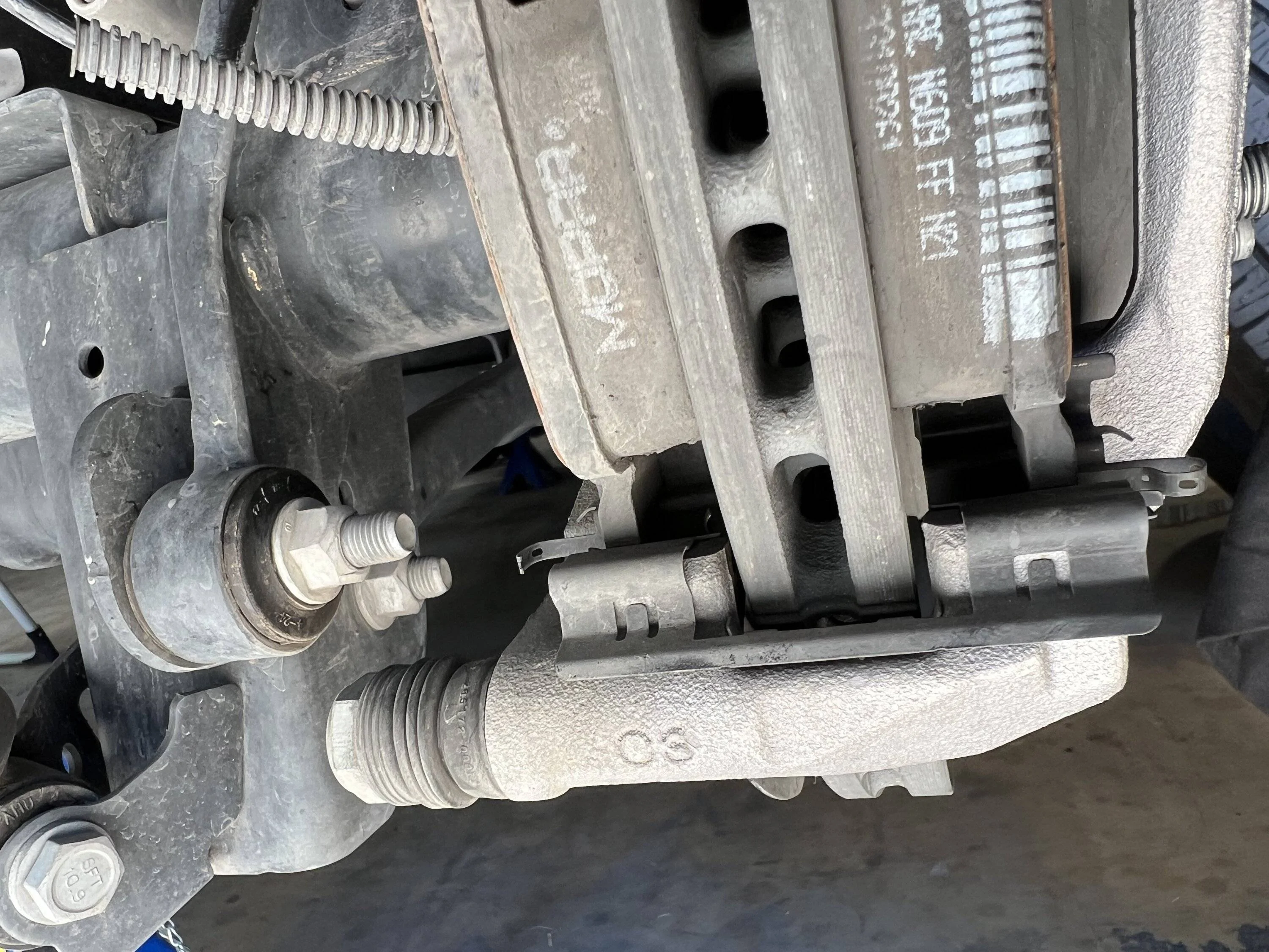

Solved! On my end. (2021 4xE. ) 30k miles
exact same issue as originally posted. Only happen after sitting over a period of time.
took it to the dealer they had it 6 weeks, initial diagnosis was build up of break dust on front pads. (I told them several times the noise was from the back)picked vehicle up after 6 weeks. Noise was immediate and we ended up leaving it at the dealership for another 1 week. Second Diagnosis was “glazed” front pads (again ignoring the rear) Although the brakes are hardly ever touched because of the regenerative system is used 99.9% of the time and i cannot recall a moment we have been hard on the brakes for any reason. Furthermore, no noise was created from ever hitting the brakes and the brakes stop the vehicle easy and without excessive force. We were quoted $1200 for front brakes and rotor’s because of “glazing”. We decided to decline and take the Jeep back home since their diagnosis was not adding up.
I am a Independent mechanic who works on all manufactures all years blah blah blah. So naturally I finally and no longer worried about their warranty decided to investigate myself.
NOW FOR THE SOLUTION.
SEE PICS ATTACHED
Rear Brake Pad “retainer” or “Shims” What ever you decide the call them, were broken identical on Driver and Passenger rear. Causing the inner pads to not retract “flush” from the Rotor.
The broken piece of the “spring” portion is retained under the pad until physically removed.
Also, rear brake area was never looked at by the dealer, visible evidence showed they never even took the wheels off the back.
SEE PICS ATTACHED
Thanks for sharing this, I will have to pull mine apart and take a look. The brakes are starting to get lower, so maybe it’s time to go ahead and put new pads and clips on anyway.
