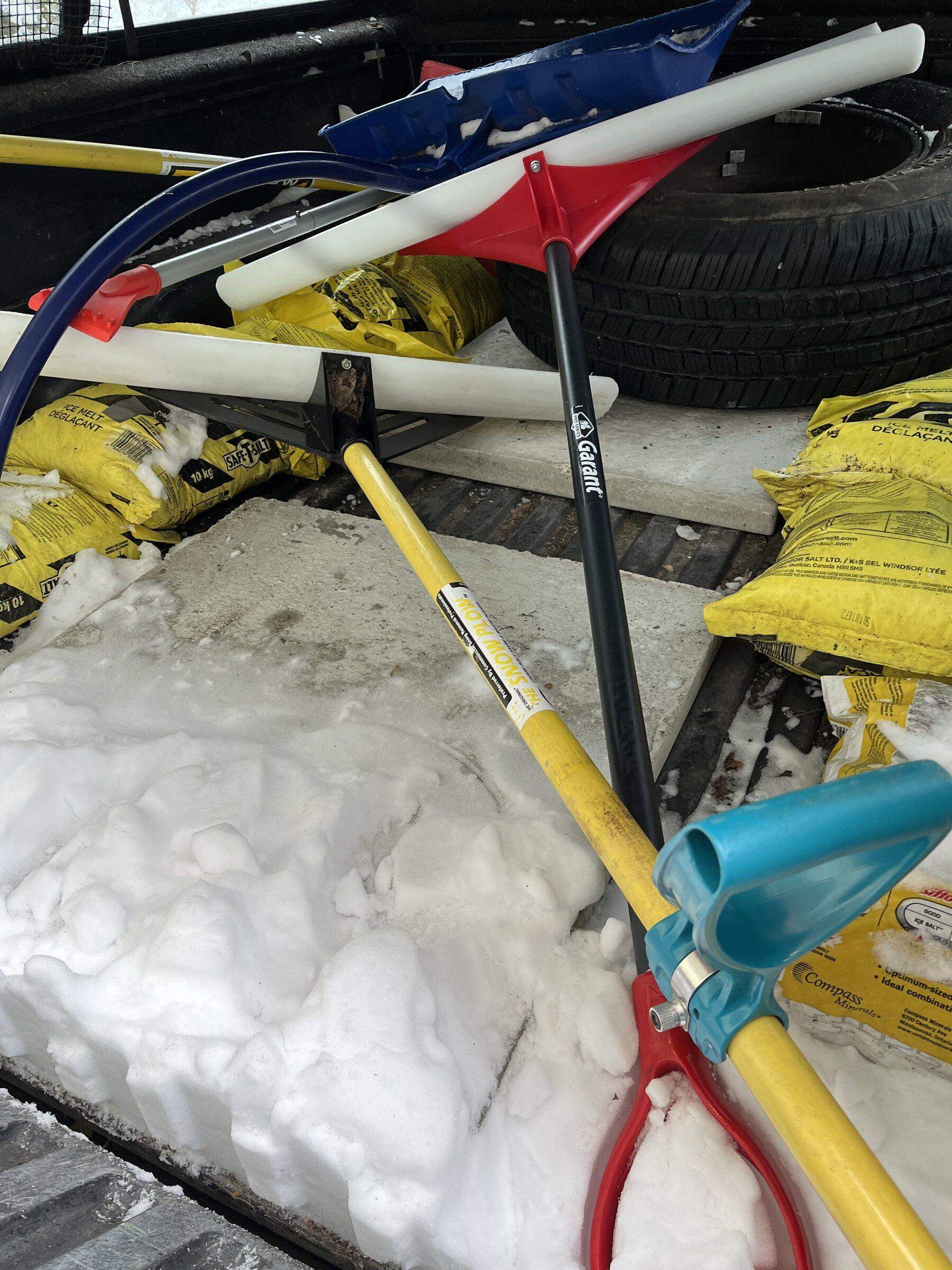

Here’s back of my Tacoma. Some salt a spare tire and couple large patio stones. Amazing what some weight over rear wheels does to these pickups in deep snow
You may find the weight in the bed to be less necessary in the gladiator. The weight distribution is really great. It’s the best slippery condition pickup traction model I’ve driven, with an empty bed. Mine is a rubicon. Great in snow. You’ll have no problems towing 3k. We do all the time, with or without the bed loaded.

You're right about the weight distribution. My Tacoma has the 6' bed so the Gladiator should be better but I'm still loading the bed with weight. I've driven light trucks in snow enough to appreciate the benefits of about 300lbs in the bed.
