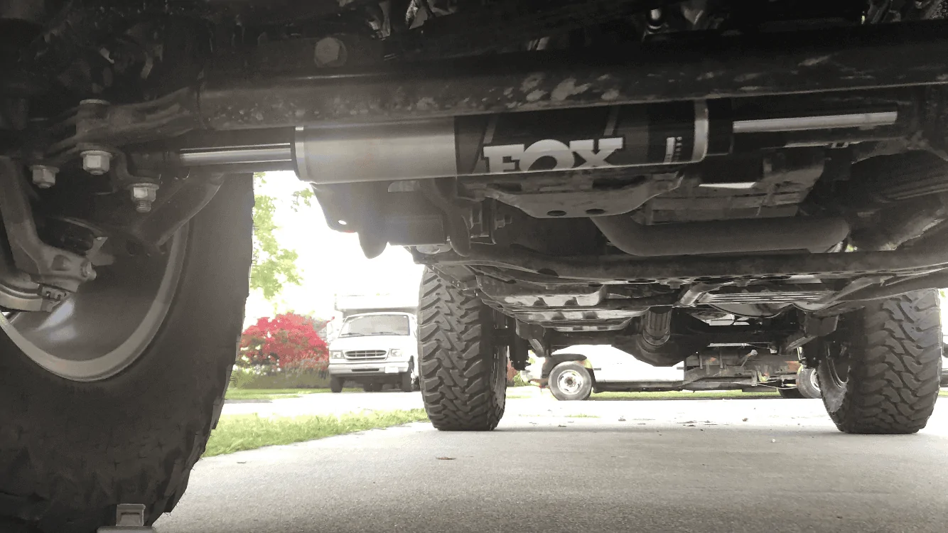

My steering noticeably became worse from stock to the installation by the dealer of the Mopar lift. They installed a Fox Steering Stablizer for me and it improved it where it “felt stock” again. That being said, now that I’ve gotten the TSB fix on it, it’s night and day. Zero issues and immediately felt like I was driving a different vehicle even in the parking lot as I pulled away.

It’s been said a few times, but the IFP type steering damper will make the Jeep pull to the right (they should only be used in a push-pull double damper configuration). The thru shaft versions cost more, but it’s a much better solution, it’s what I installed
