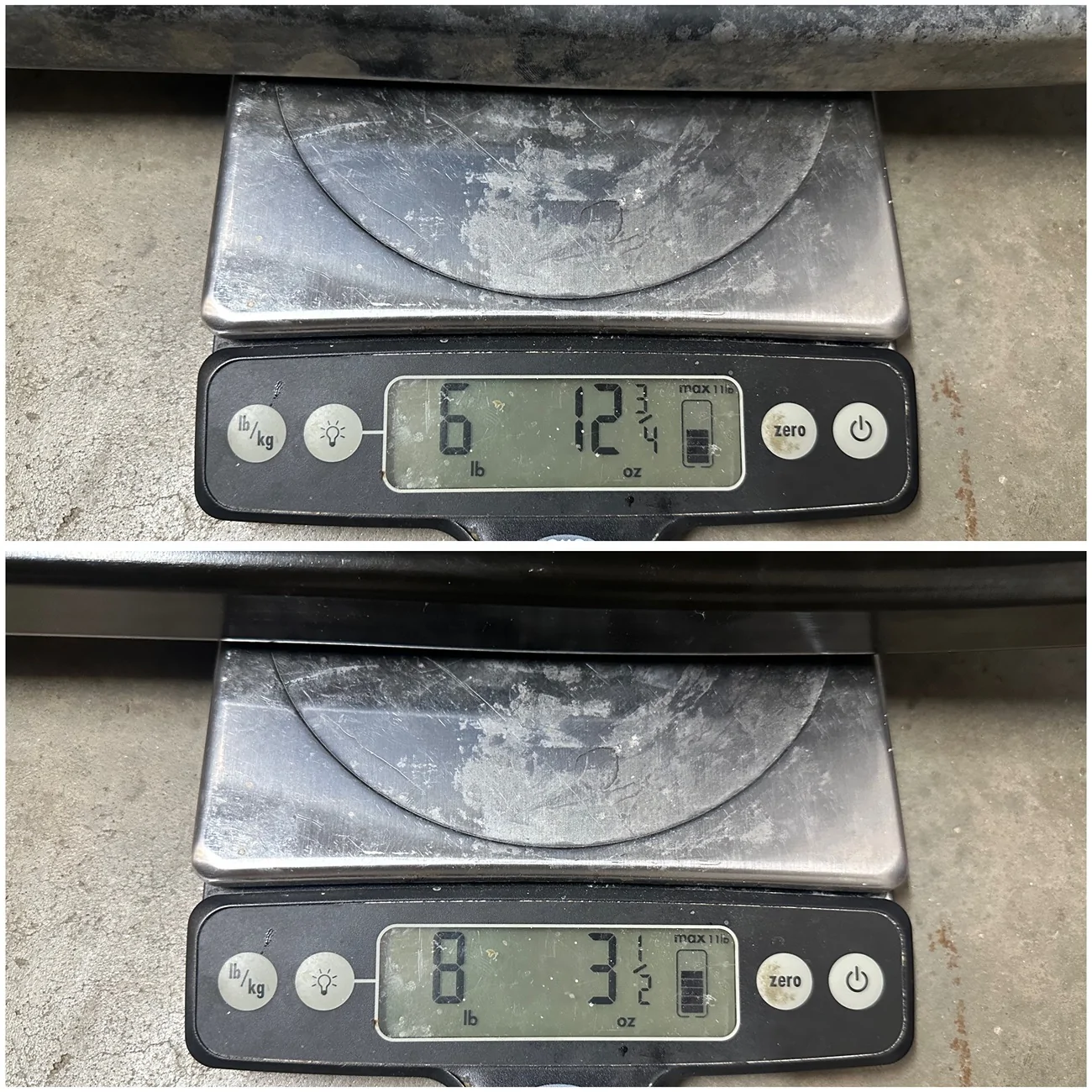

I just got in 2 Mopar Lift LCA part # 68322798AA they are 1/4" longer. The LCA are heavier each weighing 8.5 pounds where my stock 2024 JL Rubicon LCA weighed 7 pounds (according to my fish scale lol).
I thought you were crazy and I didn’t believe you. As soon as I got home I weighed a new MOPAR 2” control arm and a OEM Rubicon control arm. I was surprised with the results lol.
Your level of accuracy greatly surpasses my fish scale. lol
For $39 each they are heavier and added 1 degree caster a win in my book.

Out of curiosity I weighed the control arms. As mentioned earlier, the lift LCAs are indeed heavier that the stock LCAs. 8 lb 4.5 oz verses 6 lb 11 oz.
I'm surprised the stock LCAs weigh 7 pounds. They are light as a feather compared to the aftermarket LCAs I installed. I wonder why the lift LCAs weigh a pound more. Aren't they only an inch longer? Same rubber bushings?
Actually they are only around 1/4" longer. Not sure where the extra weight is coming from, unless they use thicker wall tubing.
I guess they could be slightly thicker. The Core 4x4 LCAs weigh about 15 pounds each. They would make pretty good weapons.
